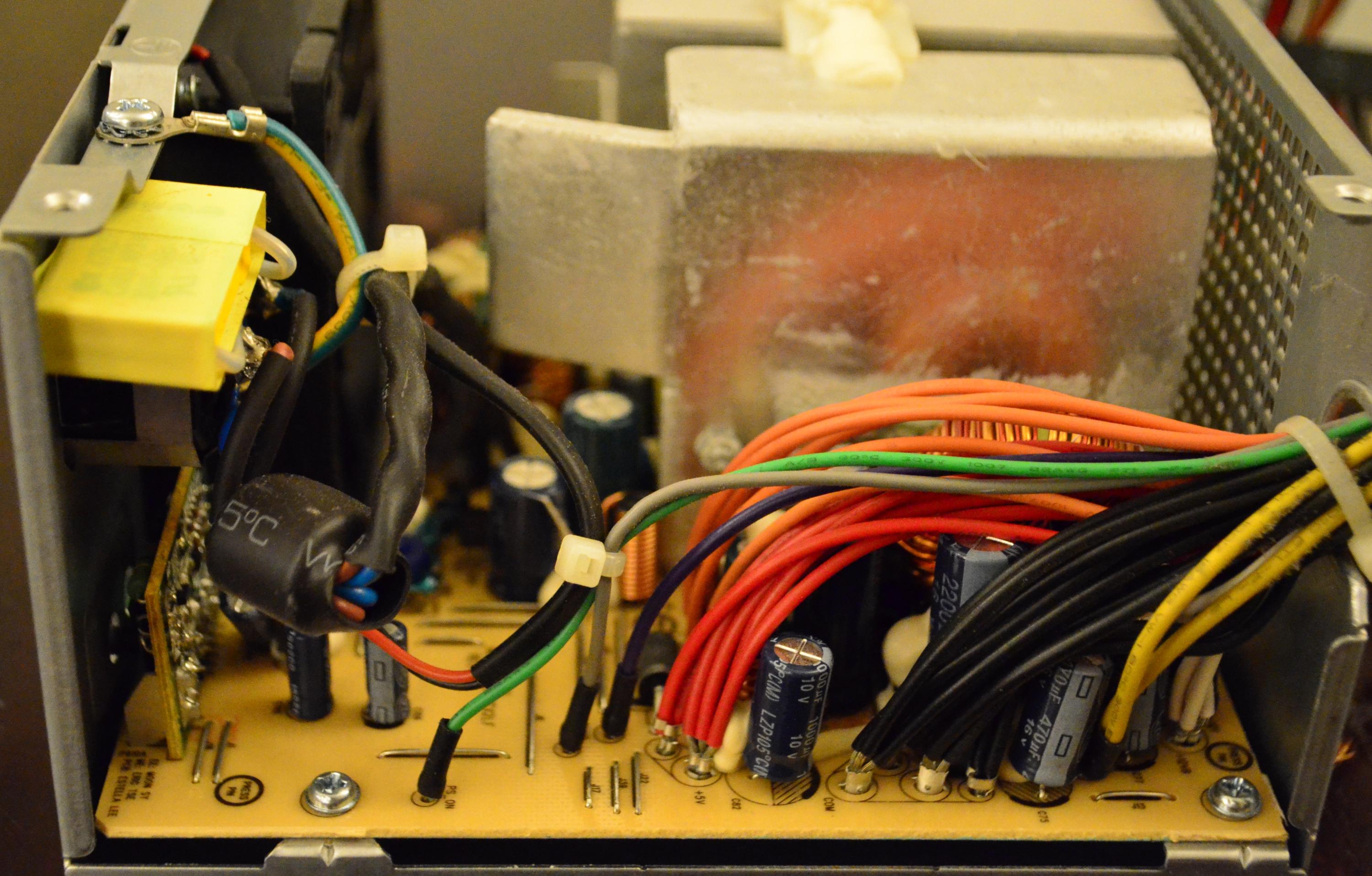

      Here's something a bit different than the normal computer PSU, a Motorola\Vesta\who knows who else "Power Module". Designed for a 911 phone system of sorts, it supplies +5V, -48V and -96V at who knows what current.
      Wasn't a cheap thing new, the 2005 Motorola catalog advertises it at $2730.
      Anyway, onward. It's based on some sort of all in one power modules. Who made them or what they are, I have no idea. I'd have to desolder them to find out and that's too much effort.
      Full res images here: https://imgur.com/a/9IpjM

        Pretty sure those DC-DC modules are not Vicor, unless they are a series that wasn't around in the mid 90s.

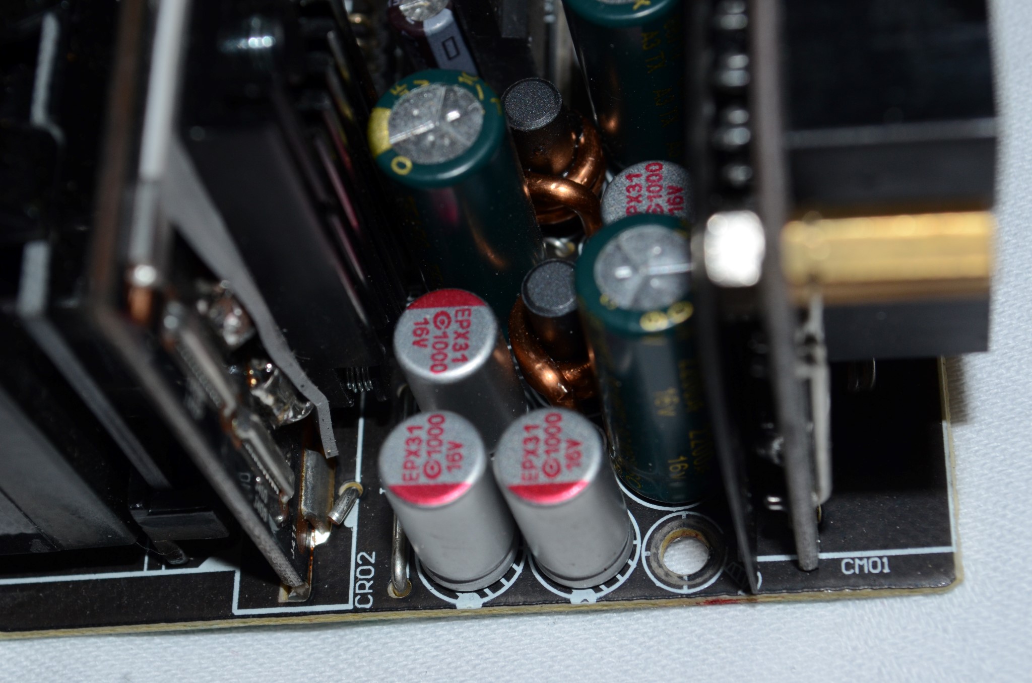

          Thermaltake Toughpower 1200 for experts' opinion
          Seems well built - using Polymers and Chemicon electrolytic
              2x 600W, not 1200

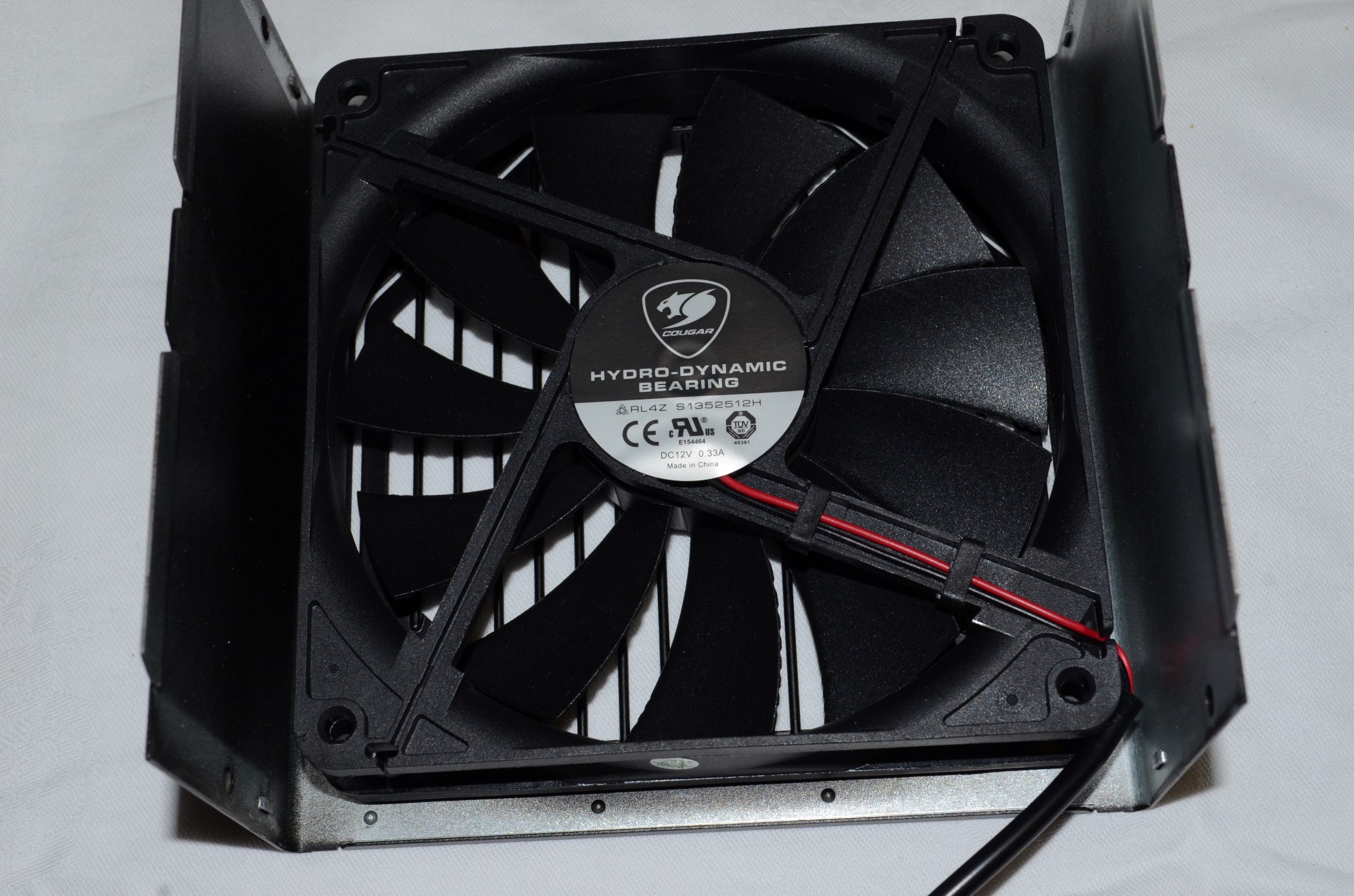

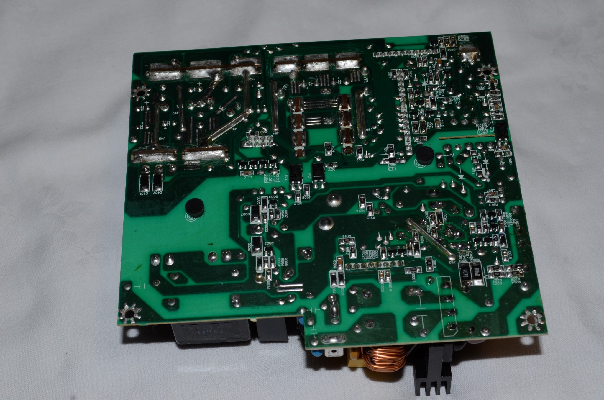

                            Something new:
                            I find the Transformer quite intriguing...

                              #2894
                              Looks pretty small. The main supply probably operates at really high frequency, though, so I imagine that's what allows it to be so small and still deliver its stated power.
                              That said, do you have a label shot of the unit? Just curious who made the PSU and how much juice it's rated for.
                              All in all, looks pretty much just like any other double-forward single 12V-design of today. And minor rails appear to be DC-DC buck regulated (again, as usual).
                              Not a fan of the all-black colors, though. Sooo boring nowadays! At least the PCB is not black on the bottom side too (I hate working on black PCBs.)

                              • Stefan Payne
                                • 1267
                                #2895
                                Well, yeah.
                                Its an LLC-Resonant mode Converter.
                                So I'd expect it to operate between 400kHz and 1MHz, maybe 2.
                                And I don't know if you see it on the Pictures but the Secondary Windings from the Transformer are soldered directly to the additional Board, where the +12V Rectifiers are.
                                Thats the 550W version of the Cougar GX-F, made by HEC/Compucase.
                                Ähm, its not Double-Forward because no Coil on the Secondary.
                                But another one right next to the main Transformer.
                                That's how you can distinguish an LLC-Resonant Mode thingy from other topologys.
                                Yeah and the interesting/great thing:
                                Its a Single Layer Board.
                                Another Interesting points:
                                The huge 1000uF/16V Polymer caps
                                The Enormous (for a 550W) 470uF/400V Main Cap.

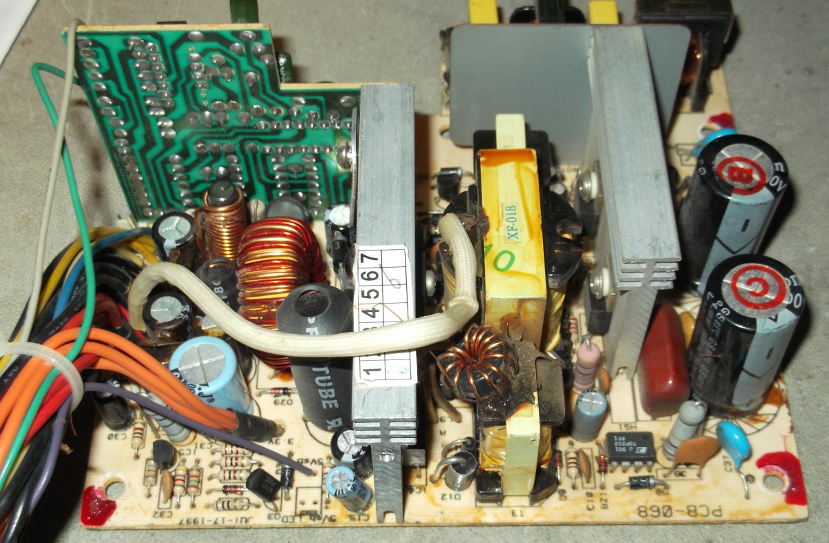

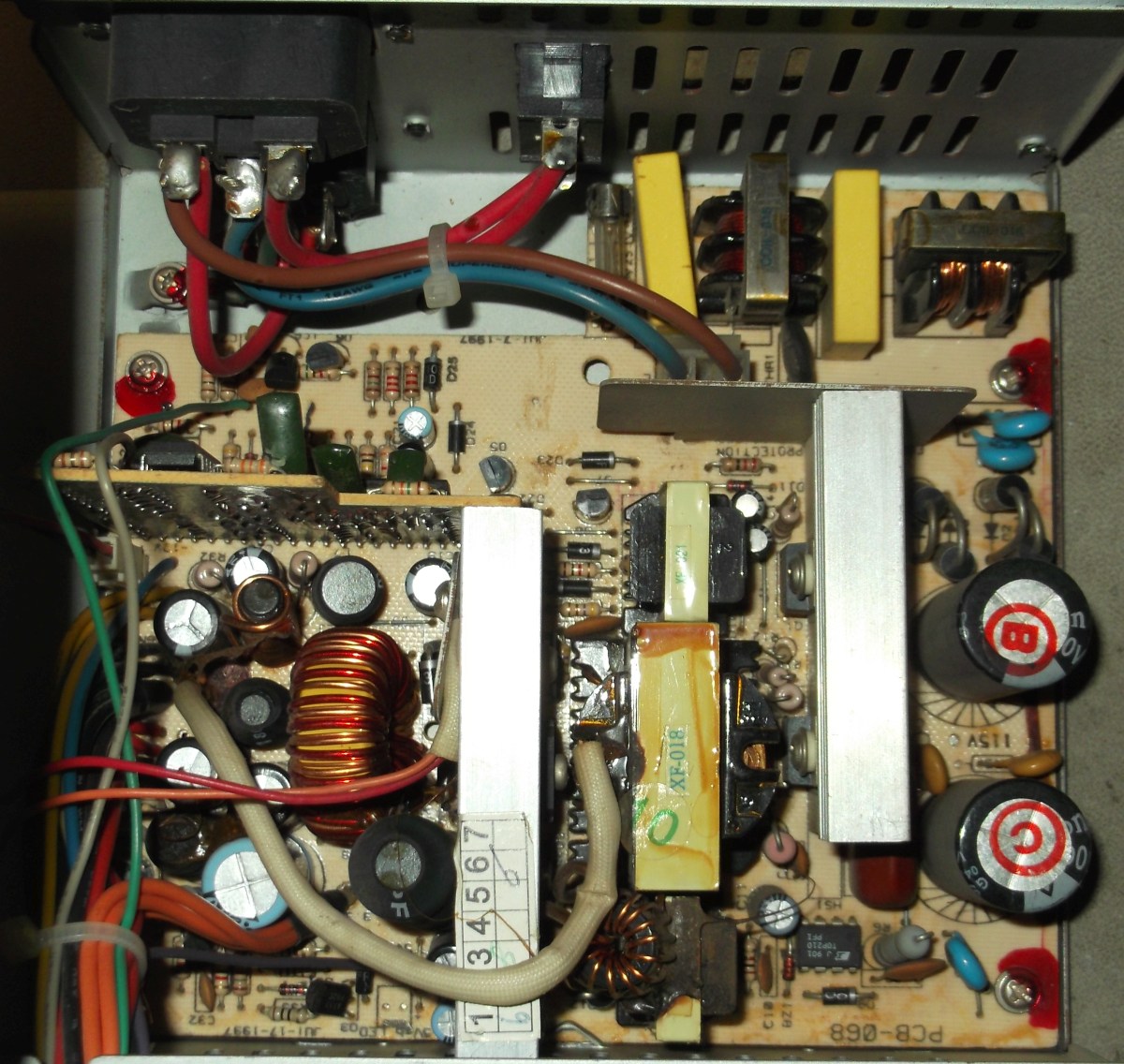

                                    VIP ST-235ATX 250W ATX.
                                    After 20 years of service it was time to retire this unit. It won't start anymore.
                                    I'm not sure who the OEM is but that XF marking on the main transformer and those stickers are something I see from time to time. The 555 based fan controler is familiar too.
                                    I was really impressed to find a TOP210 in such an old noname unit.
                                    No PFC
                                    Primary rectification: 4x IN5406
                                    Primary capacitors: 2x 220uf Capxon
                                    Primary switchers: 2x E13007 ;half bridge topology
                                    Standby IC: TOP210
                                    35mm size center tapped main trafo
                                    5V rectifier: S30SC4M
                                    12V rectifier: S10C40C
                                    3.3V rectifier: S20C30C
                                    -12V IC: L7912CV
                                    -5V current stabilizer winding + FR152 diode
                                    5V standby diode: can't see the markings...
                                    Nice fan controller circuit.
                                    Wires are awg18 thick on mb and peripheral cables. Was good enough for some pentium 2 office machine that runs nothing but word97 and solitare...

                                        #2899
                                        Nah, should repair it and make it last 20 more years.
                                        Same here. Which is probably another reason why I would say it's worth repairing it. On that note, I would guess the most likely reason this PSU doesn't start is due to bad caps - either the "start up" cap for that TOP210, the 5VSB output caps, or some of the small caps around the secondary-side PWM controller.
                                        This PSU has a classic oldschool half-bridge topology, so there's not much to go wrong with it. Should be a fairly straight-forward fix (if you have the time and desire for that, of course).
                                        Yup. Even more than enough.
                                        BTW, I like the unique and strange fan cutout. And it cools like it exhausts hot air into the case rather than out? I've seen a few old Pentium-II era PSUs like that, at least.
