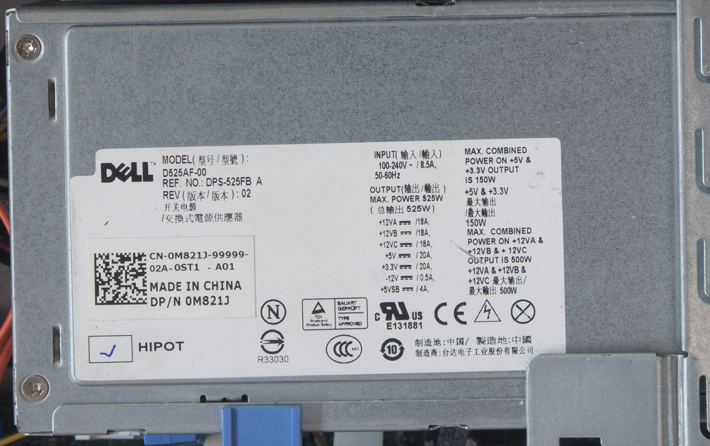

                          Here's the two factory 525W PSUs you could get in a Precision T3500.
                          The first the DPS-525FB. This one's the "525W Active Power Factor Correcting (PFC) power supply" and is made by Delta.
                          Remove one cover (the case is designed in 4 parts) and you get to this.
                          Remove the four screws and you get inside.
                          Mostly Nippon Chemicon KMQs but that black one near the power connector is a Lelon.

                            Typical over-build Delta designs. Love the two PCB design on those. It's just a shame that they are slightly too big for most cases. I have a Dell H750P-00 and Delta DPS-750CB which I can't use because of that.

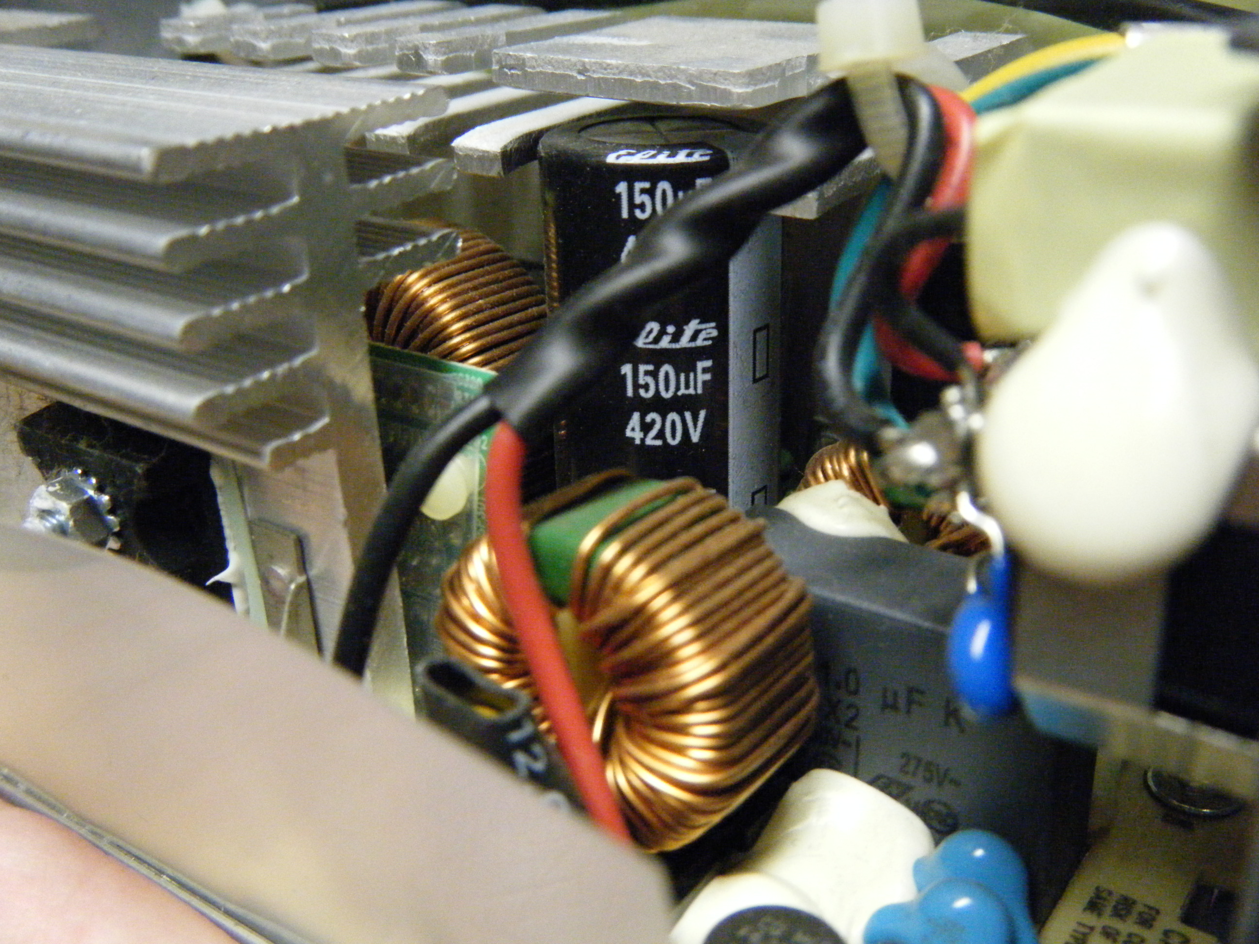

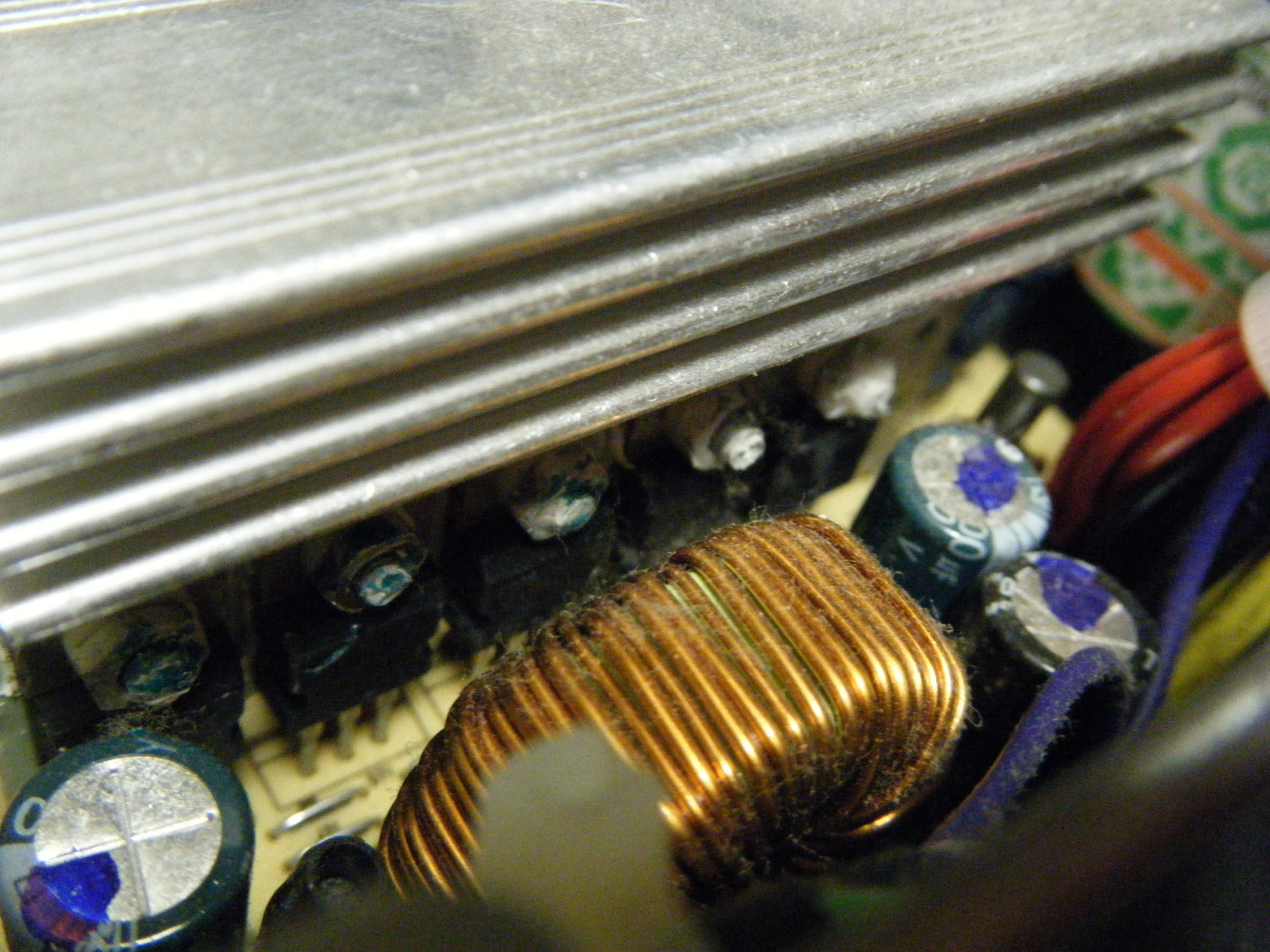

                              DELL H240AS-00
                              OEM: HIPRO
                              Output: 240 Watts
                              PFC: Active
                              Caps: Elite, Ltec, and a few Rubycon
                              Fan: Protechnic "Magic" MGA6012HS-A25
                              Input: 2 EMI chokes, 2 x-caps (one is 1uF!!!), GBU606 rectifier, y-caps, and x-cap discharge resistor
                              PFC silicon: 16N50C (Infineon), BYV29X600
                              Main silicon: W12NK90Z (STMicroelectronics)
                              5VSTBY silicon: TNY280 (PowerIntegrations) (Even has a heatsink attached to it!)
                              Secondary silicon: LM7912, 3x STPS2045CT, STPS30100, 40N06
                              Oh, hello there, Keith, Catherine and Ken! (Oh and Andy, on a small board by the AC input)
                              The electronics were designed by a female?! Nice!
                              The transformer is quite small. Smaller than the smallest DEER! Huh, I guess they might be using a higher switching frequency.
                              The build quality is very nice, except for the caps. There is a good airflow path, the heatsinks are nice, and there is good EMI filtering. Also, there is some heatshrink tubing for protecting a cable going to the board next to the AC input. Even the 5VSTBY IC has a heatsink, which I think might be because the 5VSTBY is rated for 20W!!! They could have used a better fan, but hey, it isn't the worst fan.
                              Also, the 5VSTBY is rated for 5V @ 4A!!!!! WTF!!! Wow!!!
                              (LOL, and it has a -12V output )

                                Capxon? On the APFC filter? Run away
