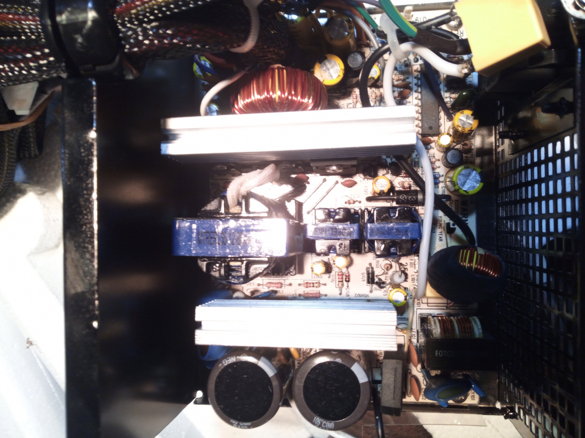

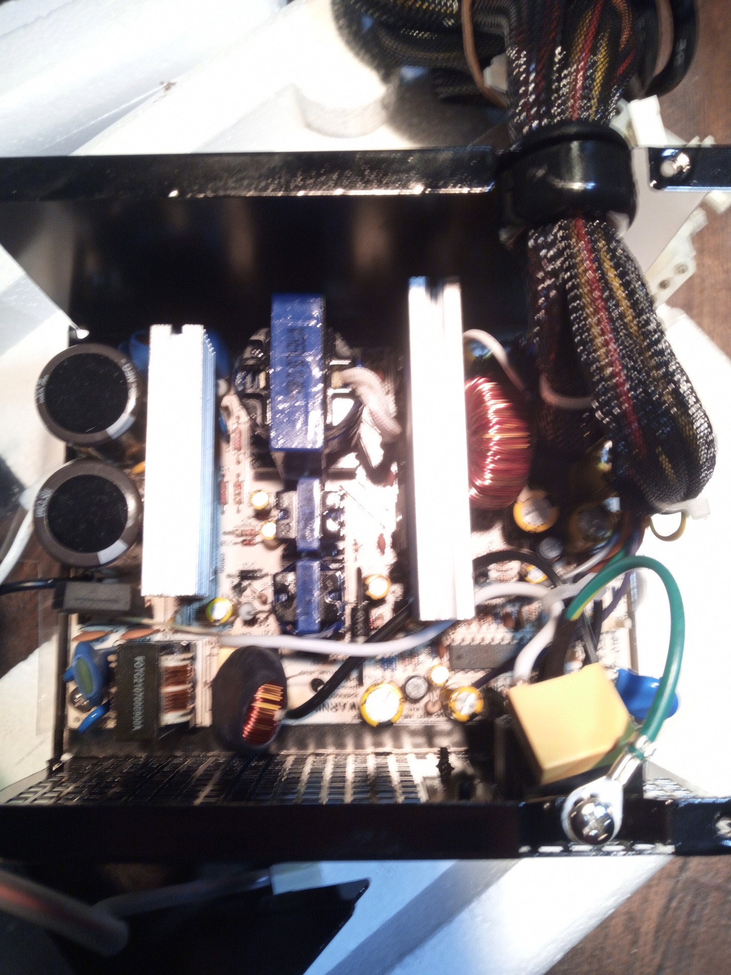

    So i bought an old-stock Apevia X-Qpack. This comes by default with a "420W" power supply. Since i read this review from JonnyGuru, i thought it would be crap:
    http://www.jonnyguru.com/modules.php...=Story&reid=79
    But i think i've got a newer revision of this psu. Mine got a passive PFC and looks rather complete. I've added some pictures to show it to you guys.
    The primary:
    - a pretty much complete input filtering stage
    - Real 250W Passive PFC coil with an added capacitor
    - 2x 2SC2625
    - KBL406 bridge rectifier
    - 2x 470uF primary caps
    The secondary:
    12V: SFR20100 Schottky 20A rectifier, pi coil
    5V: SBL3040 Schottky 30A rectifier, pi coil
    3.3V: SFR20100 Schottky 20A rectifier, pi coil
    The secondary caps are really crammed together so i still have to take a good look at them to know which one is for which rail. All caps are Fuhhyu ones. The PCB says this is a YoungYear unit. It also is 230V AC only and it seems that if even has a temperature controlled fan.
    Now, when i look at the power supply and the components it uses, i really think that the unit JonnyGuru reviewed maybe had a 10A rectifier for the 12V rail?
    If i recap the secondary output stage, will i have a reasonable 250W PSU that can deliver about 200W on the 12V rail?

      I just replaced the 12V rectifier for a MBR4045PT and it works just fine with it. I hope this will give it some more leeway on the 12V rail. It does look quite good, 2 of those big packages on the secondary heatsink. I actually found a production date on the pcb, it says february 2006.
      I will wait for you guys to see what you think this power supply can do on the 12V line, if it is good enough i will recap it with some panny's.

          This is a half bridge unit so a diode package rated 45v reverse voltage should not be used on the 12v rail, I mean you can do it but if the reverse voltage peaks at more than 45v you are going to see some magic smoke
            Re: A "nice" YoungYear unit?
            +10
            Not uncommon for 45V rectifiers to blow on the 12V rail, unless the 12V rail transformer windings are center-tapped to the 5V rectified output (done on some newer H-bridge PSU designs to improve 5V-12V rail loading, but it decreases efficiency).
            Looks like the answer is Yes.
            I have a similar YY PSU (Aspire / Apevia ATX-AS520W) based on the same platform. But I haven't finished recapping it due to other projects, and as such I haven't been able to load test it with a more powerful rig to see how it does.
            That said, your PSU did have a 20 Amp stock rectifier on the 12V rail, so the 12V rail should be able to reach 200 Watts in theory. The primary side also has TO-3P devices, so that too should allow the PSU to do at least 200 Watts (for TO-3P parts, you're probably looking at 300-350 Watts limit on the primary side... maybe 400W with a really good design).
            Anyways, if you do recap the PSU, make sure to also do the 5VSB output, as well as all of the small electrolytic capacitors.
