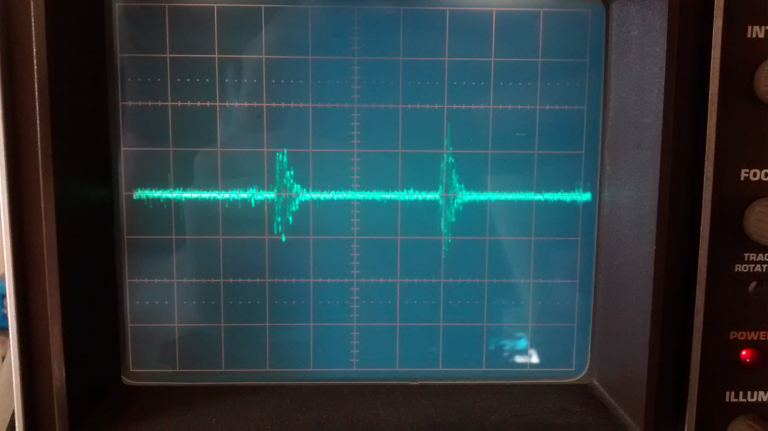

    A first visual inspection did not reveal any defective/bad components. I then tested the single components on the entire board looking for a short/bad behavior, with no success.
    Finally, following ChaosLegionnaire's suggestion, I decided to plug it in, connect to an old motherboard and measure the signals with my oscilloscope.

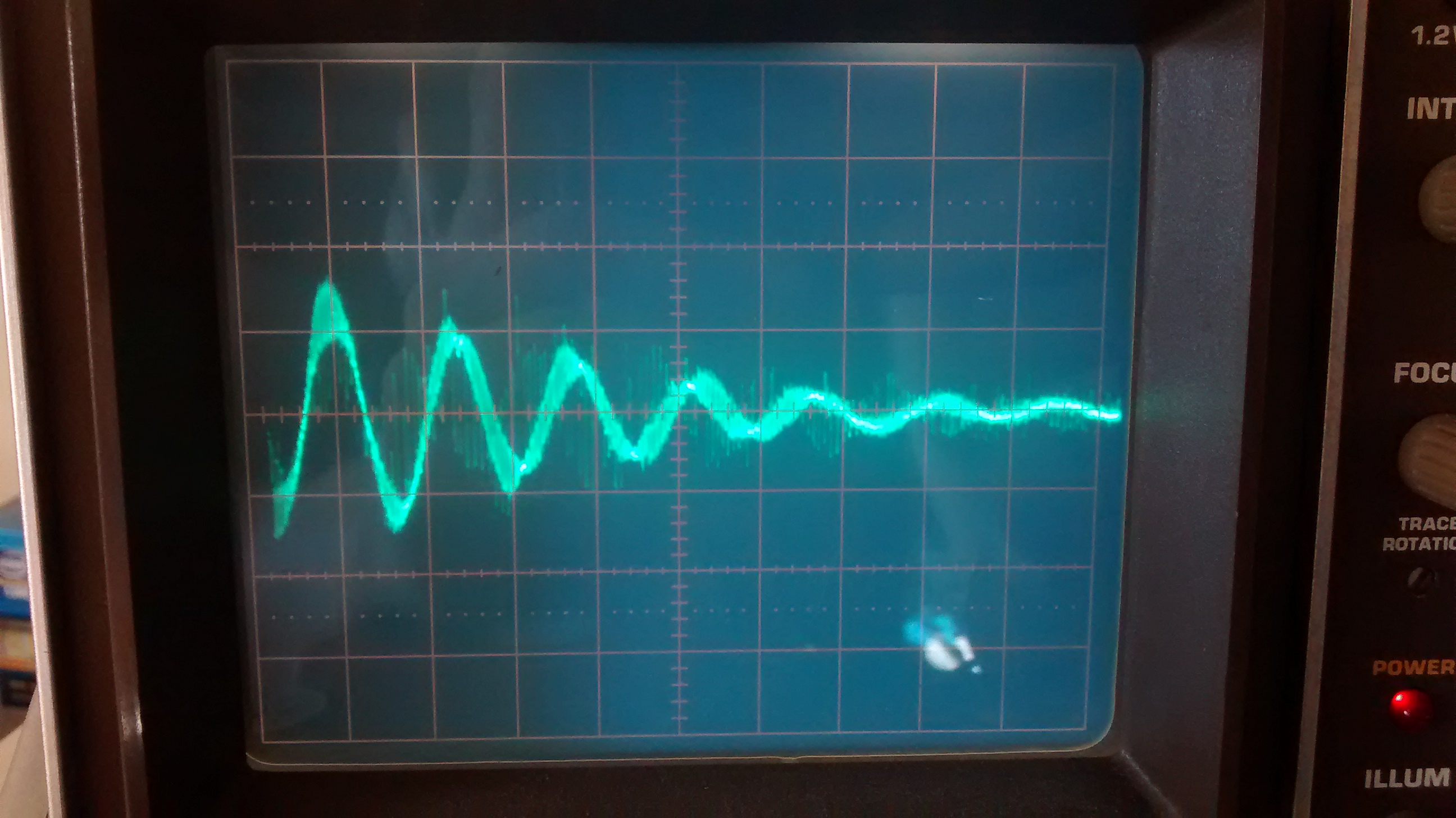

    Strangely enough, I can find the following pattern on every output (and also ground!, that's why it is weird) I place my probe to.
    These "oscillations" have a duration of about 2us and each one is visible 7.6us after the previous one. The maximum measured voltage is about 0.6V.
    Is all of this normal/has it something to do with the aforementioned issue?

    How are you probing? If you are using the long "antenna ground lead" as I like to call it that's your issue...
    Try to probe using the metal spring that comes with the probe (that you attach right at the end).
    Watch the following video: https://www.youtube.com/watch?v=Edel3eduRj4

      Yes, I was using the ground lead provided with the probe. As suggested from the video, by using a much shorter and more direct ground path I was able to remove much of this unwanted e.m. "noise".
      I also noticed that this "noise" is generated by the power supply. Indeed, when I shut it off the "noise" vanishes completely.

        Yes, this is a very common and easy mistake to make.
        The EM can also be created by things like dimmers for lights, cheap china LED lights, your dishwasher, etc etc etc etc ad infinitum
        This video is also a good thing to see on this subject: https://www.youtube.com/watch?v=BFLZm4LbzQU&t=

          Thank you for linking that video, it was of a great help.
          Coming back to the topic, I was finally able to see the waveforms of the outputs. I did not even bothered to measure the ripple, since it was very low (<50mV) and no overshoots could be seen on startup/shutdown of the power supply.
          It must be said that the issue is not showing on my testing setup. If no one has any suggestion, I think I will reassemble the unit, (externally) connect it to my PC and monitor the outputs before and after the issue.

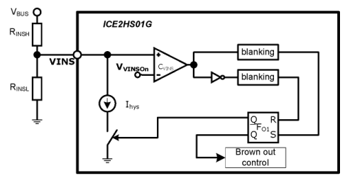

                Ok, I redrew the schematics used by the PSU to provide +12V to the output.
                The more complete schematic is available in the attachment.
                After some measurements, I finally found out the cause of this problem. Apparently, when the issue shows up, the pin "VINS" of ICE2HS01G is at 1.21V instead of 1.48V when the PSU has turned on. According to the datasheet, this IC requires a VINS voltage greater than VINSON (1.25V), otherwise it turns off and so the power supply.
                This voltage drop is due to the current generator inside the ICE chip that is connected on VINS pin in parallel to the resistive voltage divider (R501/R503):
                And this is verified by applying the superposition principle: VINS = VINS(Ih=0) + VINS(Vbus=0) = Vbus*R503/(R501+R503) - Ih*(R501//R503) = 1.44 - 0.23 = 1.21 (using Vbus = 7.48, when issue shows up).
                According to the datasheet and verified by my calculations, the purpose of this current generator is to add an hysteresis to the comparator.
                The datasheet provides two formulae to calculate the resistance of RinsH (R501) and RinsL (R503) when the two voltage levels Vbus(low) and Vbus(high) are known. Inverting these relations I could obtain that
                Vbus(low) = 6.476V
                Vbus(high) = 7.676V
                When the PSU doesn't start, Vbus = 7.48V, so the comparator output is not known, but since VINS = 1.21V, output must be 0: the ICE is off and so the PSU. This tells me that Vbus voltage must have been lower (for a short period of time) than Vbus(low).
                Actually, in the previous calculations using the superposition principle, I assumed Vbus was connected to a voltage generator. This is not really my case, since the real voltage generator (on the primary cap) is connected to Vbus through Q302. If I assume Q302 as a short and calculate the voltage on Vbus with and without the current generator Ih, I get
                Vbus(Ih = 0) = 7.706V
                Vbus(Ih /= 0) = 7.515V
                which may confirm that the current generator is decreasing Vbus voltage, causing the ICE chip to turn off.
                What's more, if I calculate them when the power supply is off (voltage on primary cap = 303V) I get:
                Vbus(Ih = 0) = 6.526V
                Vbus(Ih /= 0) = 6.335V
                which really approach Vbus(low) voltage, and may cause the IC to shut down.
                To sum up, my theory is that when I turn off the power supply, the voltage on the primary cap (303V) causes the ICE chip to shut down and the current generator to be connected. The latter causes a decrease of Vbus voltage which cannot be enough to turn the ICE chip on (higher than Vbus(high)) even when the primary cap is at its maximum voltage of 357.8V.
                Also, after some other measures I noticed voltage decreases on several points around VINS area. VCC is one of these and, as shown in the schematics, is generated by the standby IC, an ICE2QR4765. Again, I measured the voltage on its pins, but couldn't figure out if there's something wrong with that.
                Do you think the VCC voltage has something to do with Vbus and VINS?
                If not, I think I know how I could solve this, but I would like to know your opinion first.

                    So I decided to test my 'solution', which basically decreases the 'on' threshold voltage Vth(on) to be a little lower than the minimum Vbus voltage (which I have when the current generator inside the ICE chip is connected).
                    Requesting Vbus[min]>Vth(on) gives a numerical solution of R501 <(about) 120k.
                    I therefore placed a 100k resistor in place of the original 120k of R501. This, assuming 357.8V on the primary cap, gives the following theoritical voltages:
                    Vbus[max] = 6.983V
                    Vbus[min] = 6.783V
                    Vth(off) = 5.605V
                    Vth(on) = 6.605V
                    And as you can see Vbus[min] > Vth(on).
                    I've tested the PSU throughout two full days so far, and it seems to run good. I haven't tried to force VINS with an external power supply, but that must have been the problem. I'm actually pretty sure it was because even connecting a voltmeter (which has 10MOhm of resistance) caused the ICE chip (and PSU) to shutdown (the voltmeter's resistance decreased the total resistance to ground, and so the voltage on VINS pin).

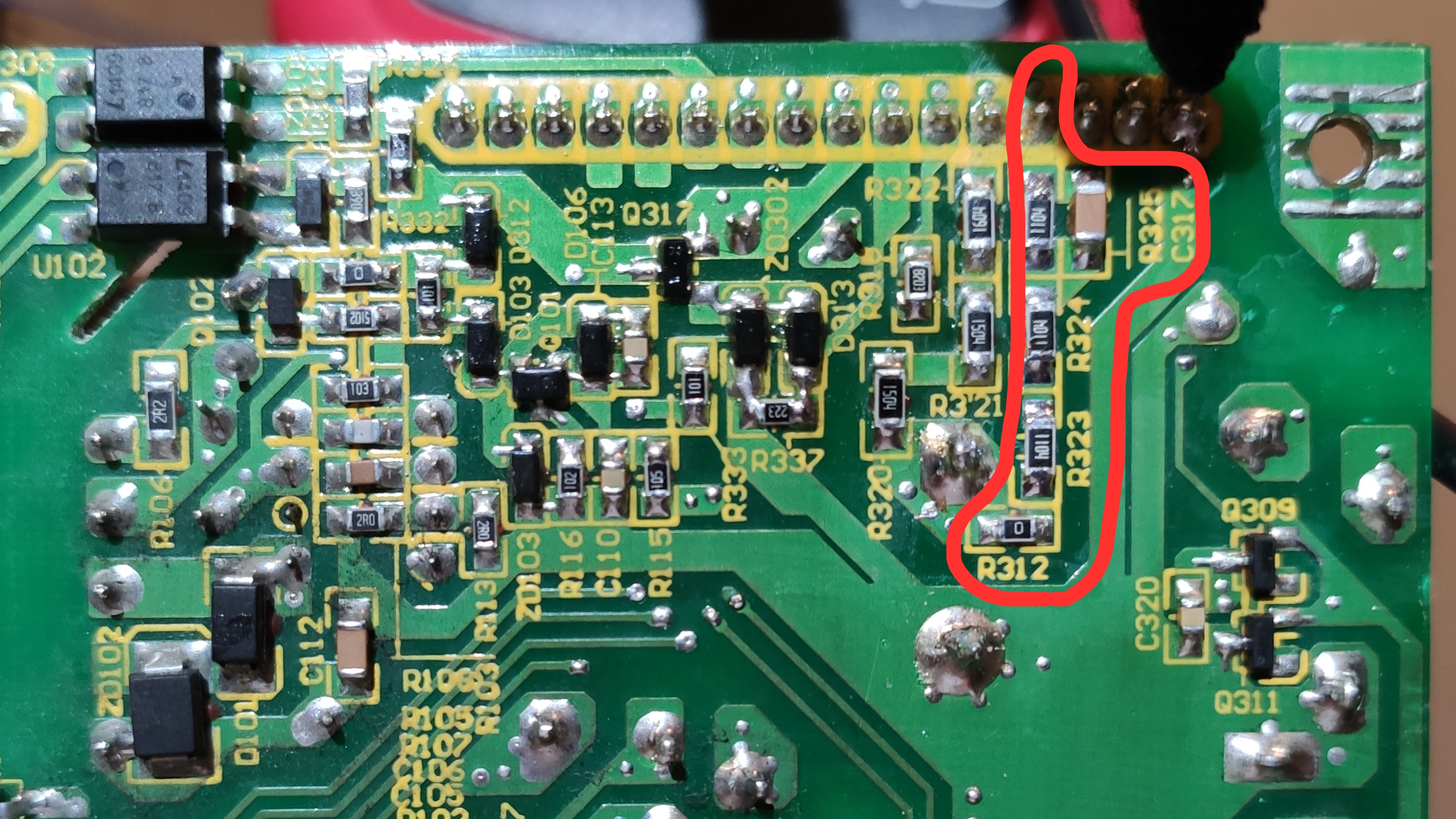

                            Just in case anyone else runs into the same issue and stumbles on this thread:
                            TL/DR
                            The actual root cause is a failed solder joint at the boost (PFC) controller's 1206-size voltage feedback resistors. Just resolder R312, R323..25 and C317 on the bottom of the main PCB, as well as pin #4 of the PFC&LLC controller board (pic attached) and profit!
                            Background
                            My experience was 100% same as OP's. One night I powered off my PC, the next day it refused to turn back on... most of the time... but sometimes it did. When performing measurements, I also received the same voltage values as OP did.
                            Analysis
                            OP did an excellent job reverse engineering the schematic of the unit, and tracing the cause of the malfunction back to the failure of the LLC controller's "mains voltage range" check.
                            However the failing self-check is not the root cause. By altering its configuration you are treating only the symptom, not the underlying problem, you are masking the issue instead of solving it. There is nothing wrong with how it is set up out-of-the-box: the hysteresis lower threshold is 300V, higher threshold is 365V by default. The problem is the bulk/bus voltage. (Just to be clear, I am referring to the output voltage of the PFC/boost converter stage - the one that you measure accross the terminals of the big el. cap. The voltage OP is referring to as Vbus, is not the actual bus voltage.)
                            Generically speaking, in APFC-equipped SMPS design, the bulk voltage is typically in the range of 380-400V DC. 356V is very suspiciously low. It is very unlikely to be the design voltage in any SMPS. In fact if you calculate the intended bulk voltage from the ref voltage and the resistive devider network on the Vsense pin, you'll find that the PFC in this model was intended to deliver ~392V DC.
                            OK... so we have a malfunctioning control loop. But what is the cause?
                            Why is Vbus so low? Is the controller struggling to increase it further but the high-voltage part of the circuit just can't deliver? Or is it not even trying as it thinks it is already at the specified level. Apparently the latter, as Vsense = Vref = 2.5V.
                            So we have a failed feedback. Something is off with the resistive divider. Or maybe Q301. So let's see: what may cause the voltage on Vsense to be higher than expected? Well, either the perceived resistance of R307 increased or the resistance of any of the others (R323..25) decreased. Let's measure them! Suprise: all values close enough to nominal. Hmm... WTF?
                            OK then... lets see how it behaves live, under load. Let's measure the voltages on each terminal of each resistor ->determine their individual voltage drops (the ratio of which is equivalent with the ratio of their resistance) -> determine the resistances which correspond to that ratio considering Vbus=356V and Vsense=2.5V. As it turns out it gives: R323=940k, R324=1085k, R325=920k. Hmm...interesting. R323 and 25 are way out of tolerance, while R324 is nominal-ish (1085k was the exact same value that the resistance measurement returned in the off-state).
                            Maybe I measured wrong? It's a possibility since the imput impedance of my DMM (10MOhm) is in the same magnitude as the total resistance of the divider. But fortunately, we are measuring a control loop here -> the voltage at the measured point will drop momentarily -> Vsense decreases well -> and the controller immediately compensates -> by boosting Vbus until Vsense reaches 2.5V again and thereby the point being measured reaches its original voltage. Confirmed by simulation.
                            So it's not the measurement. It's really the resistors. Or are they? Let's swap the good one with one of the faulty ones. Let's see if the voltage error follows! (Beware: all HV board areas are protected by a layer of conformal coating. You can remove it with some acetone. In addition, all components on the bottom side of the main PCB are glued to the board! Your best bet is to use a hot-air rework station and twist the components once the solder on their terminals melted - as the glue is unaffected by heat.) To be thorough, I desoldered and labelled all 3 resistors as well as C317, and in the meantime also reflowed the first few pins of the PFC/LLC controller board, just for good measure. OK... resistors swapped... power applyed... no smoke... so far so good. Let's take some measurements! Surprise #2: boost voltage is now 392V. Exactly as calculated. PSON signal HIGH -> wait a bit -> PSON signal LOW -> the PSU turns on instantly, Vbus=392V. Repeat x N -> all good.
                            Additional thoughts and observations
                            The LLC contoller's power is cut each time PSON goes inactive/high. Which also means that at each power-on attempt it starts with the hysteretic current generator activated. So in principle, every time to press the power button / set PSON=LOW, the LLC controller should be able to start up only when VINS>365V. But wait... If that's the case, how could it tun on on some lucky attempts at all, considering it was delivering Vbus=355-356V only?
                            The answer is: the startup transients. Each time you activate PSON and the PFC stage starts up, there is very short overshoot / transient overvoltage on the Vbus line. Which is completely normal. Whether the PSU manages to turn on or not only depends on whether this pulse is long enough and as high enough voltage (>365V) to trigger the hysteretic comparator on the VINS pin of the LLC IC. I've made lots of measurements using the peak detect feature of my DMM. Each time the PSU failed to start the peak of the pulse was below 365V and each time it started, it was above 380V. In my case "cold starting" (waiting for the big cap to loose charge before turn-on) tended to create larger pulses almost every time, while "hot starting" (i.e. only allowing marginal discharge of the bulk cap) resulted in smaller pulses (not enough to trigger VINS).
                            Conclusion
                            The PSU is working again. All pieces of the puzzle fell into their places. Except for one thing... I still cannot figure out how a solder joint can fail in such a way that the resistor it is applied to shows decreased resistances, and only in a live circuit. If you have any theories, please share, I am genuinely interested!
                            That's it. You can find my circuitjs models (of the feedback circuits) below, in case you want to experiment, confirm theories, etc. Good luck!

                              Update:
                              For the past 5 months, the PSU kept working fine. Until today. Same phenomenon.
                              Maybe some of the resistors (R323..325) are actually broken, and were temporarily fixed by the thermal shock from resoldering?
                              I replaced R323, 324, 325 and C317 this time. So far so good... PSU is starting up correctly again. Fingers crossed.
