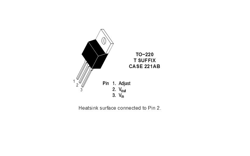

      f you relocate the LM317T, be careful, its metal tab is physically the same as the middle pin - output, so don't short it against something.
      what tab? its just a TO220 3 pin IC

        The TO-220 has three pins on one end and a metal thing sticking out the top (that has the hole in it). This tab is NOT isolated from the IC, it's connected to the middle pin, which is the output. If you screw this onto a grounded chassis, you'll short the output to GND. If it has its own isolated heatsink, that should be fine, just make sure it doesn't touch something that's not also connected to the output of the device.

          Here is a picture, I dont think there is any real need to heatsink the lm317 if you are using it with the 2n3055, The 2n3055 should have a proper heatsink as it handles most of the current
              Thank you for that info, I didn't realise that. Its OK though as I only attached the heatsink I used to the LM317T itself as fixing it to the circuit board would have been to awkward so it has no connection with the circuit board.
