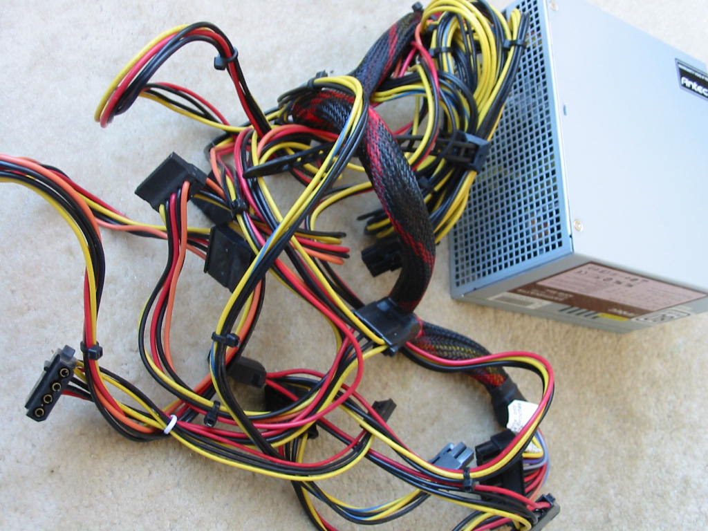

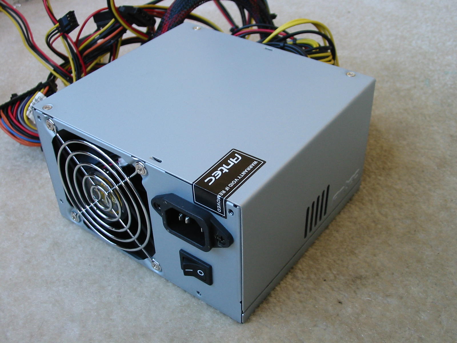

    Clearly this eBay seller cared about his/her computer stuff, as everything is in immaculate condition.
    Likewise, the PSU itself was just as clean.
    https://www.badcaps.net/forum/attach...1&d=1509061896
    All output wires are 18 AWG, 300V.

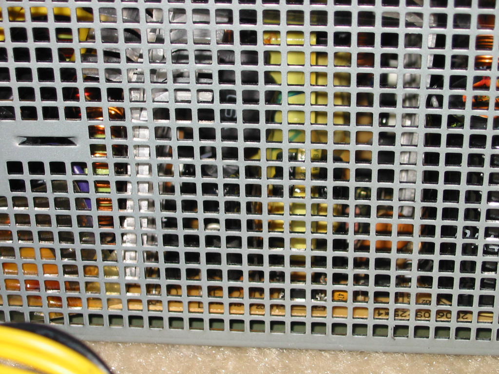

    But looks can be deceiving! Without even tearing it open, it was easy to spot this:
    Perhaps not so obvious on this picture, but right there I was able to see a bad cap. And that shouldn't be surprising - turns out bad caps are quite common for these PSUs. Actually, there are plenty of examples here on badcaps.net as well. For instance, below are two posts made by everell, where he shows the same EA-500 model as mine.

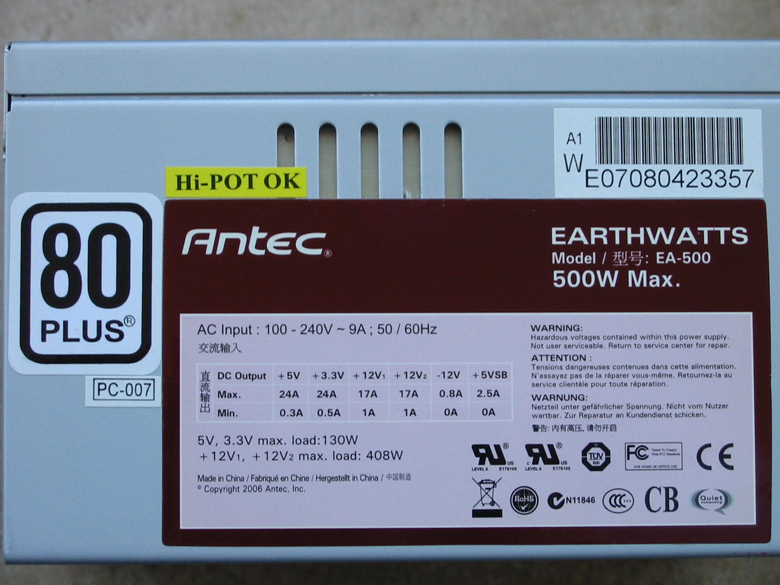

    Before I open it, let's have a look at the label.
    Nice and consistent labeling that looks just like on the review websites.

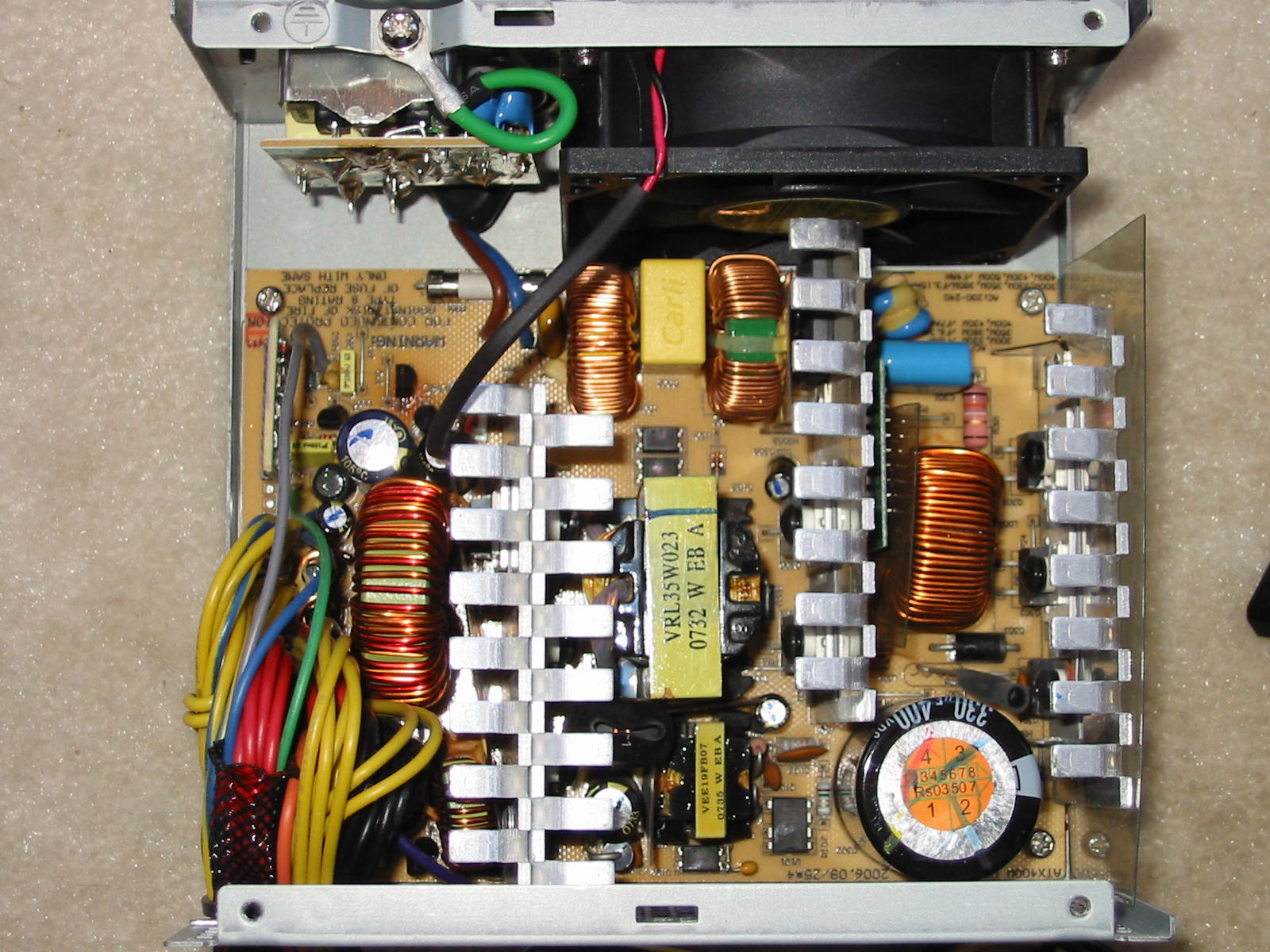

    And now we dig in…
    https://www.badcaps.net/forum/attach...1&d=1509062129

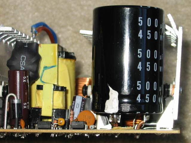

    … revealing another bulged cap. Other than that, I really like what I am seeing – nice open design with plenty of space for airflow, especially on the primary side. The secondary is a bit cramped, but not that bad and nowhere near as horrible as the Aspire PSU I posted about not too long ago.
    Here is a different angle to give an idea about the size of the components:

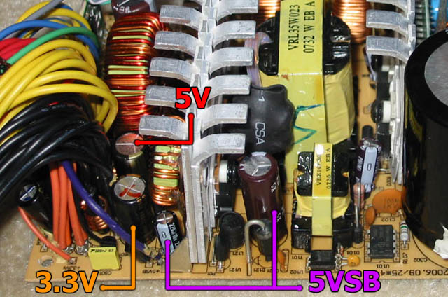

    Looks like the bad cap we saw through the front grille is filter output for the 5VSB circuit. No wonder the seller stated in the auction that the PSU is dead. At least this PSU has a ICE2A0565z PWM-FET offline IC for the 5VSB, which is good. What's not so good-looking is the hack job with that small cap soldered directly to the opto-coupler top-side pins. But it works, so I'm not worried. It just looks... eh…

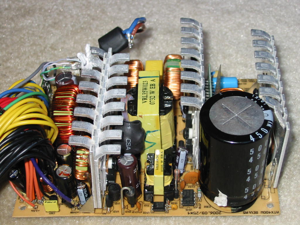

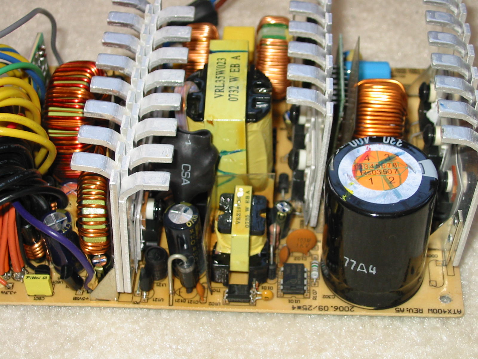

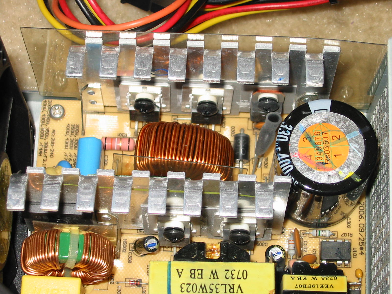

    Next, we observe the primary side:
    PFC silicone consists of two PV218N50 MOSFETs, a STTH8506d diode, and a 1N5406 bypass diode. The main PS section is double-forward, again with two PV218N50 MOSFETs. Main transformer has a 35 mm core and the 5VSB a 19 mm one.

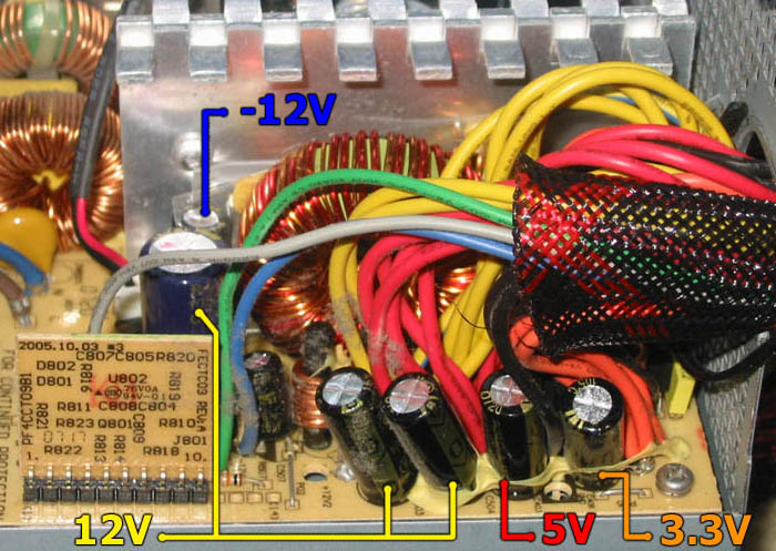

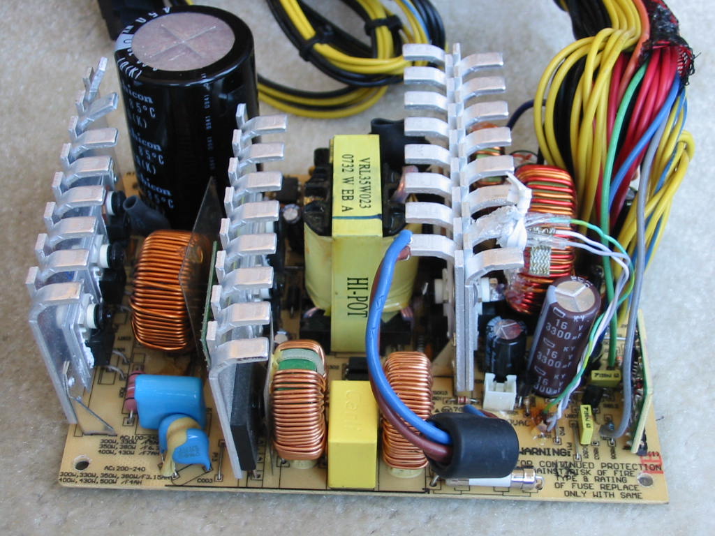

    Moving onto the secondary side:
    We see an exclusive OST-only party. And it looks like some of these “party-goers” had little more than a few drinks, as they are looking a bit “puffy”.
    Specifically, the 12V rail cap (OST RLX 16V, 3300 uF, 12.5 mm dia.) on the left is bulging, as is the skinny 8 mm OST RLS behind it (which is for the -12V rail.)
    It is interesting to note that this PSU also has a design from 2005, just like the Aspire I posted. BUT! Notice how much cleaner this PSU is. Clearly YoungYear has a long way to go before it catches up to the quality of Seasonic here (if they are even still making PSUs). Speaking of designs, this is Seasonic's S12II platform. PCB is labeled: ATX400W PCB rev 5.

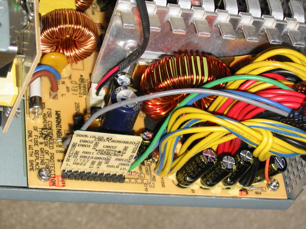

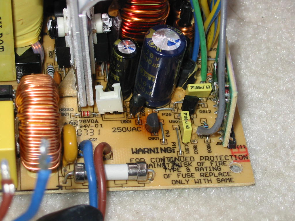

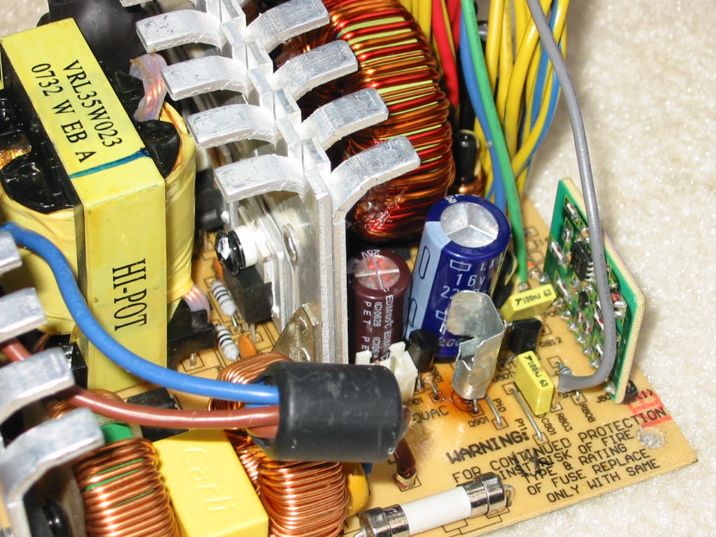

    Another short of the secondary, showing something that I don't like:
    That little TO-92 transistor with the scorched PCB around it is the drive transistor of the linear fan controller. It is a _______ transistor. Clearly, it is undersized for the 250 mA that the fan is rated for. Did that contribute to cooking these caps? I don't know, but I sure don't like it. In the picture you can also see the fan connector pulled out. I had some trouble disengaging that locking connector. What's worse: as I tried pushing the connector back in, I ended lifting up the traces on the solder side of the PCB. Lame!

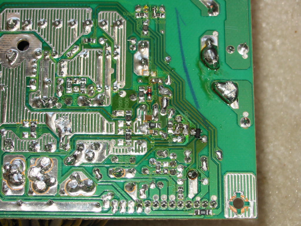

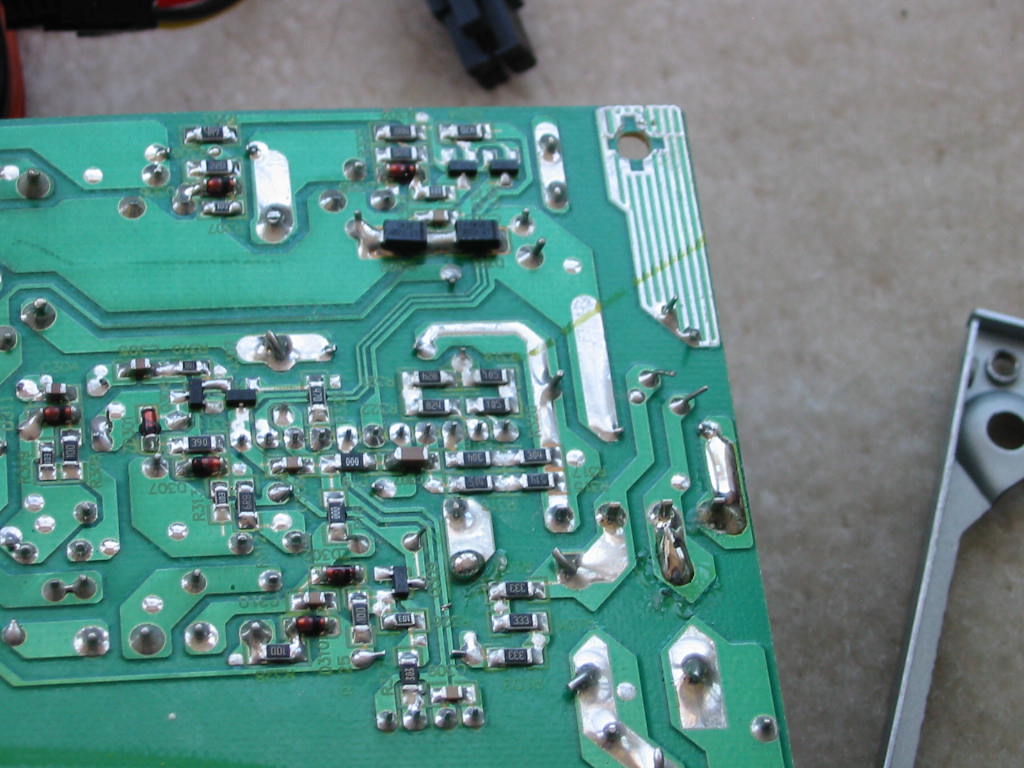

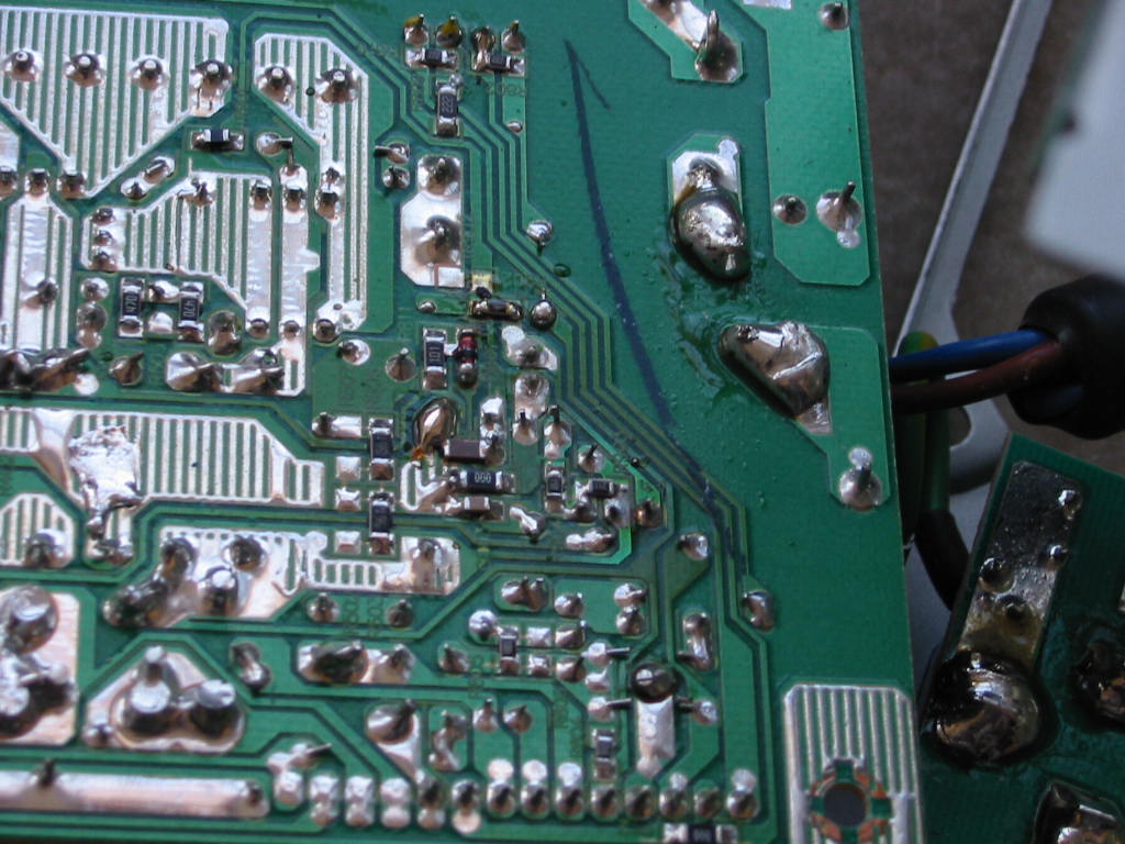

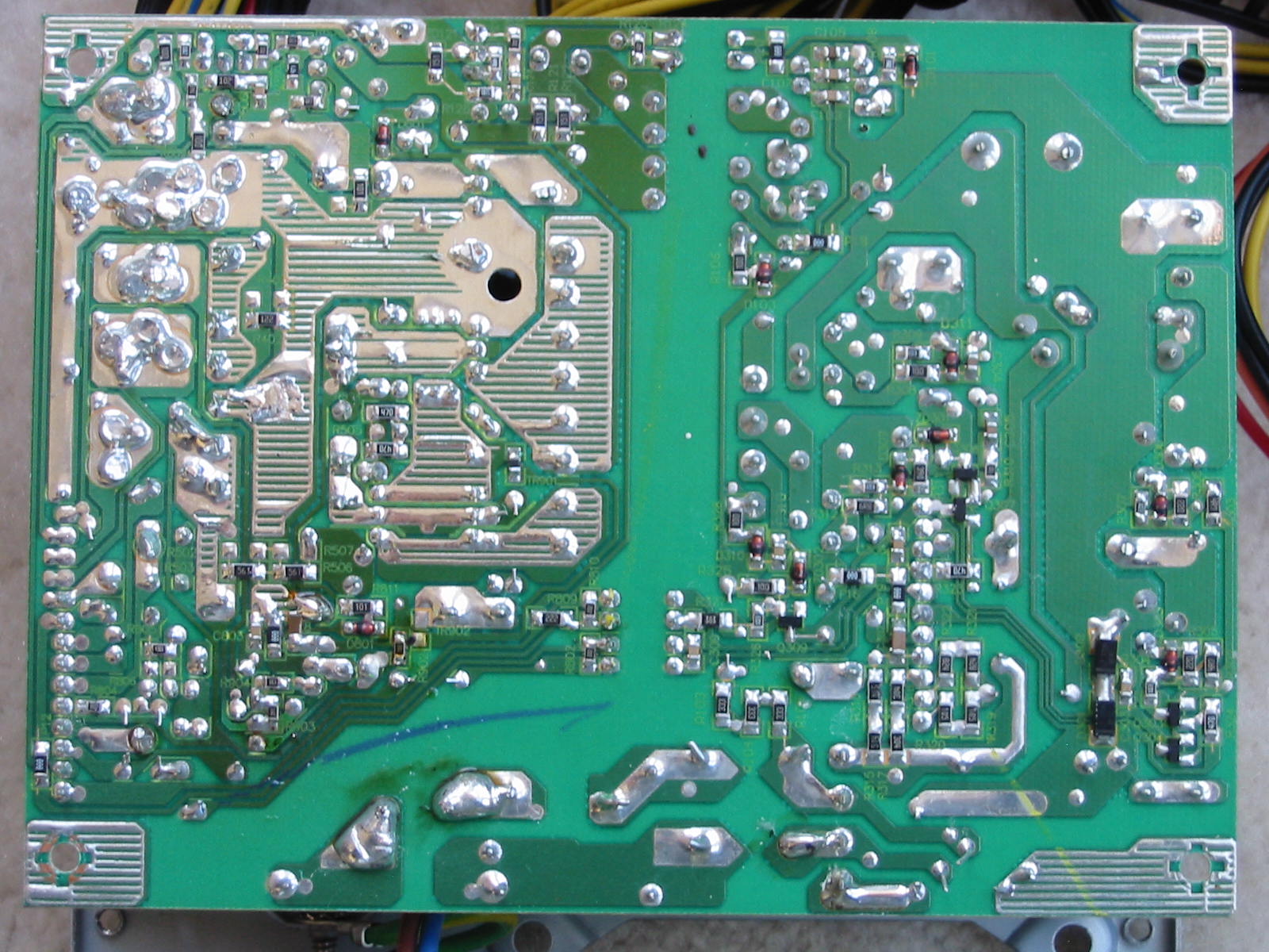

    Speaking of which, let's have a look at the solder side:
    It looks pretty good, except for the few hand-soldered blobs (mostly on the primary side.) Also, some of the component leads were not cut very well and protruded a bit more than I like to see. I actually managed to pierce the skin on my hand quite a few times because of that. But it wasn't as bad as the CWT-built Corsair CX750M and Thermaltake M850W PSUs I posted here – those actually make me want to cry every time I think about doing anything to them.
    Sharp eyes may have also noticed in the last picture above where I lifted the traces for the fan connector. Nothing got ripped out, though, so no major damage.

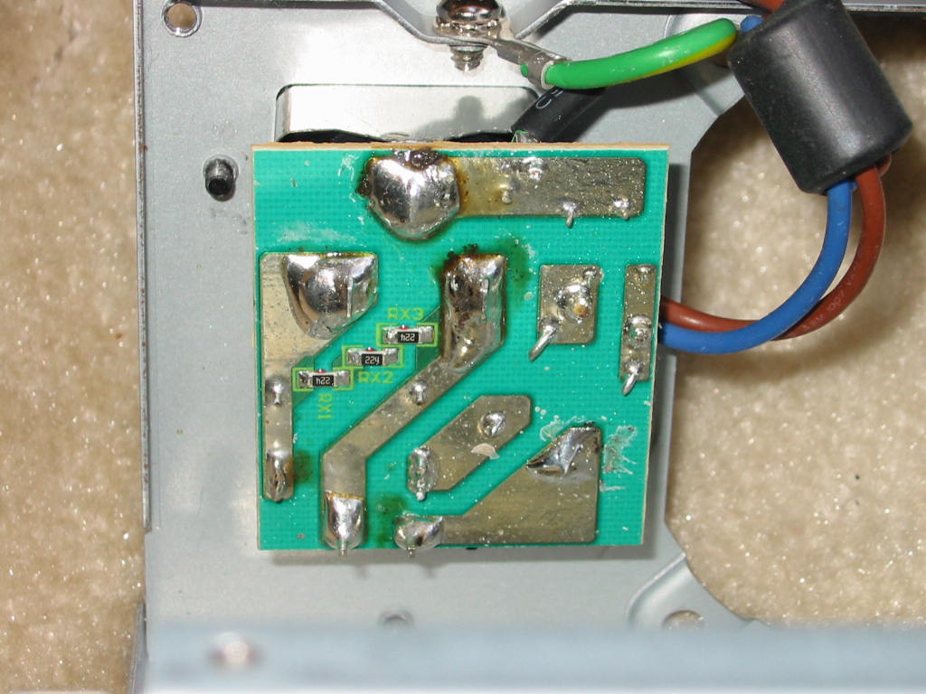

    While on the topic of PCBs, here is the receptacle filter board;

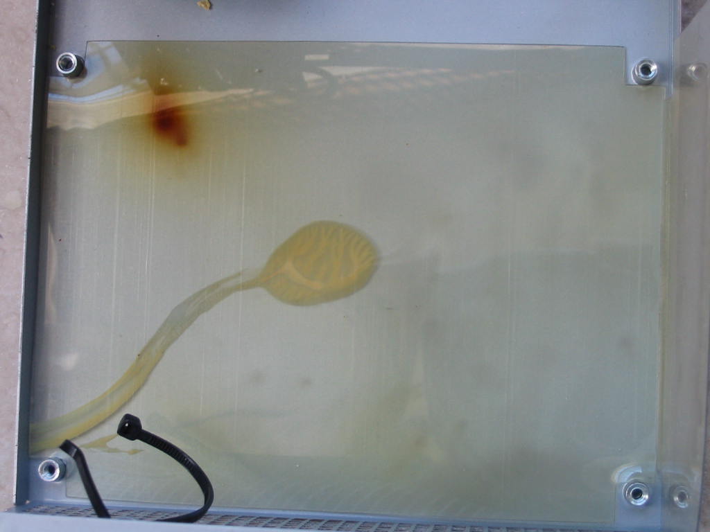

    And last but not least, I want to make a note of the plastic insulation sheets used in this power supply: they seem to be quite sensitive to heat and easily get darkened. Once that happens, they also become quite brittle. Here is a picture of the one under the PSU's PCB:
    Mmmm. Nice and crispy on the upper left corner. Coincidentally, this is where the fan controller's drive transistor is. Who would've thought.

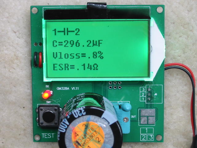

    - Main filter cap: one Hitachi HP3, 400V, 330 uF, 30 x 40 mm (dia. x h)

          Antec EarthWatts EA-500 – temporary recap and fan controller fix v1
          Originally posted by stj
          what the hell is Q901 doing that managed to cook the pcb with just a TO92 package??
          It's an H8050 NPN transistor for the fan controller, and it drops down the voltage to the fan in a linear fashion. That said, at about 20°C room temperature, the fan is fed about 4.20 Volts from the fan controller. It spins quietly, but pushes enough air. The problem is that the voltage drop across Q901 is then 12V - 4.20V = 7.8V minimum. I'm not sure how much current the fan draws at 4.2V, but it's probably around 100 mA, given that it is rated for 250 mA. At that current, Q901 would be dissipating about 0.78 Watts. It doesn't seem like much, but for a TO-92 transistor it is quite high. H8050 is rated for 1 Watt dissipation @ Ta = 25°C. As the fan controller increases the voltage to the fan with increasing temperature, the voltage across Q901 drops. However, the fan starts to draw more current. So I wouldn't be surprised if at higher voltages, that transistor is pushed right to its limit.
          I found a similar scenario recently in an old FPS power supply (FSP400-60PFN): same transistor and the fan was rated for 240 mA. When cold, the fan was driven with about 6.5V and drawing about 18 mA. Thus, the little transistor in that PSU was dissipating about 0.99 Watts - right at the edge of the allowable Pd in the datasheet! And of course, that transistor had a burned PCB all around it too. I'll post about that PSU another day... but yeah, this is quite common.

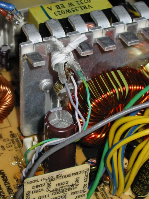

          As such here is my temporary/partial solution to the hot transistor in the Antec EA-500:
          https://www.badcaps.net/forum/attach...1&d=1509126932
          Basically, I added a little SOT-23 diode (look at the bottom right corner of the picture, the go slightly up, and you will see a SOT-23 device with one leg floating on the PCB) connected with its Anode to the 5V rail, and the Cathode connected to the fan output. This makes the fan receive about 4.5-4.6V after the voltage drop from the diode. As such, Q901 has to pass less current to the fan, and thus heats up a little less. It doesn't really make a difference when the fan controller increases the voltage going to the fan, but at least when the PSU is cold, Q901 can take a little break. Also, if Q901 fails open-circuit, the fan would continue to spin, as it will be supplied with power from the 5V rail.

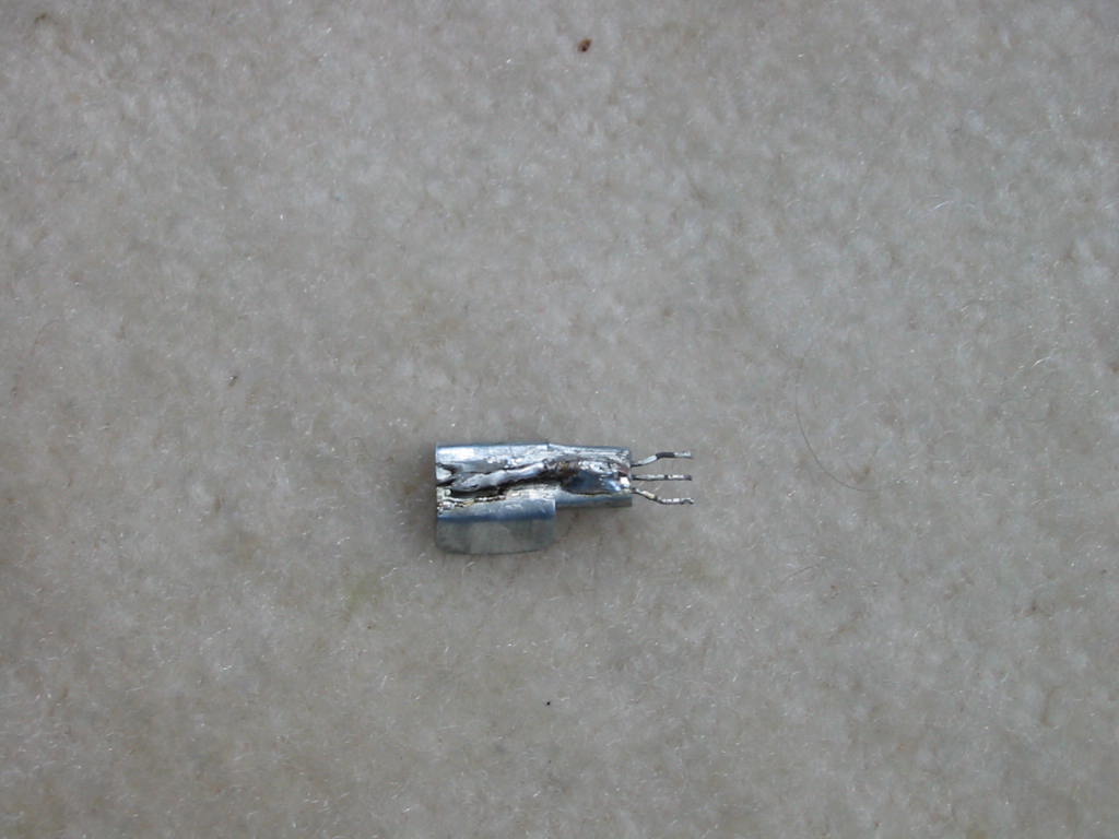

          And below is also a picture of what I did to (hopefully) dissipate the heat from the transistor a little better.
          Basically, made a heatsink made from steel sheet. It's probably not a very efficient heatsink, as steel sheet is a rather poor heat conductor compared to Aluminum, Copper, Brass, and Silver... but better than nothing, I figure. I also soldered a copper wire to the back of the steel sheet to help draw the heat away from the transistor and move it to the top of the steel sheet "fins".
          Here is a picture of this heatsink hack/mess installed in the PSU:
          I'll probably replace that whole transistor in the future with something beefier and maybe mount it on the secondary heatsink as well. But for now, this is passable.
          In the above picture, you can also see my temporary recap that I did to test the PSU. Basically, I replaced the bulging OST RLX 16V/3300u cap on the 12V rail with an old Chemicon LXZ 16V/2200u. Clearly, it's not quite a match in terms of ESR nor capacitance... but it beats a bulged OST any day.
          The cap to the left of it is an Elite ED series (25V/470u), pulled from a monitor that I recapped just in case. So the cap has healthy ESR and capacitance. I used it in place of the bulging OST RLS 16V/1000u cap that was filtering the -12V rail. Although the PCB is silk-screened for a 8 mm can, the lead-spacing is for a 10 mm cap (5 mm LS). So I figured if a 10 mm cap fits, I'll use that and not have to bend leads on an 8 mm cap to make it fit.
          Finally, and not visible in this picture - I replaced the bulging OST RLX 10V/3300u cap on the 5VSB output with a Nichicon HN 6.3V/2200u cap. Should be more than enough to keep the 5VSB circuit happy. Works fine as far as I can tell.
          With this arrangement, I even used the PSU to test an AMD Phenom X4 PC with a Radeon R9 290 GPU. I couldn't fully stress-test the R9 290 as it was faulty and kept crashing with artifacts... but that system drew up to 150 Watts from the wall and this PSU managed it fine. So I will properly recap it, as I said. I already have the caps for it too. Just have a few more projects I have to finish before it.

                                Antec EarthWatts EA-500 – final recap and mods
                                Time for an update on the EA-500.
                                Basically, I replaced my temporary test caps (the Chemicon LXZ and Elite ED on the 12V and -12V rails, respectively) with something more permanent. I also replaced the first cap in the 3.3V and 5V rails (2200 uF each) and changed the 5VSB caps. Finally, I did a few other mods. Pictures of the handiwork below:
                                https://www.badcaps.net/forum/attach...1&d=1549078446
                                Details on the recap and mods…
                                Starting with the 12V rail… it originally had 1x 3300 uF OST RLX cap and 2x 1000 uF OST RLS caps. I didn’t touch the OST RLS caps, as I didn’t quite have anything in stock (8 mm) to replace those. But the RLX was replaced with a Chemicon KY 16V, 3300 uF, 12.5 x 35 mm. I can’t say if that’s an ideal replacement or not, as the OST RLX datasheet does not list a 16V, 3300 uF cap at all. Going by its 12.5 x 25 mm size, though, this cap is likely to have anywhere from 14 to 21 mΩ ESR and 2780 to 3000 mA of RC (ripple current). Knowing that this is a 16V cap and doing some datasheet interpolation, its ESR is probably closer to 21 mΩ ESR and RC around 3000 mA. Thus, my Chemicon KY wasn’t too far behind in terms of ESR and RC specs, as it is rated for 20 mΩ and 2880 mA. It is a whole 10 mm taller, though.
                                Next, the first cap in the 3.3V and 5V rails: both had an OST RLX 10V, 2200 uF, 10 x 20 mm cap each. Again, this particular cap wasn’t in the OST datasheet. So going by size one more time, ESR should likely be around 20 mΩ and RC ~2500-2700 mA. Actually, note that the OST RLX datasheet lists a 10V, 2700 uF cap in 10 x 25 mm can size and that it is rated for 22 mΩ ESR… which doesn’t really make sense! (Why is the ESR increasing?) Either way, my replacement for the 3.3V rail 2200 uF cap was the Nichicon HZ 6.3V, 2200 uF cap that I used temporarily on the 5VSB (I moved it). ESR might not be ideal being so low (7 mΩ), but it’s a mag-amp regulated rail and thus it likely won’t care too much. (Not that the 5VSB did either.)
                                For the 5V rail, I used a Panasonic FM 6.3V, 2200 uF cap with 10x25 size. It is rated for 18 mΩ and 2470 mA, which I think is a pretty spot-on replacement for OST RLX – that is, if the OST RLX ratings are even legit.
                                And finally, the -12V rail: it had an OST RLS 16V, 1000 uF, 8 x 20 mm cap. According to its datasheet, this cap is rated for 23 mΩ ESR and 1820 mA RC. For its replacement, I used a Rubycon YXJ 16V, 1000 uF, 10 x 16 mm cap with 62 mΩ ESR and 1210 mA RC specs. Obviously, this is not an ideal replacement in terms of ESR. However, this is the -12V rail, which isn’t exactly stressed a lot. As for why I went with a 10 mm cap: the PCB lead spacing for that cap spot was 5 mm (which is what 10 mm caps use), so I didn’t feel like trying to find an 8 mm cap and then bending its leads.
                                Speaking of more non-ideal replacements, I decided to go with a Chemicon KY 10V, 2200 uF cap for the 5VSB rail in place of the bad OST RLX 10V, 3300 uF (which I had replaced temporarily for testing with the Nichicon HZ 10V, 2200 uF cap that is now on the 3.3V rail). Yes, neither the temporary Nichicon NZ nor this Chemicon KY are the right capacity (2200 uF vs. 3300 uF of the original OST RLX), but I’ve seen plenty of 5VSB circuits before (from trusted manufacturers like Delta and HiPro) with a similar cap setup. Also, the Chemicon KY is a bit “tougher” (less heat-sensitive) than the Nichicon HZ, so I figured it was better-suited for a circuit that is constantly running (and without active cooling some of the time.) That said, the 5VSB in this PSU had a second cap on its output after a PI coil: OST RLS 16V, 220 uF. I pulled this cap and checked it with my TT meter – it was starting to develop bad ESR. So I replaced it with a Nichicon HE 10V, 220 uF, 6.3 x 11 mm cap. Once again, that’s not quite to spec with OST RLS… but I think you got my drift already.
                                Anyways, the important question is: does that recap work? The answer is YES. Unfortunately, I don’t have a load tester and o-scope to stress the PSU to its maximum limits and measure ripple/noise. But I doubt the replacement caps I used would make that much of a difference to make ripple/noise out of spec at full load. Moreover, the PC I intend to build with this PSU probably won’t be loading it more than 300 Watts max - if even that (most of which will be on the 12V rail). So I don’t think there will be a problem with ripple.
                                As for mods… I’m sure many of you noticed the new big primary cap up there in the pictures. If you’re asking why I did that, the answer is, because I was curious if the old primary cap was good or not. Sure primary caps don’t fail that often. But after my findings with my ThermalTake M850W and the Enermax Pro 82+ EPR525AWT (both of which had blown/bad 400V primary caps), I decided it wouldn’t hurt to pull the primary cap from this PSU (Hitachi HP3, 400V, 330 uF, 30 x 40 mm) and check it. According to my TT/ESR meter, it was showing about 0.33 Ohms ESR. Upon a second more recent check, though, it shows 0.14 Ohms ESR and slightly low capacitance (but still in spec):
                                I don’t know if this is considered okay or not for a big cap like that. IIRC, most other caps of this size typically measured lower ESR. Thus, I changed it to be sure.
                                The replacement I used for the primary cap is a Nichicon LQ, 450V, 500 uF “behemoth”. As you can see, it’s quite a bit bigger. However, this PSU uses a rear 80 mm exhaust fan and not a top 120/140 mm fan. Therefore, having a taller cap wasn’t an issue at all, unlike in the Thermatake M850W. The cap lead spacing was an issue, though. So I had to do a bit of “ugly work” to get it to fit “right”:
                                Basically, I soldered two pieces of solid 14 AWG copper wire to the leads of the cap and then ran the wires through the holes/vias. It’s shady work, yes, but it will hold. I didn’t have much of a choice either - even if the cap had the right lead spacing, I still couldn’t make it fit, because both primary heatsinks have metal stand-offs in the corners near the cap. Thus, raising the cap like this was necessary either way.
                                So what did I gain from this mod? TBH, I don’t know. However, all I can tell you is that after my first (temporary) recap, I noticed that the PSU would sometimes emit weird noises from the primary side that would change with the load. Doing a bit of research online suggested this is somewhat common on cheaper/ lower-tier PSUs with APFC. After changing the primary cap for the Nichicon LQ, all of the noises have disappeared. Does this mean another APFC disaster averted? – Who knows. I suppose, time will tell. (Personally, I’m inclined to say yes, because as I showed in the Enermax thread, the APFC controller won’t necessarily do anything if the APFC voltage overshoots above 400V for a few moments – possibly during load transitions.)
                                Another “ugly” mod I did… remember the overheated fan controller transistor and the metal heatsink I made for it? Well, I decided to change that mod when I came up with this:
                                Essentially, it is the H8050 transistor mounted on the secondary heatsink with some wire ties and hot glue (because I wasn’t sure if the wire ties would move with time.) Being a “test mod”, I didn’t put too much (any!) effort into the looks – hence, the Ethernet/phone wires used to connect it back to the PCB. Some of you might also have noticed a piece of used Copper braid attached to the middle wire. Well, since this wire goes to the Collector of the transistor, and since most non-tabbed BJTs are designed to cool through the Collector pin, I thought why not add a bit of extra cooling there as well. (Moreover, I wasn’t sure if the case mold of the TO-92 transistor would provide good enough heat transfer to the heatsink alone.)
                                To test this mod, I connected the 12V rail of the PSU to a 12V power adapter, essentially making the fan and its controller run. I ran it for about 30 minutes. The secondary side heatsink near where I had attached the transistor became only slightly warmer than room temperature, as did the Copper braid on the Collector pin. Thus, it looks like that transistor is finally running cool now.
                                Well… that concludes all the work I’m going to do on this PSU for now. There are still some OST RLS caps remaining on the outputs of the 3.3V, 5V, and 12V rails. But with the good caps in there too, I don’t think they will see much stress or fail. So for now, I consider this PSU done. Next stop would be recapping the Earthwatts EA-430, which I’ll probably do the same exact way. But we will see, of course, as I constantly have new “ideas”. So who knows what crazy/ugly mods I will come up with next?

                                      Here is a cap diagram of all the output rails:
                                      It is applicable to both Antec EA-430 and EA-500 models.
                                      You should change all of the output capacitors in the PSU (the ones I pointed to above), along with all of the small electrolytics as well. The big cap doesn't need to be changed. I just did it anyways, because I already had a bigger and better cap.
                                      Unfortunately, I didn't make a cap list, as I used whatever caps I had in stock (hence the mix/mismatch in capacity and size mentioned in post #16).
                                      But going by the parts summary I made in Post #1 above, here is one example list of all the caps you will need for the output rails:
                                      2x 6.3V or 10V, 2200 uF, 10 mm diameter, 5 mm LS (lead spacing)
                                      2x 6.3V or 10V, 1000 uF, 8 mm diameter, 3.5 mm LS
                                      1x 16V, 3300 uF, 10 mm or 12.5mm diameter, 5 mm LS
                                      2x 16V, 1000 uF, 8 mm diameter, 3.5 mm LS
                                      1x 16V, 1000 uF, 8 mm or 10 mm diameter, 3.5 mm or 5 mm LS (can be same as above 16V/1000 uF caps)
                                      1x 6.3V or 10V, 2200 uF or 2700 uF or 3300 uF, 10 mm diameter, 5 mm LS
                                      1x 6.3V or 10V, 220 uF or 330 uF, 6.3 mm diameter (note: possible height restriction)
                                      For ESR and ripple current requirements, see post #16 above, which details what replacements I used and what other ones are possible.
                                      And for the small electrolytic caps, you will need the following:
                                      1x 50V, 47 uF, 5 mm or 6.3 mm diameter
                                      1x 50V, 22 uF, 5 mm or 6.3 mm diameter
                                      Hope that clears it up. Let me know if not.
