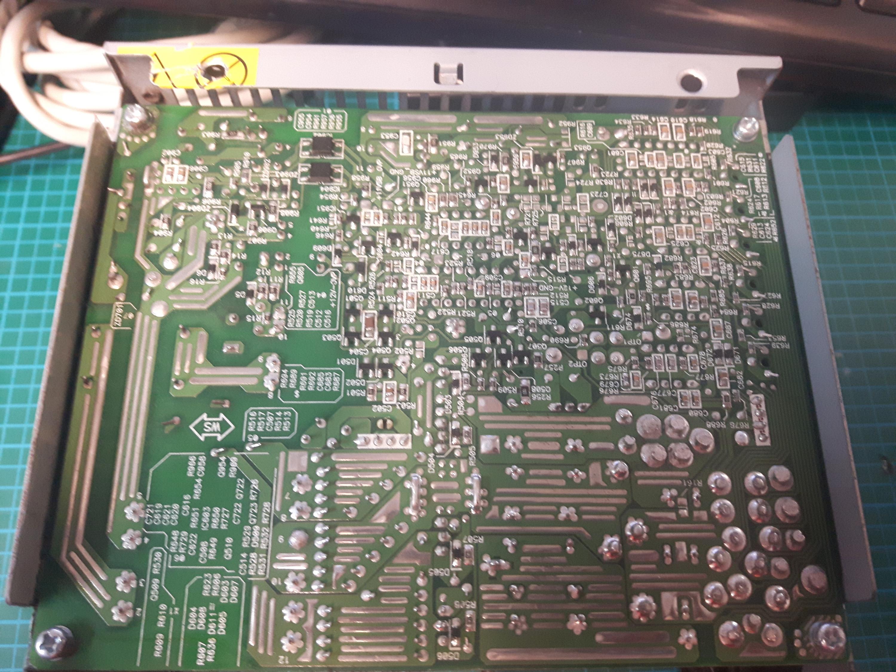

    Hello, my Z420 enter a loop when i try to turn it spin the fans then click and start over in a loop.
    I heated the power supply with a air dryer and it started and working perfectly.
    I think that maybe its only a small startup capacitor that need to be replaced.
    What information or pictures are needed to get your help?

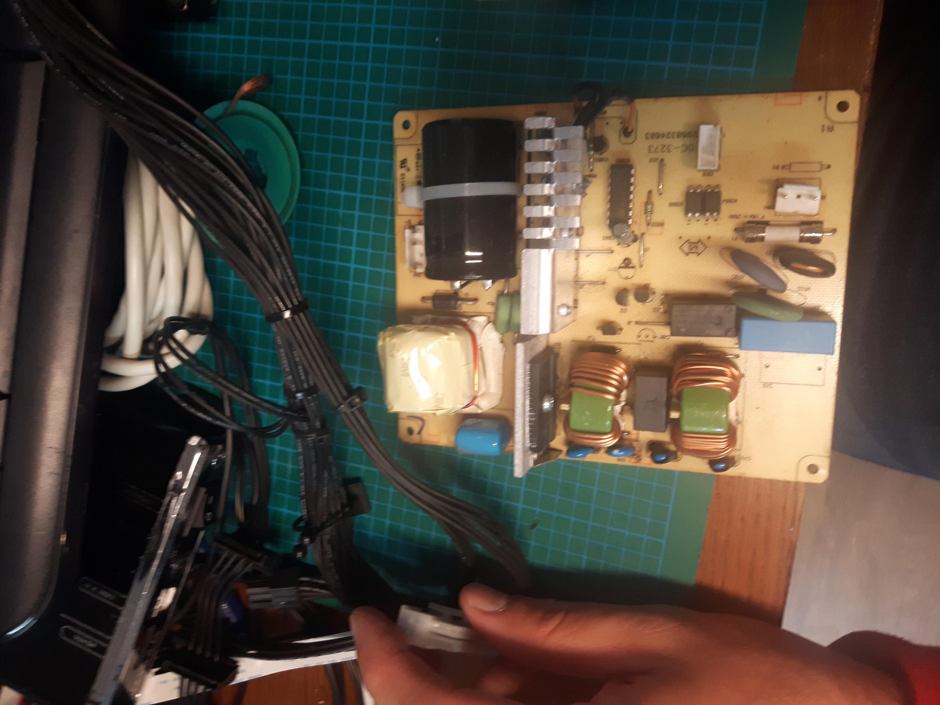

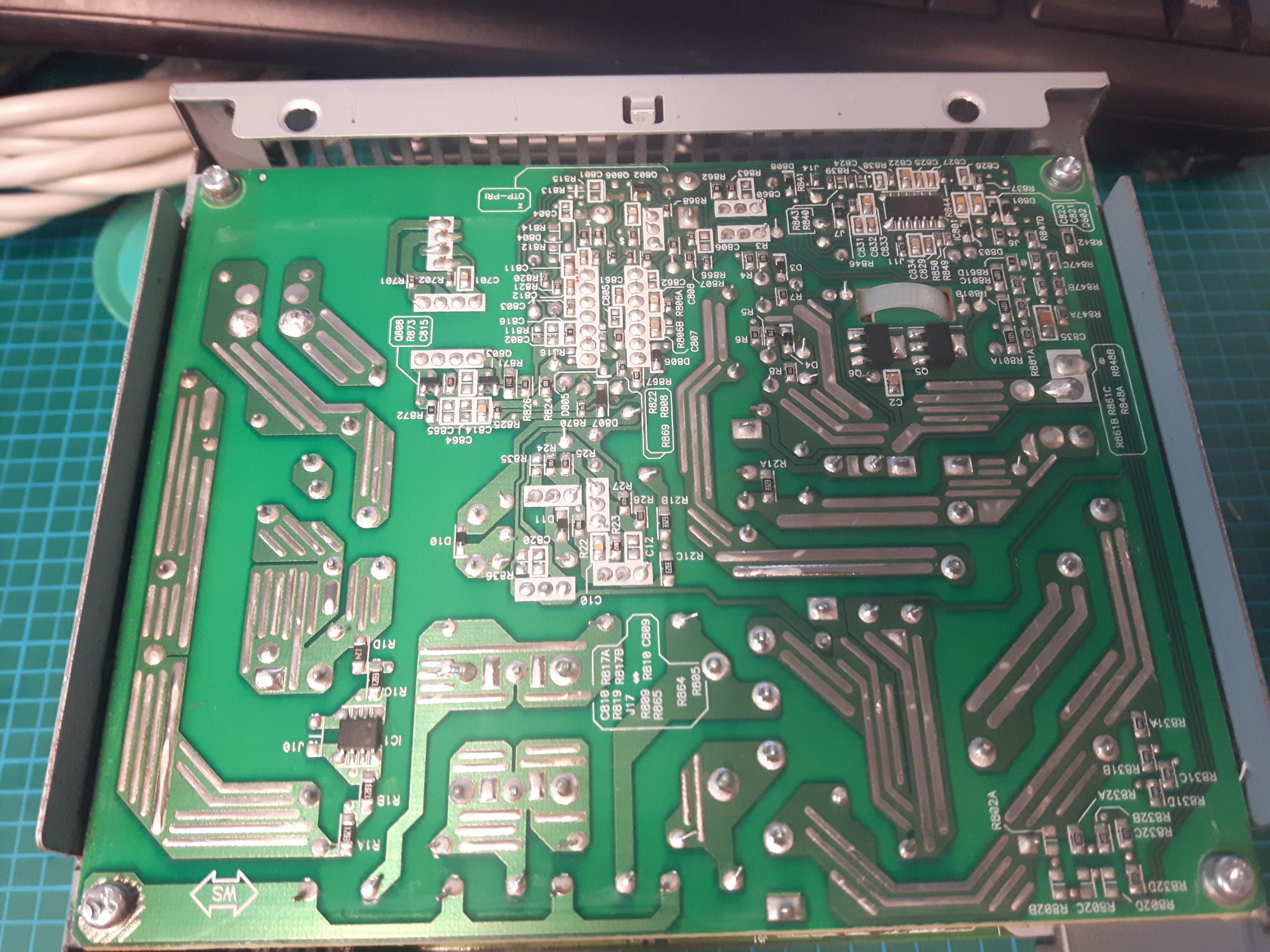

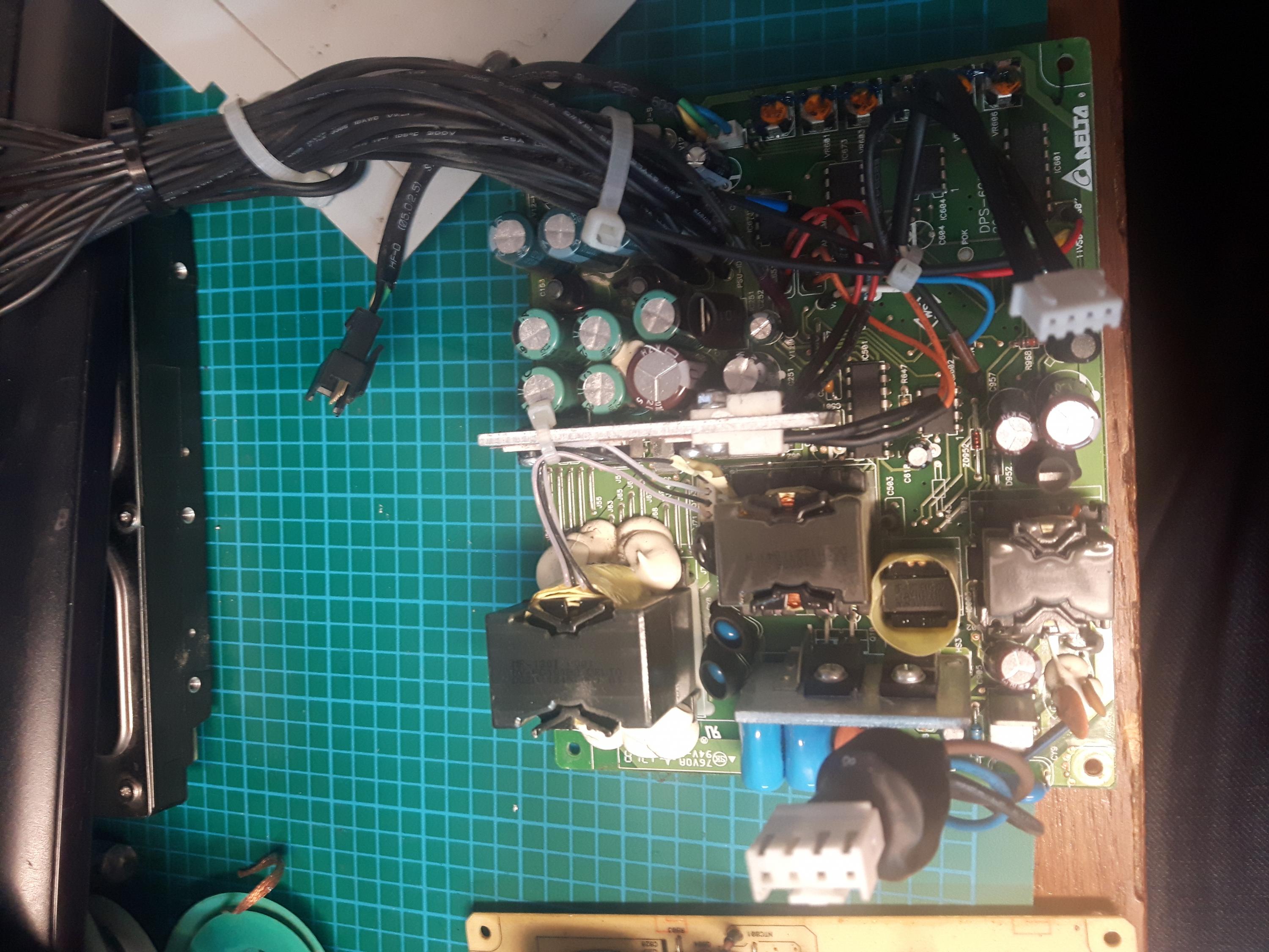

    here are somes picture. i see a cheap capacitor near the lm339an maube its just this one?

        can it be the small cap near the supervisor IC??

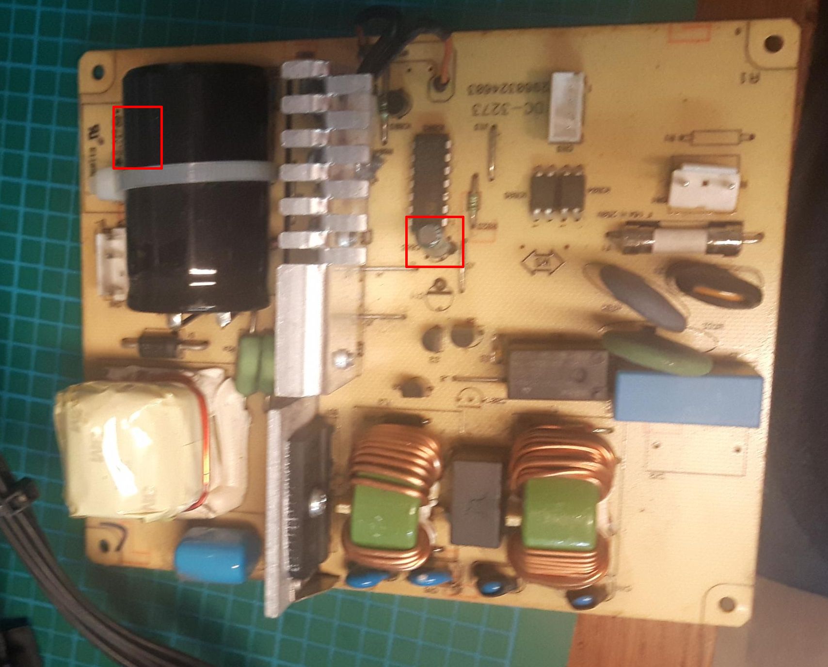

                                  Hey pr0cess0r,
                                  Are you still around? Which cap specifically did you replace?
                                  I have a supply doing the same thing. I reheated a few joints on the primary board. A couple of the green Taicon caps measured ok out of the primary board so I put them back in as I didn't have replacements. Supply did work for a bit but then after a short power down, went back to the cycling problem. So I think in general the supply is OK i.e. not a dead switcher or anything major.
                                  Since removing/replacing the two on the primary board seemed to help temporarily (even though the seem good) I tried replacing with new 105C low ESR caps but no go.
                                  I replaced the 10uF/25V almost underneath the large DC cap. and the 10uF/50V near the 16 pin IC (I think it's an LM3xx quad opamp). Sorry don't have the designators as it's screwed back together at the moment but I marked the ones I replaced on your picture.
                                  Was it one of these you replaced?

                                      I replaced the small caps on the primary board (same as Shonky) and the small 10ยต/50V on what I think is the the primary side of the tranformers on the second board.
