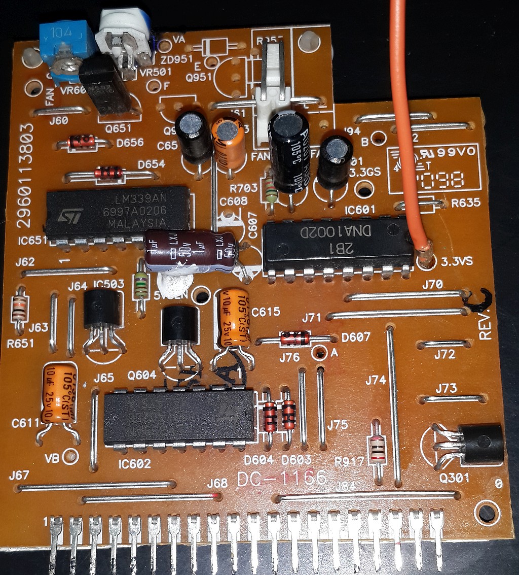

    I'm troubleshooting this delta DPS 320 EB. Problem : PG Signal is at 0V. Leaky capacitor has all been replaced and could not help to think that the problem lies in the DNA1002 chip which from what I read is a custom IC by delta.

    Measurement on DNA1002 pin shows similar number like the one on the simonwyss website, except pin 3 (PG : 0v expected 5v), pin 8 (Unknown : 2.6-2.7v expected 4.25v), pin 9 (5Vin : 5.15) pin 10 (12Vin : 11.7V), pin 14 (unknown : 2.6v expected 2.7v). Expected value is based on symonwyss number. All other pin are pretty much spot on with his measurement.

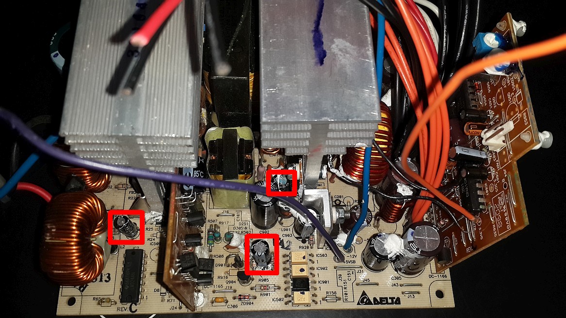

        Picture of the PSU. Replaced capacitor is highlighted with red square. Additional note : This is PSU for B2600 HP Workstation, after replacing these bad capacitor workstation boots up and running for 3 days straight without issue. I also have a second workstation that I have replaced it with normal ATX power supply (swapping the pin around to match B2600 pin) and that is also running fine.
        Next plan is to blindly replace every single electrolytic cap for both secondary and primary side to see if that brings the PG signal back on ( saw other thread reply encountering same issue on different psu ). Just that it doesn't make sense to me as output signal shows good ripple in the scope...
        Few other additional note :
        I can hear a faint tweet tweet tweet sounds roughly about 1 or 2 in a second that changes slightly depending on the load I introduced in the 12v or 5v output. Couldn't really pin point where it is coming from... I don't really have the guts to put my ear too close to a live PSU... who knows when those cap or transistor decide to blow themself up.
        Adding a 12v100W halogen lamp load on the 3.3V line will make the PSU refuse to turn on ( a mere 7.5W load at 3.3V?), adding these load when PSU is running doesn't cause any issue.

          Re: Delta DPS 320 EB missing power good signal
          Originally posted by ultrasmurf
          Bad capacitor are mostly on the control path and bypass cap for the IC. 47uf and 4.7uf type.
          As I thought.
          These small caps can cause lots of issues like this.
          It's probably the small caps if loss of PG signal is all there is wrong with the PSU.
          Don't just replace blindly - replace blindly every little capacitor. The big ones, not that important for now (if ripple is within spec).
          That said, try to use good quality low ESR capacitors rated for PSU use (and 105C). Don't use 85C general purpose stuff - that's no good, and you will be doing this recap again in the near future, because they won't last long in there.
          Halogen lamps have a very low resistance when cold - almost like a short-circuit. With the lamp connected before the PSU is turned ON, the PSU has to supply a large surge current to the halogen lamp and also its own output capacitors. This alone can be enough to trip the short-circuit, over-current, or under-voltage protections. Once the PSU is running and the output caps are charged up, they can provide that large surge current when the halogen lamp is cold, so that's why the PSU doesn't shut down once it's running.
