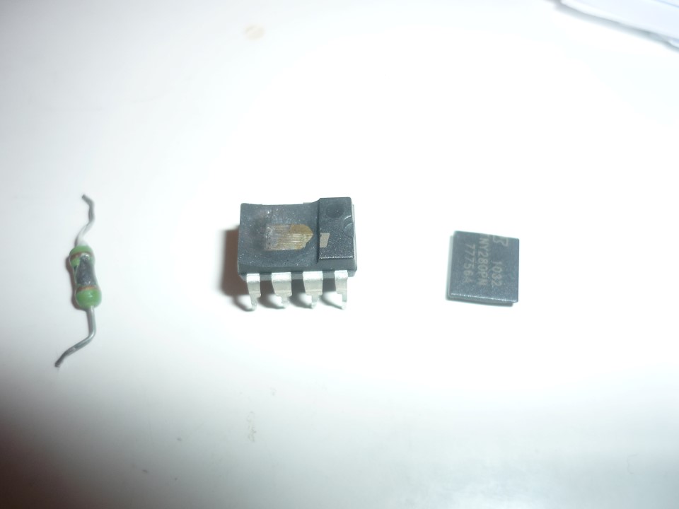

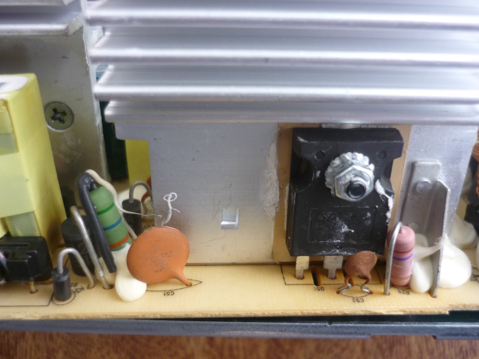

    I've been asked to look at one of these that was dead.
    On opening I've found that R21 (1R) was burnt and open cct and IC21 had exploded (TNY280).
    The snubber cap (C25) is original and will need upgrading to a 2KV one, as has been suggested by others.
    All the main FETs and diodes appear to be OK as does the SMD components. I'm unable to find a schematic for this model to delve any deeper at present. I've removed the high voltage cap and it measures 130uF instead of 150uF although it's ESR is still very low. No bulging or leaking caps are evident but that's no guarantee they are OK of course.
    I'm probably going to re-cap it anyway to get rid of all those 'elite' caps.
    Does anyone have a schematic so I can investigate why IC21 blew up. I'm not comfortable just swapping parts and crossing fingers.
    Cheers
    Bob

                • midibob
                  • Nov 2008
                  • 285

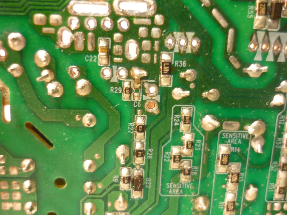

                  Re: Dell PSU H240AS
                  Well, the plot thickens.
                  Firstly I noticed this...
                  C6 isn't on it's pads. Is this a mod or has it slipped during soldering?
                  I'm still trying to draw the cct out but it looks like this is on the feedback cct from the opto.
                  Also I've come a cross a thread about TNY280's failing for no reason in large numbers.
                  https://ac-dc.power.com/forum/low-po...4/tny-problem/
                  Those two horrible words are cropping up again together ie conterfeit and China. Let's hope not.

                      Time for an update on this one.
                      Once the TNY280 was replaced along with it's series flameproof resistor and rebuilt, power was applied via a 40W bulb. The bulb would pulse bright and dim but the PSU wouldn't stay running. At least it looked like nothing was going to blow up. Replacing the bulb with a 100W bulb and it then ran OK with all output voltages correct.
                      With full power applied everything looked good and it powerd the PC up OK. I'll let it run for a while to make sure it's stable but it's a mystery why the chip exploded?
                      I've now got another 3 to look at so it'll be interesting to see if it's the same issue.

                          I wonder if it's the snubber network causing this. Try different loads on the 5VSB. If it blows up again, the snubber definitely might have something to do with that.
                          • midibob
                            • Nov 2008
                            • 285
                            Re: Dell PSU H240AS
                            I have changed out the 1kv cap on the snubber for a 2kv as suggested in other threads so we'll see what happens after it's been running for a while.
                            The next one on the bench also had the 1R resistor burnt and although the TNY280 hadn't exploded this time it was measuring about 900 Ohms across most of the pins.
                            With a new resistor and IC it fired up and again appears to run OK. The snubber cap was upgraded too.
                            The last one was different and this fired up but shutdown approx 7 secs later? The series lamp also glowed slightly with no load whereas the other two didn't. Could be something on the secondary side that's going amiss so further investigation is needed. All the secondary voltages do appear to be correct though?

                              Re: Dell PSU H240AS
                              Sounds like something is eating power when it shouldn't.
                              I'd check the snubber diode first. If it is shorted, it will conduct both during the TNY IC's On and Off cycles, which can in turn make the TNY IC overheat and go into thermal shutdown protection.
                                • 31161
                                Re: Dell PSU H240AS
                                check ceramic caps too.
