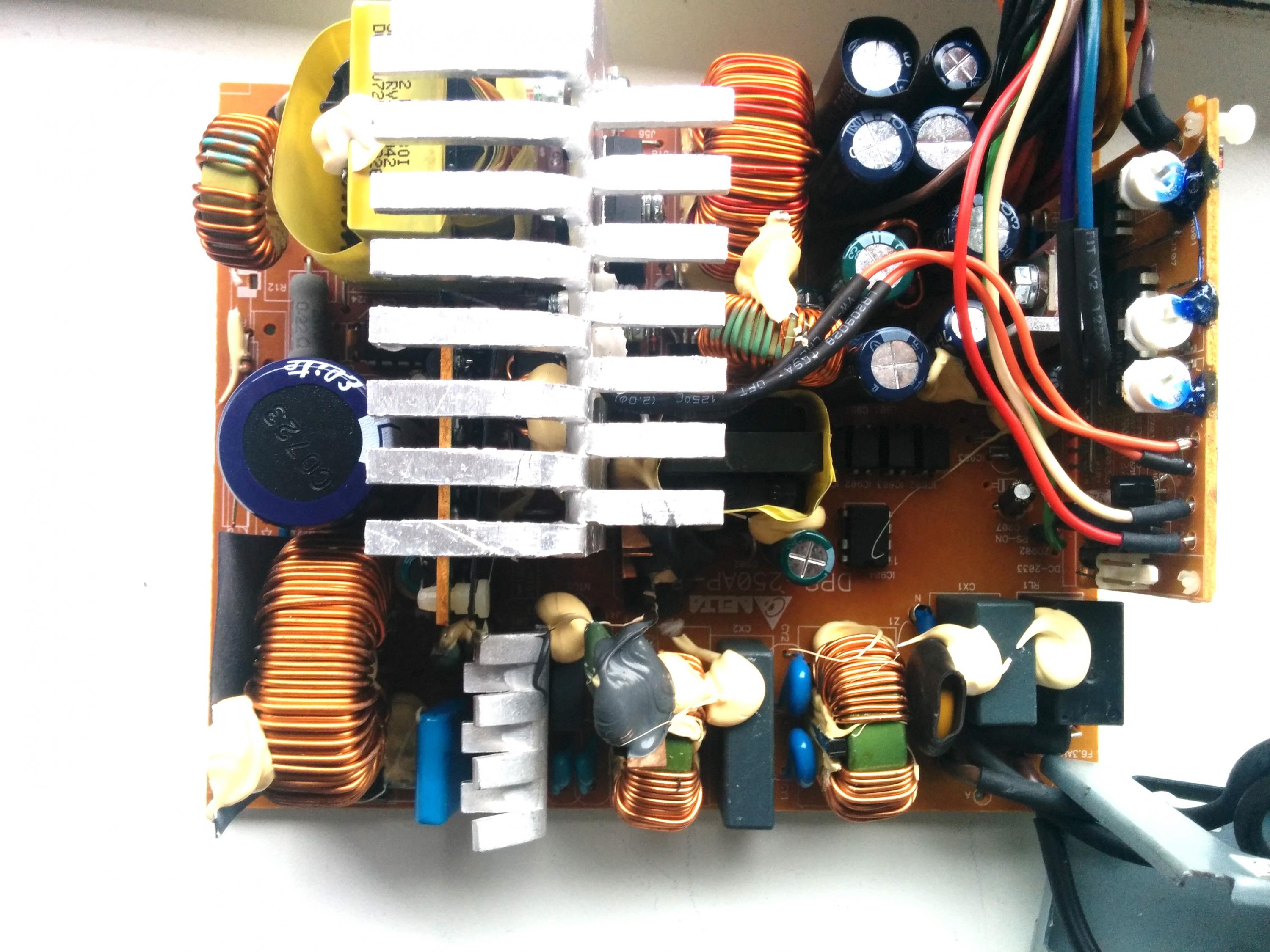

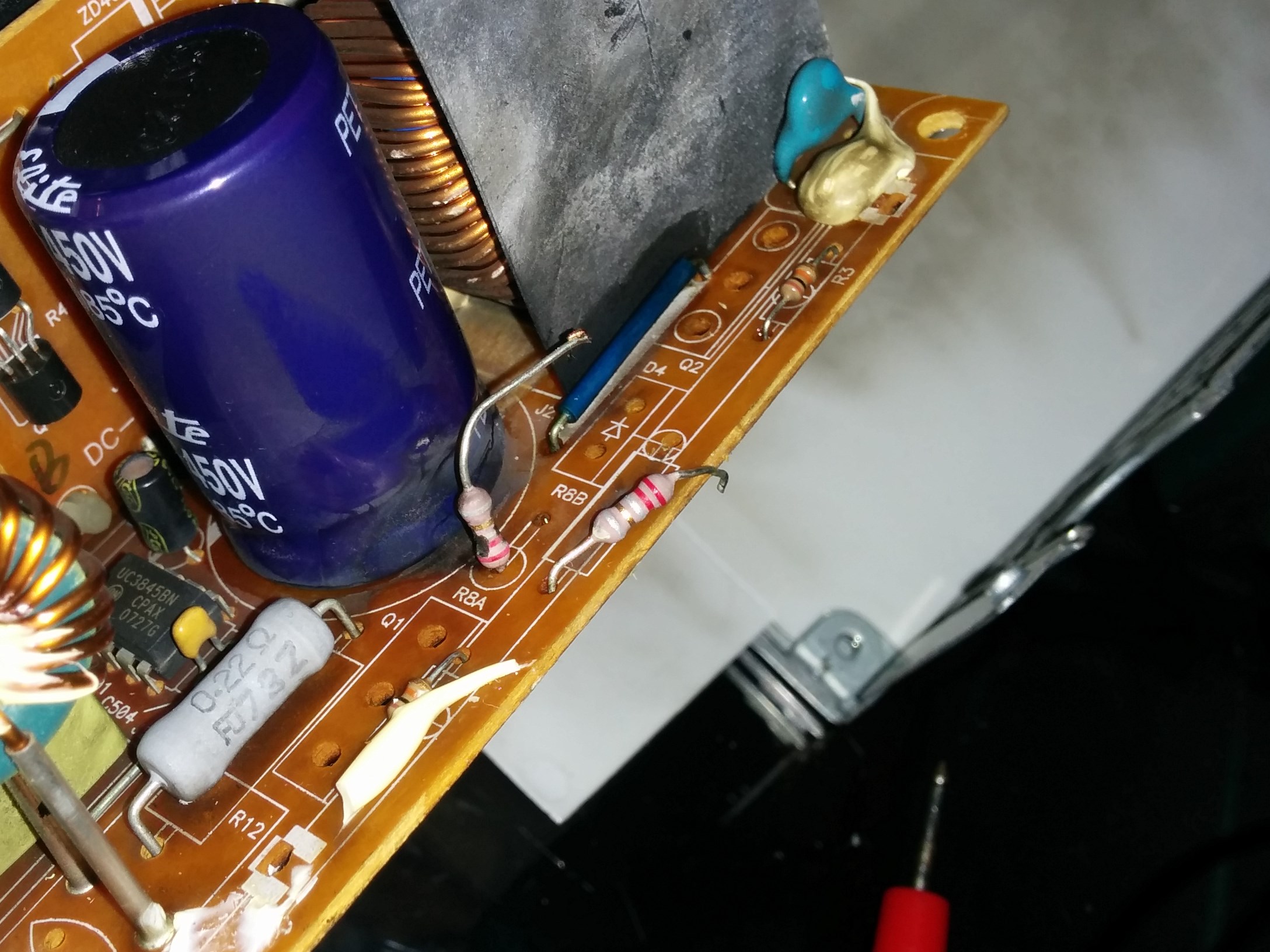

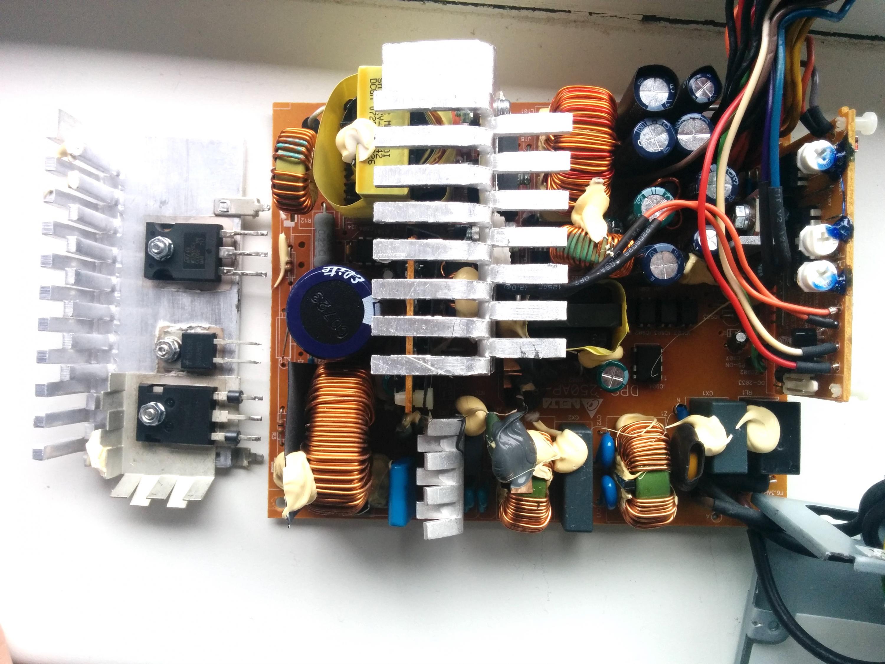

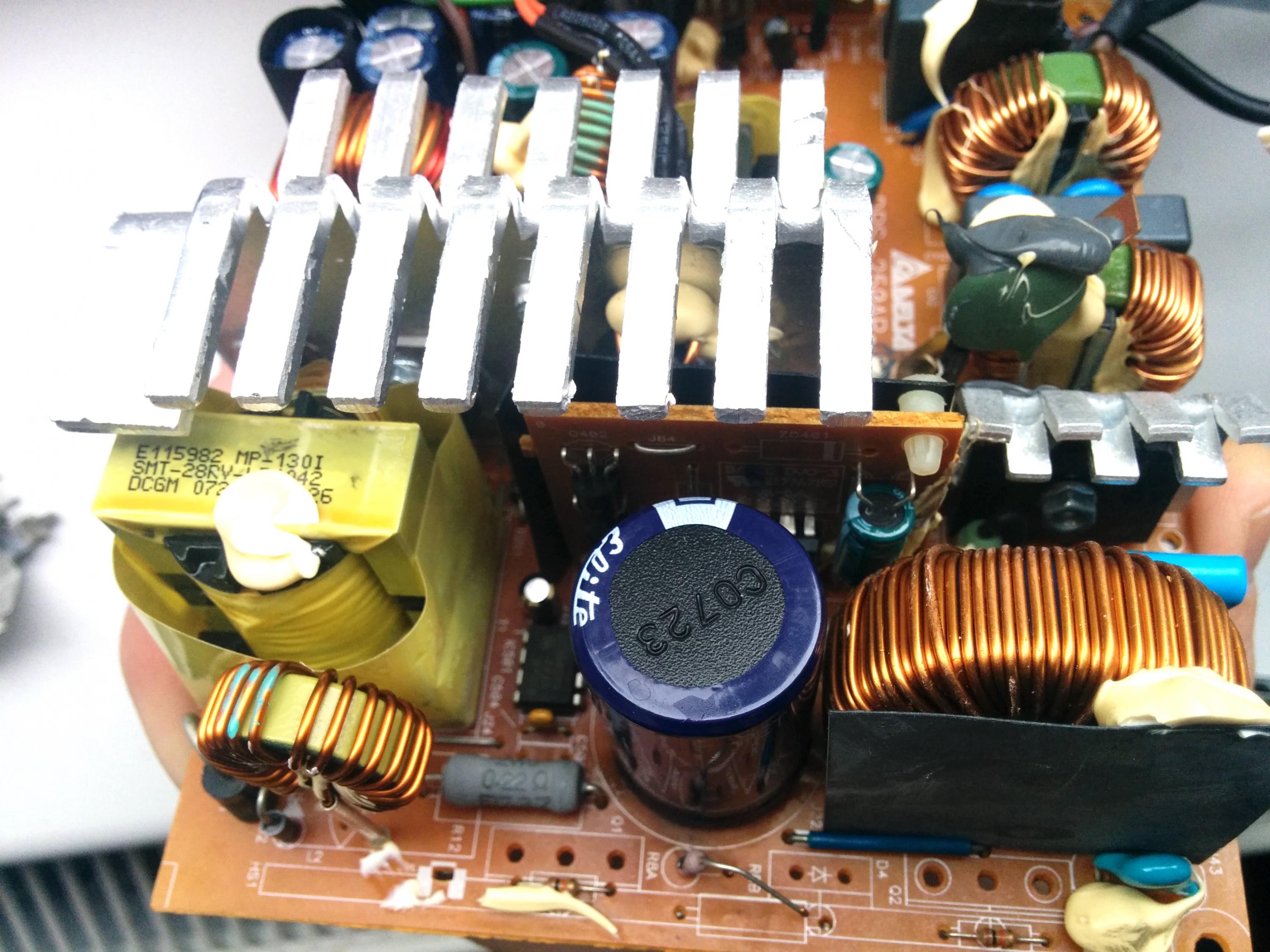

    I am repairing a Delta DPS-250AP-8 power supply from a Fujitsu SFF machine. The main fuse was blown, and culprit was that one MOSFET is shorted. Standby +5V line came up nicely when I powered it via a variac.
    I ordered the MOSFET, but there are still two burned looking resistors. One is too charred, but the other looks reasonable. However, upon further look I can't get proper value off the color rings, as the colors just don't add up.
    Colors are: red, red, silver, gold, silver.
    0.22 ohms perhaps?
    Or if perhaps someone has the proper schematics, these two are labeled R8A and R8B.
    See the attached pictures. Thanks!

    Re: Delta DPS-250AP-8 repair
    Given the proximity to the primary cap and APFC coil, there's a good chance those resistors may have something to do with the APFC.
    I suggest posting good top-side and bottom-side pictures in case a schematic can't be found, as we may be able to find out what those resistors do. That said, do the resistors show any resistance on your multimeter? Indeed the color code shown on them doesn't quite make sense.
      maybe more like 22 ohm.

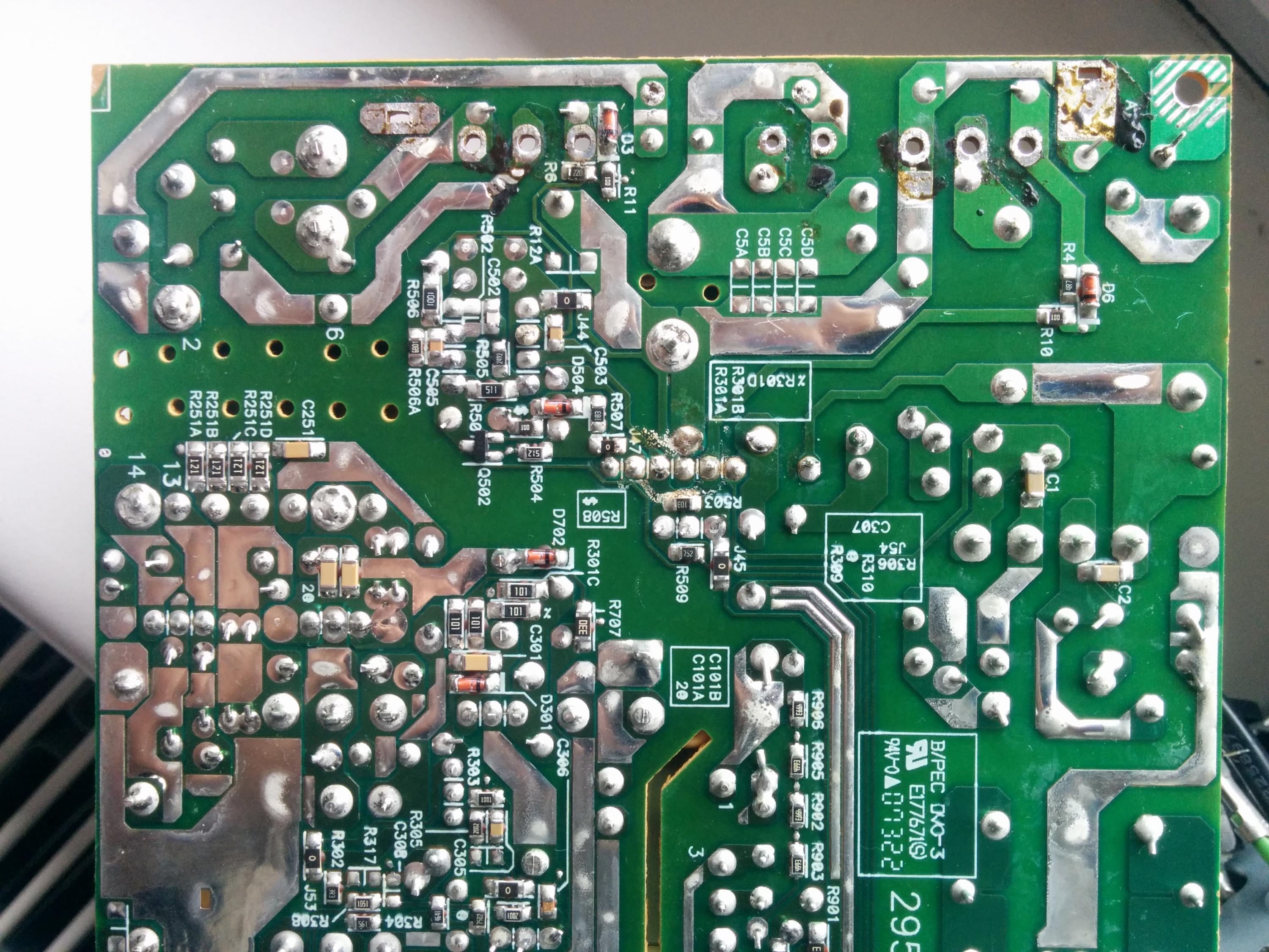

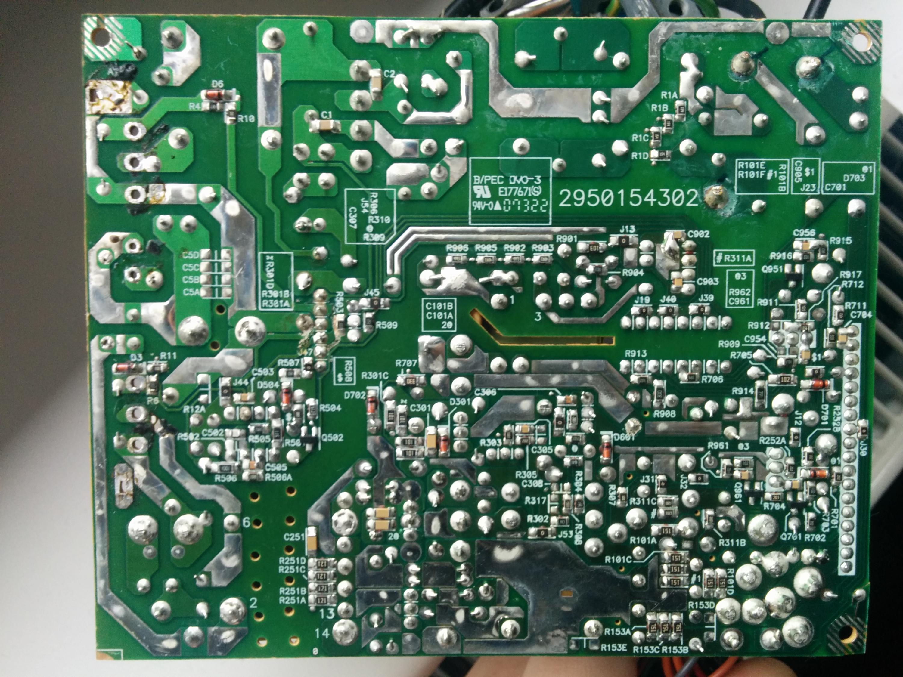

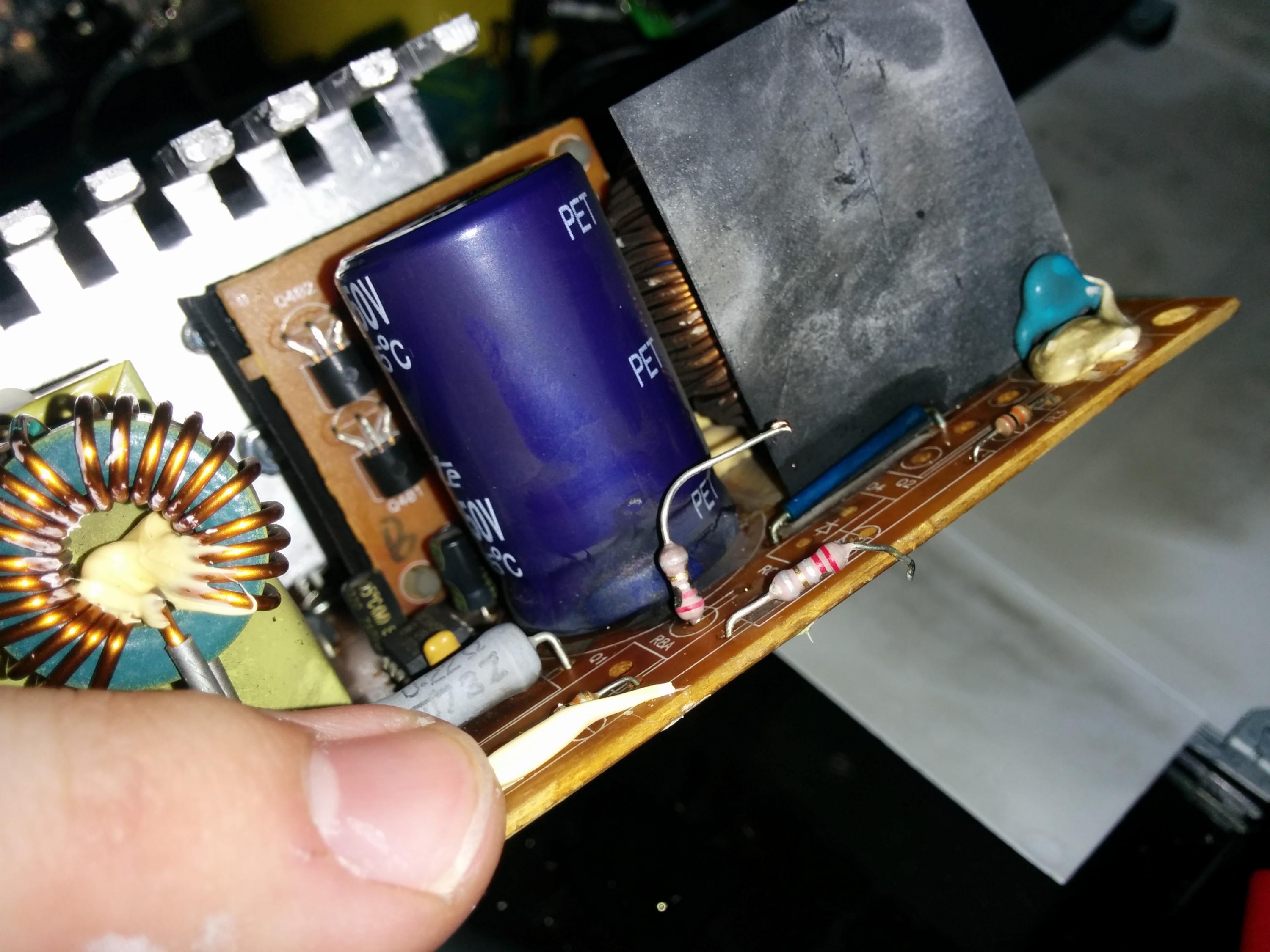

        Hi, thanks for the answers. I snapped few more photos, please excuse somewhat poorer quality.
        These resistors look like they are for protection for the D4 diode, as they are wired in parallel and in series with D4.
        They are both the same and both completely open, so no measurement possible. One that looks good, actually has a hole on the bottom...
        Thanks in advance
          It appears that Q1 is the switching FET for the main power supply (12V, 5V, and 3.3V rails) and Q2 is for the APFC.
          So which MOSFET blew, Q1 or Q2?
          Judging by the blown resistors R8A and R8B, I would guess that Q1 was the one blown. R8A and R8B connect the primary's positive (+) bus to one leg of the main transformer. The other leg of the main transformer is connect to the Drain of Q1 and is how the main power supply works (it's a single-transistor forward topology, or STF for short).
          Thus, check R12, as that may be blown (open-circuit) too. While at it, also check the snubber components across the main transformer's primary: that would be the two diodes next to it, along with a ceramic cap in there (it's not visible in the pictures, but I think there should be one, and I think I can see one too from the solder-side shots). All of these components are located between the main transformer and coil/inductor L2.
          That said, I wouldn't worry too much about resistors R8A and R8B for now. I think you can safely go with 0.22 Ohm resistors, at least for testing purposes. Just make sure they are flame-proof. In fact, even jumper wire may do for testing. So go with that if you don't have 0.22 Ohm resistors.
          But before substituting the new FET, check if the 5VSB comes up and that nothing else blows or overheats. To do that, simply install some jumper wire in place of D4. DO NOT install Q2 or Q1. Then connect an incandescent light bulb in place of the fuse. 40-100 Watts should do. This will limit the current if there is anything else wrong with the PSU. Here is actually how it's usually done:
          https://www.badcaps.net/forum/showpo...4&postcount=70
          If the 5VSB comes up, remove the jumper wire from D4 position, install a jumper in place of R8A (or R8B, whichever you prever, as they are both in parallel, so it doesn't matter), and install Q1, Q2, and D4 back (the whole primary heatsink with its components, that is). Keep the incandescent bulb connected across the fuse. Now plug the PSU back in the wall and try to turn it on (short PS-ON to ground). Depending on the PSU, you may or may not need to put a small 1-5 Watt light bulb on the 5V rail or 12V rail (sometimes, an HDD will work too). If it turns on, you are probably done. If not, you may have to start checking the small components around the UC3845B PWM chip, as there may be some more that are blow, including the UC3845B chip itself.

            Thanks for the exhaustive answer!!
            The one that blew was Q1.
            R12 is still okay and it is not open (measured less than 0.4 ohm).
            5VSB already came up when I powered it on at first with fuse bypassed with an 60W bulb and using a variac. If I tried to power the PSU on (ATX PS_ON to GND) it immediately whined and bulb lit brightly.
            I will replace the Q1 and see how the thing goes.
            Also snubber components all seem to be okay, no shorts, etc.

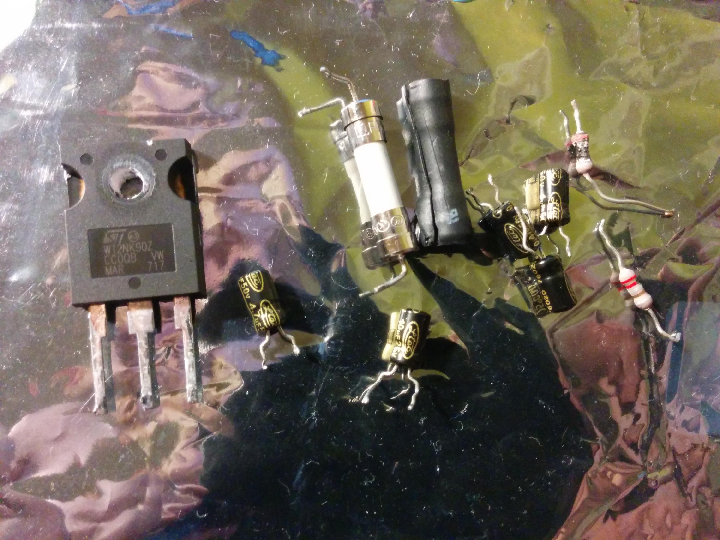

                I assembled the case and tried it in a computer. Sadly, there was a loud bang and I disconnected the mains immediately.
                This time, there is much more damage, Q1 blew again, also the IC501 (UC3845B chip) blew its head off, R12 is open, some diodes are shorted, few SMD resistors open, one SMD transistor shorted. R8A and R8B this time survived.
                I am a bit baffled why did this happen, as it worked properly for about 30 minutes (albeit with minimal load), but when tried in a computer it just went bang. Perhaps the UC3845B was somewhat damaged before and it blew now or perhaps there is something else?

                    By the way, can you point to us which SMD resistors and transistors burned?
                    I think the PSU should still be repairable. Not sure if you'd deem it economically repairable, as that will depends on how much time you have and how much you value your time. But on the other hand, it may also be a learning experience, so that's also worth considering sometimes.
