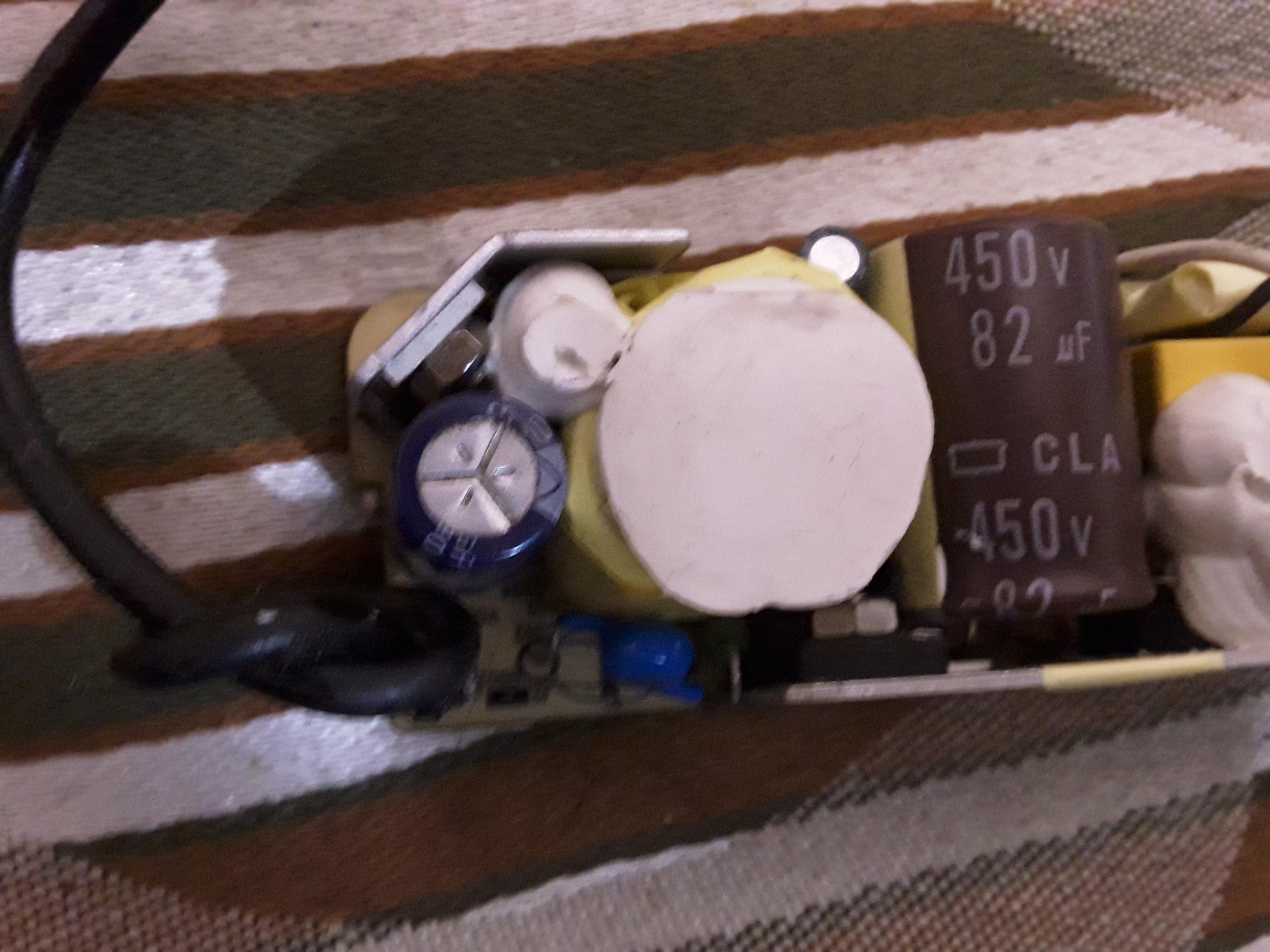

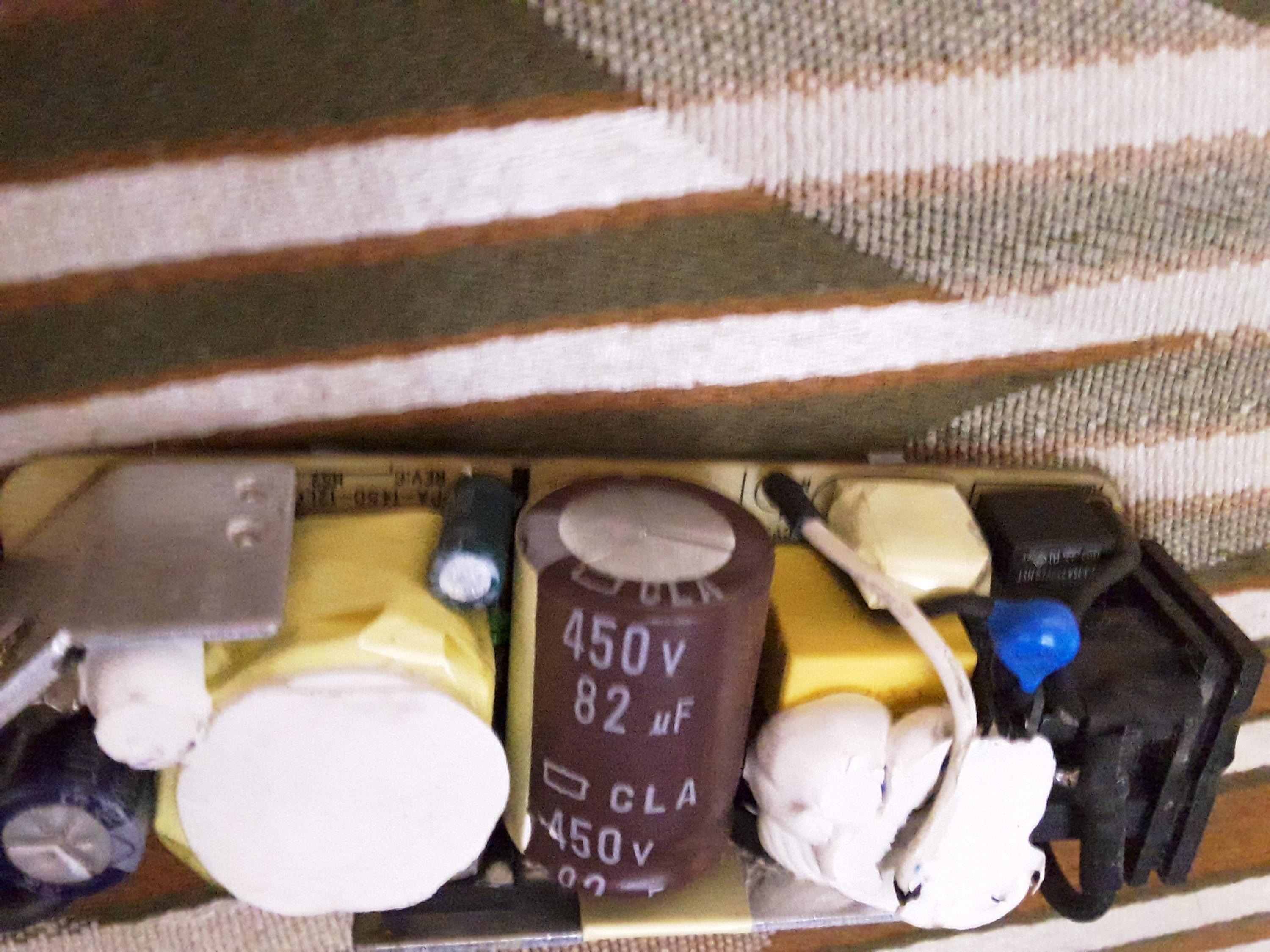

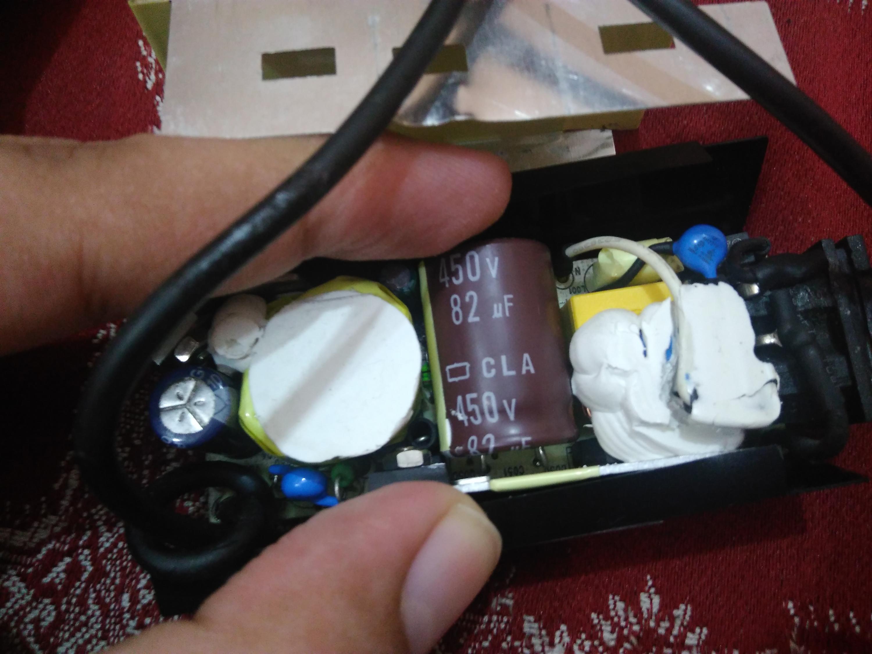

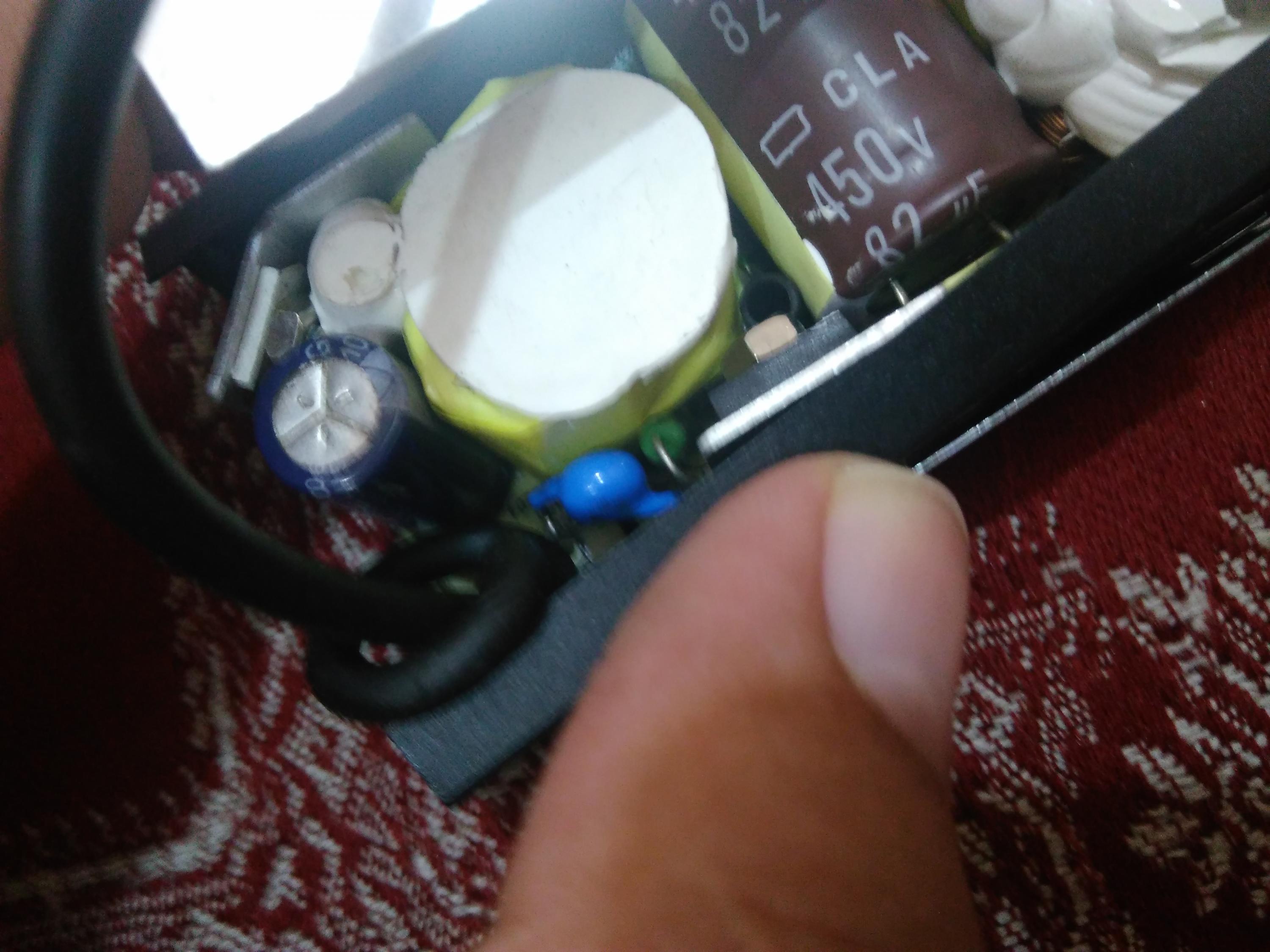

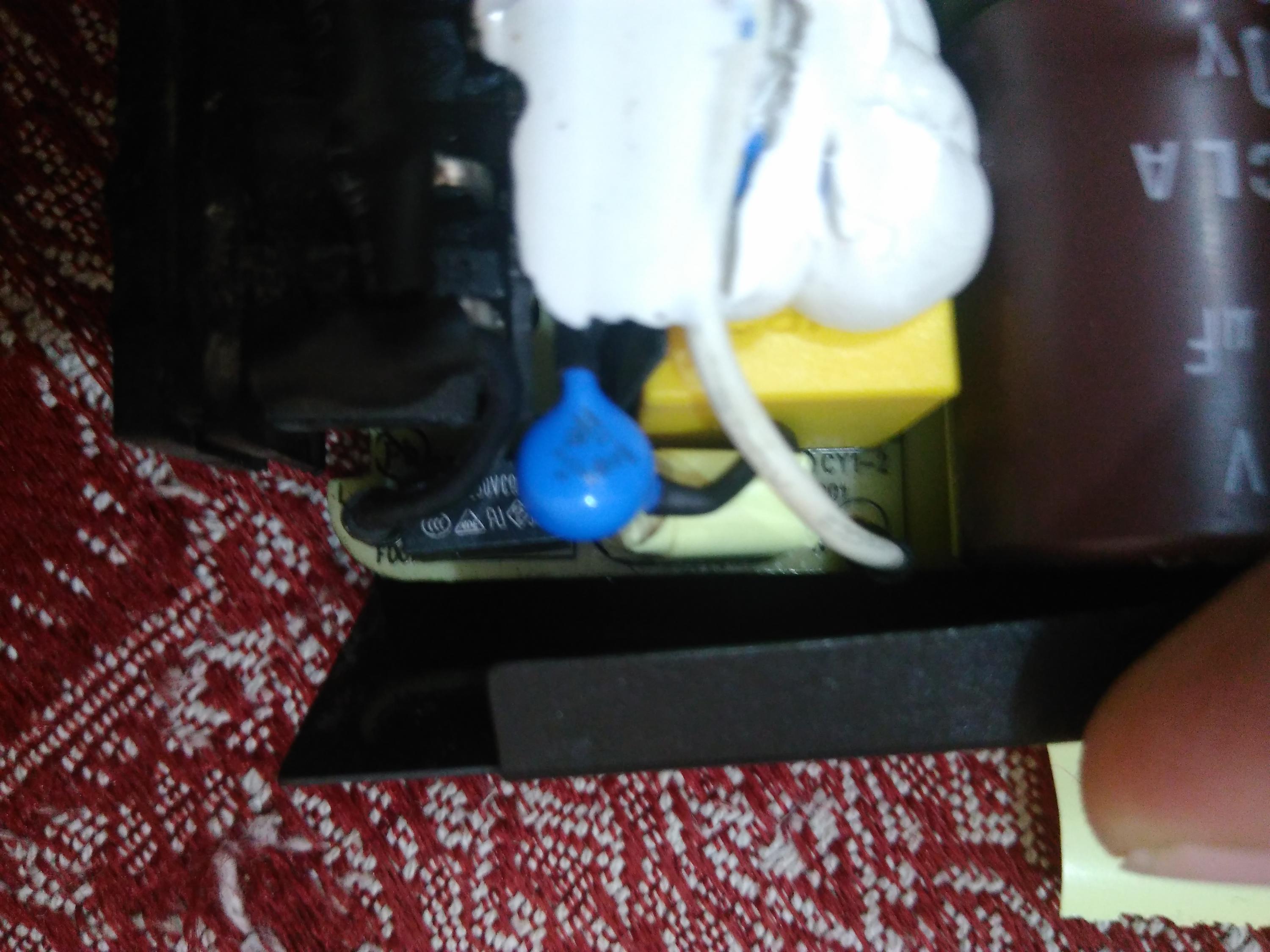

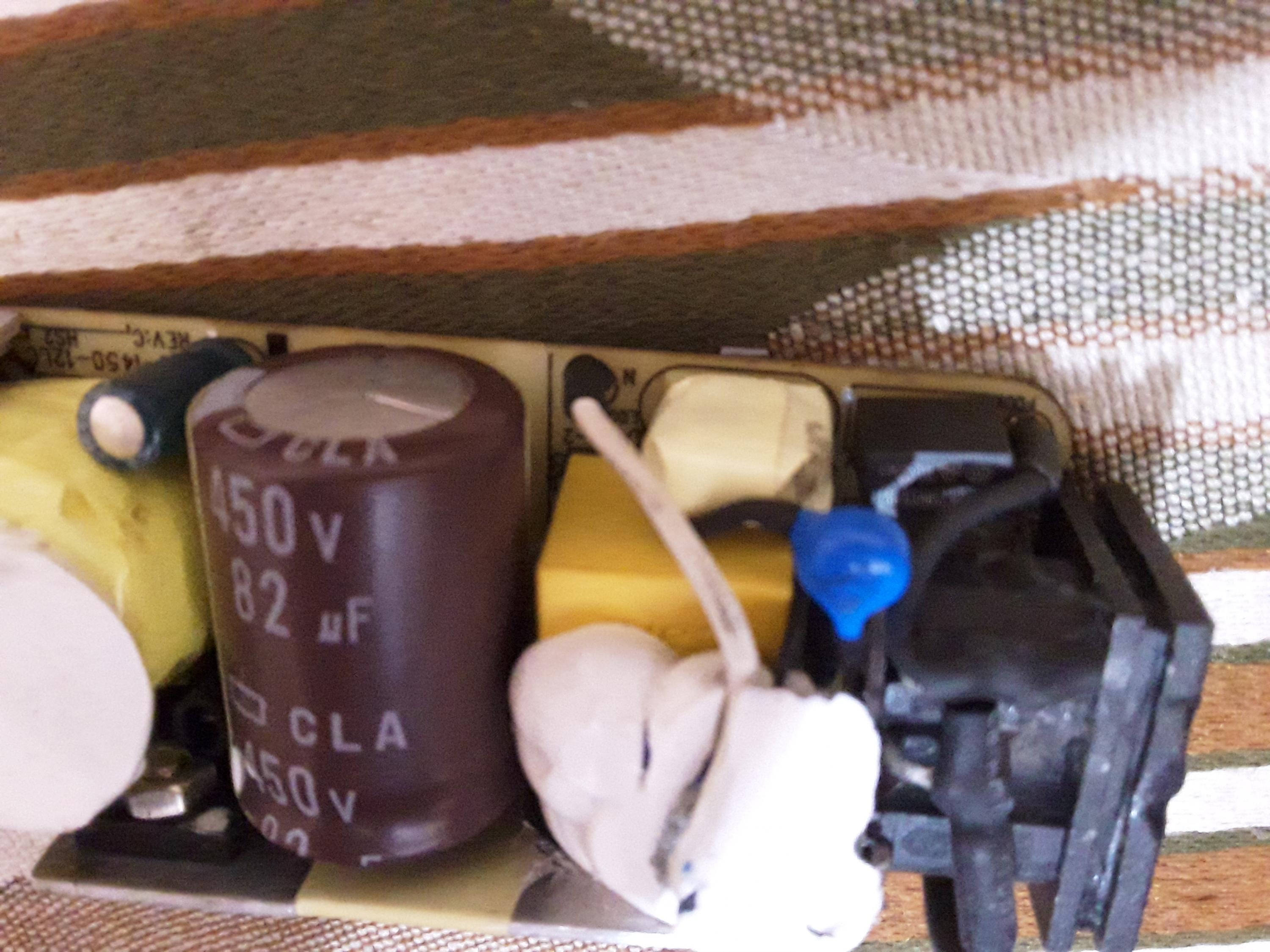

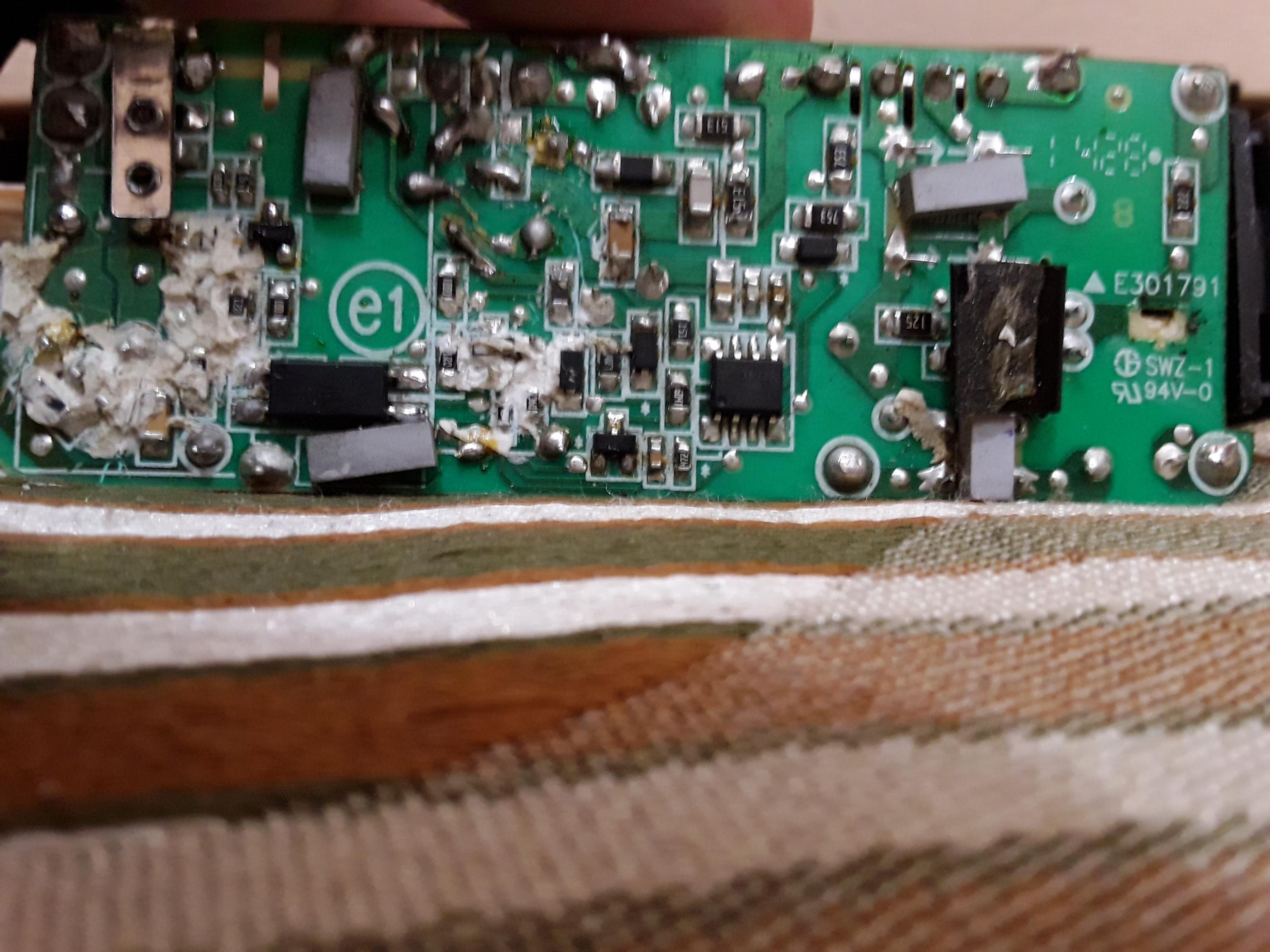

      Re: Repaired laptop charger , is it safe to use ? - General query
      Thanks sir for replying ... i have attached internal images of Charger ...
      i could only see 3 capacitors ..
      big one - 450v , 82Uf brand unknown
      left side blue one - 1000uf , 25v G-Luxon
      tiny green one - 22uf , 50v Taicon ( on top left side of big one, where 450v is written )
      can somebody please tell me now if it is safe to use and will not harm motherboard/other components ?
      --- it is working fine and able to charge the laptop
      thanks
        That small green one may be critical, and is a Crapacitor . If it failed, it could blow up the charger. The large one is a Chemi-con. Good brand. The blue G-Luxon is not OK for use here. They do not do well with how hot these charges get....
            Thank you sir but isn't Taicon like the best non-japanese capacitor brand out there ?
            and as long as G-luxon cap works , can i trust that it isn't going to harm motherboard/other parts through high ripple or voltage ?
              That capacitor is not going to harm anything, but if it goes bad, charger will stop working again. Genuine chargers have protection circuits built-in which will prevent them from doing damage to the board.
                A repaired genuine charger will be safer to use than a knockoff replacement. My 2 cents.
                Make that 4 cents now
                I'll take a repaired genuine charger over a cheap replacement any day.
                That said, if that TV repair guy is using crappy caps for repairs, I would avoid him in the future, unless you really have no one else to go to. I hate it when people use the cheapest caps available for a *permanent* repair. I use crap caps too sometimes, buy only to verify function. After that, it is Japanese quality caps or waiting on my parts shelf in pieces until I get caps.
                As far as this charger damaging your laptop - that is very unlikely to happen. Like Unique said, most are designed well and will shut down when they detect they are not outputting the right voltage or being overloaded. Cheap chargers are not so good with that, so that's why it's better to avoid them.

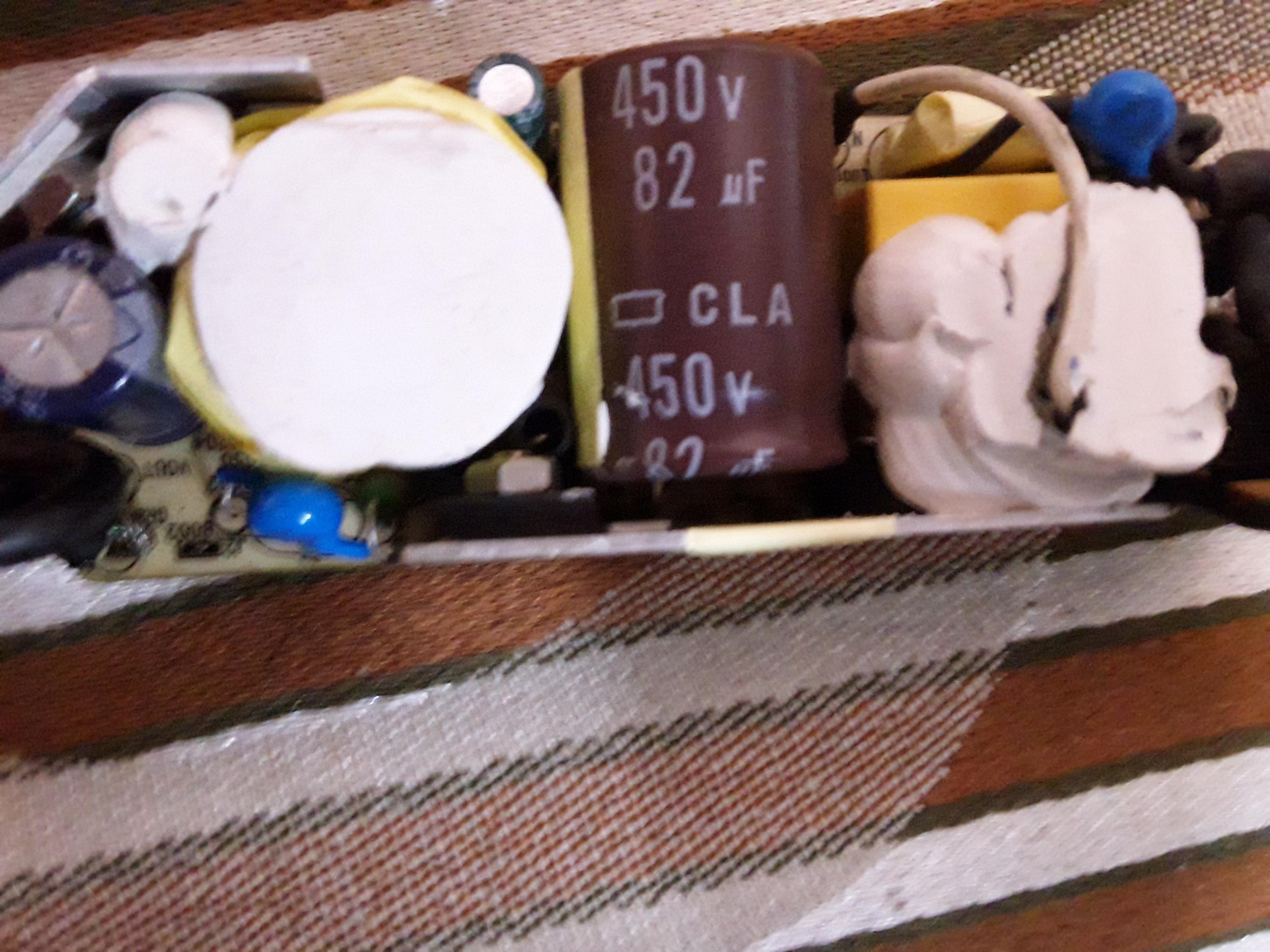

                                • asasf
                                more pics
                                      hello sir , this got a bit delayed... have a question before i place an order
                                      my existing g luxon cap is 10 x20mm .. with hardly any extra space for diameter or height
                                      in 1000uf 25v rubycon ZLJ i am getting 20x10mm .. in 1200 uf i am getting 10x25mm
                                      now if i go with 1200 uf 25mm height then the cap height will be too much and top cover wouldn't fit properly .. i can duct tape it with protruding cover adjusting it somehow and managing it with protruding cover .. But is it worth it .. is 1000uf going to be detrimental to ripple and harmful for motherboard ? this is for a 15w tdp pentium 3558u laptop
                                      additionaly there is Panasonic FS in 10x20 1200uf .. but this is new series if i am not wrong and untested and i would like to stick to Rubycon and panasonic costs more
                                      what should i do , thanks a lot..
