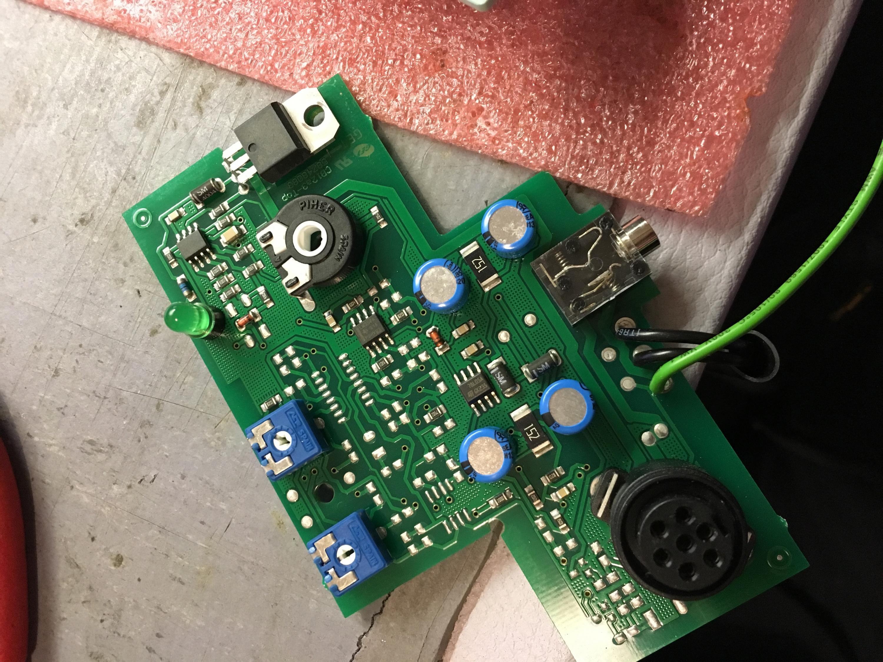

    Hello, my Weller PU81 wont started today
    I check and see that fuse burned (0.5A/240V), replaced it and same thing happened.
    I try widouth soldering iron attached - no help.
    I disassamble PSU and check transformer with ohm resistance. Primary is 15.7 Ohm and secondary is 0.03 Ohm. I think it is gone bad, am i right?

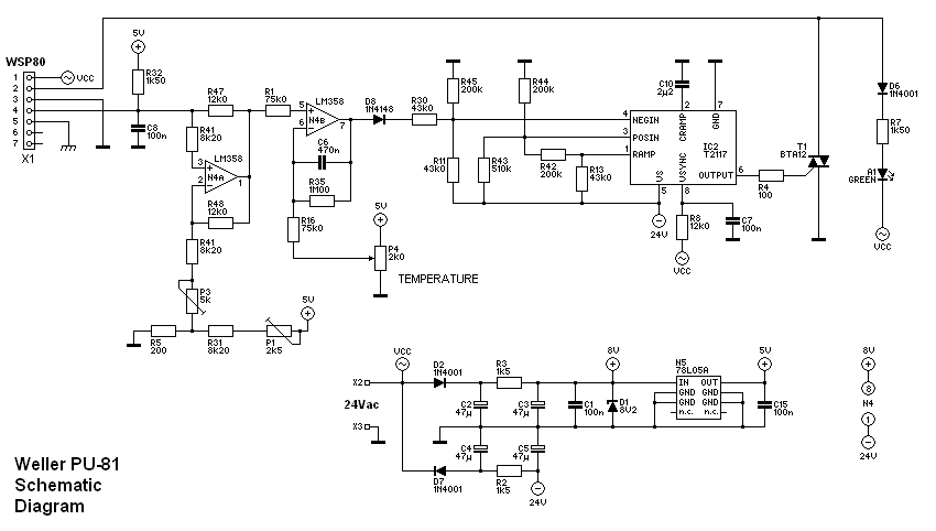

      Re: Weller PU81 bad transformer?
      Found this PU 81 schematic on the web.
      I would disconnect the xfmer secondary and use the dim bulb tester (say across on/off switch) to see what happens.
              yes you are right, i check now with dimm bulb and transformer give 24VAC on secundary. So my problem is in circuit.
              Here is the picture of it. I check the big voltage regulatore and it is ok.
                The big one is triac (BTA12-600CW)
                ...the quieter you become the more you are able to hear...
                            These two files are part of the schematic that may help
                                  Check D2 and D7, one may be shorted.
                                    So the TRIAC is not shorted out or has leakage resistance?
                                        So if you lift one end of Gate resistor R4 the iron will no longer gets hot for sure?
