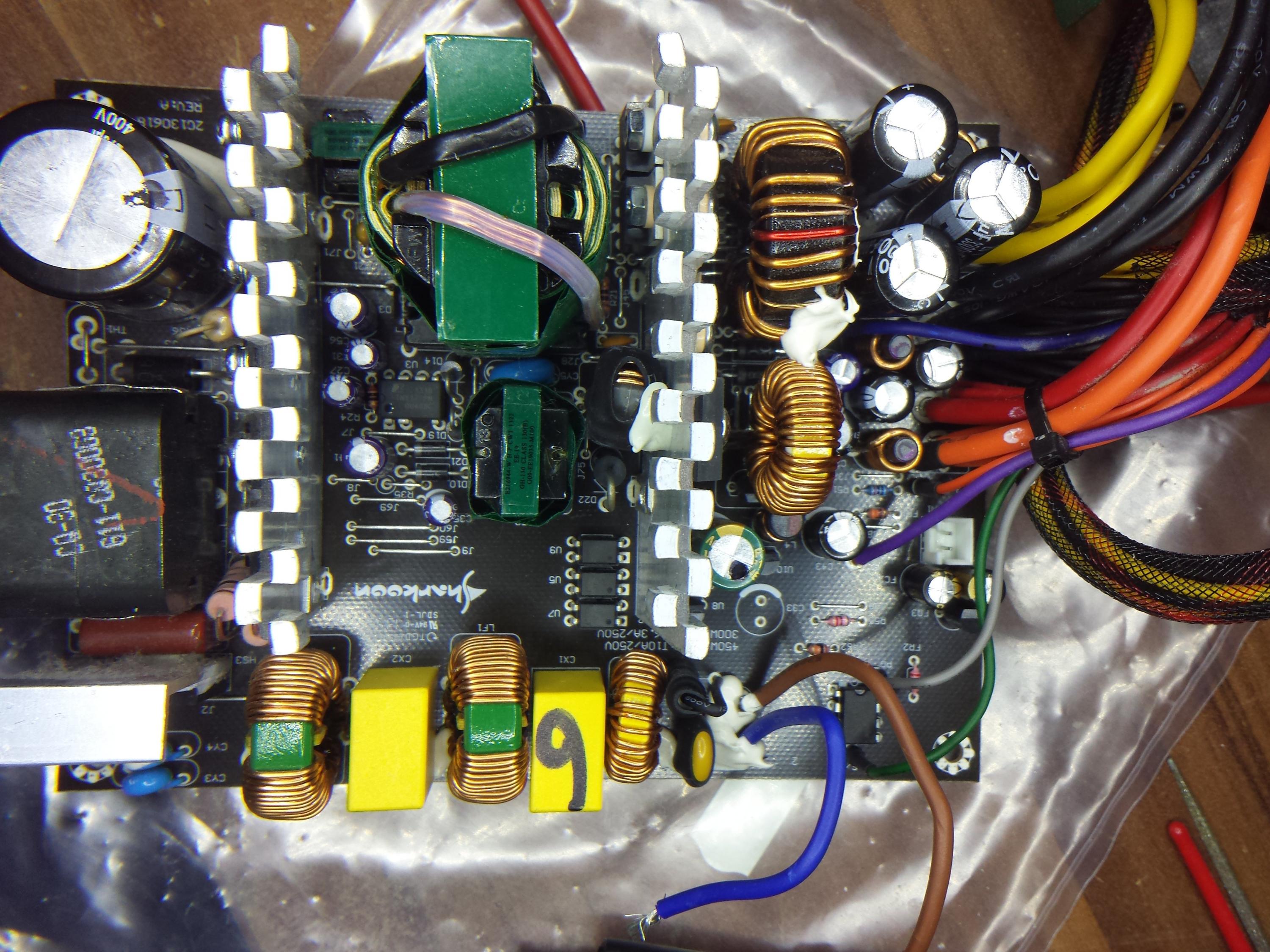

    i got this very new not older than 1-2 years Sharkoon WPM 600 V2
    the PSU doesn't turn on testing it with a motherboard+cpu(which work's fine with another PSU), it tries to start and the fans spin not quite a second before it shuts down.
    the power supply is very similar to this one tested and carefully documented on this site
    https://www.techpowerup.com/reviews/...L650AWT/4.html
    i replaced all the cheap Electrolytic capacitor's on the secondary side, near the output rails.
    the 'main PWM IC' CM6800TX got 0V on all pins in Power down state, (PS_ON left high).
    the 5VSB line showed 5V.
    a strange behavior come up when I tried to load the 5VSB line with a 22Ohm resistor (17Watt) the Voltage dropped down to 0.
    i see there are small caps around that 'standby PWM controller' TNY177PN
    which i guess is responsible for the 5VSB. should i replace these caps too ?.

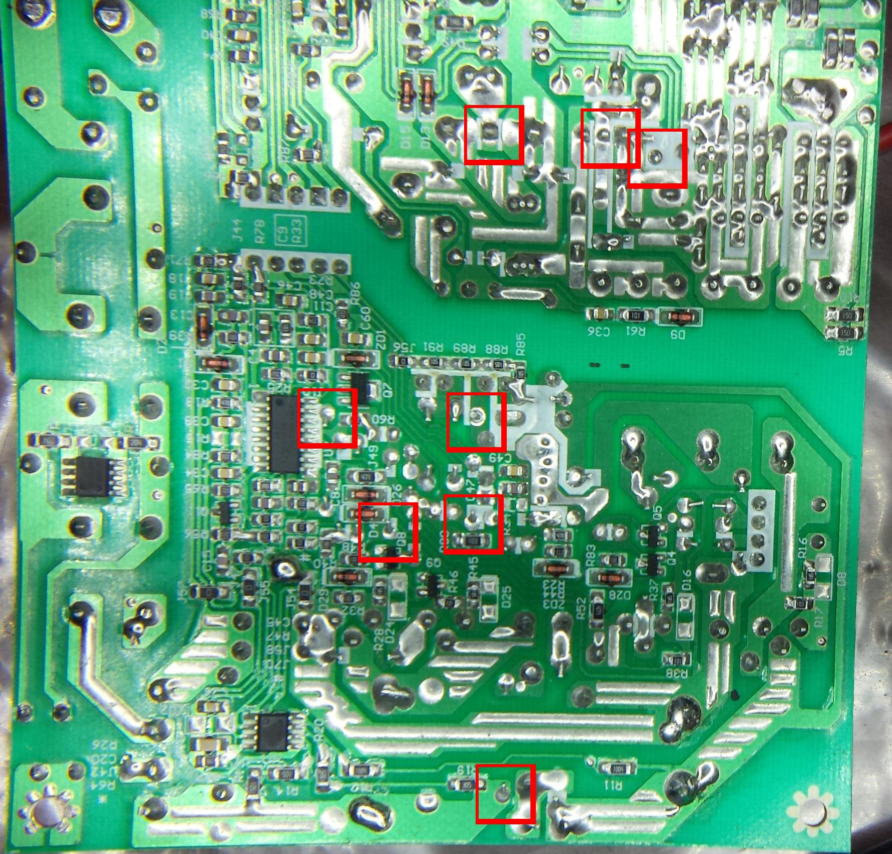

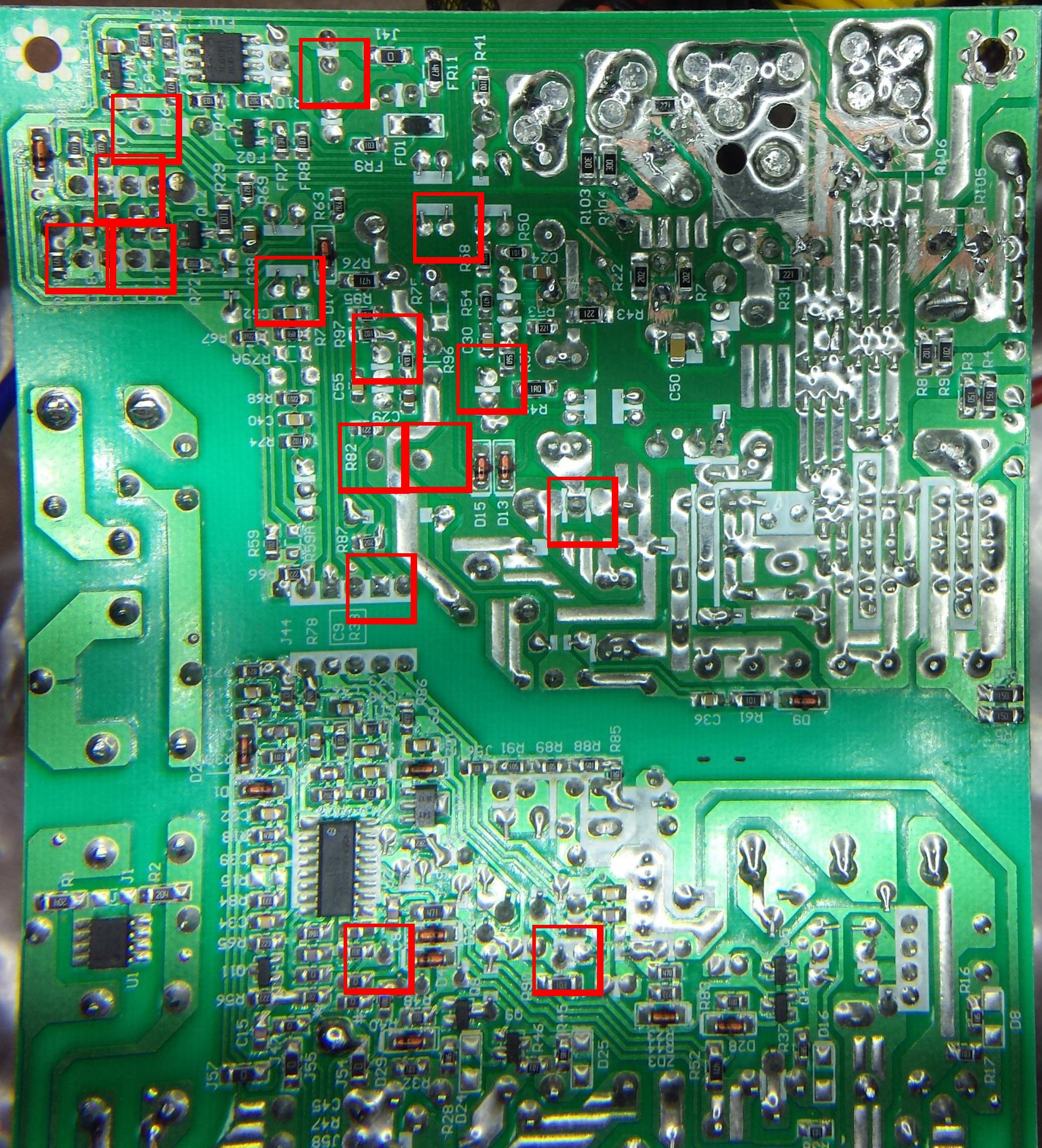

          • 31015
          Re: ATX_PSU_5VSB_only
          go over that with a magnifying glass - i see lots of cracked solder joints.
          hint: HALO's are for Angels - not solder joints!
          • zodiac565
            • Jul 2013
            • 9
            • Austria
            you mean solder joints that look like HALO's ? can you please give me an example through my picture.
              • 31015
              i may have missed a few, and some may just be the lighting.
              but you get the idea.
              • zodiac565
                • Jul 2013
                • 9
                • Austria
                yea thanks for that tip, i re-soldered some of bad looking solder joints.
                what now appears is, when i don't insert one cap of the 5VSB line (the one before the small coil placed on the output side). i get all voltages 3.3V 5.0V 12V when i pull the PS_on Low.
                if the cap is inserted still the same problem and no output voltages if PS_on Low.
                strange thing.
