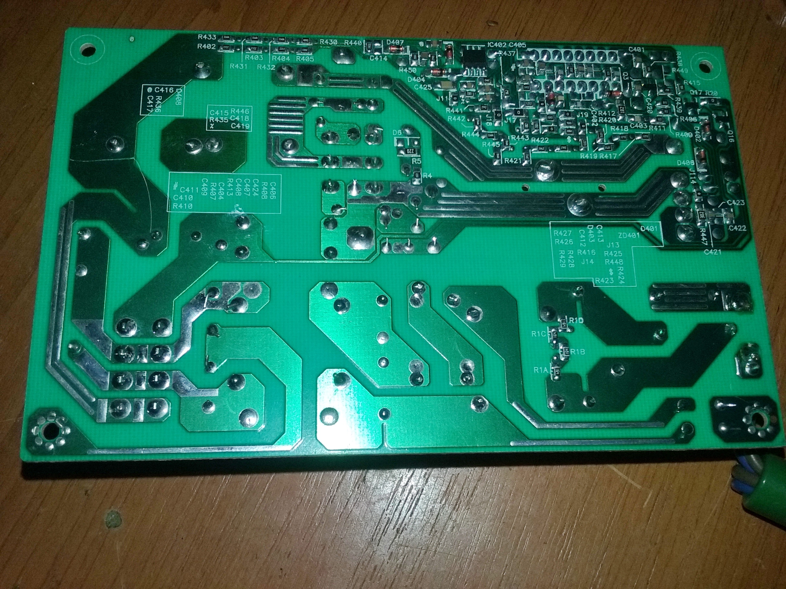

                    Where's the primary cap for that unit??
                    • Khron
                      • Sep 2006
                      • 1350
                      • Finland
                      Re: Delta Electronics: DPS-410DB A issues

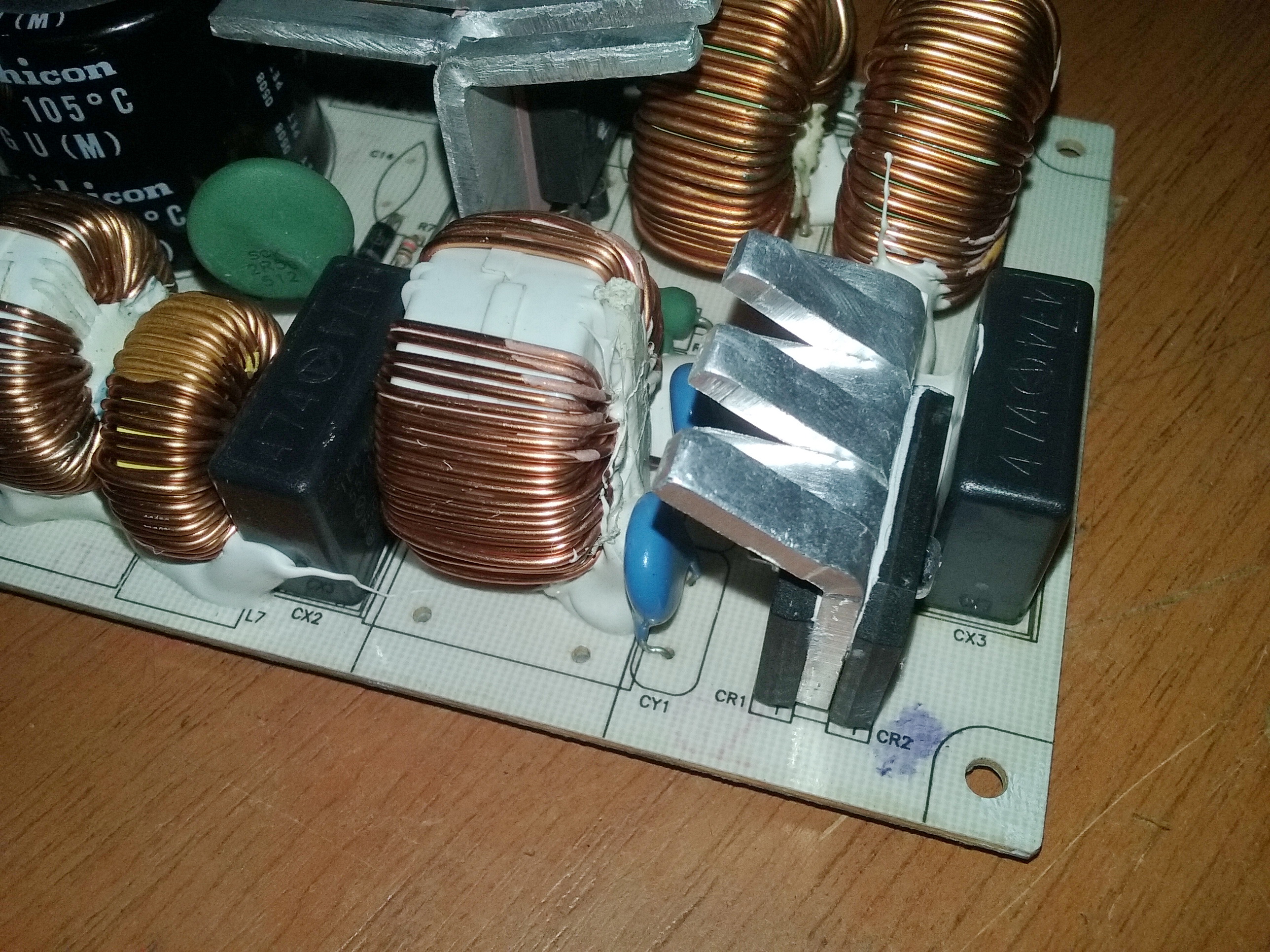

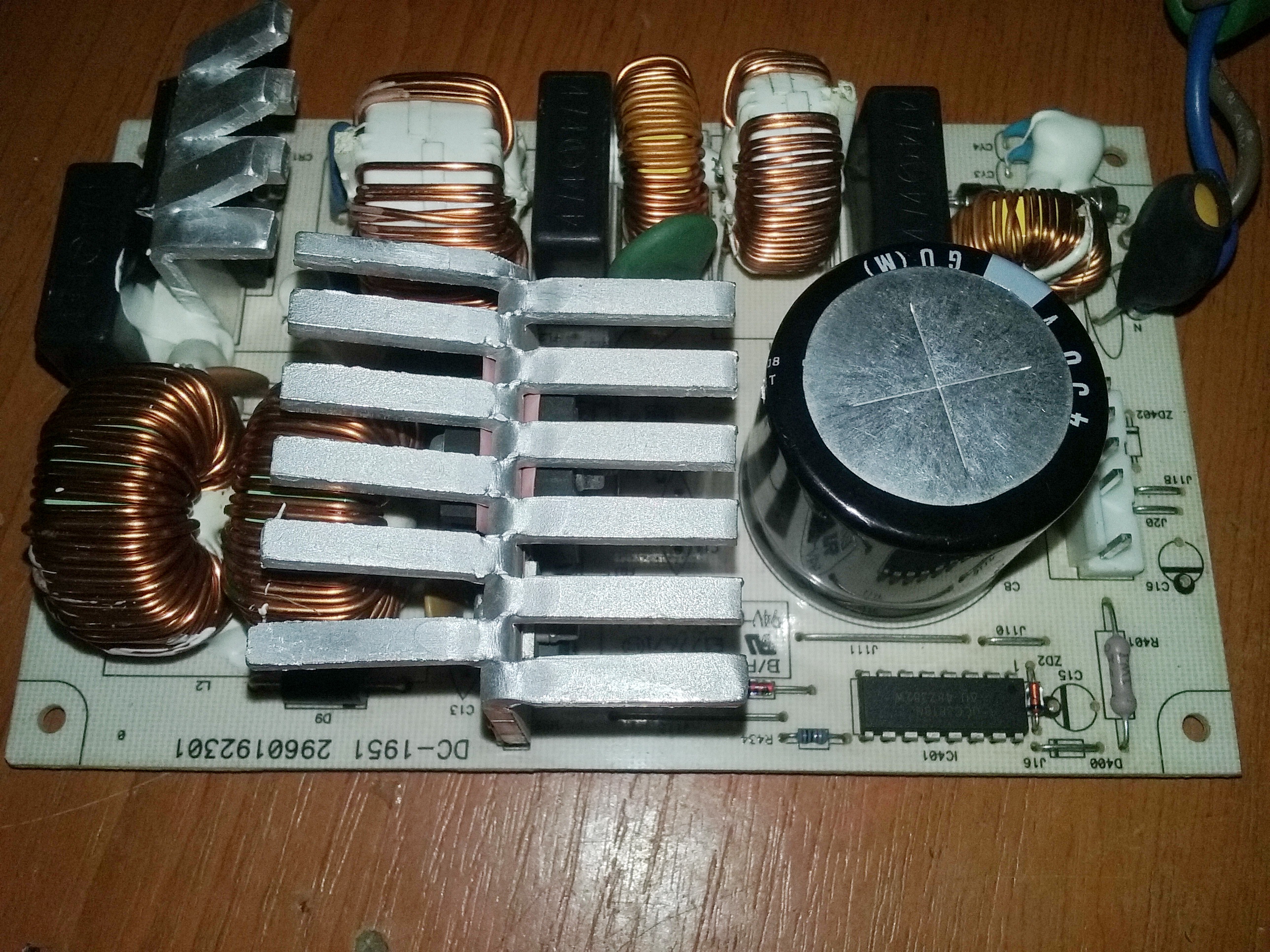

                      My hunch is there's a second PCB with possibly an active PFC. See that clump of wires going off to the left, from the primary side, in the 3rd photo?
                      In fact, right next to where the brown wire goes into the "mainboard" (lower left), i see something resembling "B+", which would most likely be the main DC bus.
                        Indeed there is a second board with EMI filters and active pfc:
