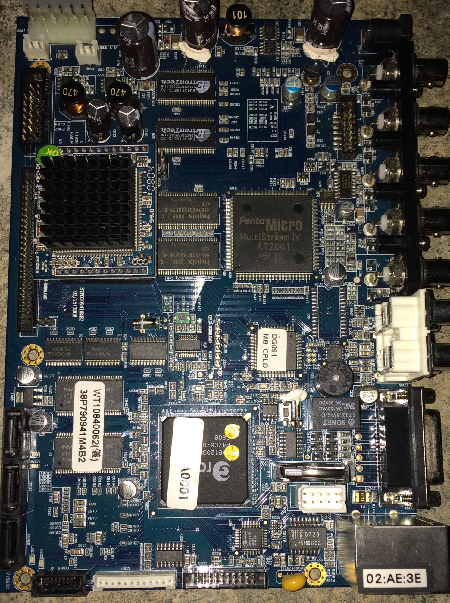

    Can some one tell me what the part number would be for these surface mount caps on this board
    One of the caps has this on it
    7G ?
    220 uf
    6.3 volts
    The 7G is what do not know what this mean

    Re: Digikey part number these surface mount caps
    Can some one help me with what type of caps should I order
      It's probably a date code or some internal manufacturer number. No need to worry about it. Just get some 220 uF, 6.3V SMD polymer caps (under "Aluminum - Polymer Capacitors" on Digikey). Probably something like Chemicon PXA or Panasonic OS-CON SEPC/SEPF (formerly Sanyo OS-CON) should work. I haven't looked at what is currently available on Digikey these days, though, so I can't suggest anything concrete.
