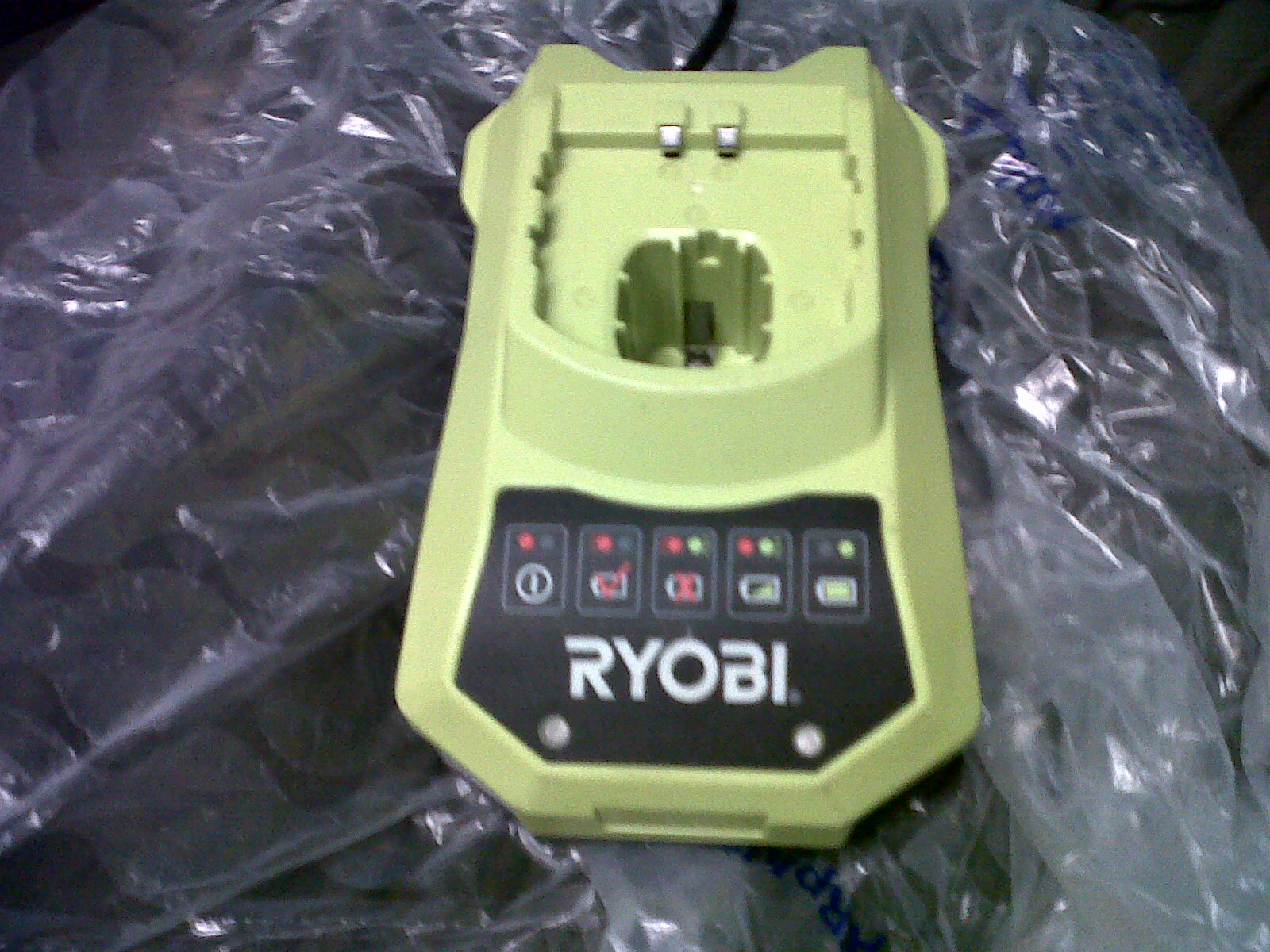

    RYOBI-one charger

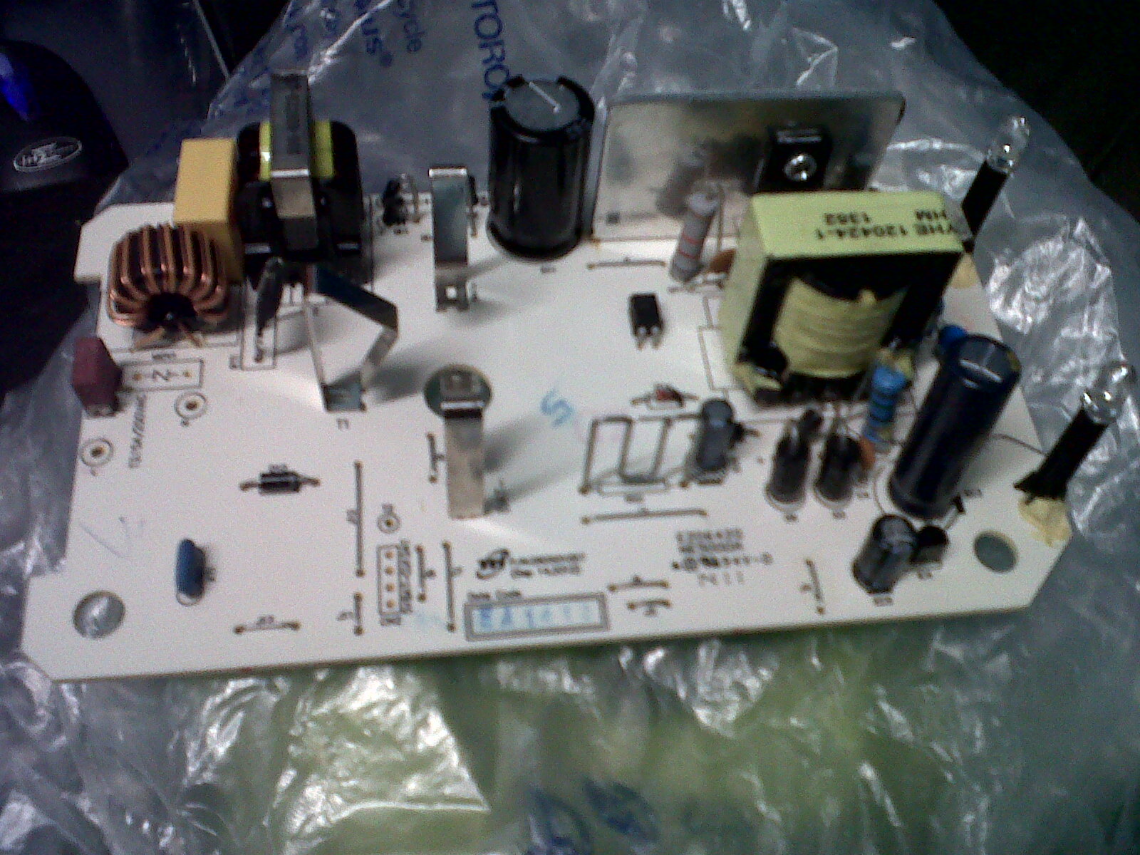

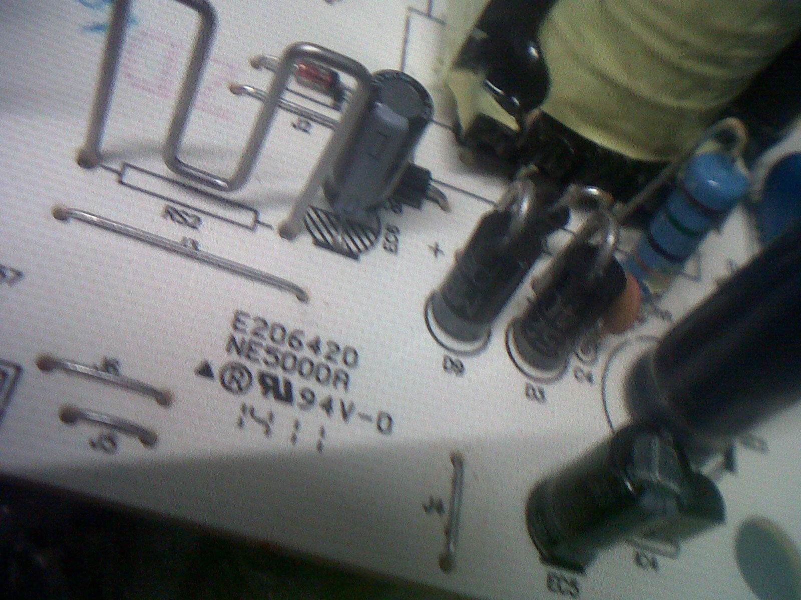

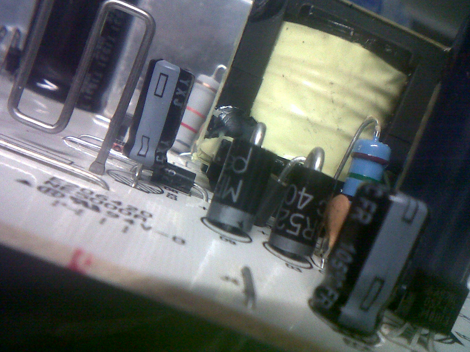

    these green things are shit, they die after less than 2 years.
    u-tube is full of people trying to fix them.
    (i fix them for good)
    the main problem is similar to the vestel psu's - parallel diodes.
    one shorts - blows the smd fet, damages the protection zener.
    • 31065

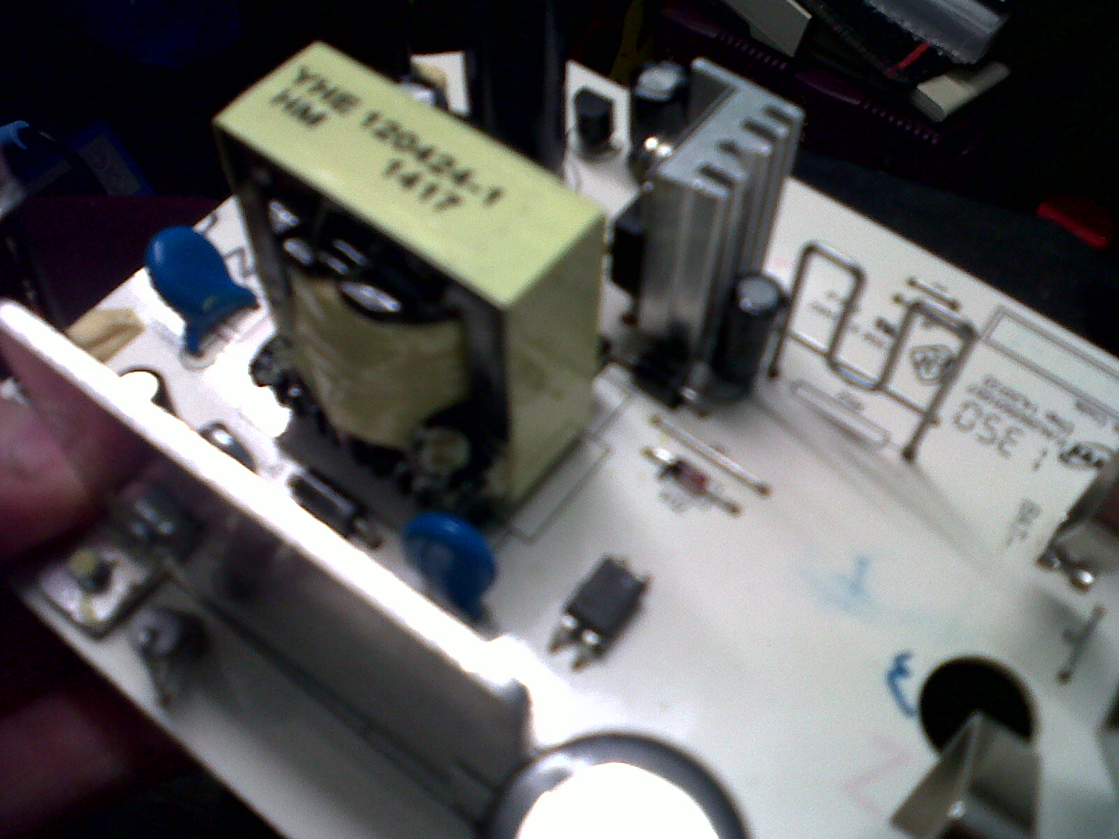

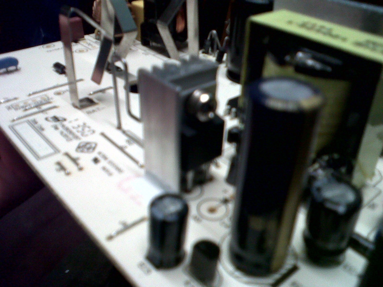

    Re: RYOBI-one charger

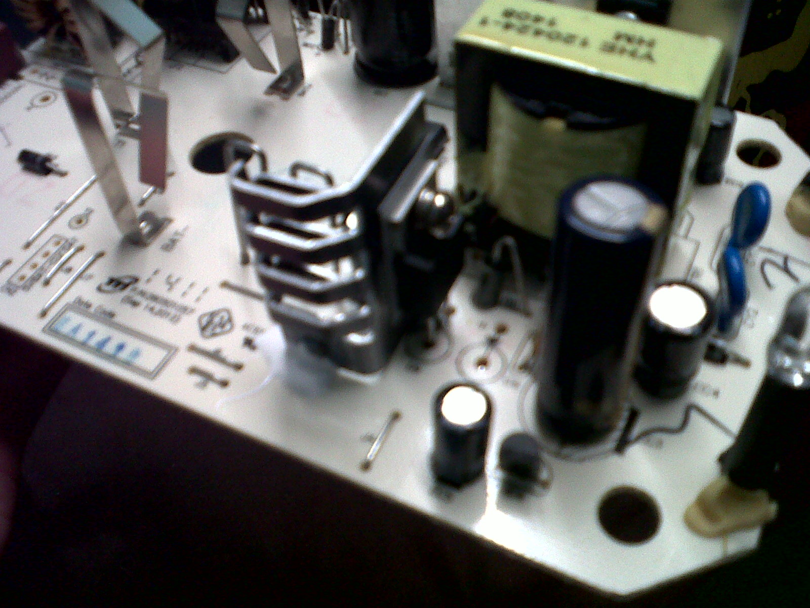

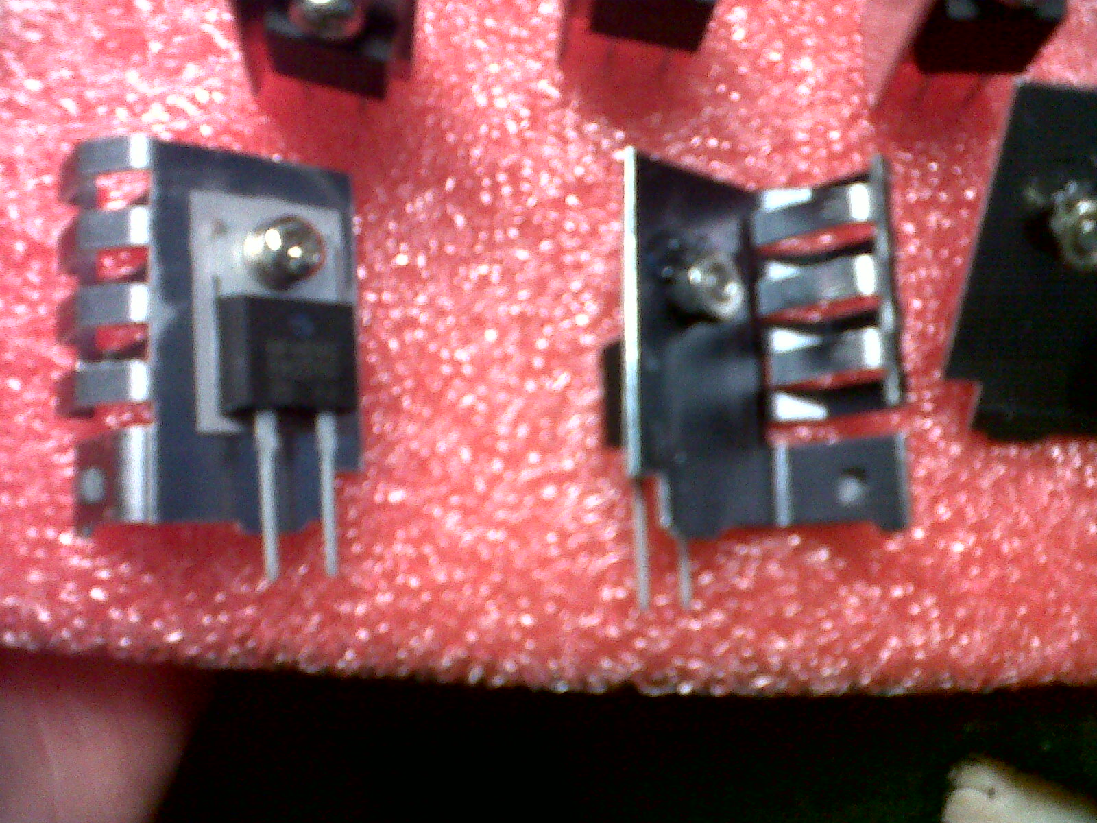

    so lets fix the bastards so they wont disrespect us again!
    replace the fet with IRFR5505PBF
    replace the diode with BZT55C18
    replace the 2 diodes with a single MBR40250G on a customised heatsink with an insulating kit.
    finish it with resoldering anything cracked, removing glue, and a full recap with FR,FC,YXJ and a BXW primary (instead of capxon)
        it works better than new - it does not get hot over the diode(s) now.
        i replace a pair of 5A diodes with a 40A diode on a heatsink - you expect it to fail?

            • 31065

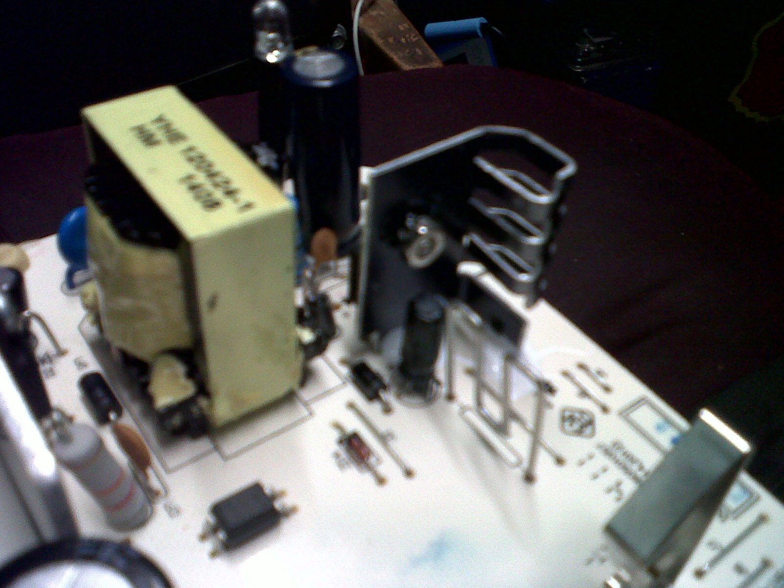

            problem is the 2 big diodes fail and blow stuff up - if you have that model with 2 big MBR5200 diodes, replace them with a big diode on a heatsink before one fails.
            i know there is another version of this charger with a single diode on a big heatsink that has other problems.

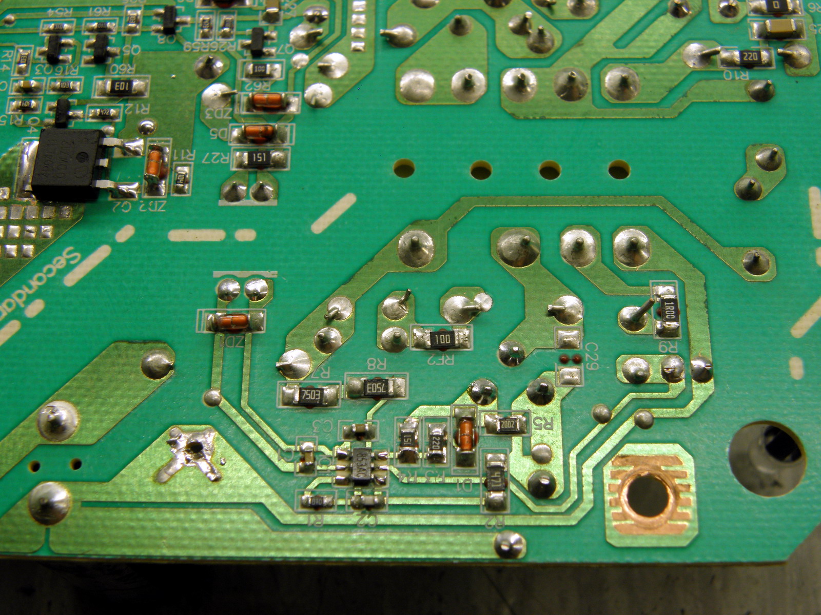

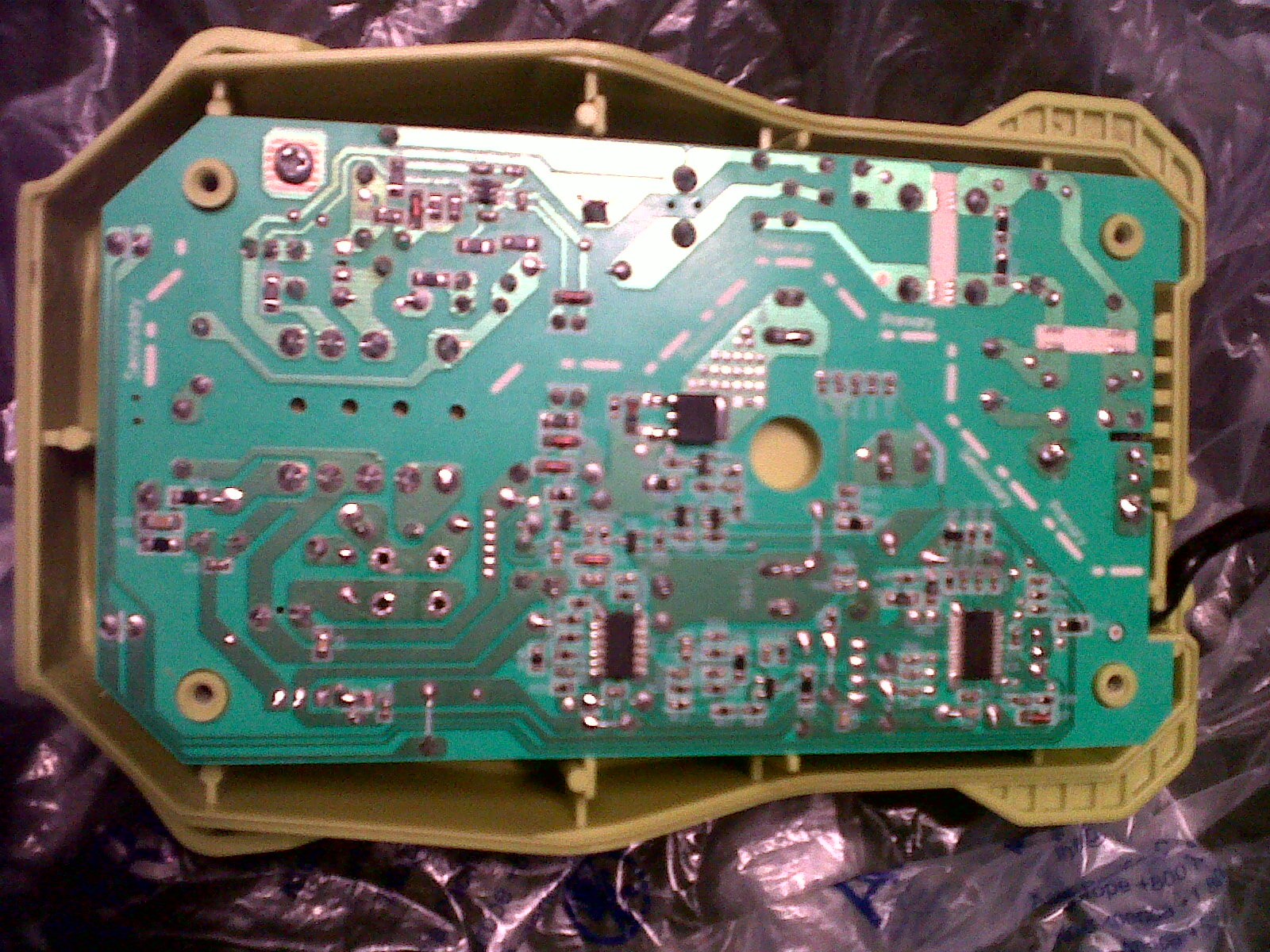

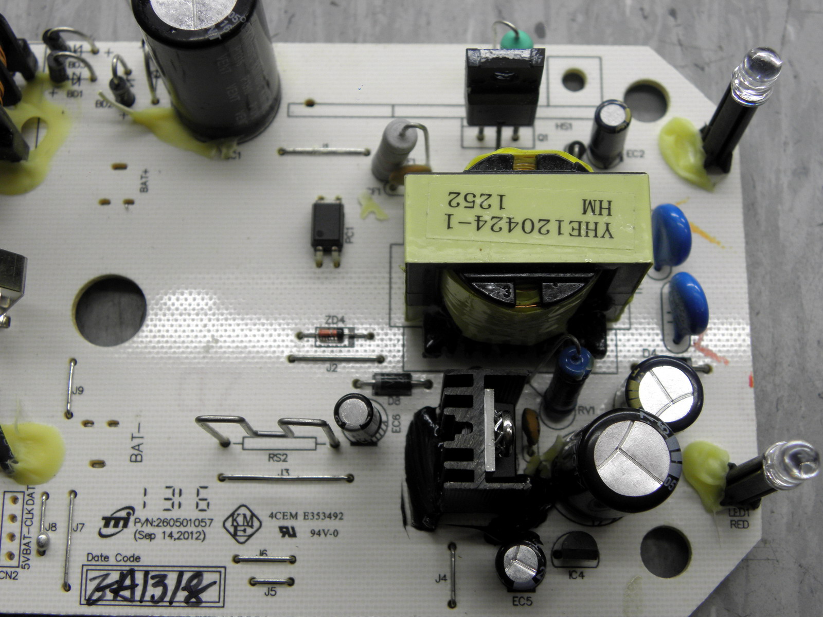

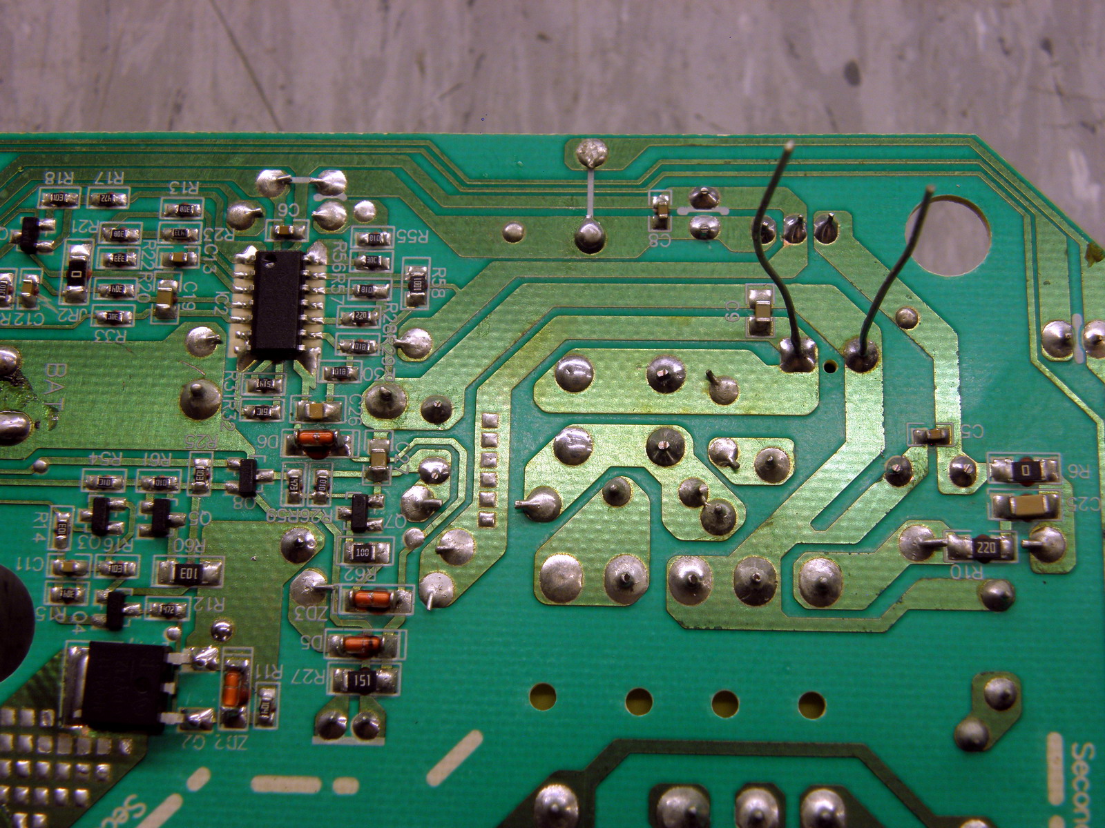

                I'm repairing same charger. It came to me with broken primary (diodes, mosfet, pwm ic, gate resistors) and shorted secondary diodes + mosfet. I have replaced all parts and now its pumping (secondary voltage rises to about 30V, then restart, red led blinks). For regulator mosfet i used:
                http://www.farnell.com/datasheets/19...648.1413390707
                Any ideas?
                  • 31065
                  voltage is over, did you check all the resistors etc?
                  also did you replace the zener across the fet?
                  the only other thing, i think there was a 431 voltage reference that may be bad.
                    TL431 was replaced, all zeners are ok (not shorted). I also replaced optocoupler. Can somebody check primary gate resistors? I replaced both but i want to be sure they are correct..
                    • sulc
                      • Jan 2013
                      • 9
                      • EU
                      Some pictures...

                          Originally posted by sulc
                          Tall zeners are ok (not shorted)
                          they may not be operating at the marked voltage.
                          you either need a zener tester of some kind, or just replace them.
                            • 31065
                            btw, you need to check every resistor around the switching controller.
                            when you blow that chip, some resistors get damaged.
                            and make sure your new heatsink isnt touching anything.
                            there is a reason i cut one side off mine!
                              Anyone has values for SMD zeners?
                                • 31065
                                the only one that gets blown afaik is across the surface-mount fet, it's 18v.
                                i posted the datasheet
                                voltage is printed on them anyway.
                                    That one I replaced with right one just to be sure (old one has knee at about 18V when testing so it seems it was good).
