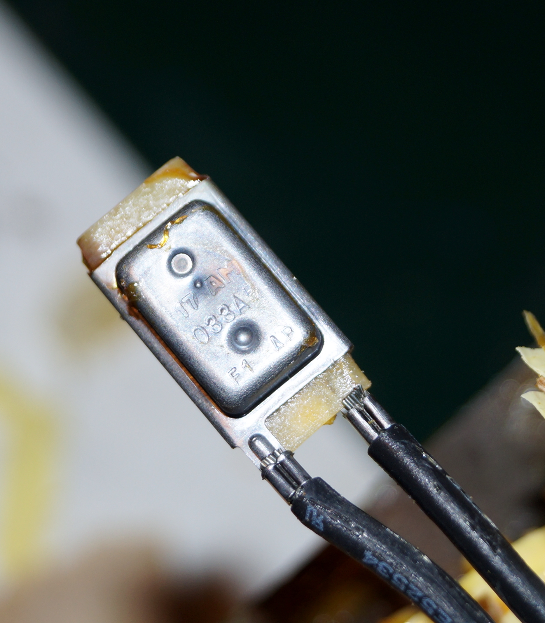

Re: Identifying Part from Schematic
Just out of curiosity, what resistance do you measure? And what fuse did you use?
I'd say it's not impossible to use separate transformers, you'd need to find the right wattage...
Identifying Part from Schematic
Re: Identifying Part from Schematic
Have done, on the AC socket it's 0.L on all points. On voltage selector is 0.L on points, aside from 2 which depending on position of switch, so that seems fine.
The primary windings on transformer all have resistance with one another.
Any idea on a replacement transformer? I'm guessing it's difficult due to dual different output voltages, 55ac and 12vc?
Would it be possible to use two seperate transformers? I have plenty of room and can mount another inside chassis.Last edited by mikay786; 12-19-2015, 03:57 AM.Leave a comment:
Re: Identifying Part from Schematic
If you disconnect the primary winding from the circuit and then check the resistance between the terminals where the primary winding wires of the transformer were connected to, the resistance should show infinite resistance, but more likely you have bad transformer with shorted turn.Last edited by budm; 12-18-2015, 02:54 PM.Leave a comment:
Re: Identifying Part from Schematic
good, based on statistics the rest of us wont see one for a year!
Leave a comment:
Re: Identifying Part from Schematic
This is my 2nd in a month!Leave a comment:
Re: Identifying Part from Schematic
I put in a 400v 25a rectifier, then found out I have a dead transformer. Lesson is always test transformer before worrying about and spending money on things further down the line.you could just put a 200v 25a rectifier in knowing it's over-rated.
got a foto of the one you have for size comparison?
btw, shit design - it needs a couple of fuses on the outputs from the rectifier or caps.
as it is, if you have a shorted output transistor it will overload everything until the mains fuse blows - or something else does!Leave a comment:
Re: Identifying Part from Schematic
Yep disconnected output side so just transformer on its ownLeave a comment:
Re: Identifying Part from Schematic
I thought he had the secondary disconnected from the board...you could just put a 200v 25a rectifier in knowing it's over-rated.
got a foto of the one you have for size comparison?
btw, shit design - it needs a couple of fuses on the outputs from the rectifier or caps.
as it is, if you have a shorted output transistor it will overload everything until the mains fuse blows - or something else does!Leave a comment:
Re: Identifying Part from Schematic
you could just put a 200v 25a rectifier in knowing it's over-rated.
got a foto of the one you have for size comparison?
btw, shit design - it needs a couple of fuses on the outputs from the rectifier or caps.
as it is, if you have a shorted output transistor it will overload everything until the mains fuse blows - or something else does!Leave a comment:
Re: Identifying Part from Schematic
I would probably disconnect the transformer completely and measure resistance of primary first before continuing to blow up fuses...tested the filter caps and they seem fine, kinda of torn the transformer apart now !! well just the outer layers to see if there was a short up top.
Well another lesson for the future, ill see if I can put it back together later and tried without connecting to switch. Erm would I just wire directly to the socket bypassing the voltage selector?
But from what you describe it really seems to be your transformer. I think I never had a faulty low frequency transformerLeave a comment:
Re: Identifying Part from Schematic
tested the filter caps and they seem fine, kinda of torn the transformer apart now !! well just the outer layers to see if there was a short up top.
Well another lesson for the future, ill see if I can put it back together later and tried without connecting to switch. Erm would I just wire directly to the socket bypassing the voltage selector?Leave a comment:
Re: Identifying Part from Schematic
No, I didn't. You mean the film caps and the ac selector?Leave a comment:
Re: Identifying Part from Schematic
Just to make sure, you tested the primary side also disconnected , right? There is still a switch and a capacitor on the primary side which could be at fault.Leave a comment:
Re: Identifying Part from Schematic
are there any less powerful options if this original is too hard to replace?Leave a comment:
Re: Identifying Part from Schematic
I don't think that's the problem as is blowing fuses, just done a continuity test and all the primary cables have continuity between them!Leave a comment:
Re: Identifying Part from Schematic
That is the thermal protection device in case the transformer winding gets so hot that it may catch on fire, this device will cutoff the power to the transformer winding. That device should show <1 Ohms between the two leads.Attached Filesif you find these attachements useful please consider making a small donation to the site
Last edited by budm; 12-18-2015, 01:39 PM.Leave a comment:
Re: Identifying Part from Schematic
I got it from avforums, someone posted it up on there. Not been able to find anything else.Leave a comment:
Re: Identifying Part from Schematic
There's nothing on it apart from sticker saying 185230533, lucky it has markings on the board or would have absolutely nothing to go on.
I feel this is going to be difficult!Leave a comment:
by Steph.henHi all, a newby question about a bridge rectifier I'm trying to identify.
I'm in the midst of reparing a battery charger in work which went pop, The bridge rectifier has shorted and took out a couple of other components. The rectifier in question has a part number KPB305G, and it looks like it's obsolete. Does any one know what I could replace it with?... -
by mpn78Hello
My Fujitsu Esprimo Q556 motherboards blew up. At least fuse, bridge rectifier and capacitor got damaged. I have changed fuse and bridge rectifier (DF1508S), but I don't know what capacitor it is (picture). I know that capacitors size is 47nF, but I don't know other specs for it. Can you help me to choose right capacitor for my motherboard?
There is 240V AC on input side of bridge rectifier and 340V DC as output on capasitors side.
Thanks.... -
by EasyGoing1I have a 40 volt AC transformer that I put a bridge rectifier on, and I wanted to see the input signal and the output signal on the same screen on my scope, so I set one channel up with the test lead on one side of the input and the ground lead on the other side of the input, then I used another channel on the scope and clipped the test lead on the positive side of the output then the ground on the negative side of the output.
When I connected the transformer to power, the wire that was connected between the ground lead on the second channel and the negative side of the bridge rectifier... -
I’m working on a Dewalt DCR020 jobsite radio that won’t power on.
So far, I’ve checked the following:- The mains is reaching the transformer
- Transformer outputs ~15-20 V AC
- Bridge rectifier outputs ~15-20 V DC
- All fuses test OK
- The on/off button signal reaches the PCB connector
Despite this, the unit does not power up at all.
Inside, I’ve identified some of the ICs:- ST7317 (appears to be an LCD driver, not the main MCU)
- LM2937L (voltage regulator)Not putting out power, 0.5V on the input
- Markings like FS1235, unknown IC
- Board number:
30 Photos-
Channel: Troubleshooting Audio Equipment
by mikkele86hello.
I have two power amplifiers, both having their IGBT blown on the PSU.
The original mounted IGBT where marked with IRGB20B60PD1PbF and the gate driver is a IR2156STRPBF.
I looked at mouser and digikey and could not find any available IRGB20B60PD1PbF and somehow ended up using a Bourns BIDW20N60T.
I replaced the gate driver, the gate resistor and both IGBT. But as soon power is turned on, both IGBT shorts out completely (gate, emitter, collector) and the fuse on the AC line gets killed.
So I though i missed a capacitor or diode. I removed... - Loading...
- No more items.
Leave a comment:
