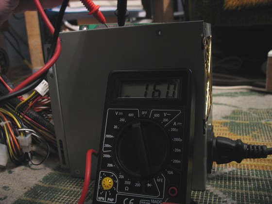

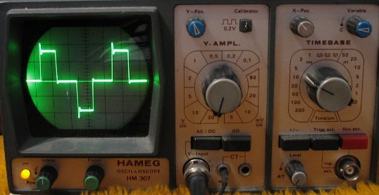

    first of all let's see how does output from ups looks when it's powered from the battery:

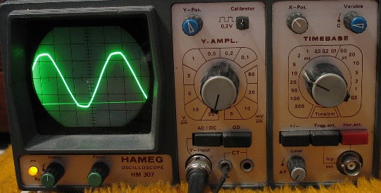

    it's a freakin' square(apc calls it "Stepped Sine Wave" meh)....comparing it to mains
    we can also see square has larger amplitude(square needs to have larger amplitude to produce same power as sine).

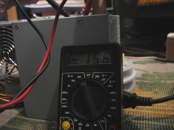

    now to measure voltage on those caps, to see if this sqaure pos is overloading them. first off let's see voltage when we're powering the psu off the mains:
    and another cap(enermax has some small discrepancy between the two caps)

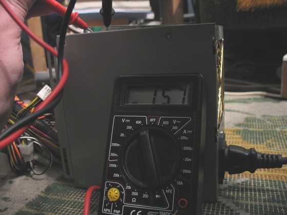

    now let's see what happens when we serve it that square:
    only the (square) voltage peaks are charging the caps, so it's natural to have increased voltage here...bulk caps on both enermax and fortron are rated 200V...let's see the other cap
    within specs, but barely....now let's see fortron (with passive pfc)..mains powered:

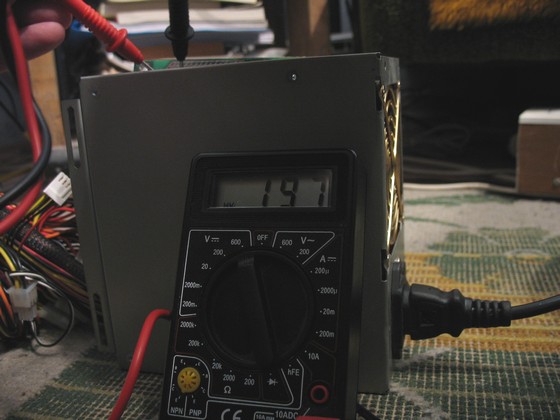

    and now ups powered
    uhm...that's more than these caps are made for.
    conclusion; don't use non-sine ups for too long.

    2 x 200v in series = 400v
    i didnt understand why you have 157v mains.
    your ups sounds ok
      and 2 x 213 = 426V
      <wink>
      mains 157V?
      "first off let's see voltage on bulk capacitors when we're powering the psu off the mains"
      bold added now(only thing i was measuring was voltage on caps)
      it's apc ups, yeah, but i didn't know it was producing such a simple waveform, i thought that at least it got few more 'stairs' between 0 and the peak.... but it's the same all across the ups market...'true sine' models aside...

      on silverstone's pdf 1000VA ups produces almost 100V overshoot...woohoo....

                      1. The PC input caps can only charge up to the peak value of the waveform no matter whether square, triangle or sine.
                      2. The UPS square wave peak voltage should not be more than the normal sine, if it is there is a problem with voltage control in the UPS. The pulse width does not vary, it is fixed at a well establish peak to RMS ratio. The peak voltage is set by the voltage of the DC supply for the output switching transistors, this voltage should be controlled by voltage regulation so if it is not right it is either not adjusted correctly or there is a fault. Where the sample of output voltage is taken for control will depend on the design.
                        no.
                        my device is working properly ie just as it was designed to, but the problem is, it's wrong design.
                        this situation repeats with ALL ups' (measure voltage on yours) so it's not a malfunction of any sort....
                        they are simulating rms of sine by increasing peak of this square rubbish.
                        true, solution should be to have same peak value as sine, and to compensate(to have same rms value) width of the pulse should be extended, so it looks more like this

                                  what we have concluded so far is that 220V "Stepped Sine Wave" ups' are overloading psus when they're powering the system from the battery.

                                        i think per was wrong on 2 accounts:
                                        1-why take 470V example and not others? you have ups' doing (the voltage on caps) from 408 to 497V on those examples.
                                        2-per said only one capacitor is used, but i think that's not correct:
                                        http://www.kronjaeger.com/hv/hv/src/mul/
                                        it's visible both caps are used and each only need to do 1xUp.
                                        the issue is the following: some ups will produce bigger overshoot than others.
                                        those closer to peak of sine(at about 170V for 120V grids) will fare better than those that produce more.
                                        either way, measuring voltage on the caps tells us if they're overloaded or not.
                                        different ups=different results.
                                        as for values it seems to me peak for sine is rated value x 1.41(sq.root of 2), so for 120 this is about 170V and for 230V it's about 320V.
                                        my measured values on caps (which is half the peak) of 157,160 and 156V confirm this.
                                        so as starfury wisely notices, voltage on the caps should be same in both cases.
                                        at 230V grid you have peak(320V), and at 120V grid you have peak(170V) doubled, which brings us to 320V or 340V "to chop".
                                        in both cases each cap is taking half the load so about 160V-170V.
                                        (grid voltage is not precise science at all...some european grids are closer to 240, some to 220, 120 standard seems to mean "100-127V" etc.
                                        http://en.wikipedia.org/wiki/Mains_e...Voltage_levels )
                                        with that out of our way, we still can't say for sure what 120V ups are doing.
                                        if they're doing same thing as these 230V models (most probable, i think) then you have same net-effect, and that is overloading the caps.
                                        for 120V grid that would mean the following:
                                        to compensate for shorter pulses (they employ in this square configuration) they're increasing the amplitude, nearing the 200V peak(or going over it) and therefore endangering the caps in psus.
                                        one thought: this is easily solved by putting 300V caps.
                                        for active pfc psus that use one cap only there's no easy solution on the psu side.
                                        dunno if active pfc design could be accomplished by usage of two caps in series(?).
