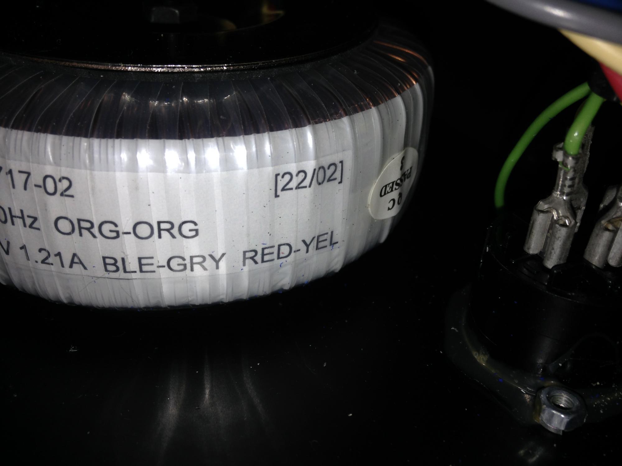

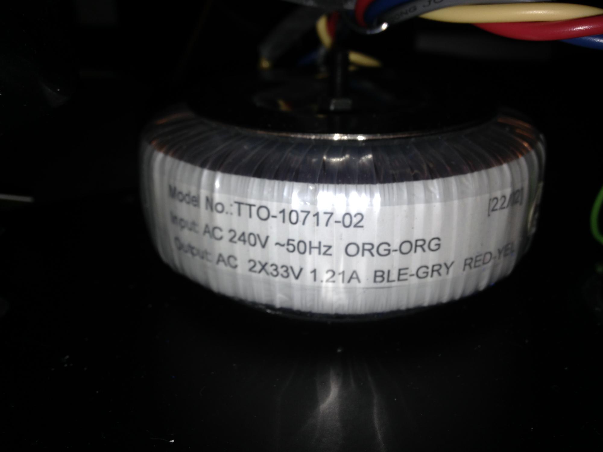

OK, so the transformer has 1 primary winding with Orange wires for the primary winding, input AC rating of 240VAC @50Hz.
It has TWO secondary windings:
First secondary winding has 33VAC rates @ 1.21A, the wires color are Blue(BLE) and Gray (GRY), VA rating of 40VA (33 * 1.21 = 39.93VA).
The Second set of the secondary winding has 33VAC rates @ 1.21A, the wires color are Red (RED) and Yellow (YEL). VA rating of 40VA (33 * 1.21 = 39.93VA).
So the transformer VA rating is about 80VA.Last edited by budm; 11-22-2015, 10:11 PM.Never stop learning

It is a step down transformer, you will have to connect the two secondary side with correct phasing (see the DOTs on the spec sheet) since they will be formed into 25-0-25. (two of the wires will be connected together. Look at you board to see which two Male terminals are tied together.
The terminals on the board are labeled to tell you which color wire goes to where, right?
BTW, the transformer probably has shorted turn.Last edited by budm; 11-22-2015, 10:38 PM.Never stop learning

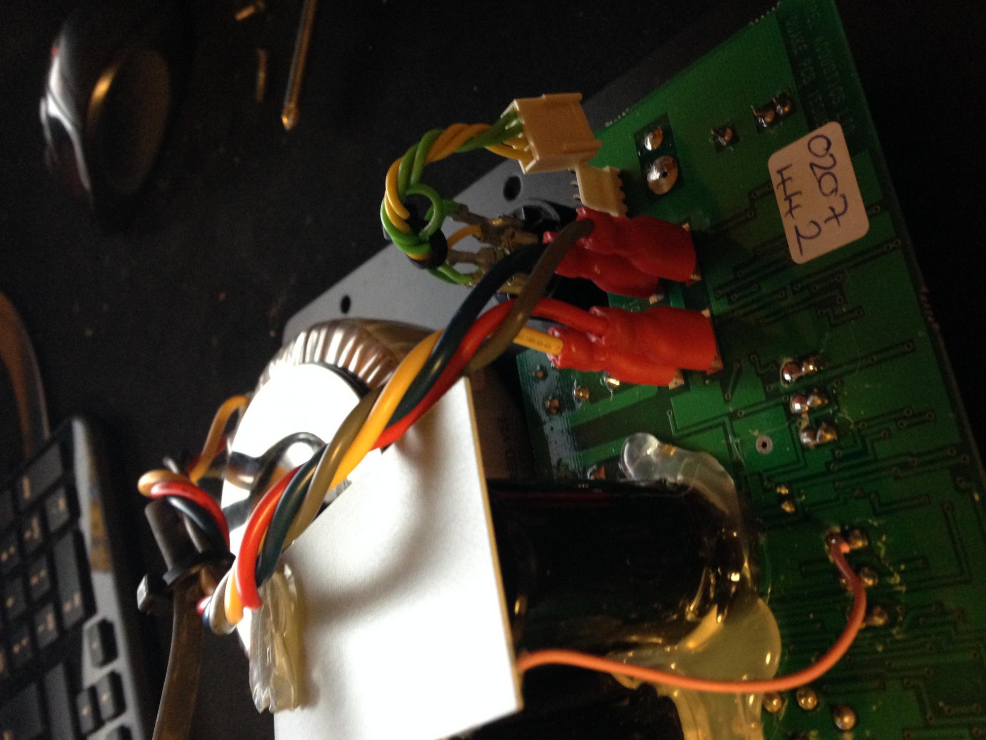

No it's not labelled on the board but I took a picture before hand
(thank god)
There's plenty of room it's pretty much empty space in the cabinet, downward firing sub. Better going with the more powerful one?Attached Filesif you find these attachements useful please consider making a small donation to the site

With the 25V you will not get the same power output as the original 33V, the 30V one will be closer. Lower Voltage = Lower power output.Last edited by budm; 11-22-2015, 10:55 PM.Never stop learning
