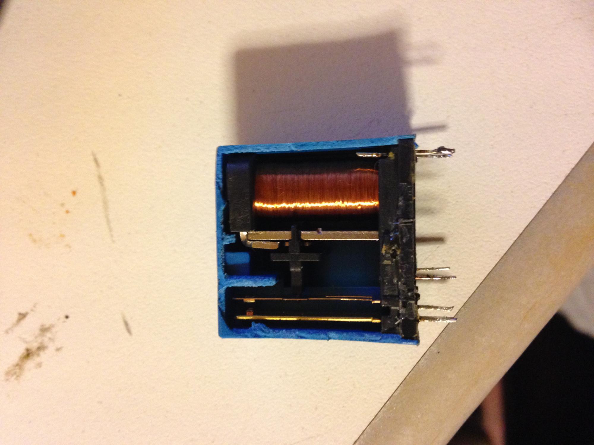

    Re: Should a transformer live/neutral pins have continuity?
    Yea one side has been cut off

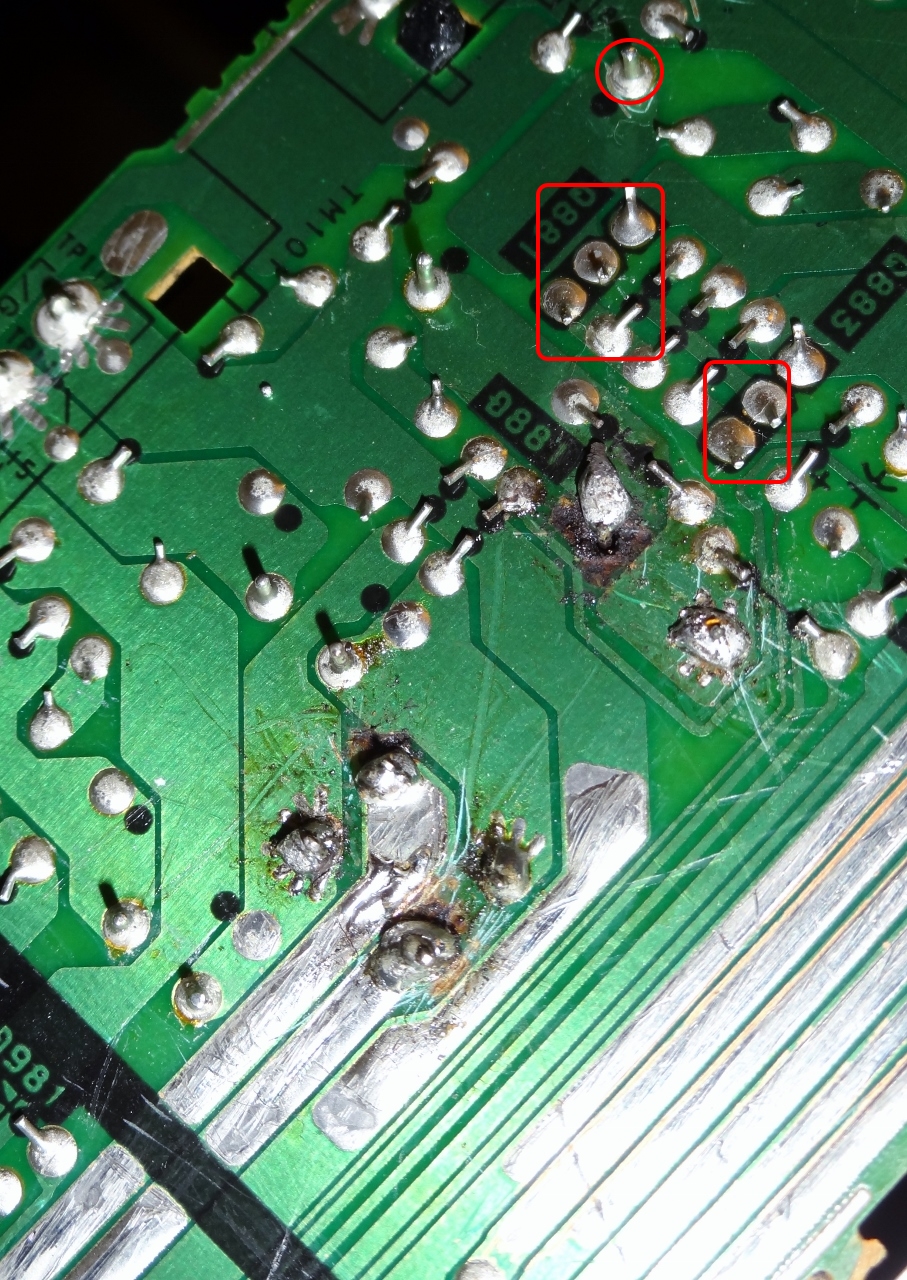

      Lots of bad solder joints with crack ring on the solder around the components'legs.
      • mikay786
        • Aug 2014
        • 765
        That is pretty shocking soldering, whwere do you see the ring fracture?
          If you look at STK-XXX IC legs, you will probably see some there too.
          When I work on these I always look through all the boards and redo the joints, and make sure all the board mounting screws are tight because the boards are GND to the chassis with mounting screws.
            measured the two rubycons. One is measuring 48uF and the other 98uF so one deffo dead
            Found one joint on the speaker terminals completely removed from pad taking pad with it looks to be either a grounding or just a support pin perhaps.
            Not impressed with the assembly of the unit, way too much flex in the board and nothing really secure.
              i cant imagine cutting the side off a relay like that just to save a few coins!
              some people are too cheap for their own good!
                  I'd start with the power amp finals circuit, check caps, resistors and fuses there.
                  Audio boards in general aren't made that well in my experience. Crappy solder joints and weak bond between traces and board are pretty common. Too easy to lift pads and traces with a little too much heat. They often aren't laminated and multi-layered like computer boards are so they flex more too.
                    Where should I explore next?
                    Re-solder all of those joints budm pointed to, and possibly any others you find suspect. Generally, that would be all of the larger components or components mounted on a heatsink.
                    And wow! Who worked on that unit?! Did they by any chance use a hot chisel or something along those lines to solder? Amusingly terrible job at best!

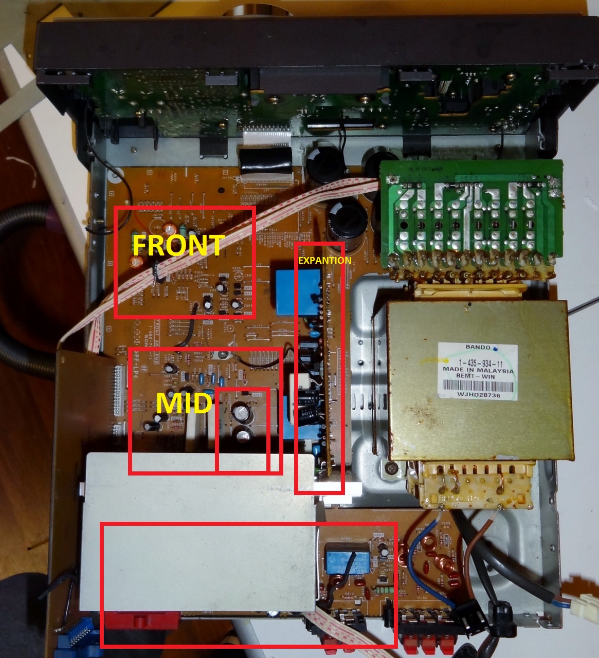

                        Found 5 dead caps so far at the rear of the unit by the terminals
                        FRONT LEFT
                        jamicon 1 - 100v4.7uf @ 5.25uf
                        jamicon 2 - 100v4.7uf @ 5.33uf
                        nichicon 1 - 50v10uf @ 11.3uf
                        elna 1 - 50v0.47uf @ 468nf
                        rubycon 1 - 10v100uf @ 116uf
                        rubycon 2 - 10v100uf @ 113uf
                        jamicon 3 - 50v2.2uf @ 2.5uf
                        MID BOARD
                        elna 10v47uf @ 30uf
                        jamicon 10v47uf @ 15.5uf
                        nichicon 50v4.7uf @ 4.8uh
                        nichicon 50v4.7uf @ 4.9uf
                        rubycon 10v100uf @ 96uf
                        EXPANSION BOARD
                        not checked yet
                        REAR
                        jamicon 4 - 25v330uf @ 281.3nf
                        jamicon 5 - 16v470uf @ 23nf
                        rubycon 3 - 10v100uf @ 113uf
                        rubycon 4 - 10v220uf @ ...nf
                        rubycon 5 - 50v1uf@ 1uf
                        rubycon 6 - 50v10uf@ 11uf
                        jamicon 16v100uf @ 113uf
                        nichicon 50v47uf @ 53uf
                        rubycon 50v4.7uf @ 4.9uf
                        making some headway. Ive tried photographing where everything was and have kept caps separate in sections they were removed from but a bit worried I may misplace them when putting them back in. Does the service manual tell you locations of caps just in case?
