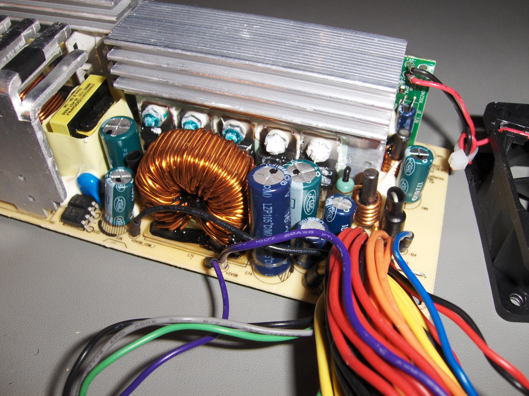

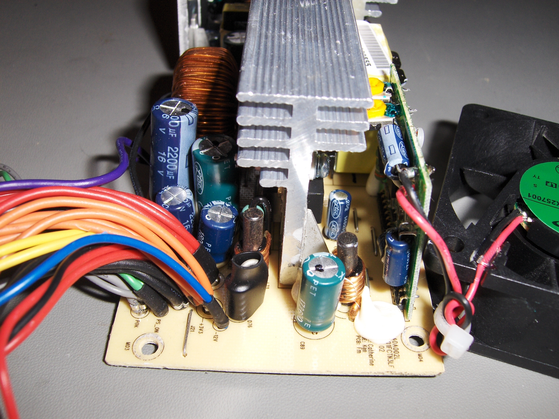

    We have these fail at work from time to time, had to do a teardown.
    All caps are Ltec and and Elite.
    Don't know if the N-channel mosfet STW12NK90Z failed first or the cap.

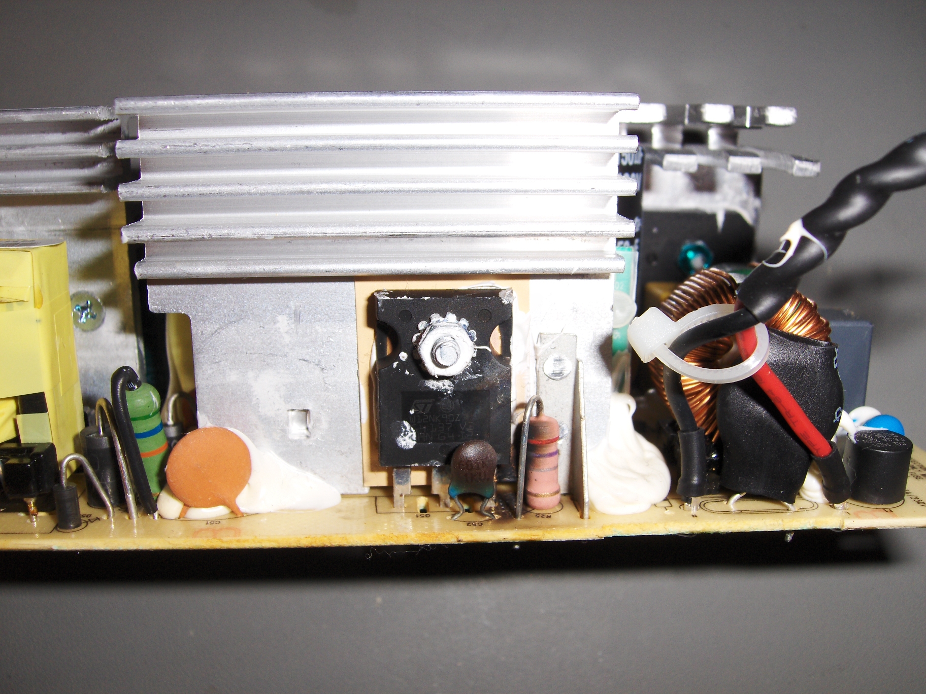

    Re: Dell Optiplex 990 psu H240AS-00
    you should check Q51 and R52 and replace C52
    • SteveNielsen
      Retired Tech
      • Jun 2012
      • 2327
      (R25 not R52) I'd be surprised if all three parts aren't shot and probably the transistor took them down. Solid state devices have short failures way more often than resistors and small capacitors do.

                there is a newer version of that supply with PFC that does exactly the same thing,
                the cause is the snubber cap overheating.
                you will need to check the fet, the snubber cap infront of it (it needs to be 2kv, but the original is 1kv) the fuse, the fuseable resistor to it's right,
                some fast rectifier diodes to it's left,
                and the driver circuitry for the fet.
                fet is W12NK90Z from ST
                the rectifier diodes can be replaced by UF4007
                and check the fan while your there.

                    • 31051

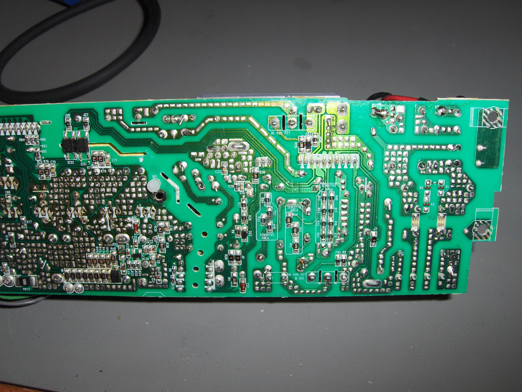

                    i think 790 is the newer one with pfc.
                    if it is, you will find a vertical pcb behind the fet heatsink that contains the driver circuits and a pair of electrolytics.
                    if those psu's fail, the 8pin driver chip will blow along with a few resistors and diodes etc.
                    also there are a few smd resistors under the main board that will burn.
                    you need to meter *everything* on the small board, and all resistors on the underside of the mainboard.
                    i said in another thread some time ago - these psu's are shit!
                    if you have working ones - upgrade the ceramic cap infront of the fet to 2kv or even 3kv before it fails!

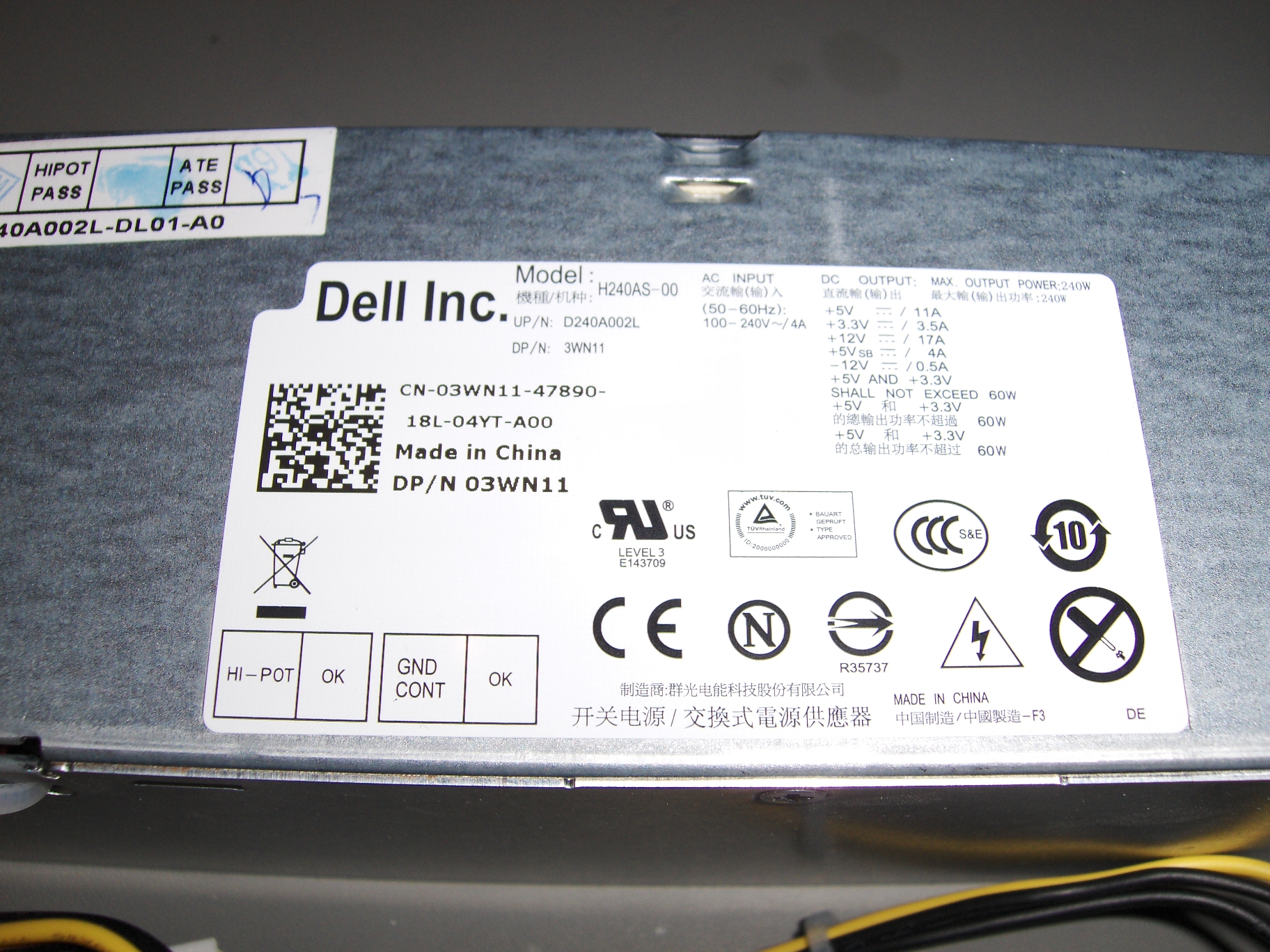

                          Hi.. I also have problem with the same PSU. Can I know the value of the ceramic capasitor since I can't see clearly. What i see is 681k, 1kv.. Is it right? Appreaciate your help. Thanks.
                          • Doc_u
                            • Apr 2009
                            Just had one of these go bad.
                            I can confirm that the cap is marked 681K (top line) and 1KV. (bottom line).
                            The resistor appears Pink in color, bands are Red, Violet, Silver, Gold.
                            Is there anything special I should know when replacing this?
                            Does anyone know the power rating for this part?
                            (I'm assuming it's 1 or 2 watts).
                            Any chance the FET is not bad?

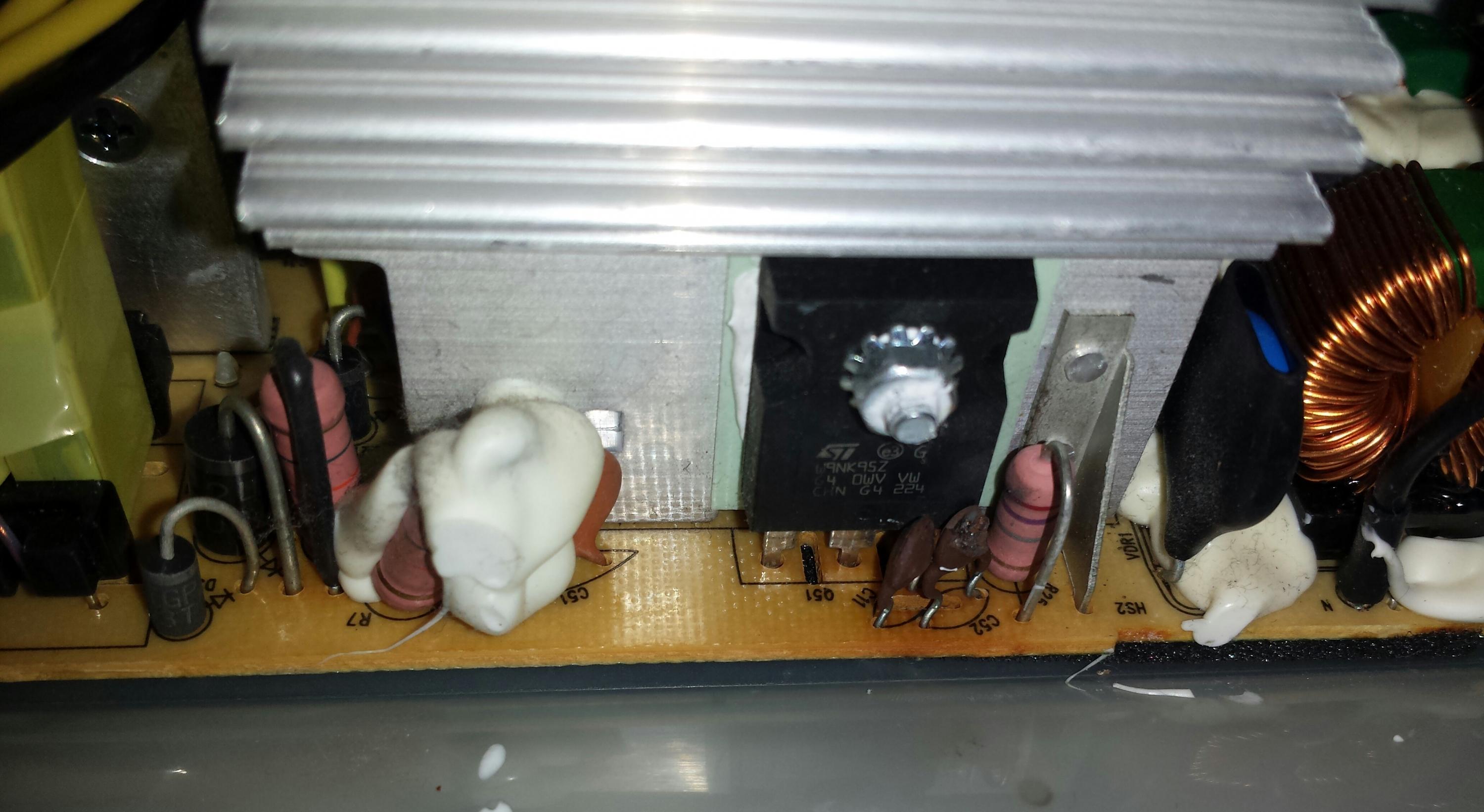

                              I had one of these go bad on me, same issue as above. What a hunk of crap. Lucky the listed value is here for the Ceramic Cap as mine popped into pieces.
                              • lotec25
                                • Feb 2015
                                • 5
                                Here is a pic of the cap in pieces

                                  H240AS-01 version has two identical capacitors at C52 and C11.
                                  Problem is still the same.

                                    Hey guys,
                                    I have 3 of these PSU to repair and i have the resistor blown, the transitor mosfet shorted and the fuse blown too, the 681k 1kv Capacitor still good but ill upgrade it to 2kv, and i will try to repair the other components, anyone know what dissipation is that resistor? 1watt? 2 watt? the value is 0,27 Ohm right?
                                    • Mandessa
                                      • Jan 2013
                                      • Thailand
                                      Hello hed190 I live in the south-east asia country,I have an experience to share with for the H240AS-00 PSU from Dell. For the problem you've asked ,You should also check some components on the board locate on P3xxA Connector behind the Q51(STW12NK09Z). From my experience,components on this board usually damage after the short. I use 470pf 2KV or 680pf 2KV (Blue one) instead of the old one.For R25,I use any value from 0.1 ohm to 0.5 ohm 1W wire wound or metal film type.
