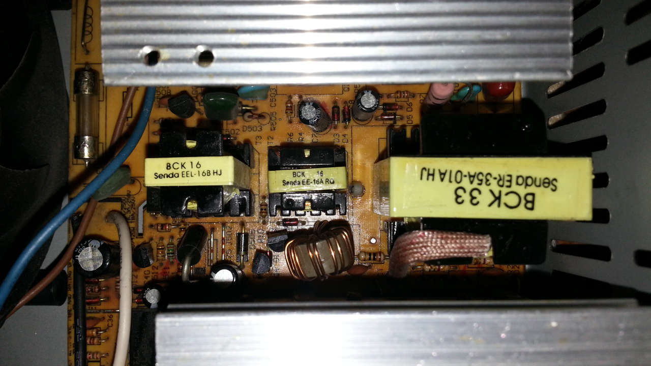

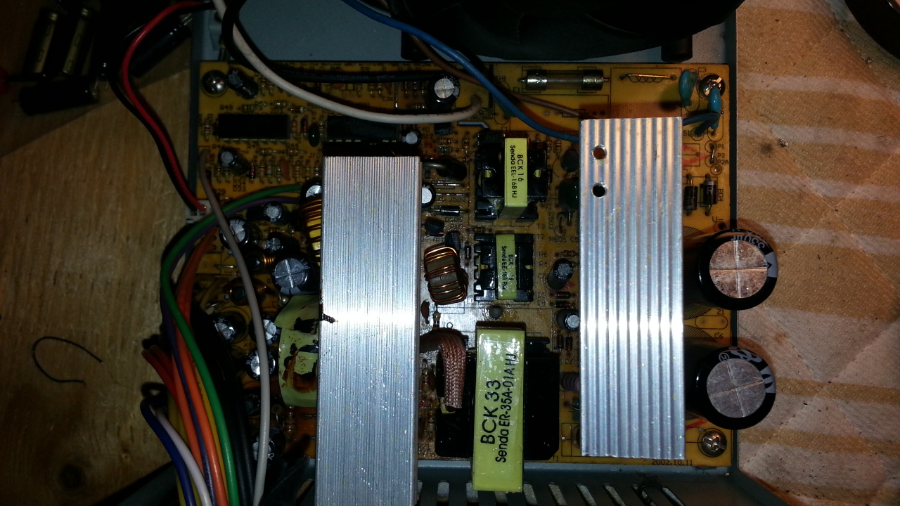

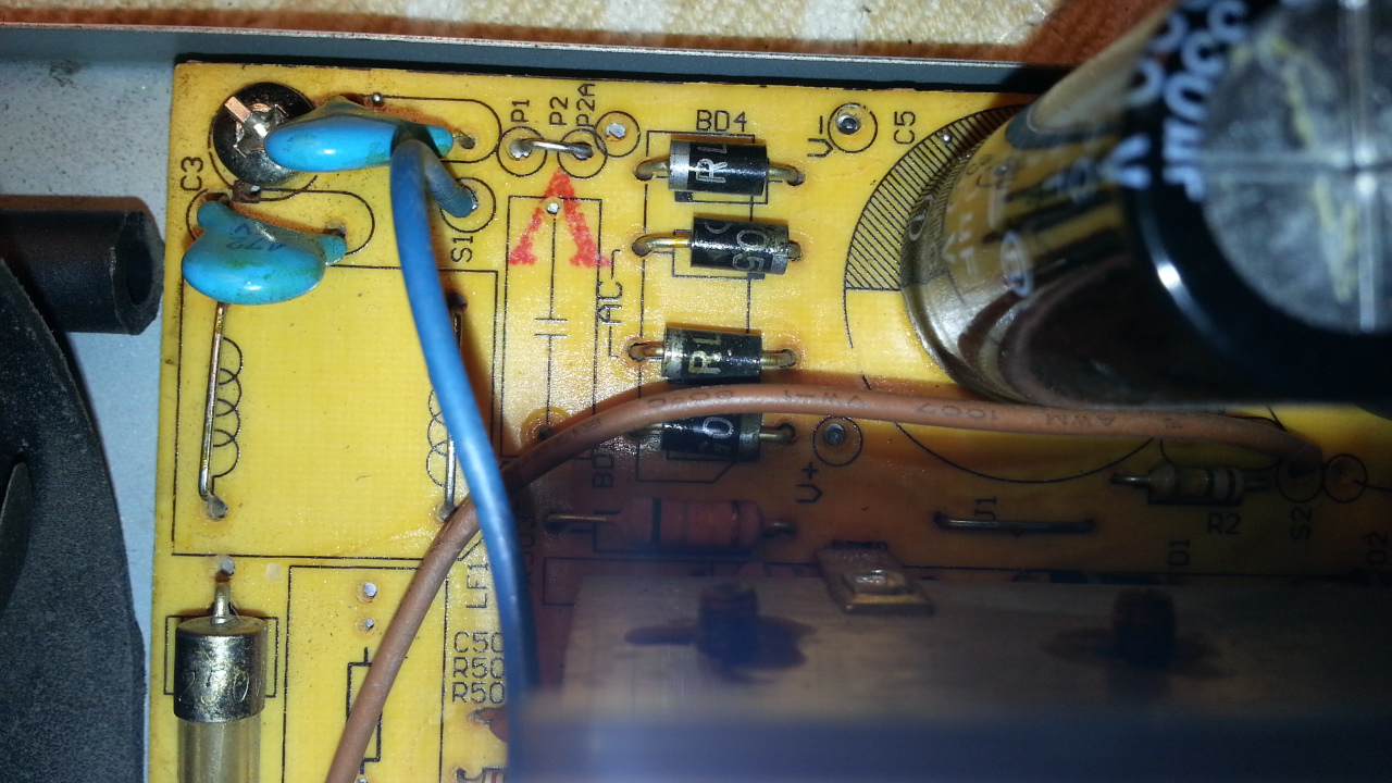

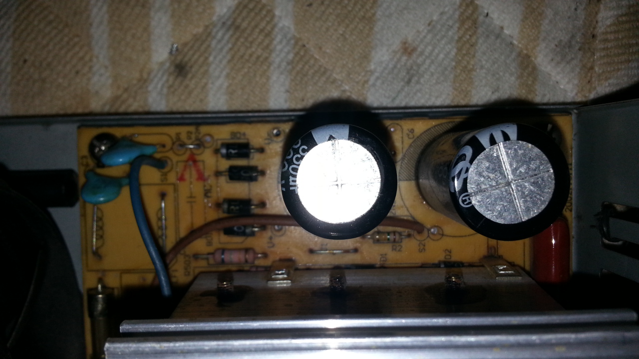

    There is a V+ and V- as seen in one of the pics which I think is voltage across the main filter caps and that measures 330v when plugged in and doesn't change when I jump the pson pin to ground on main connector. When I DO jumper it there is a short "chirp".
    I've changed out nine bulged caps. Where tollook/measure now ?

                  • RJARRRPCGP
                    • Jul 2004
                    • 6304
                    Re: Delta PS Only 5vsb No Secondaries
                    Looks like a fake Delta PSU.
                        I wouldn't call it a fake. They only used the name and didn't make any attempt to make it look like a real Delta PSU.
                        The output toroid looks burnt.

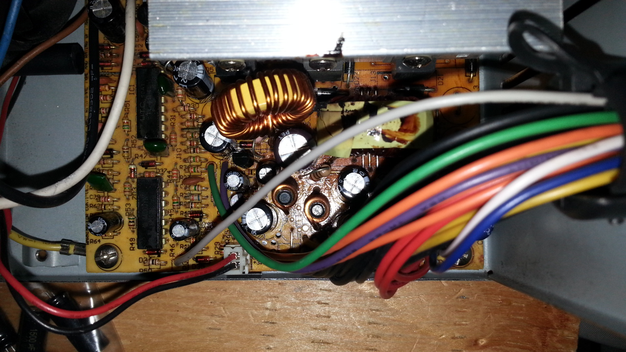

                        • mmartell
                          • Oct 2013
                          • 3189
                          What is that ? Transformer ?
                          There is a short. Thought it was the rectifier diode ? (heatsinked) but it was a smaller fast recovery diode in front of it that was shorted. Replaced it and stupidly put it all back together THEN tested again. There is still a short between each outer pin and the center pin on one of the rectifiers (my meter reads it as 50 ohms) where the other two don't do that. That part tested good out of circuit so I pulled a couple of parts up in the vicinity and can't find a shorted part.
                          Is that a normal reading for that rectifier or is there a spot I should be checking given the shorted diode I did find ?
                            Did you check the rectifier out-of-circuit or in-circuit? In circuit, the bleeder resistor for the +5v rail may be around 50 ohms, so you won't be able to measure the rectifier accurately.
                            On +5Vsb, replace the secondary electrolytics (1 or 2, typically 1000uF/10V) as well as a small primary-side electrolytic (typically 22 or 47uF/50V) near the auxiliary trafo.
                            If it still doesn't start up, unsolder and check all large secondary rectifiers and replace any that are shorted. Then check the primary switching transistors.

                              Checked it out of circuit and it checked fine. Are you saying that I SHOULD be seeing that 50ohms because I don't see it on the other two rectifiers maybe they don't have bleeder resistors ?
                              Is it possible to point out the bleeder resistor on one of the photos above ? I'd like to unsolder one of the legs to see if the short goes away. Thanks
                                • 31214
                                the load resistors are big ones mounted vertical near where all the wires come out usually.
                                • mmartell
                                  • Oct 2013
                                  • 3189
                                  Thanks stj, you nailed it. The resistor on the 5v rail traced directly back to the rectifier so I figured that would account for the measurements I was seeing. I put it back together and jumped pson and it came to life with all voltages. Only needed to replace one shorted FR153 diode.
                                  Thanks again!
