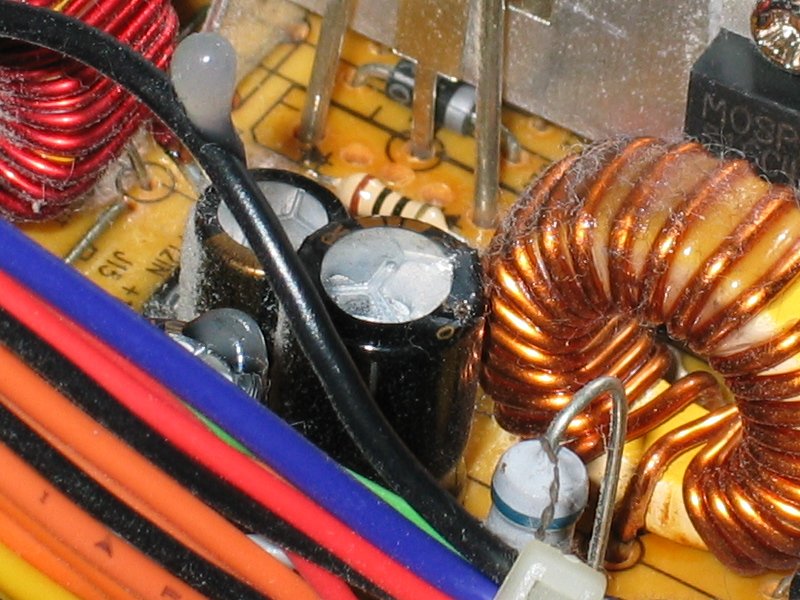

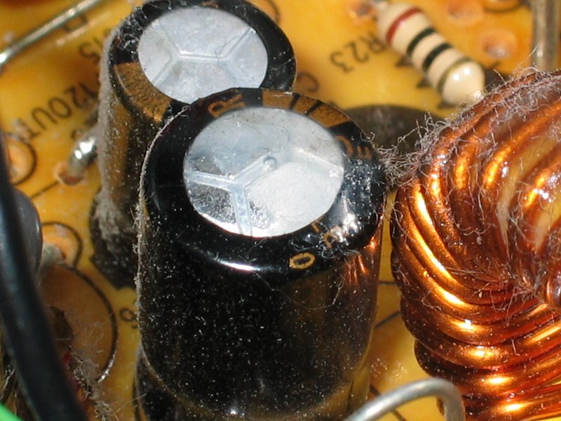

    A dead Premier LC-B300ATX...let's see what's inside

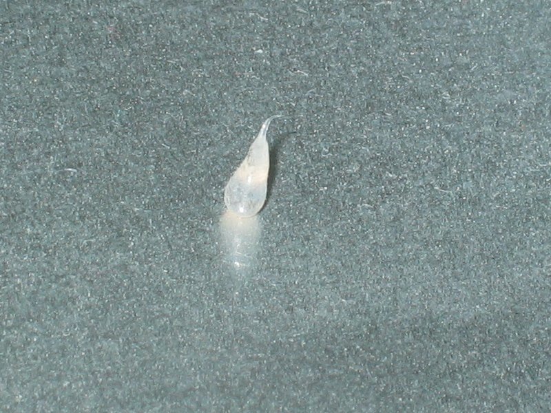

    WTF are drops of the hot glue everywhere?
    Hot glue was dripping all over the place

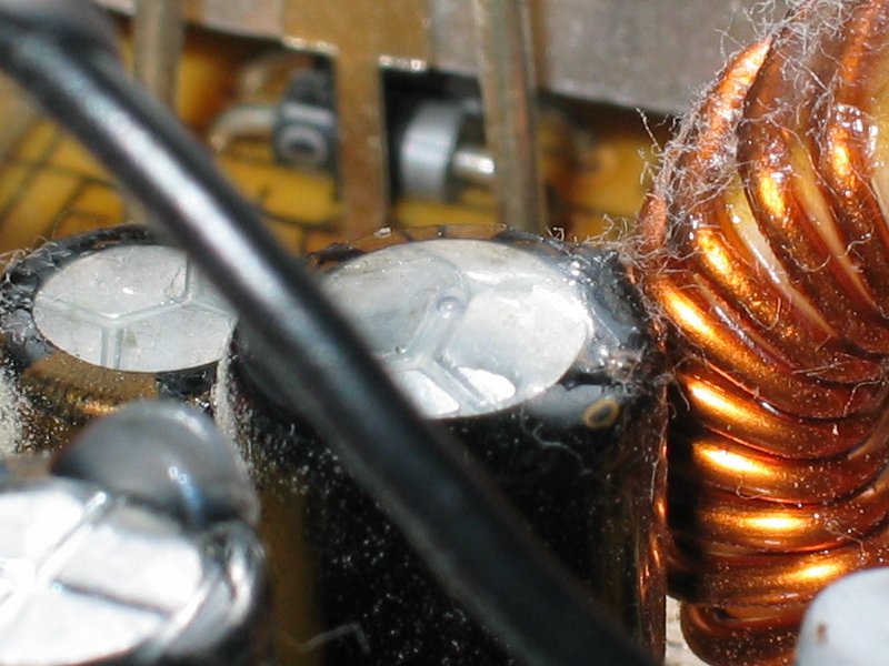

    A bulged cap
    Dust caught in the hot glue on the coil

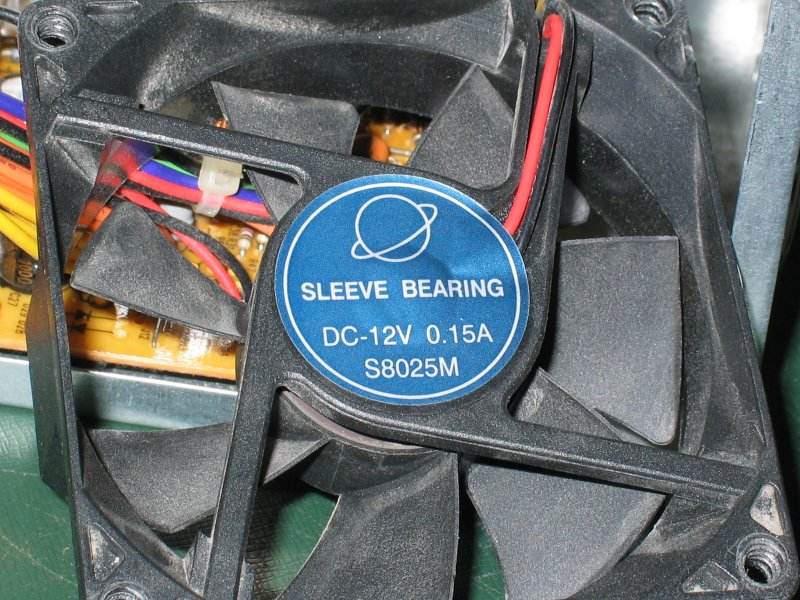

    A "high-quality brand-name" fan, completely stuck - that's why the hot glue is all over there

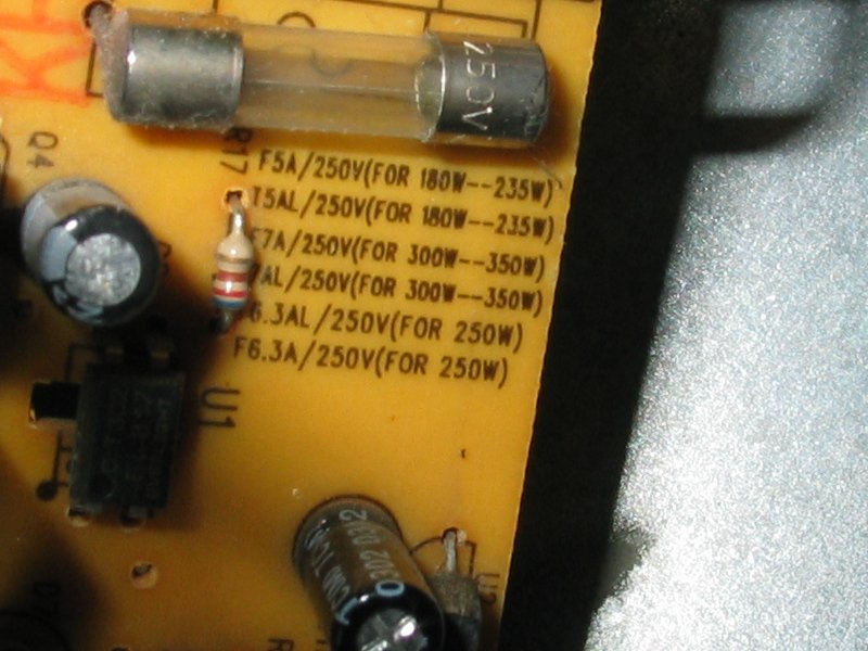

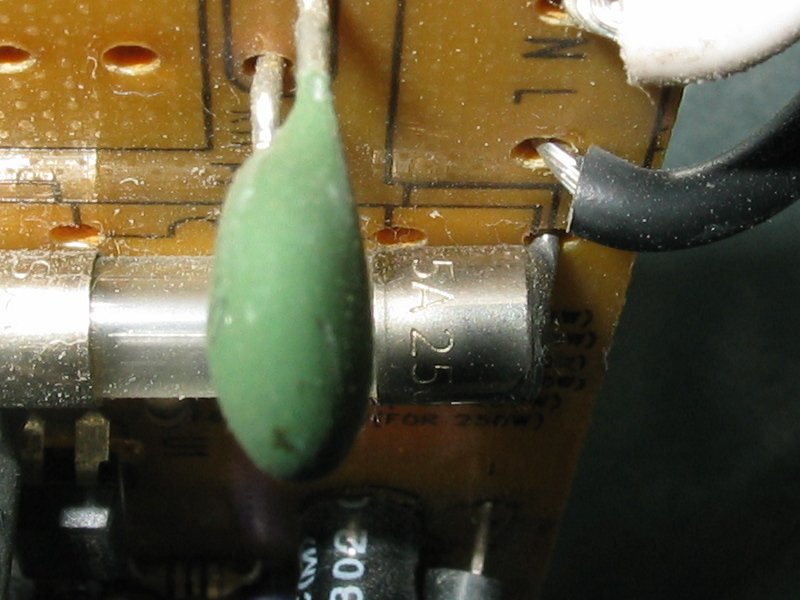

    5A fuse

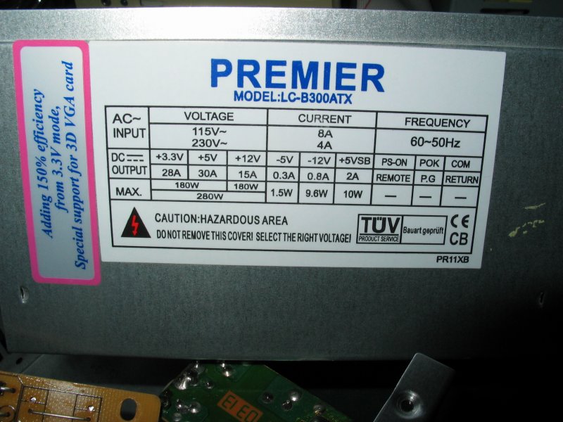

    The table says that 5A is for 180-234W PSU... The label on the outside says 300W
    Also the rectifier on 5V rail was shorted. No wonder - it was rated only 10A and even not tightened to the heatsink strongly enough.

    While it is low quality, odds are fair it would still be working if the fan hadn't seized up. Personally I always replace such fans, or on someone else's system if they are so cheap it's offensive I at least relube them - either of these being preemptive, at first opportunity before any signs of a problem with the fan.

      I already replaced the fan, rectifier (the "new" one is rated 20A - it comes from a crappy 200W PSU and is still better than the original one) and caps and it works.
      The fan runs fast (and thus loud) in these PSUs - which is probably needed to keep the temperature of the overloaded components down (~200W PSU marked as 300W).

            That's yet another Deer/L&C unit...
            "Special support for 3D VGA card" could mean that it has PCI-E +12V connectors on it.
            This label is another form of advertising...

                  Yes, another DEER PSU.
                  It doesn't have any special connectors - just standard 20-pin ATX and 4-pin ATX12V.

                    I have this (under L&C brand) recaped with Samxon GC's, was working fine with fanless VIA C3, but GC's aren't exactly for PSU's Currently changing them for some Nichicon, Rubycon etc. caps I have from my 500W Seasonic (mostly 1500 uF changed for 3300 uF there) and some MoBo's.
                    But this 15 A thing on 12V rail is laughable (or it's the 150% efficinecy again?)...I'd like to have at least 10 A (Thoroughbred-B 2400+, probably won't ever reach it, but you know), so the 10A diode rectifier is not enough I guess Good I have some old AT PSU's here
