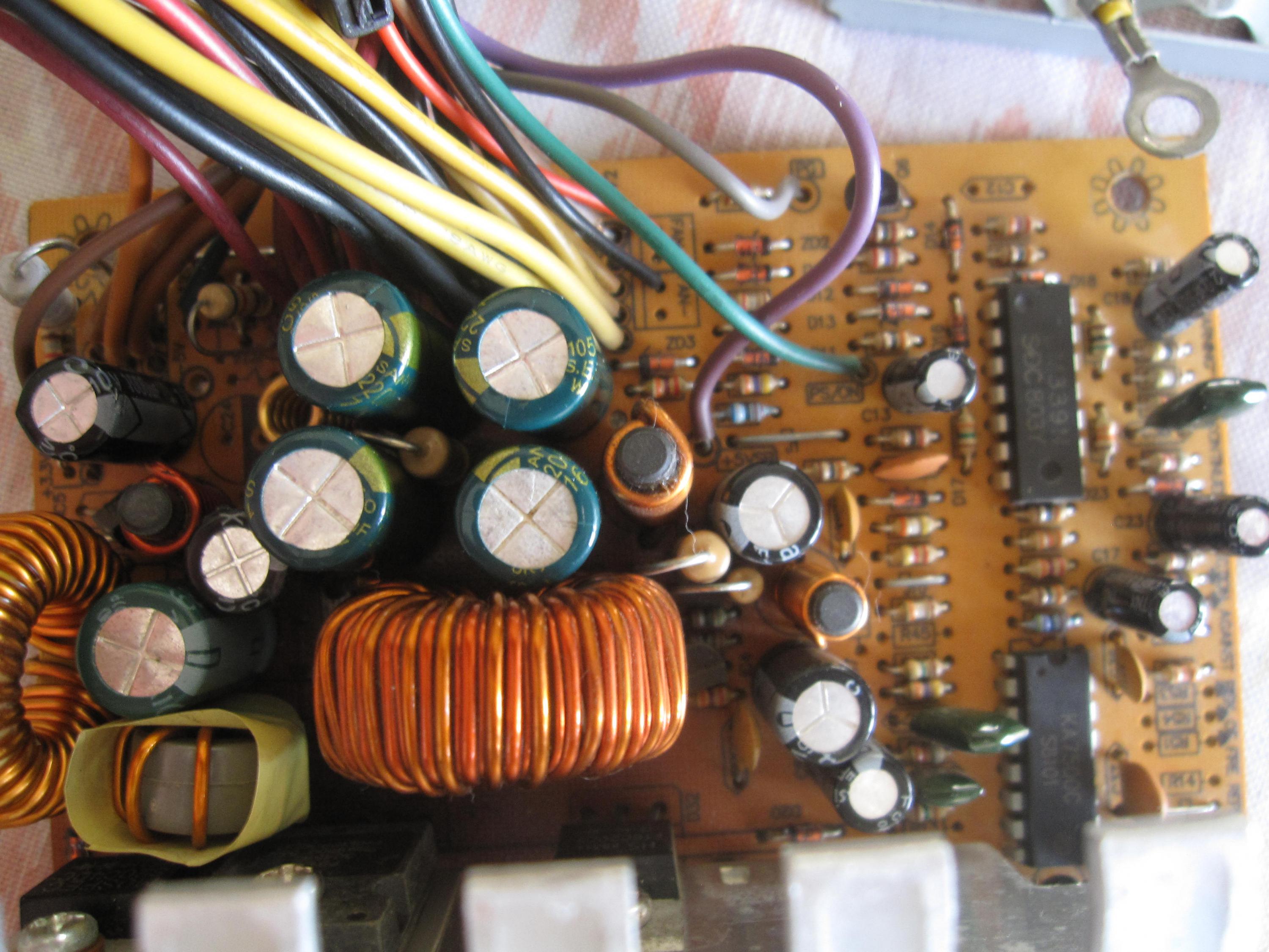

    Hello guys.
    Looks like +5vsb output only is very common problem with atx psu.
    First I had replaced three 10uf at 50v caps on primary side as esr was high. I give a try with light bulp and psu power on for 5 seconds all outputs and then shutdown. After then in every test I am getting only +5vsb.
    As this psu is quite similar to previous fixed model, I changed the inductor coil but the problem did not fixed.
    I have already made some voltages measurements at diodes, caps with esr, rectifiers etc.

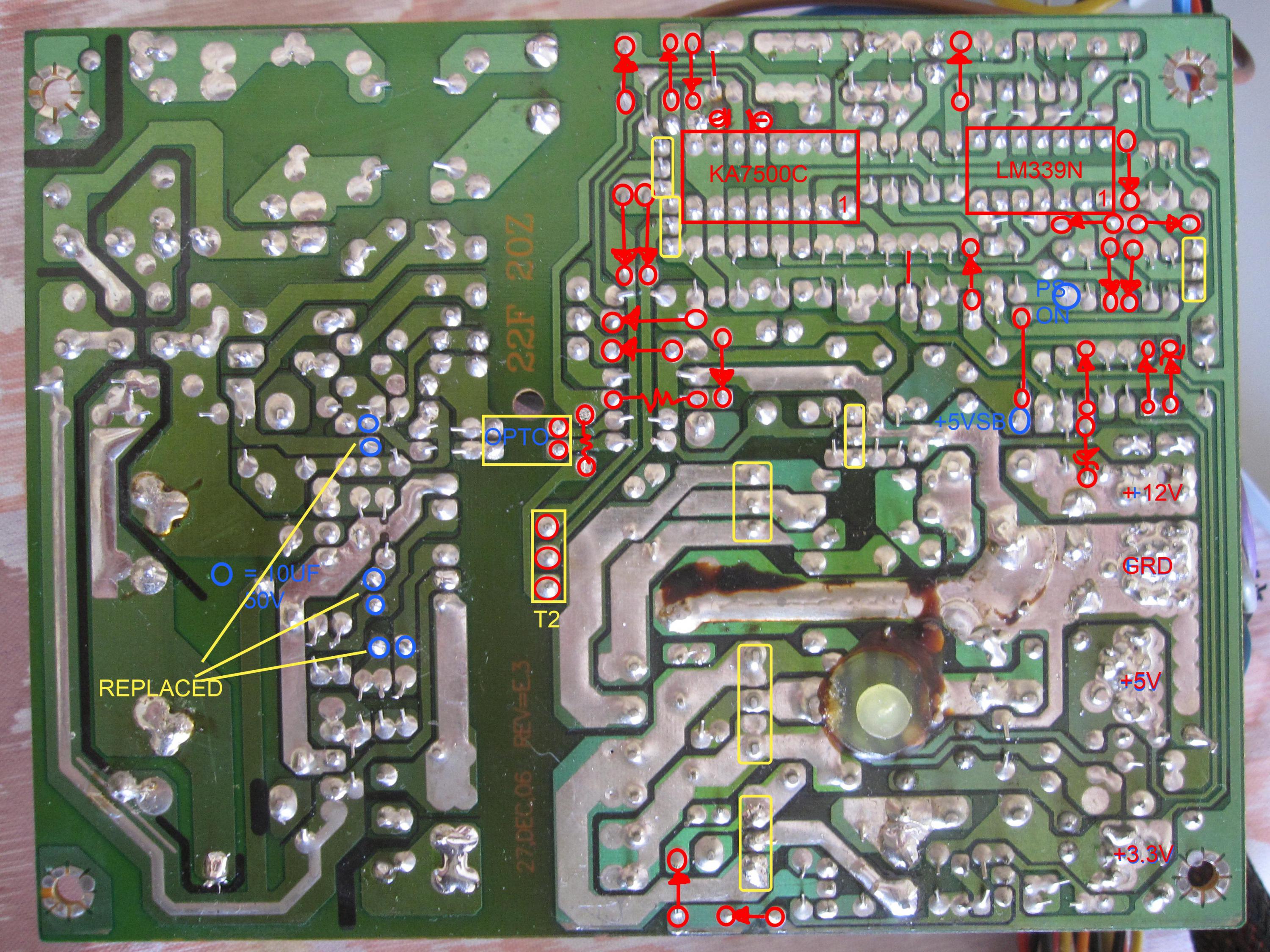

    Voltages at PS_ON state are:
    KA7500C
    1: 2.7 mv
    2: 4.868v v
    3: 105.3 mv
    4: 6.9 mv (3.369v on PS switching OFF)
    5: 1.642 v
    6: 3.620 v
    7: 0.8 mv
    8: 1.485 v
    9: 0.8 mv
    10: 0.8 mv
    11: 1.478 v
    12: 12.07 v
    13: 5.023v
    14: 5.023v
    15: 5.023v
    16: 08.mv
    LM339N
    1: 3.844 v
    2: 133.7 mv
    3: 5.024v
    4: 1.358 v
    5: 502.mv
    6: 1.4 mv
    7: 2.687 v
    8: 0.852 v
    9: 105.4 mv
    10: 2.208v
    11: 115.5 mv
    12: 0.7 mv
    13: 2.8 mv
    14: 2.8 mv
    OPTO volatges (PS_ON state)
    pin 1: 3.923 v
    pin 2: 2.783 v
    T2 transformer voltages (PS_ON state)
    pin 1: 4.688 v
    pin 2: 4.686 v
    pin 3: 4.703 v
    a) Green color at PS_ON state does not have any voltages, but on switching off state has 5.018 v
    In image 387 marked the points I have already checked.
    Can you please guide me what else can I check?
    Thanks a lot.

    What is the voltage in PIN 4, 8, 11 & 12 of KA7500C IC in Off_State ? Also needed Voltage of T2 Transformer's PIN 1, 2, 3 in Off_State .
    Also need a clear Picture of Image 387 without Text .

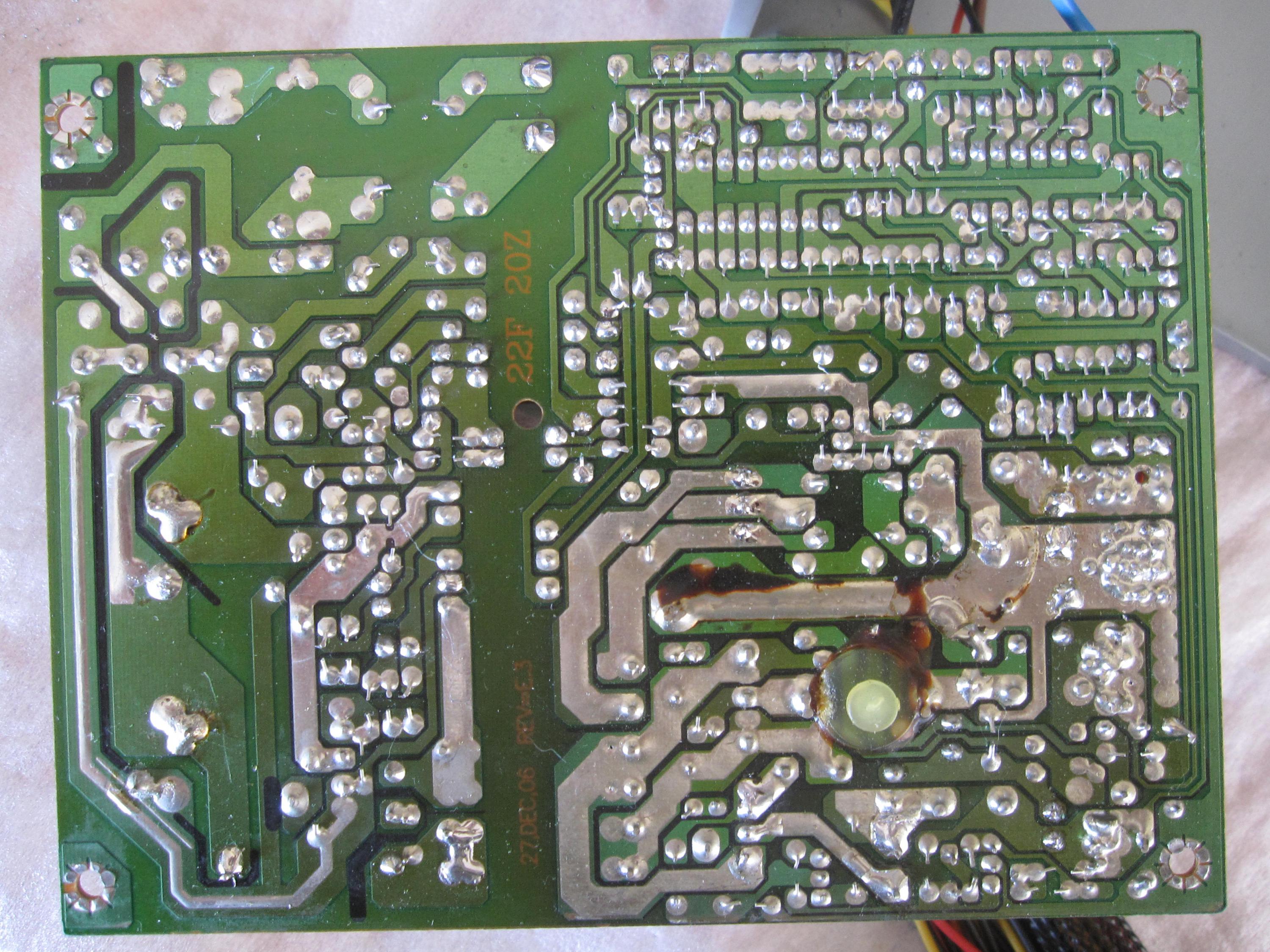

      That PSU looks like it runs seriously hot. Note the discolouration on the PCB. Did this PSU previously have its fan fail?

          It looks like your ground cable on mains transformer(the big one) is really bad burned. I would checks it If I were you. congrats on your repaired previously. I likes people with never give up attitude.

            I measured KA7500C IC voltages in Off_State and got:
            pin 4: 3.367v
            pin 8: 2.239v
            pin 11: 12.36v
            pin 12: 5.024v
            also on T2 transformer pins (1, 2, 3) got 1.490v
            Thanks !!!
