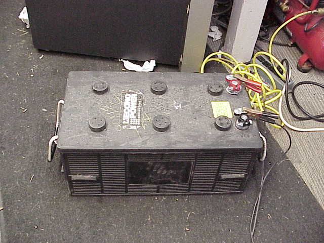

                                  • kc8adu
                                    • Nov 2003
                                    • 8832
                                    • U.S.A!
                                    Re: SmartUPS 700 will not turn on
                                    here is my ups battery!
