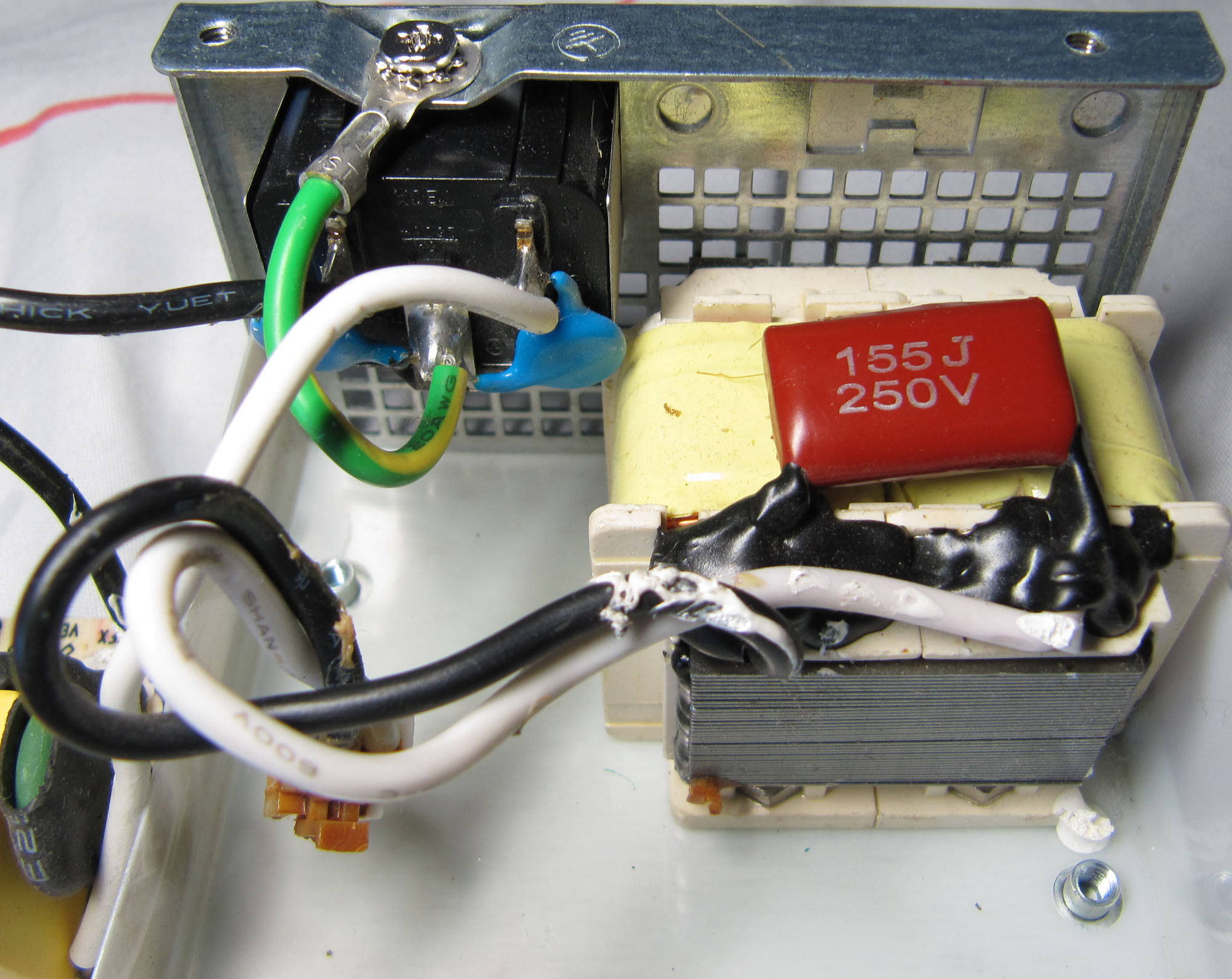

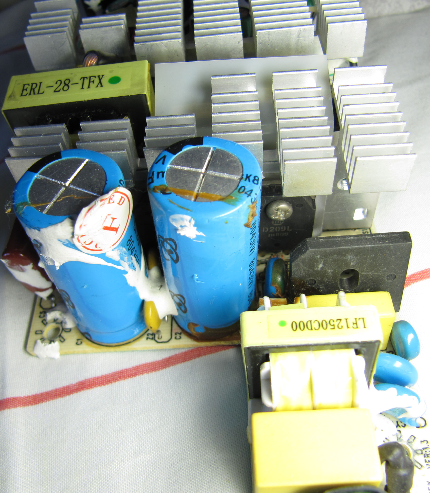

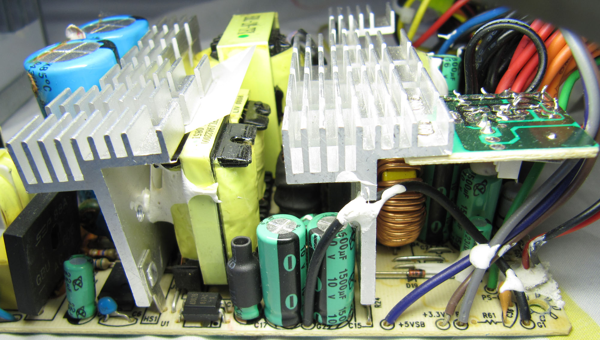

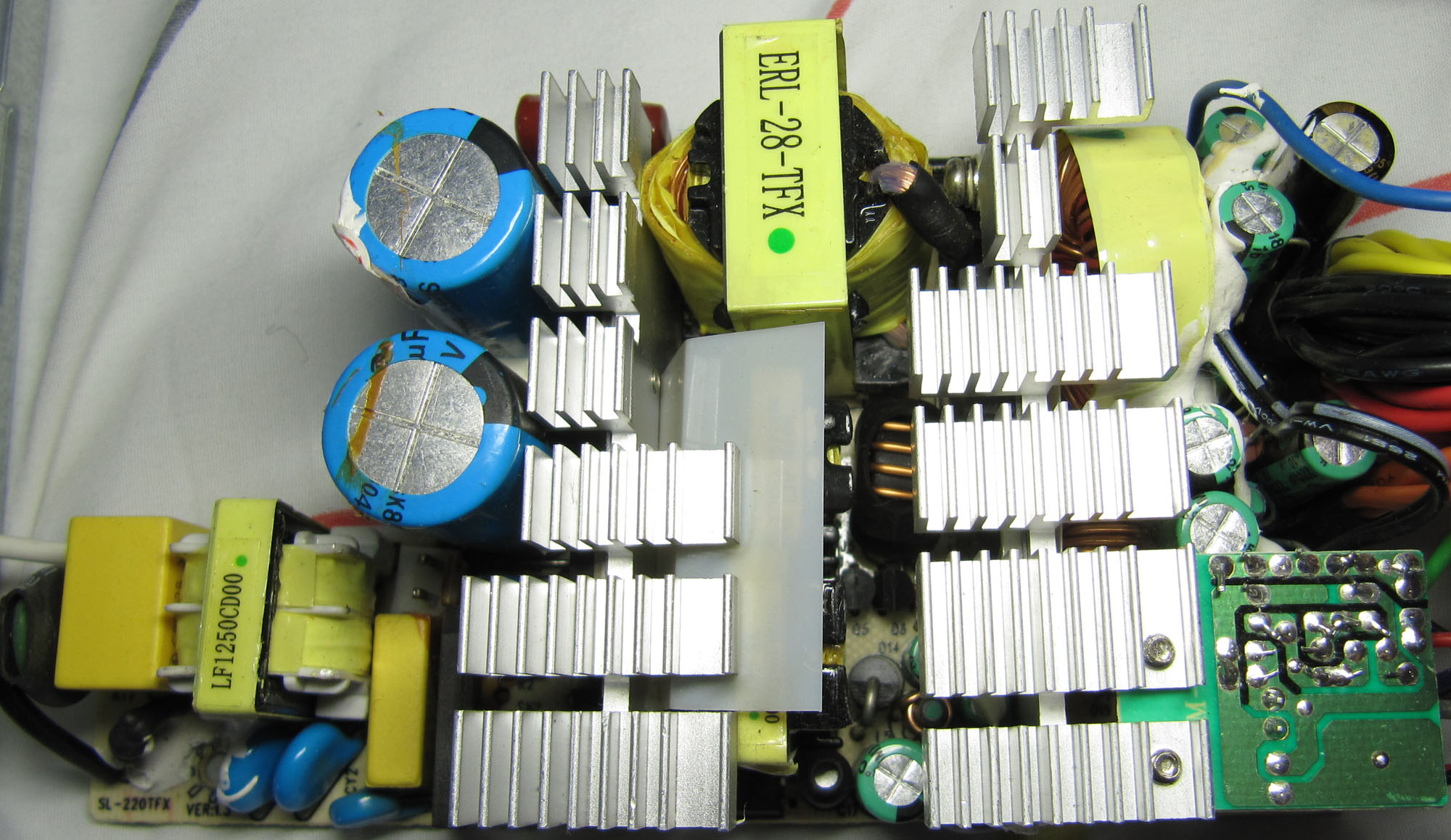

    This came to me dead. 5vsb was 1.21V, no burnt components inside, all the caps were tested in circuit and out of circuit when needed and were found ok.
    But let's see if it is worth repairing...

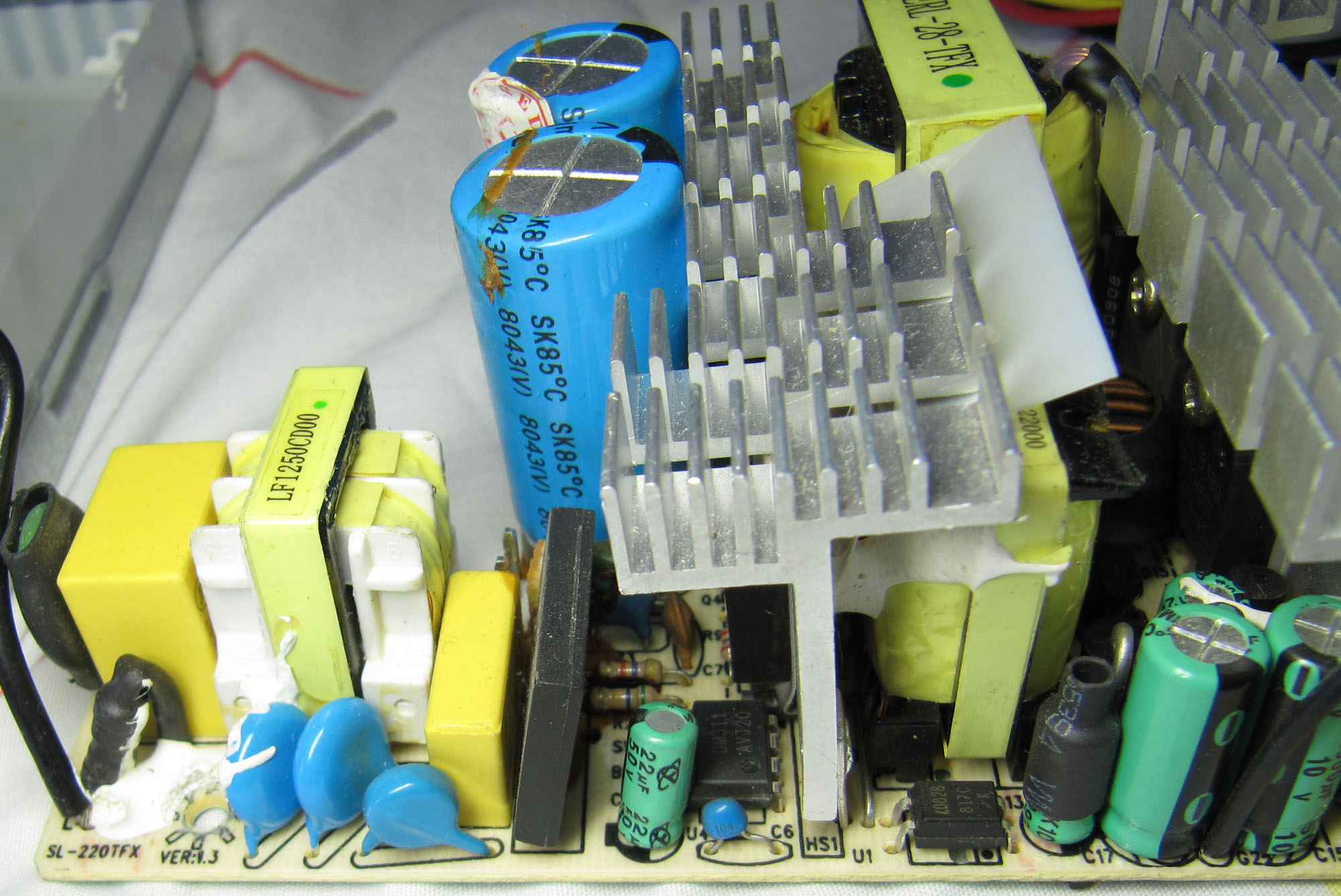

    -Passive PFC
    -Full input filter with 4 Y Caps and MOV protection!
    -GBU606 6A bridge rectifier

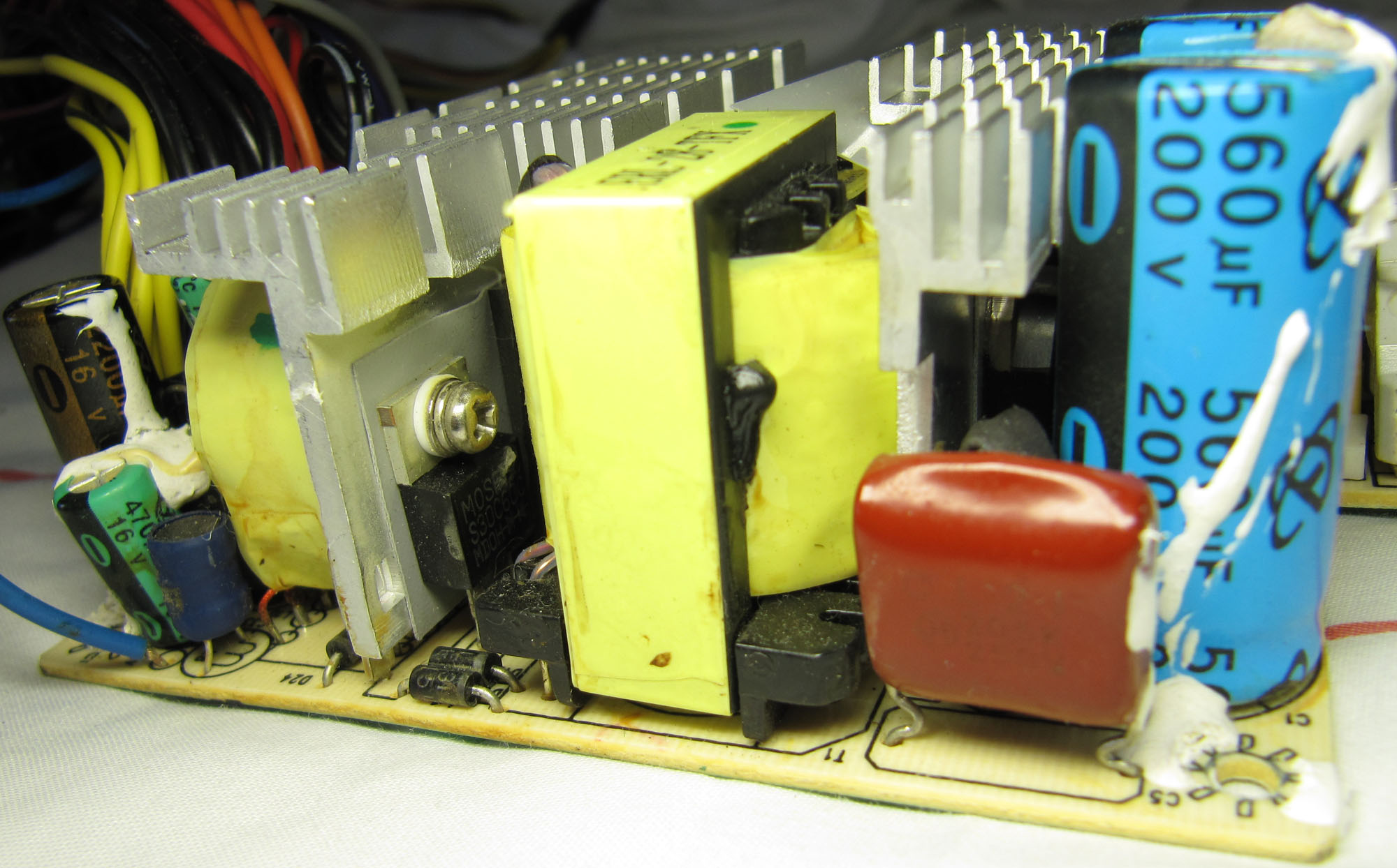

    -2x 560uF 200V YC caps. Their real capacitance is 505uF and 510uF, so they are in specs.
    -2x D209L (Ic = 12A, Ic pulsed = 25A)
    -DM311 IC regulates 5VSB
    -2005ASZ chip of the year PWM.
    -Adequate heatsinks for 300W
    -The soldering is not good. Long uncut leads could lead to short circuit
    -Sleeve bearing Globe fan thermally controlled from an add-on board attached to secondary heatsink.
    5vsb: 2x1500uF 10V YC

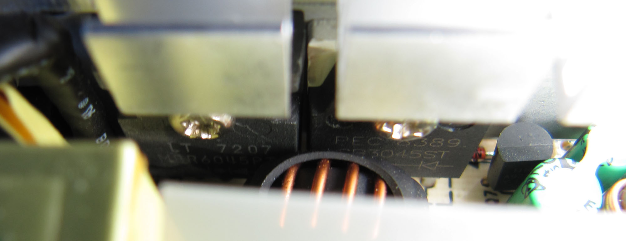

    -3.3V: SB3045ST (30A), 1x 10V 2200uF YC & 1x 10V 1500uF YC
    -5V: MBR6045PT (60A), 2x 10V 2200uF YC
    -12V: S30C60(30A), 1x 16V 2200uF YC & 1x 16V 1800uF YC
    The label claims it has dual 12V rails which is a lie.

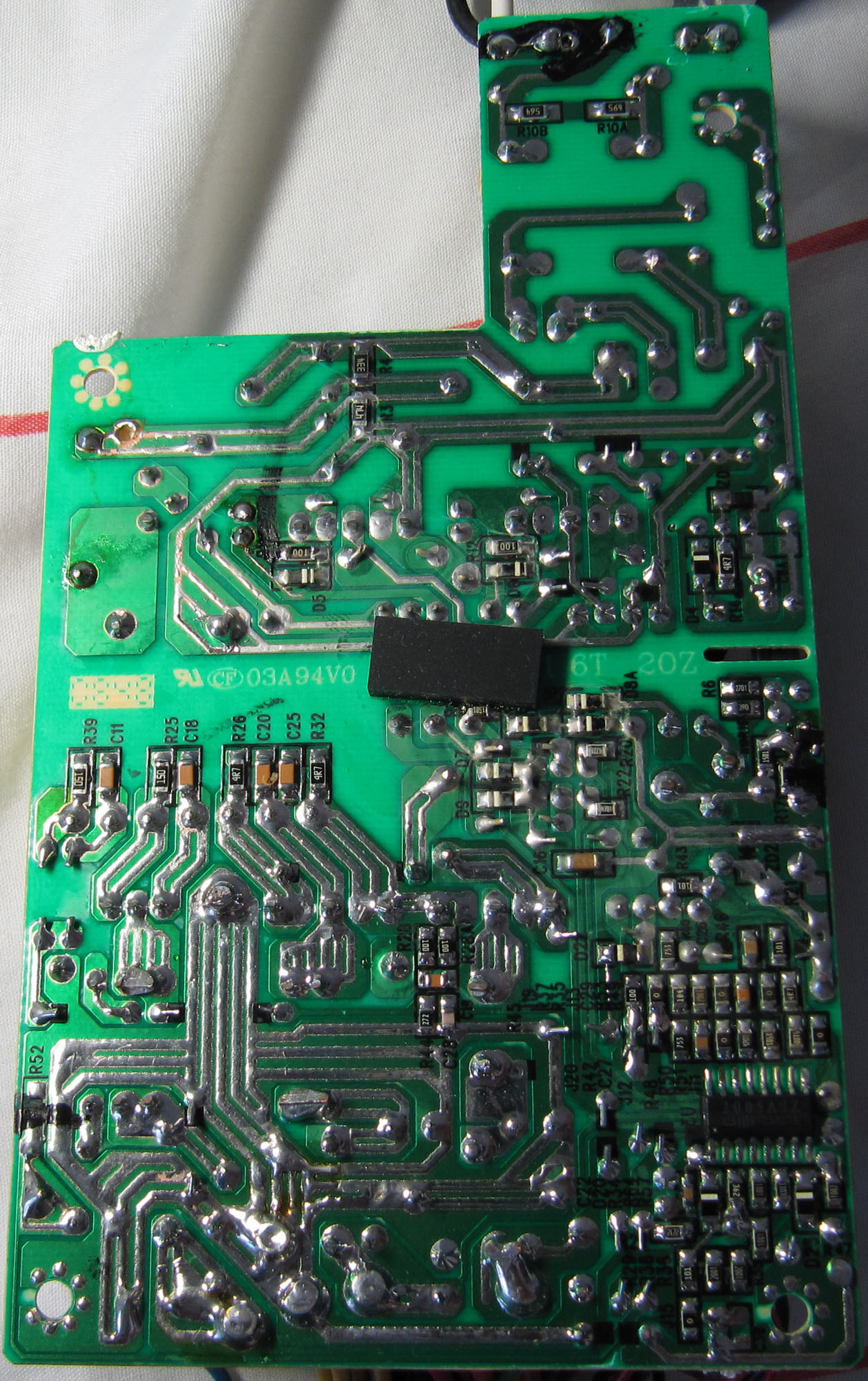

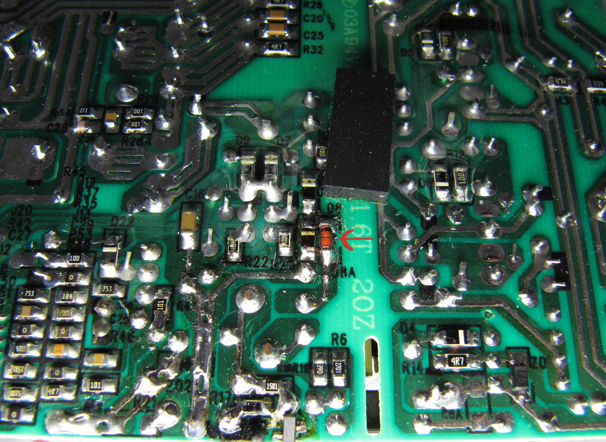

    I fixed it!
    There was an smd diode on the PCB that was shorted. The diode was in paraller with another diode that was found ok. I replaced it with a general purpose diode. The new diode is also smd, but bigger sized compared to the original. That will hopefully keep it from failing again.
    The 5vsb came alive and the psu works without any problem.

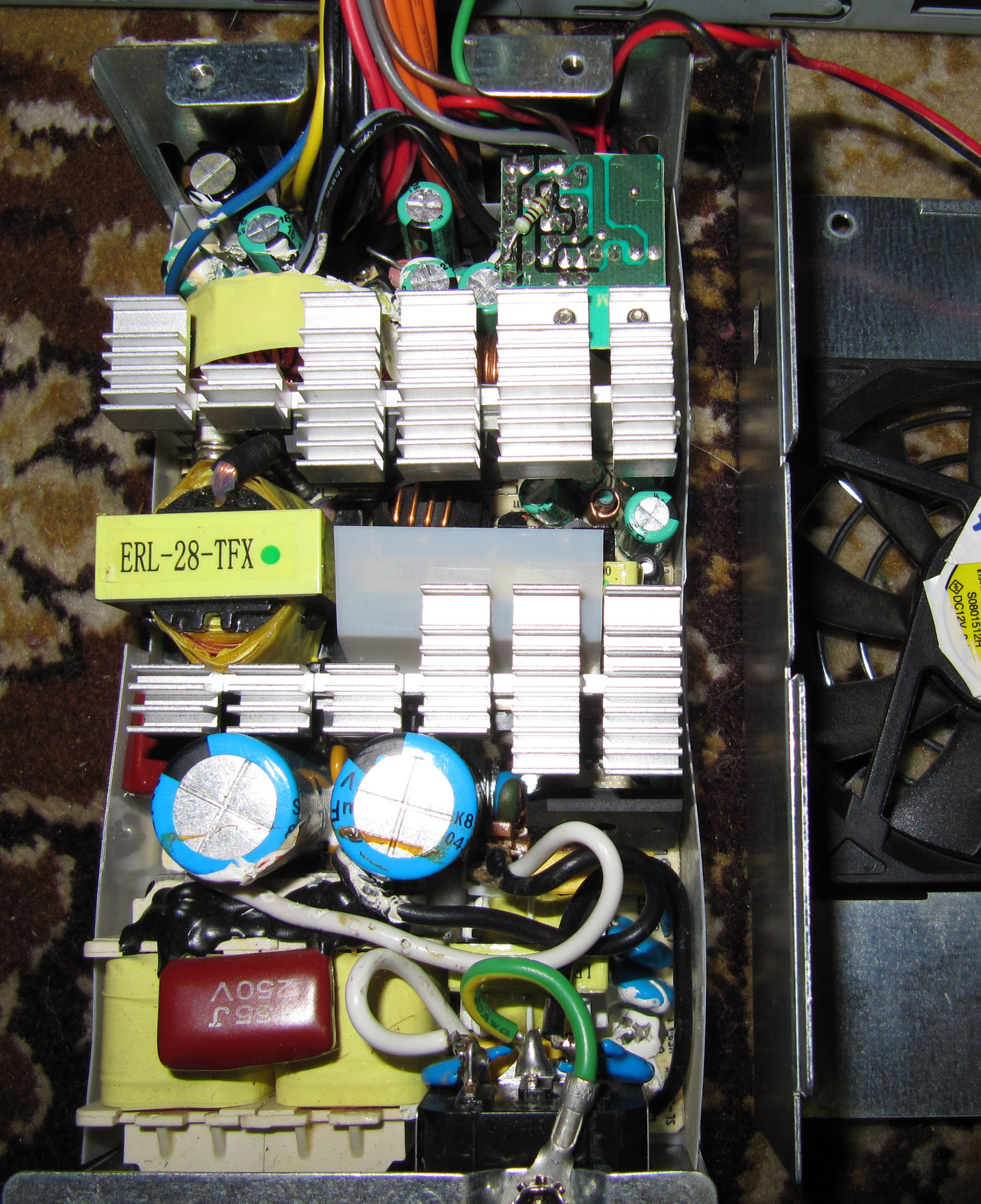

      Seems like Deer/Allied/Solytech has started to pick up their at a little bit now. No more 2-transistor 5VSB either - they are learning!!!
      I wouldn't call this PSU excellent by any means, but it is decent enough and definitely worth fixing, so good thing that you did .
      • Pentium4
        CapXon Be Gone
        • Sep 2011
        • 3741
        Re: Allied AL-300TFX the best Allied/Deer I've seen so far, still failed
        Good job! Nice save It looks good, and capable of 300W. Might get a little loud though.
        I like the newer heatsinks they're using, they have quite a bit of fins.
        Those YC caps should last a while but should be replaced eventually, especially with how crammed they are in there. Also, check the oil in the bearing of that Globe Fan. It might need some oil!!! Seen quite a bit of them fail
        I think it's funny how they heatshrinked that little cap (to the left of C17)
