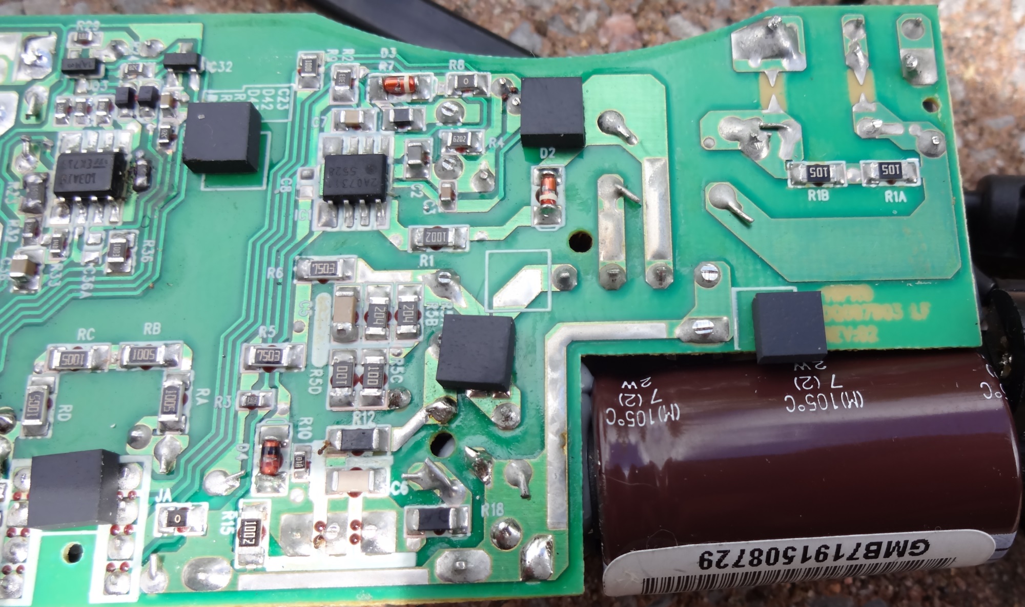

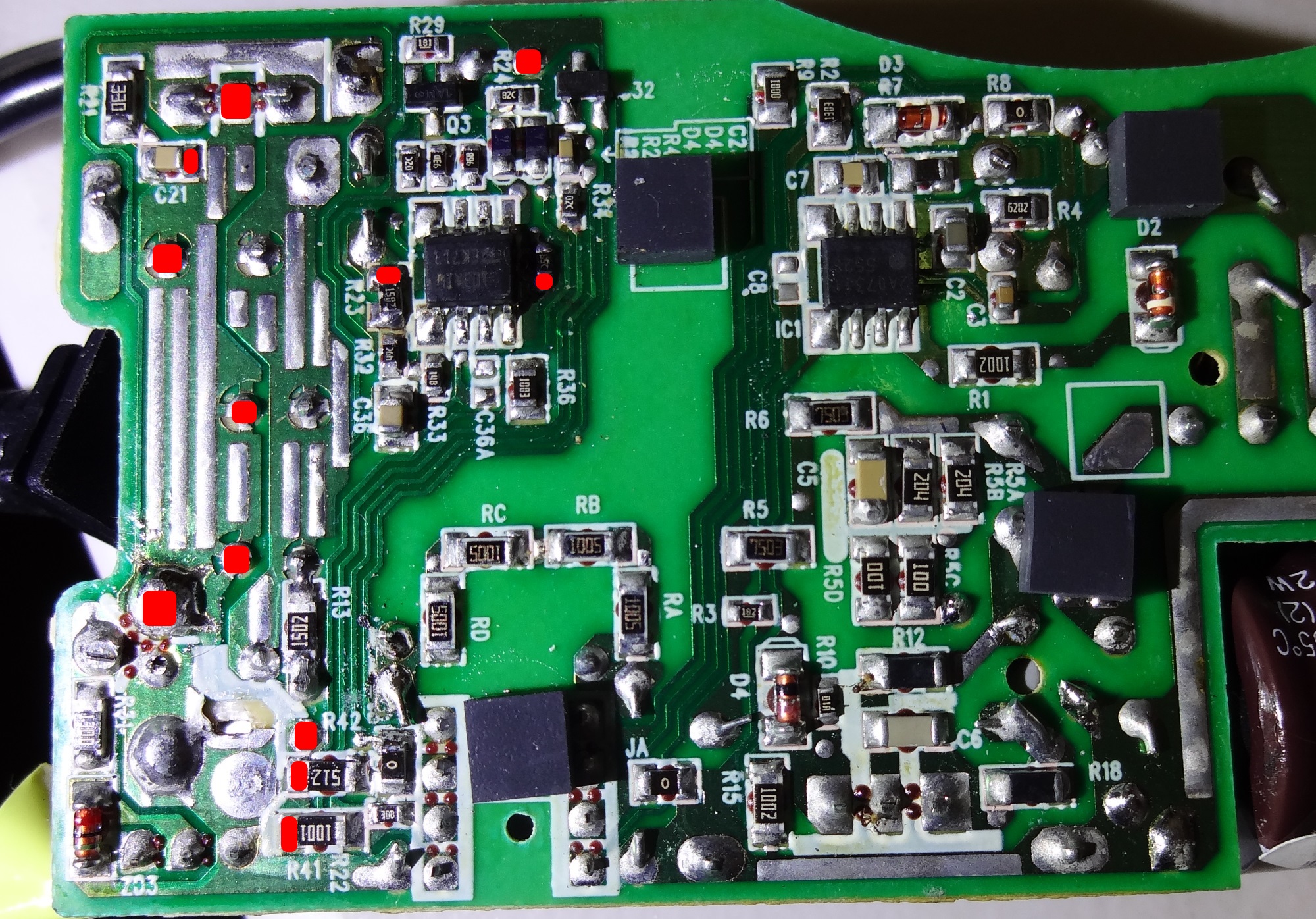

    I'd like to modify the voltage of a spare 65W Dell power brick that I have to around 17V (instead of the nominal 19.5V unloaded).
    I think that I identified the SMPS controller but it's only a partial part number on the marking. If someone could help me get the full part number and/or datasheet I could handle the rest.
    The chip is a SO-8 and the marking is 103AIW on the first line and EK713 on the 2nd.
    I still tried a few things without the datasheet. I found a 15 k resistor between Vout and a 2.5V pin on the IC. That looked like part of the voltage feedback divider so I replaced it with a pot. That didn't work. I also tried the same thing with a 75k resistor that I found between Vout and a ~2.25V pin. Didn't work either.
    Thanks for any pointers!

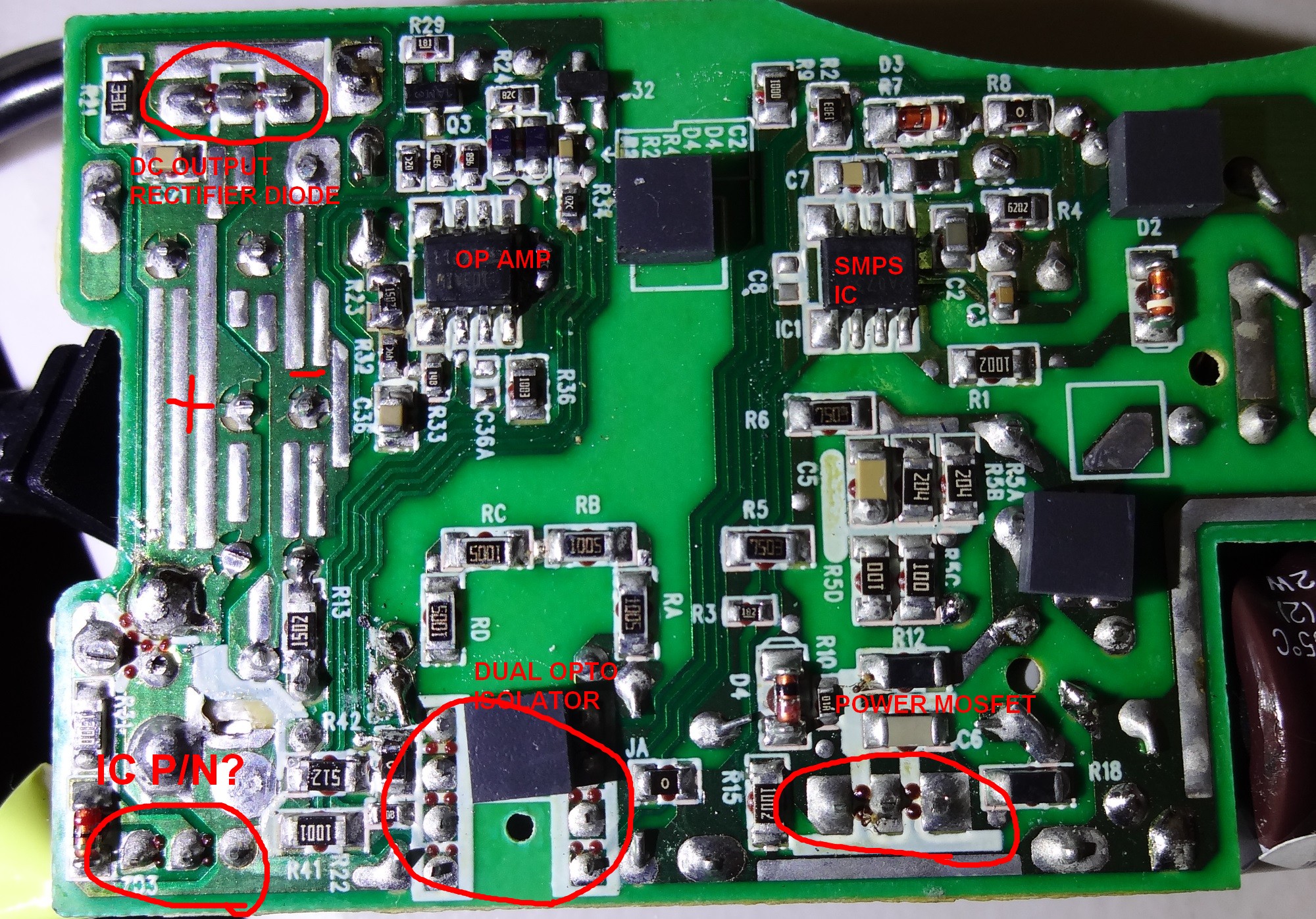

    Pictures of the board? You may be able to change the value of the feedback resistor network around the Optoisolator and the Vref Diode (such as TL431).

      Here's the picture. Sorry that's the best I could do with my point and shoot.

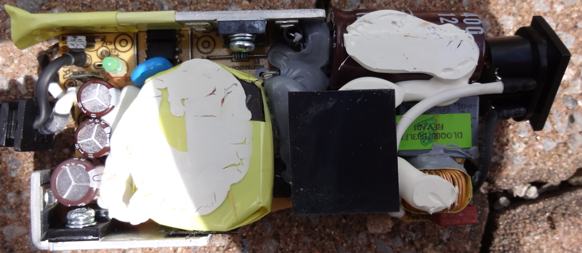

        Post a picture of the other side also, please
          Re: Modify output voltage of a Dell power brick

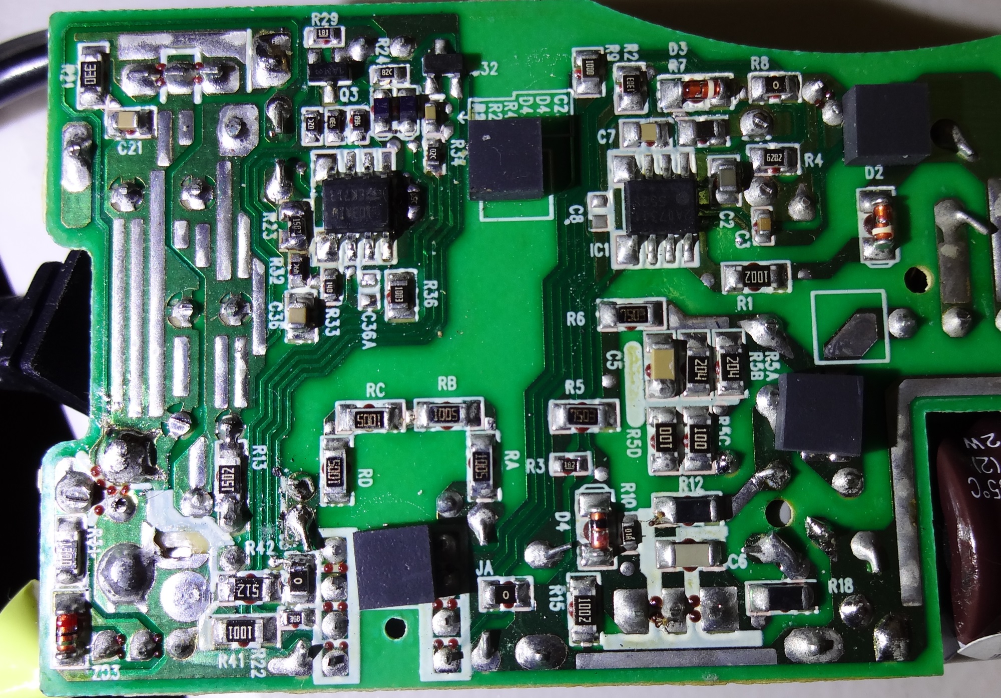

          That is good picture, but take another section of the board also so I can see how the traces are connected, and yes, top side also needed.

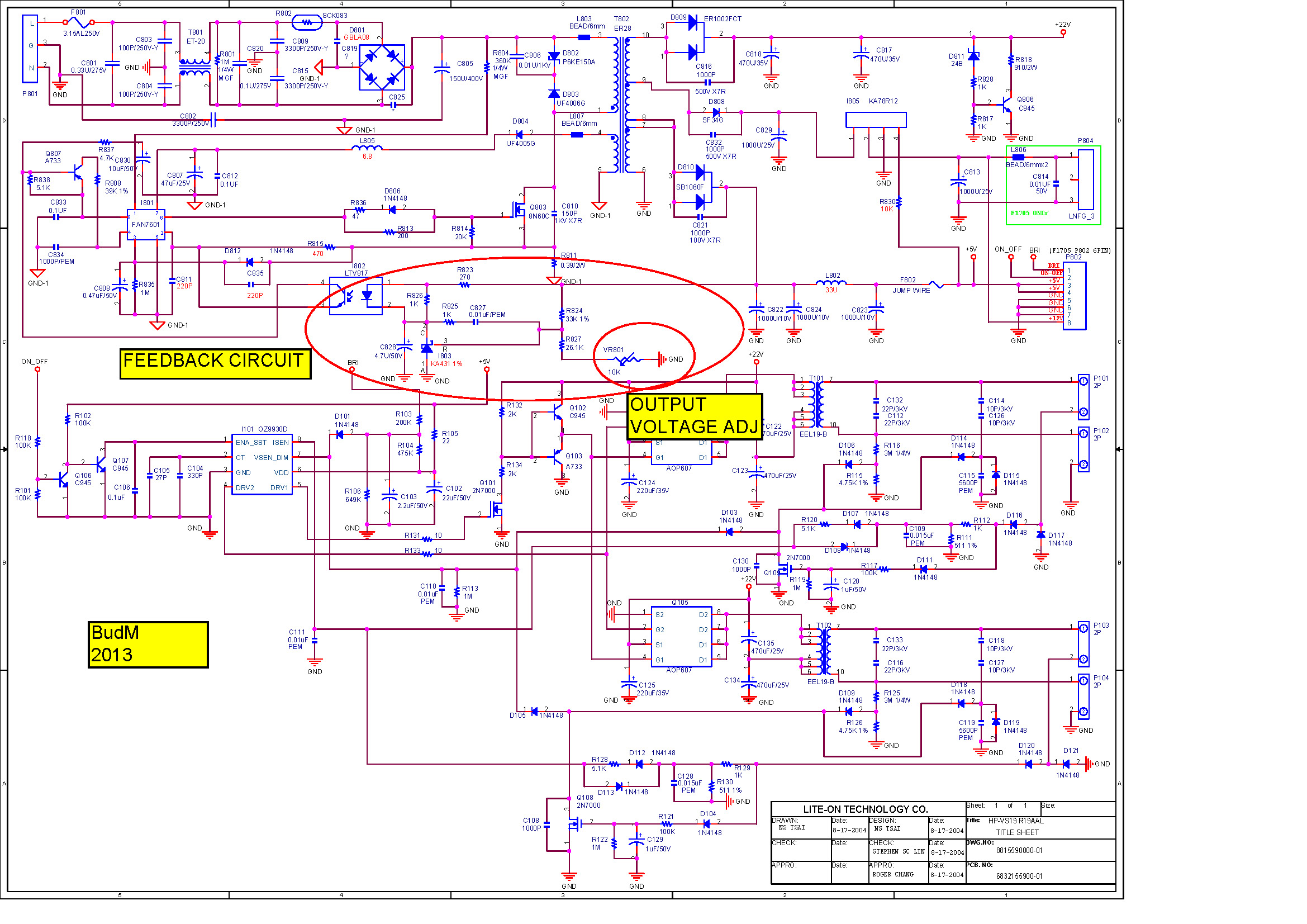

          The Opto and the ref diode will be in the DC output section of the board.
          This is an example of typical power supply.
            Thanks budm for the diagram. Here are two more pictures that should help.

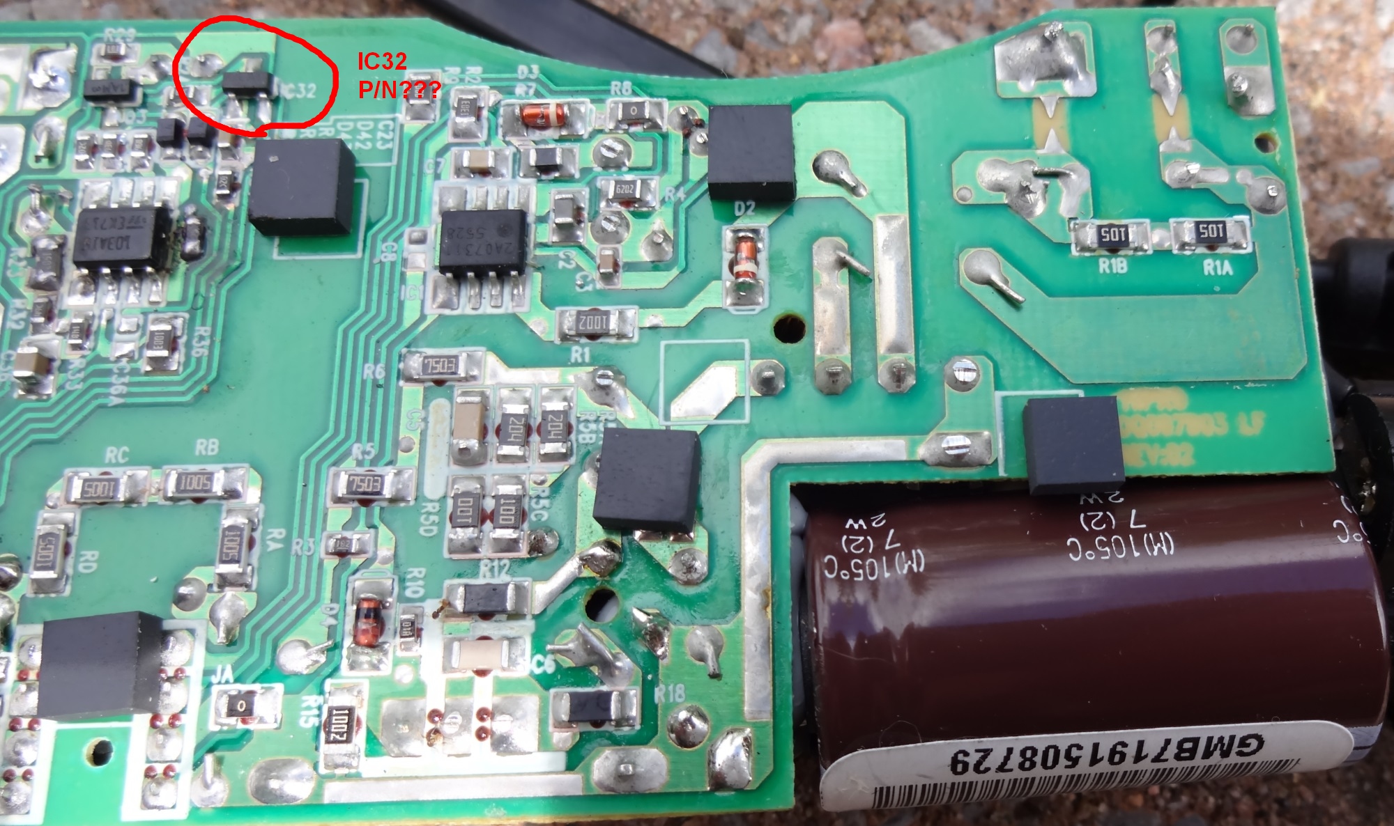

                See what the P/N of that IC3 is.
                  It's a TO92 package
                  DALLAS
                  2501
                  0714D3
                  +058AA

                    OK that is the IC Dallas 2501 is the 1-wire memory chip for the telling the laptop what kind of power supply it is being fed with.
                    I have to locate that feedback network on the board.

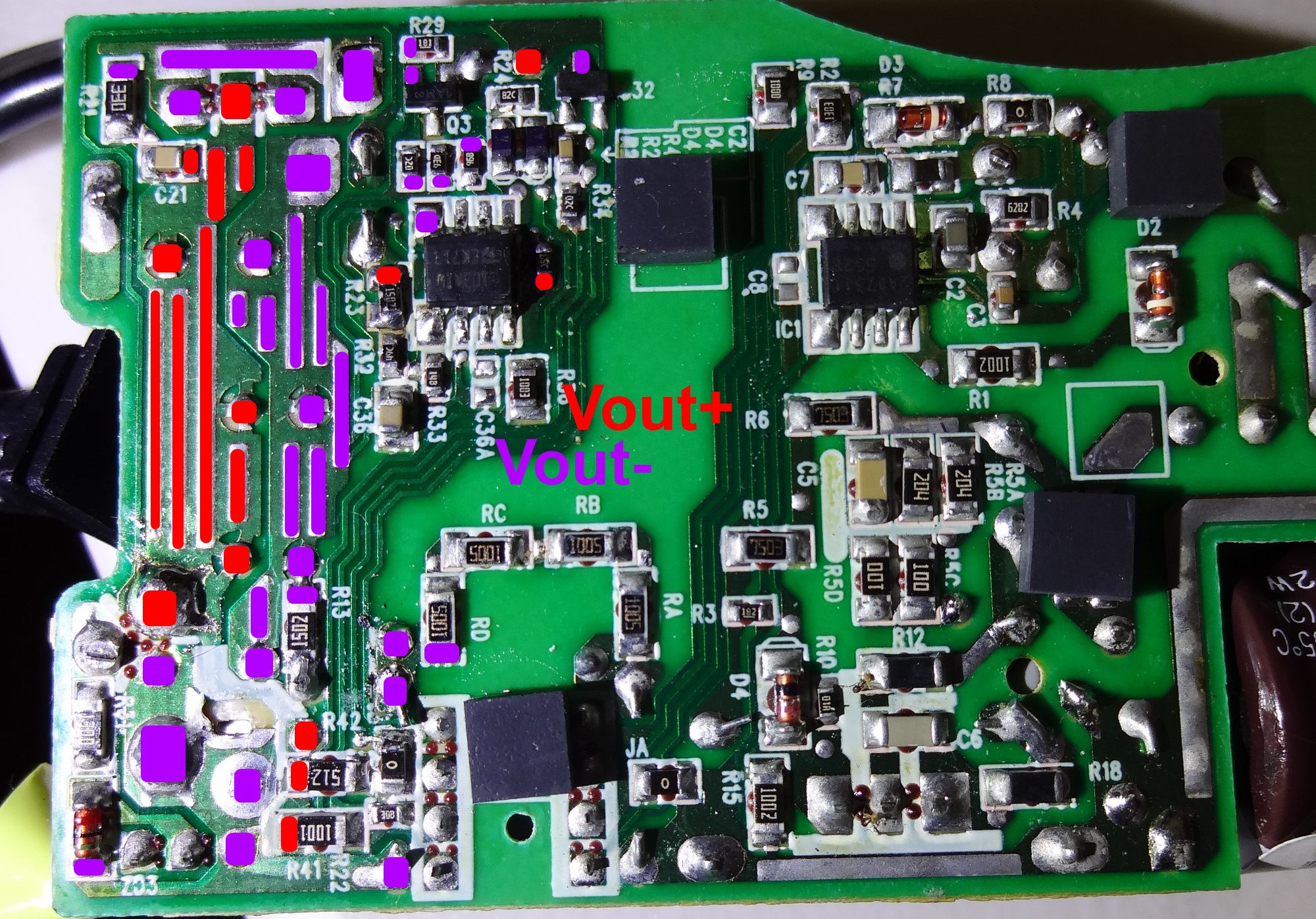

                      I probed the board and identified any point directly connected to Vout, in case that helps out. I'm guessing that the voltage divider will be connected to one of these points.
                      The p/n of IC32 is very hard to read. I think it's LA1 and there's a symbol on the left of it that looks like a backward N.

                        Can you read the P/N of that Dual Opto isolator?
                          You mean the 4-pin thru-hole parts on the top side?
                          NEC
                          2561
                          LK641
                          Both are the same.

                            OK here is the spec sheet. We just have to find how the LED inside the Opto is being driven, it has to be connected to circuit some where which I cannot really easily see from the pictures, it will be real easy once we figure out the connection.

                              Attached is the result of some more probing.

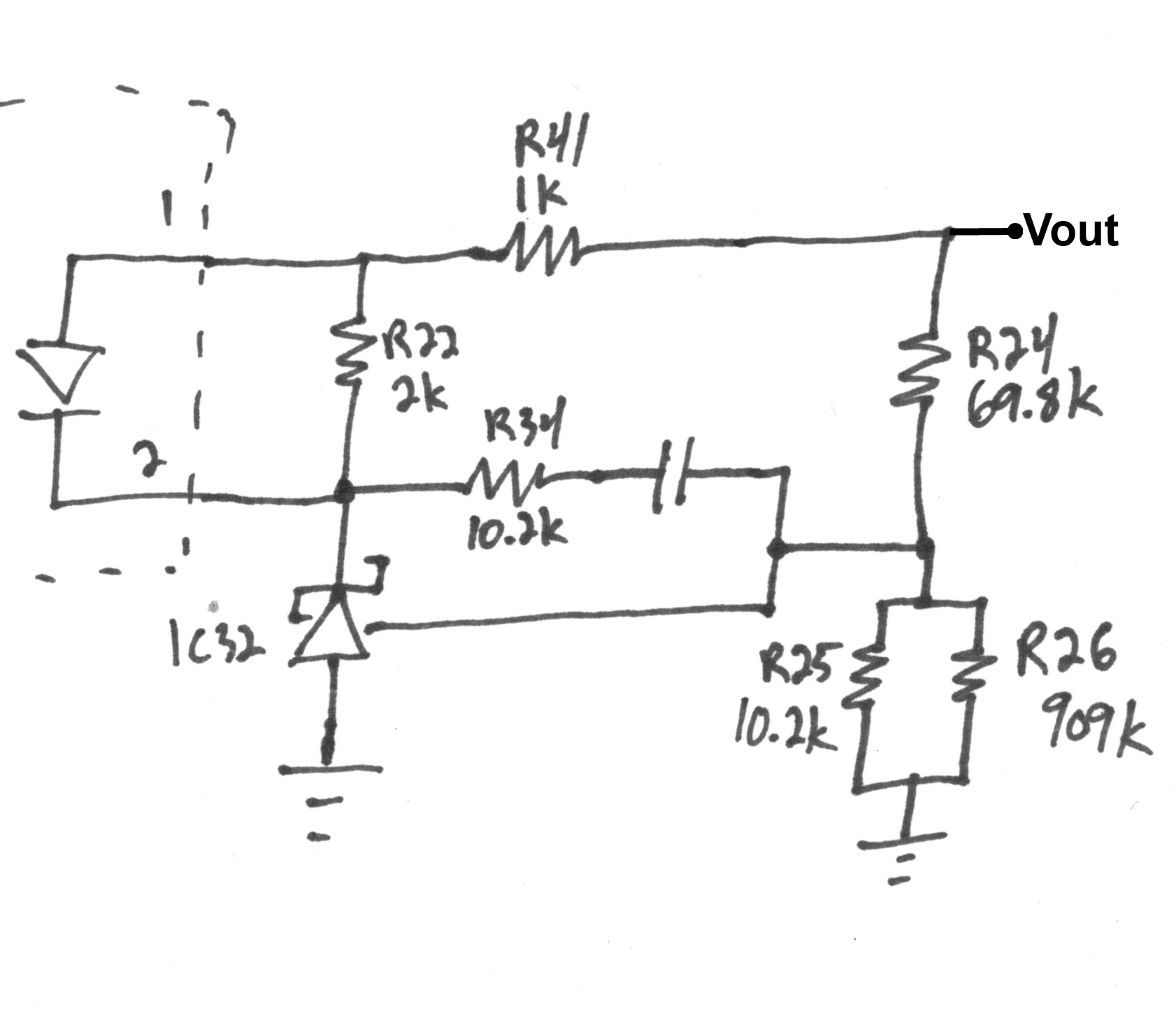

                                Ok, here's some partial reverse engineering of some of the traces. I concentrated on one optocoupler to start with.
                                I drew it to ressemble the "typical" circuit posted earlier. I think that I have everything I need. I'll try to tweak R25 and R26.

                                  I think that decreasing the 69.8k resistor will decrease the output voltage.
                                    Bingo! Tweaking R25 and R26 did the trick! Now I just need to replace the pot I used for testing with a fixed resistor. Or maybe leave the pot there to create an adjustable power supply.

                                      Well I am glad you are able to trace out the diagram, looks just as I expect it to be.
                                      Good to see that it does what you need, just be careful not to let that connection of the 68K go open then it will not have feedback to keep the voltage down.
