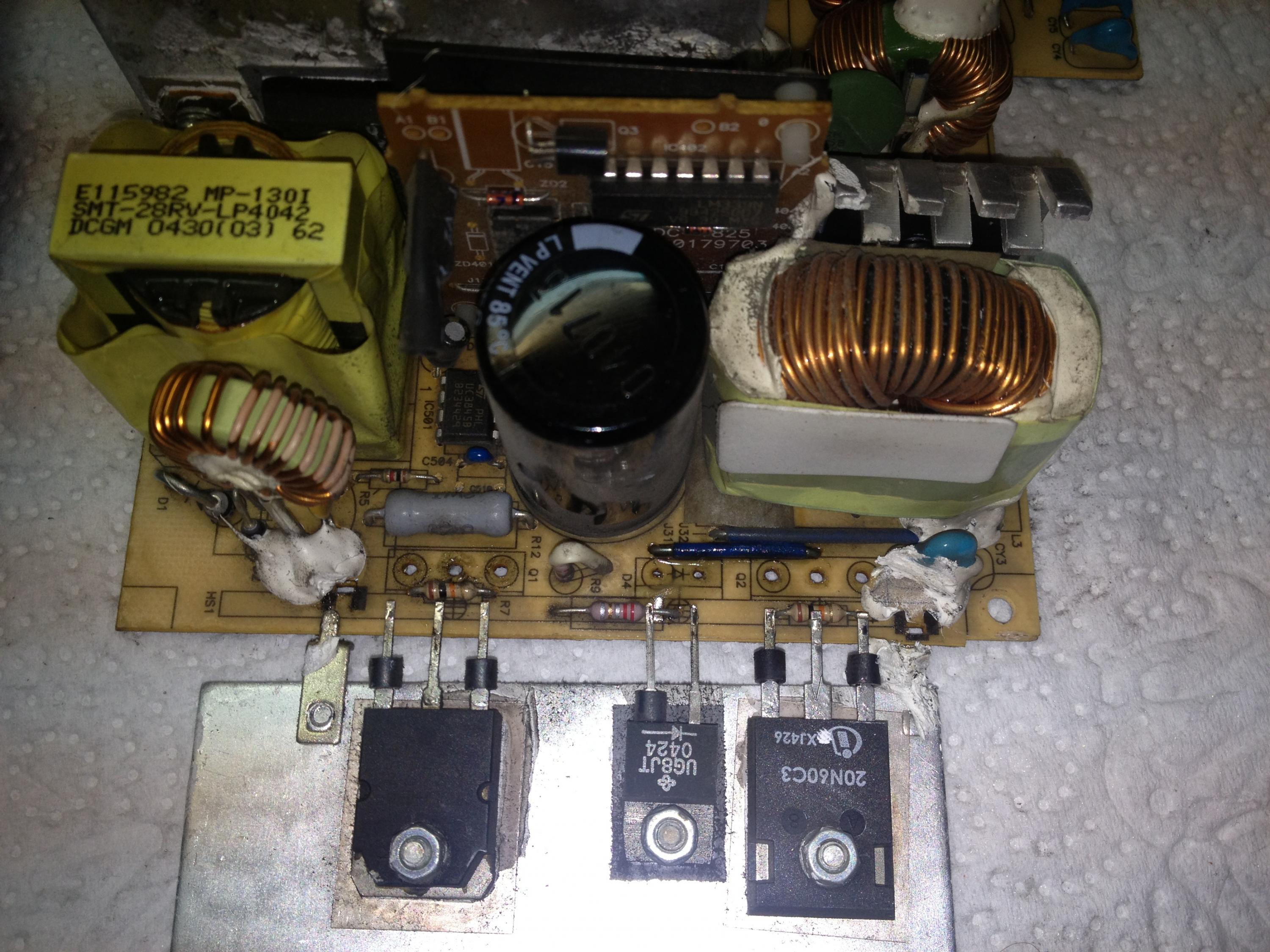

        Hi, i think i found the problem, i check the big capacitor and it vas 2-3uF on label it is 150uF 450V. I replace him.
        But i did some idiot thing, i connect the power when 20N60C3 was not solder (just plug into PCB). and i hear 'bang'
        Main fuse was burned out. I replace the 20N60C3 (because it is now shorted in all directions), and i replace fuse. I plug in and my main house fuse pop-down, but fuse on PCB stay OK. I use 6.3A, and original was 8A.
        I check varistor = OK.
        Disconnect AC/DC converter = OK no 'buum'

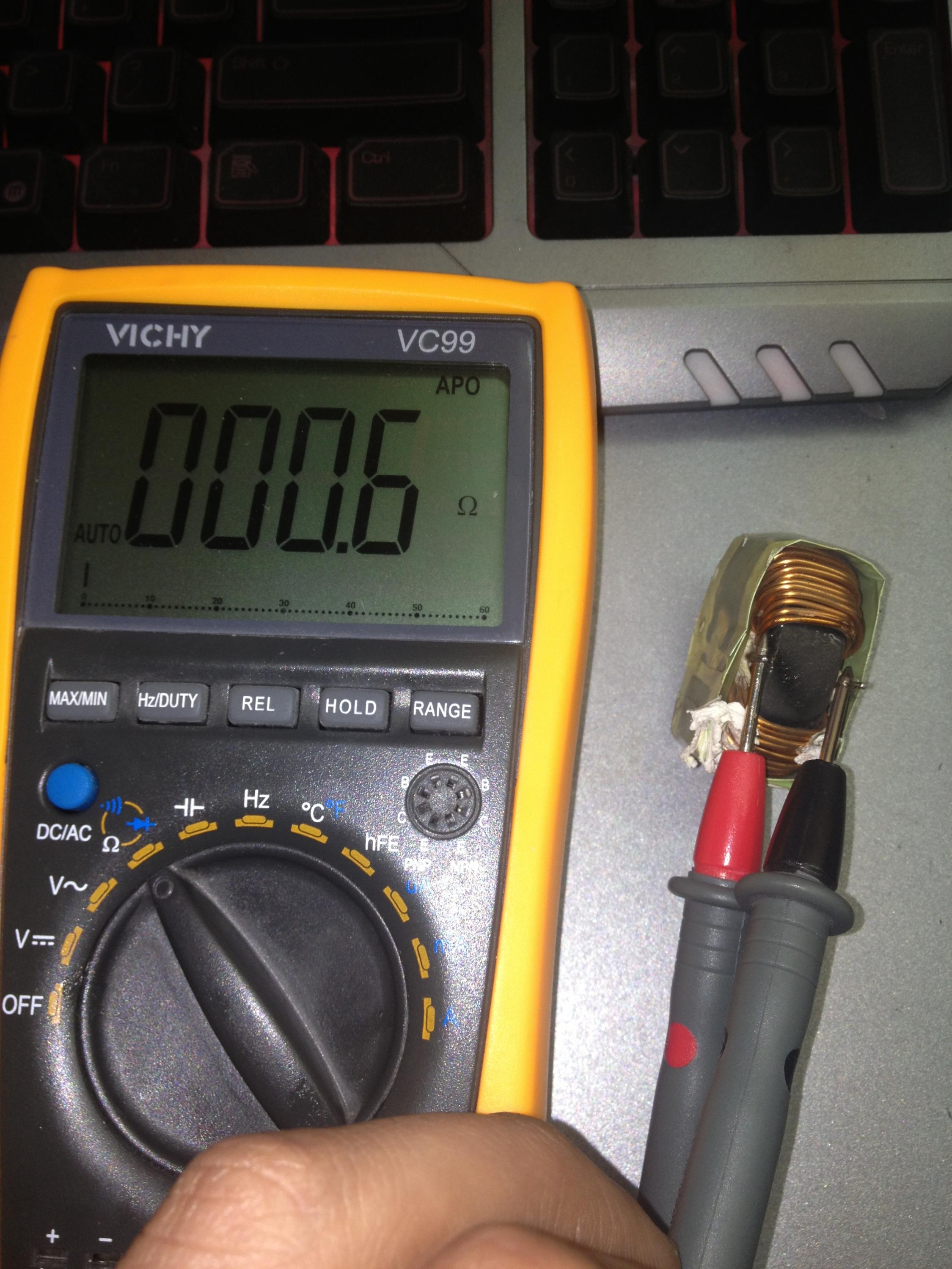

            i check Q1 Q2, they are ok, no short connection. R12 is 0.2 Ohm 2W, it is OK
            but i check the big coil and it has 0.5 Ohm, is this ok?
            ...the quieter you become the more you are able to hear...
            • ben7
              Capaholic
              • Jan 2011
              • 4059
              Re: Dps-240fb
              That is ok.

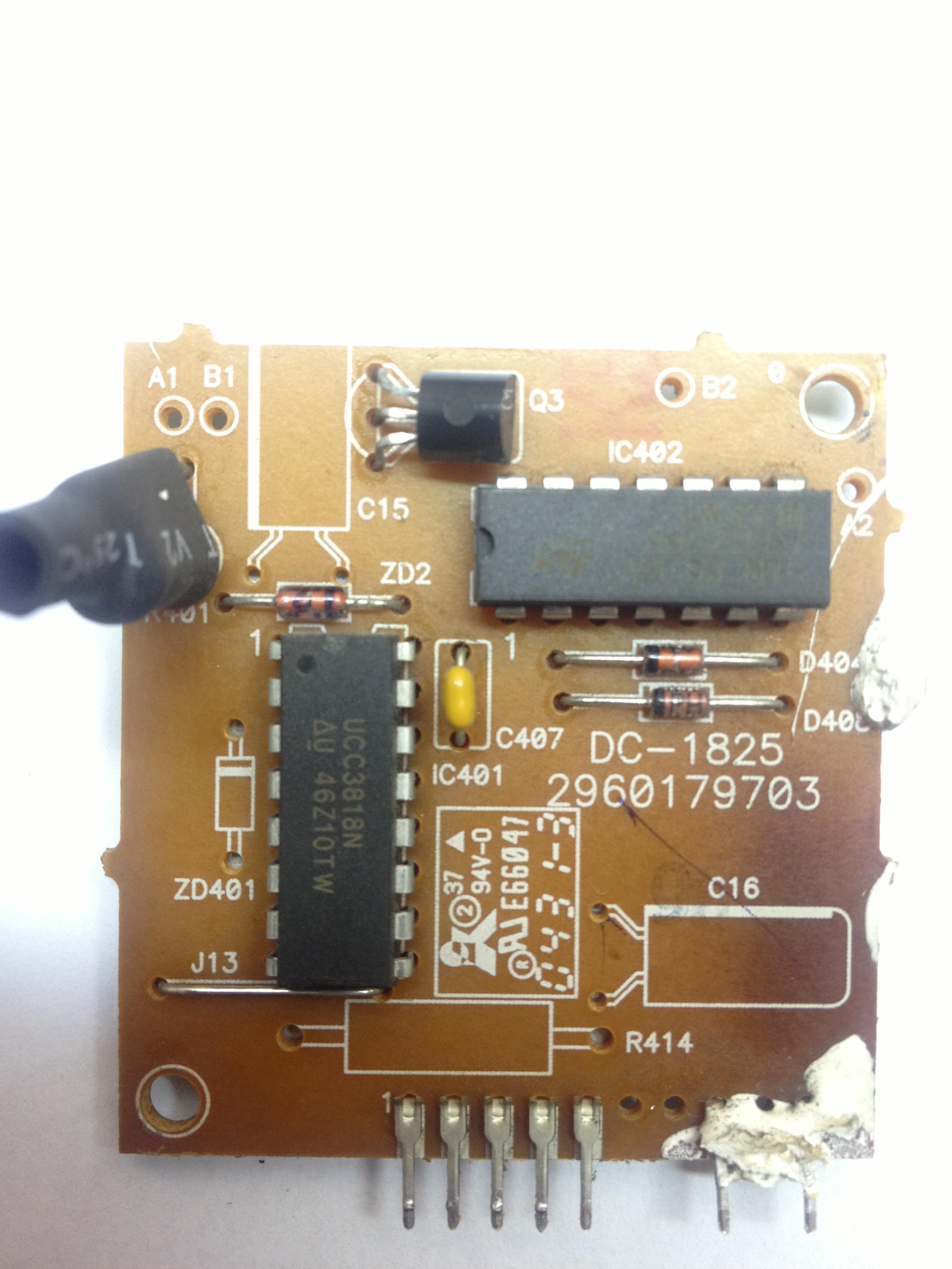

                              You've got more parts to replace. The 3845 is for the SMPS, not the PFC-booster. The PFC controller is likely on the riser.
                              That 20N60 stays on and shorts the DC side of the line rectifier because its gate driver blew when the original 20N60 blew.
                              Remove the 20N60, and apply power with the dim bulb. The big cap should now charge up. If the bulb still lights up, remove Q1 and try again.
                              You can leave that heatsink out and apply power. If the bulb lights up now, the line rectifier's shorted.

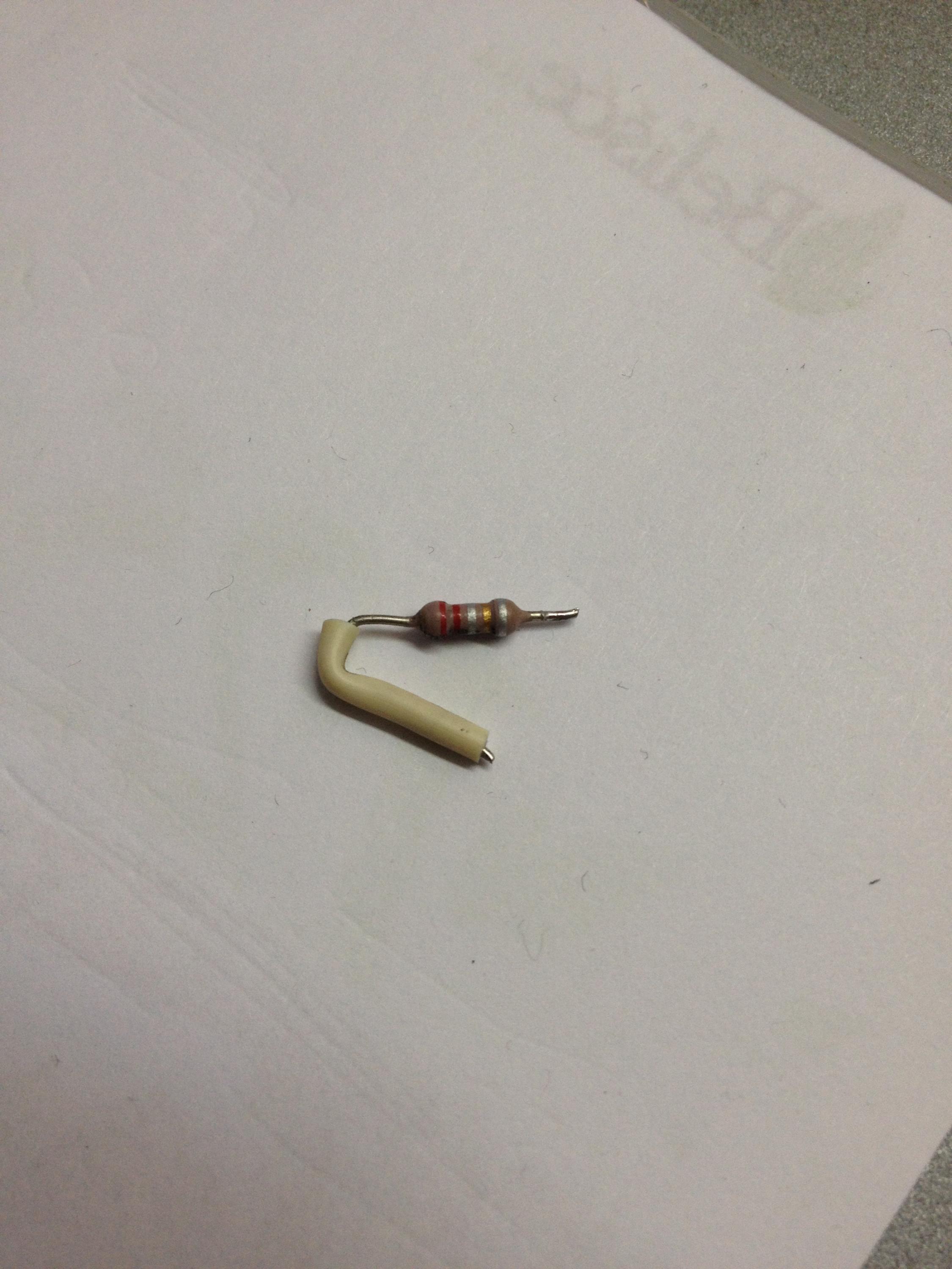

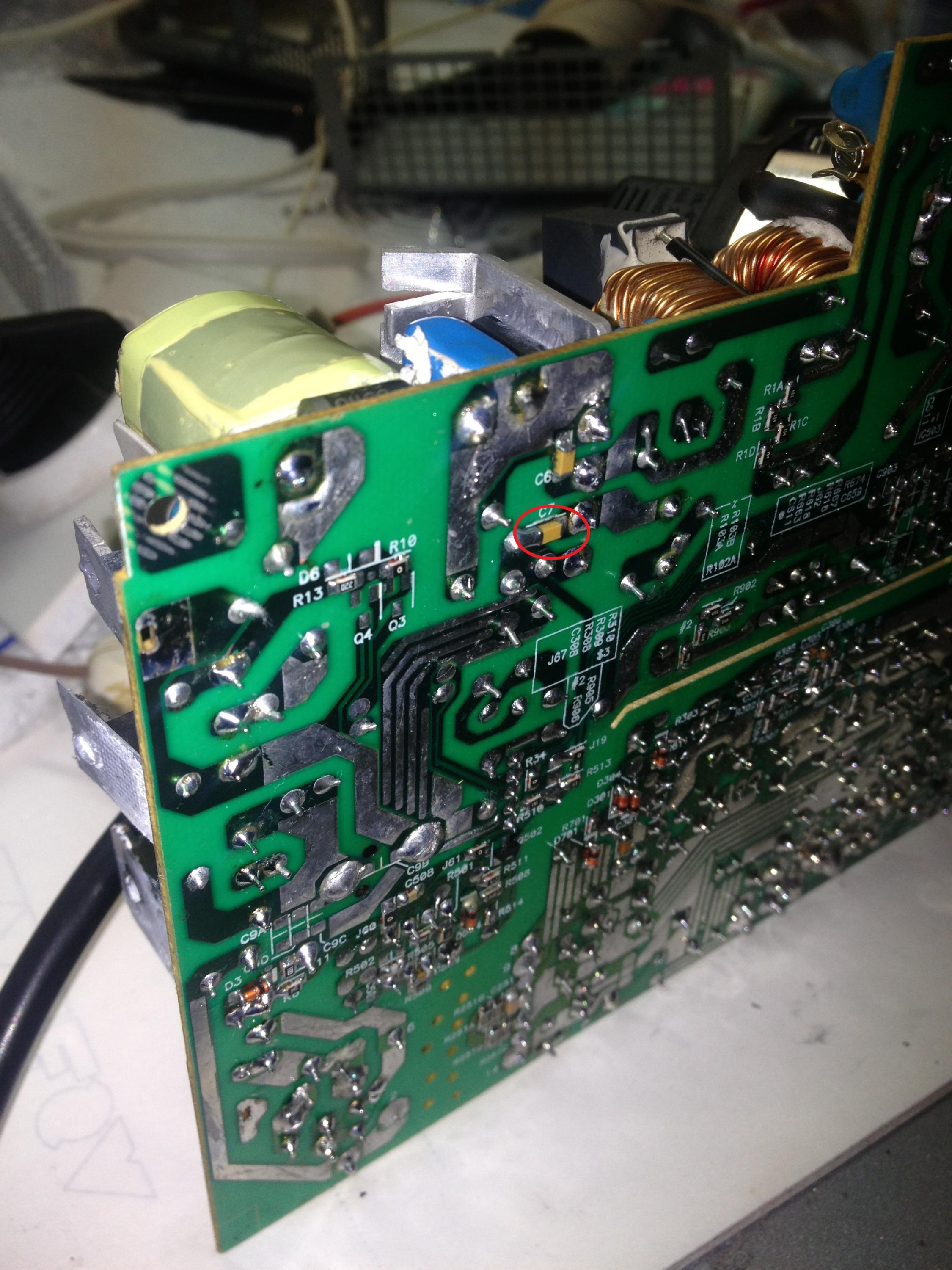

                                i try to remove 20N60, and bulb did not light up. Then i found some little piece of soldering on board, i think that make the trouble. i remove it and bulb light just for sec and then go OFF. I put back 20N60, and still bulb did not turn ON. But i see some sparks on this capacitor in the picture. The sparks are very small. I remove him and he was 1.56nF. And below capacitor i found some burned areas.
                                • ben7
                                  Capaholic
                                  • Jan 2011
                                  • 4059
                                  Re: Dps-240fb
                                  i try to remove 20N60, and bulb did not light up.is the 20N60 gone bad, or something trigger it to be open all the time?
                                  The controller for it is shorted. The PFC controller is likely on the riser board, like kaboom said. I dont know why I thought the UC3845 was for the PFC

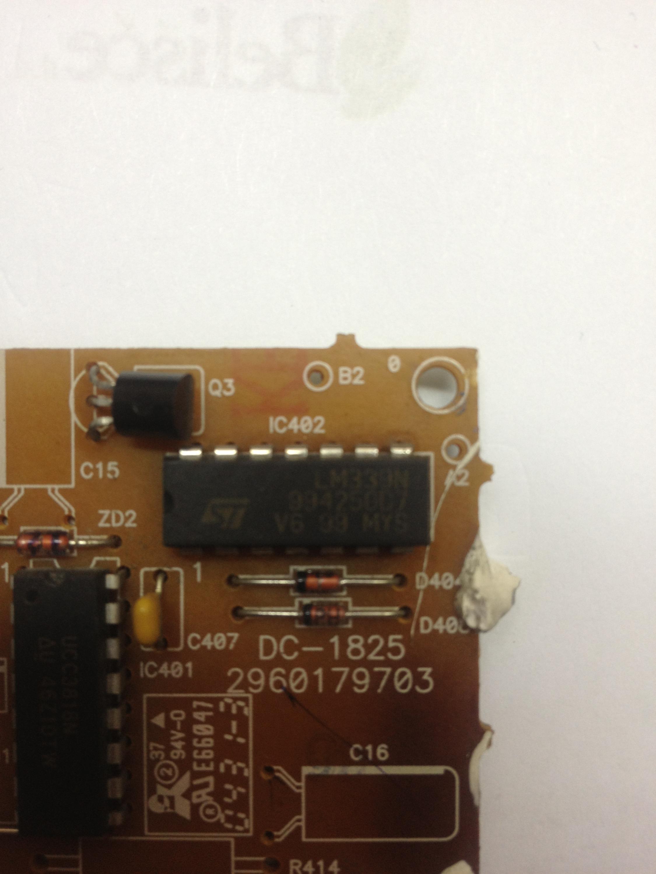

                                    Re: Dps-240fb

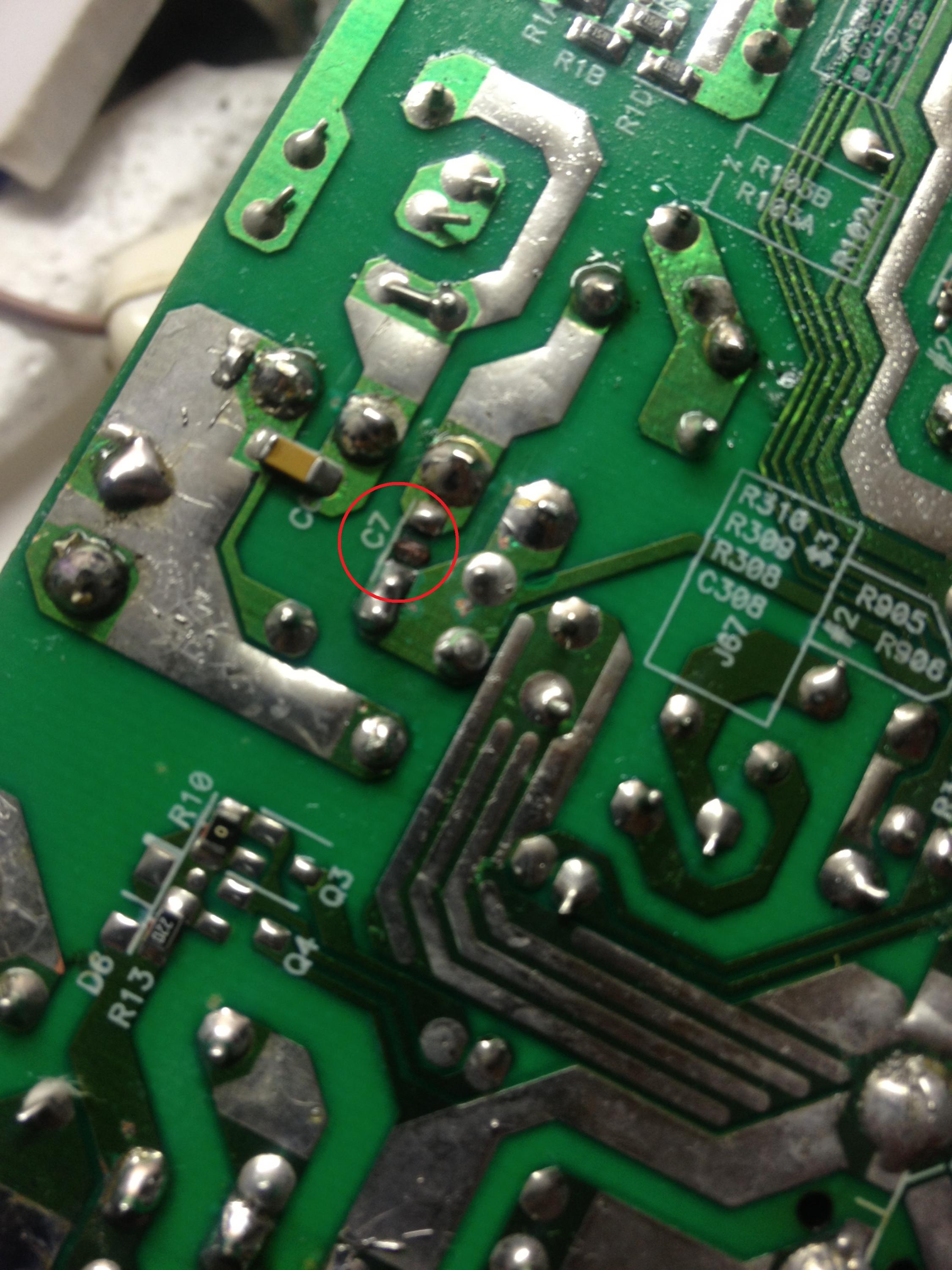

                                    This is burned area,
                                    • ben7
                                      Capaholic
                                      • Jan 2011
                                      • 4059
                                      Re: Dps-240fb
                                      Huh? Doesn't look burned at all. They just omitted a capacitor there. The solder shows no sign of anything being there as far as I can tell.
                                      Muh-soggy-knee
                                      • rtstorm
                                        • Feb 2012
                                        • 971
                                        • Croatia
                                        Re: Dps-240fb

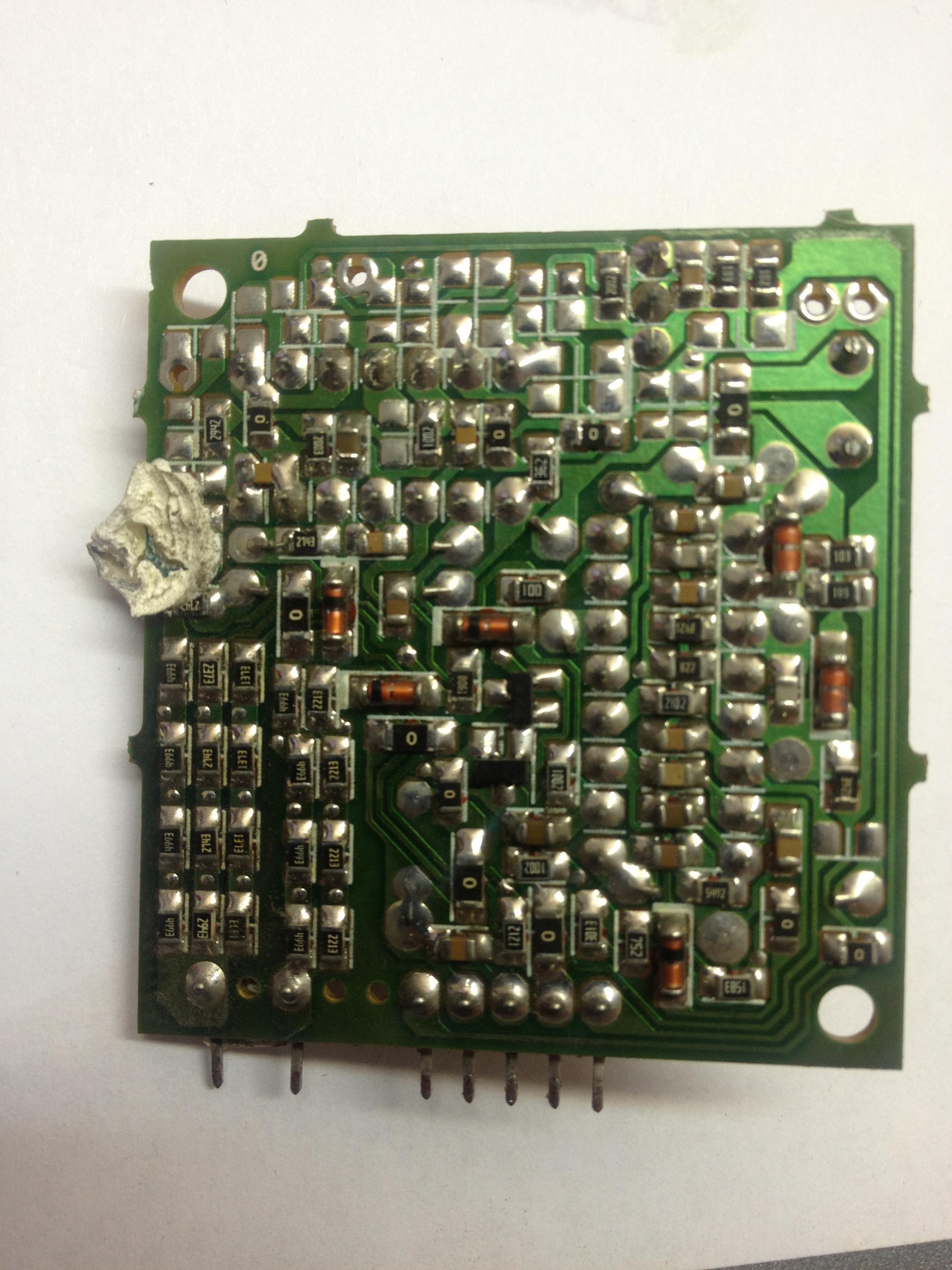

                                        i think this is the controller,
