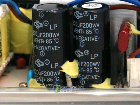

                      The attached image shows what the "SC" cap I metioned eariler.
                      I found from some reviews that they are inside some low end PSUs.
                      I'm thinking if "SC" is crap. They are populated on the secondary side
                      on my PSU. I will probobaly recap them with same uF for safe.
                      My main PSU is a GTR AP450X. The brand "GTR" is by no mean related to any sport cars. In fact, GTR in hongkong has very limited products on the high end. It's PSUs are mainly of entry level to mainstream.
                      I gonna modify the 3.3v sense wire to have 3.4 to 3.5V. For that I don't need to do anything on mobo in order to rise a bit the Vdimm.

                        well I cant help you with the caps (as to quality etc) but guess since you are going to give this thing a flogging and it sounds like you might be in the right place to source high quality caps at a reasonable price.
                        (and you know how to recap) I would recap it.

                            Your links info are very informative too. For the "SC" cap, I'm not in hurry to recap them. I wish to know more about the "SC" cap... the name of the brand , specifiaction ...etc
                            I do find some sources of YXA ,YXG , MBZ ....and I have some KZE , KZG & sanyo WG desoldered from mobos.
                            3.3v 3300uF MBZ cost HKD$6 . Is it reasonable ?

                              I duno, wich brand those SC caps are, but i belive they are somhow liked to Fuyihu crap. I have had several real BS PSu`s wich have those ugly saturn symboled caps too.
                              Alle caps on them are from Fuhiyu too. I am not shure, but IMHO there are some post abouth those Saturn symbol caps here. But may be a little hard to dig them out. Any way, AFAIR they are considered as crap. But ok, primary side caps aren`t the number one probleme, thus you can wait until you can source better ones.

                                I just "copy paste" you model into google silly me didn't pay much attention to the number... like I said DOH!
                                I vaguely remember trying to find info on those caps a 2 years (there abouts) back didn't have much luck then or now.
                                even tried doing a photo search on google to see if I could get a lead
                                they are fairly common so guess someone must know who makes the things.
                                Only came up with the teapo SC green gold low esr.
                                You said if I remember correctly, they are also on the secondary side same brand "SC"
                                If it was me I'd change them to good quality ones.....gonzo0815 comment on them as being towards if not crap would make sense since they are fairly common in cheaper supplies...so yeah since they are going to be the most expensive to replace...as he said...
