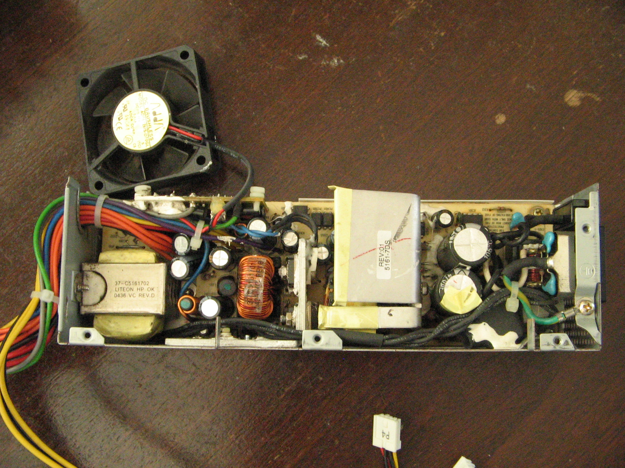

                              Do you have pictures of the PSU by any chance?

                                Re: Dell GX280 \ LiteOn PS-5161-7DS question
                                Not at the moment, I'll take some today and post them

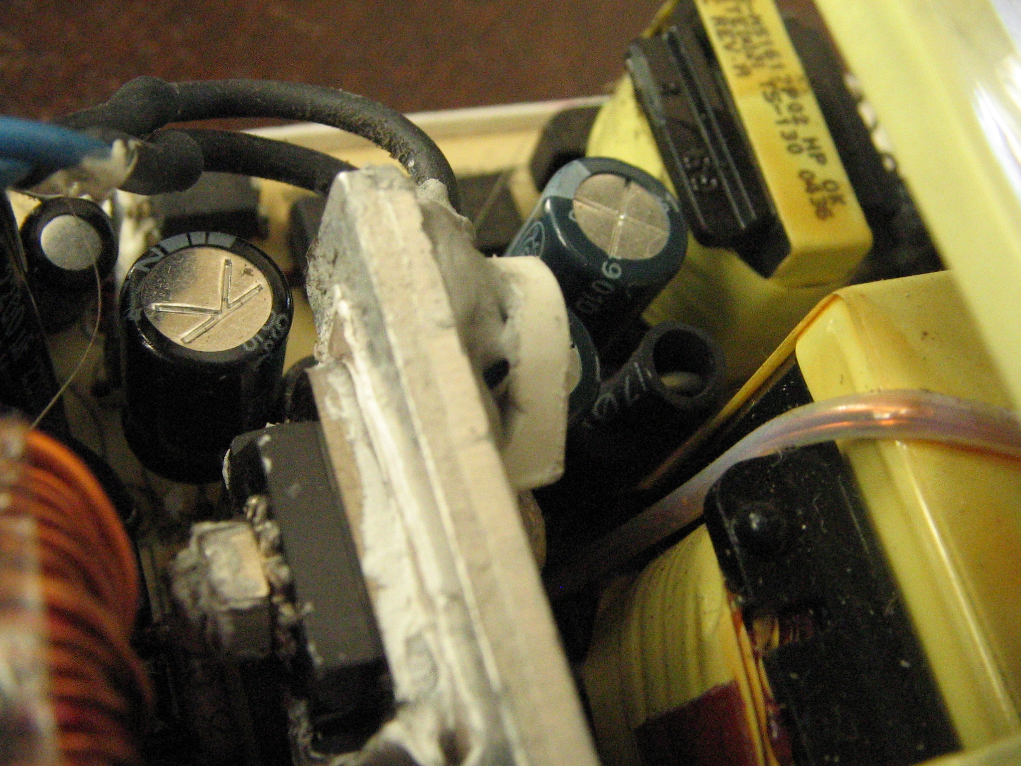

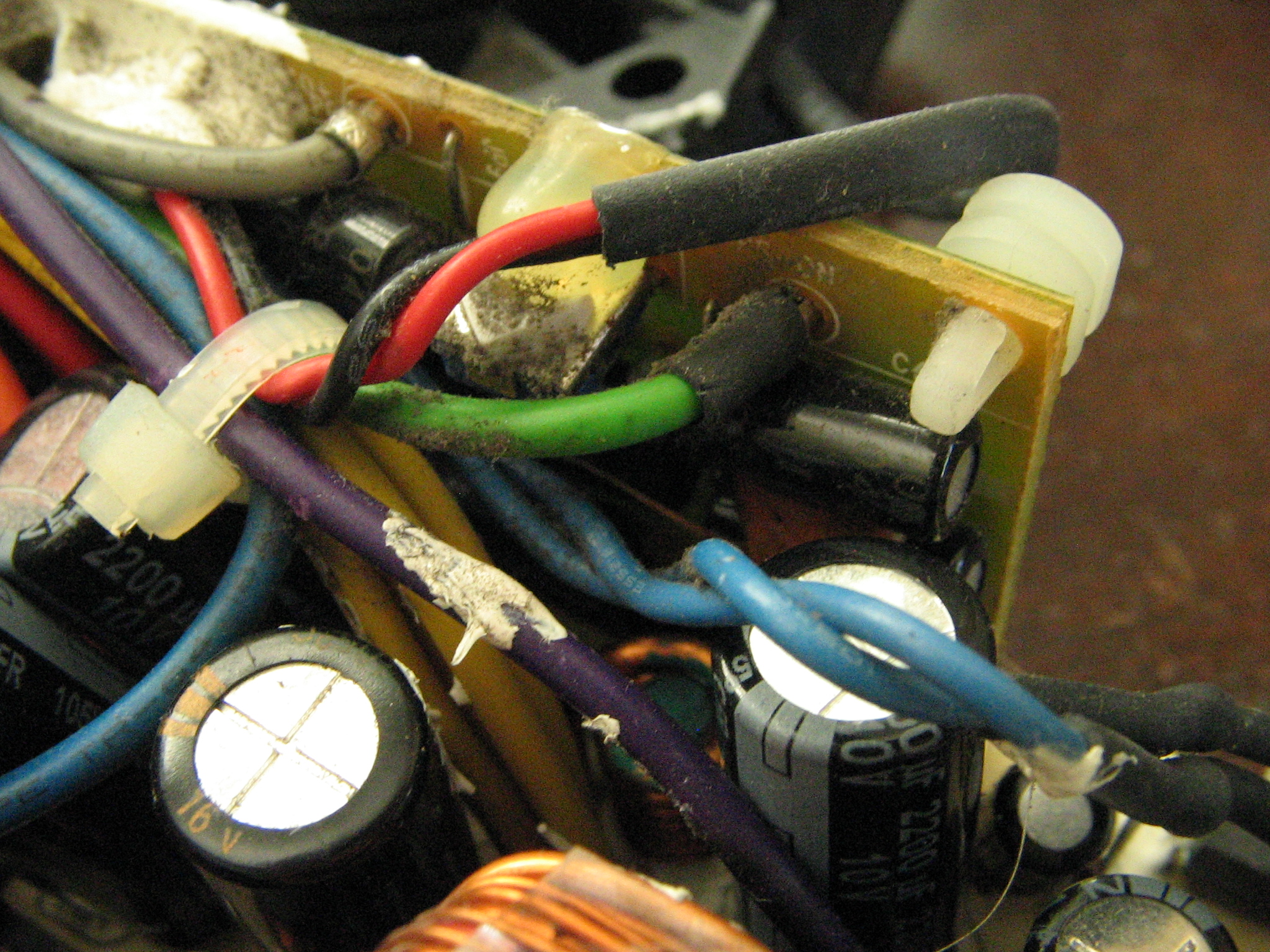

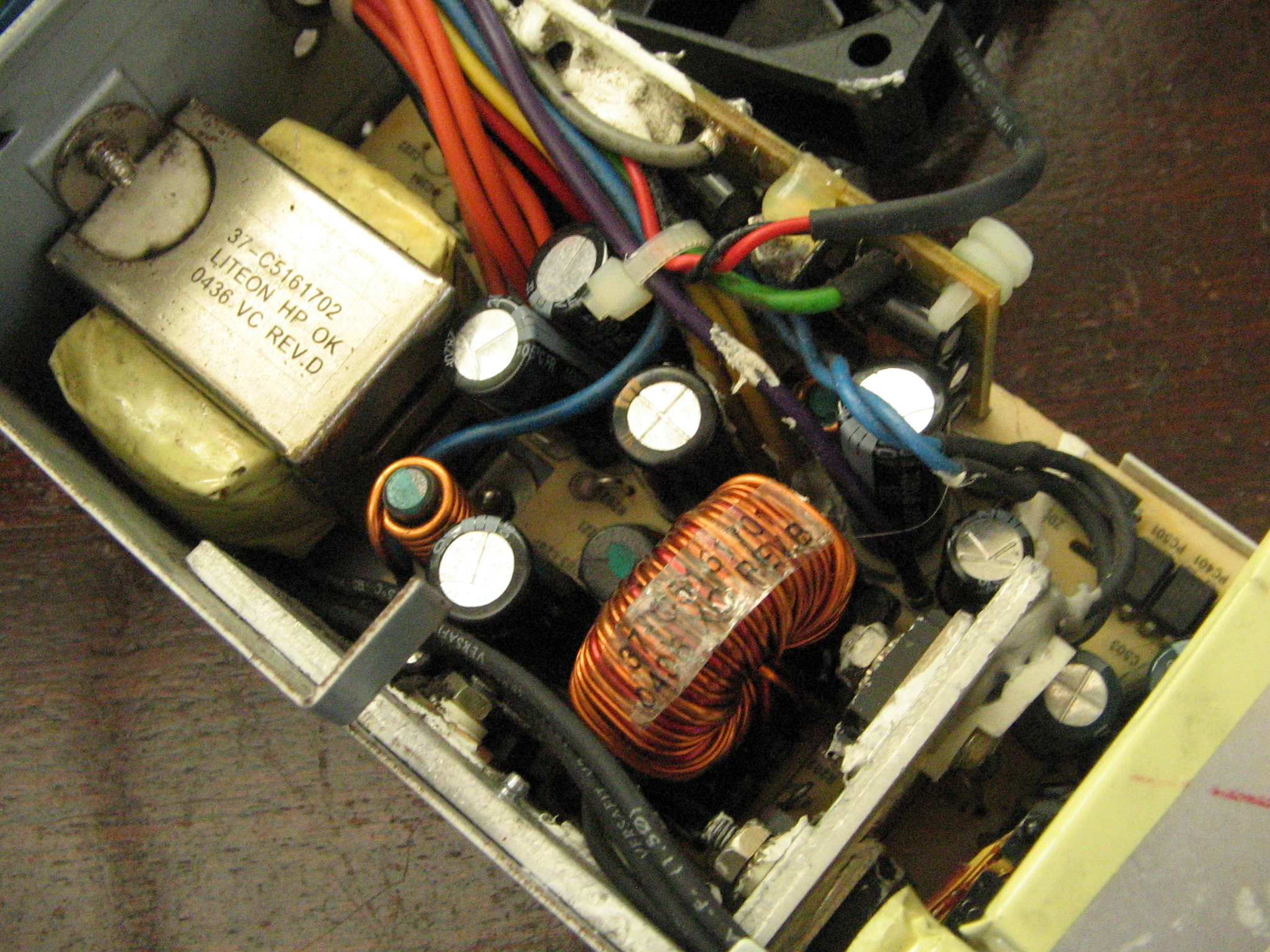

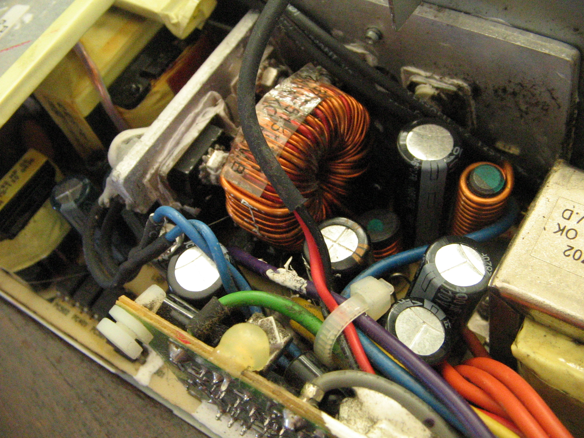

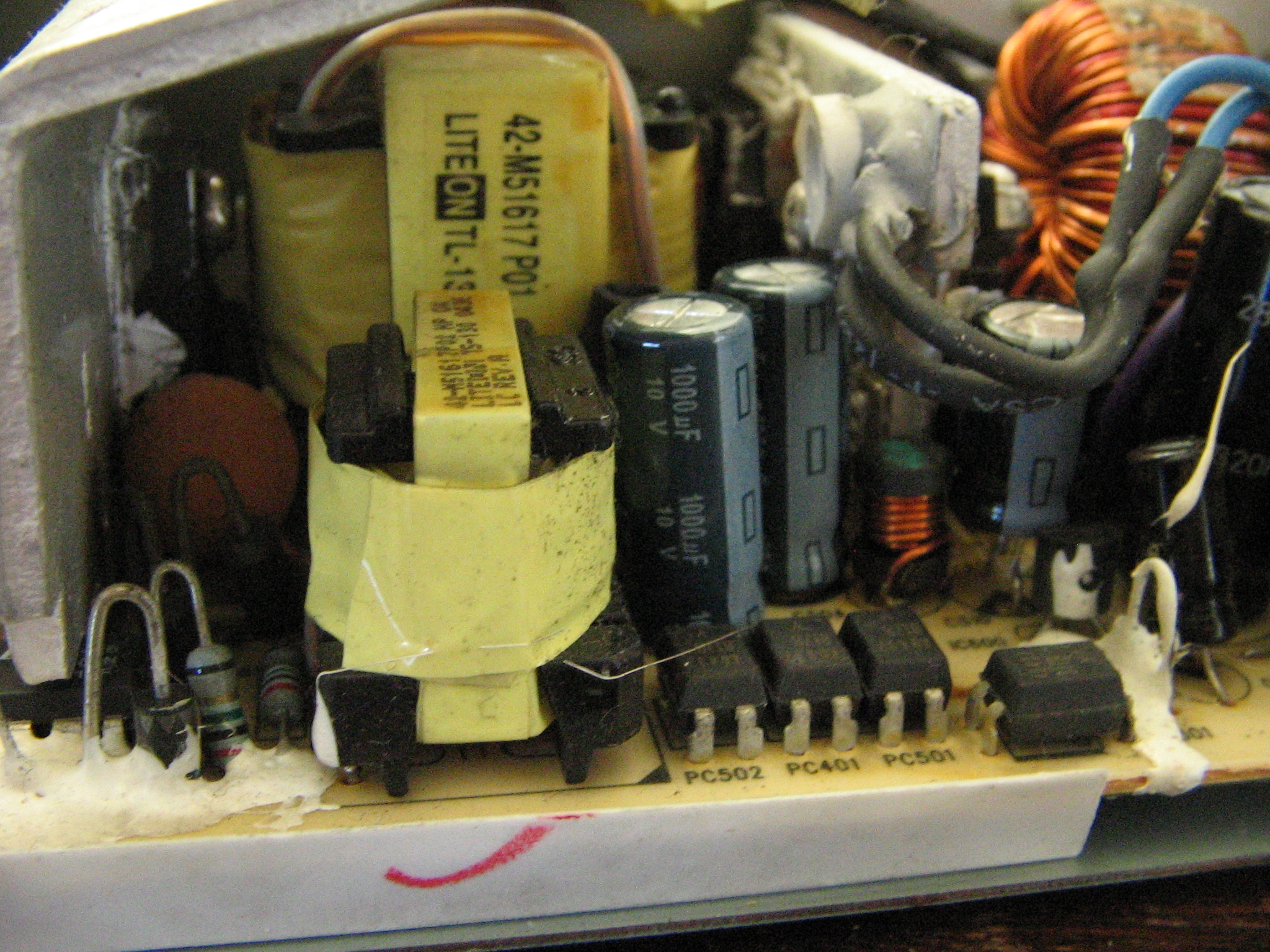

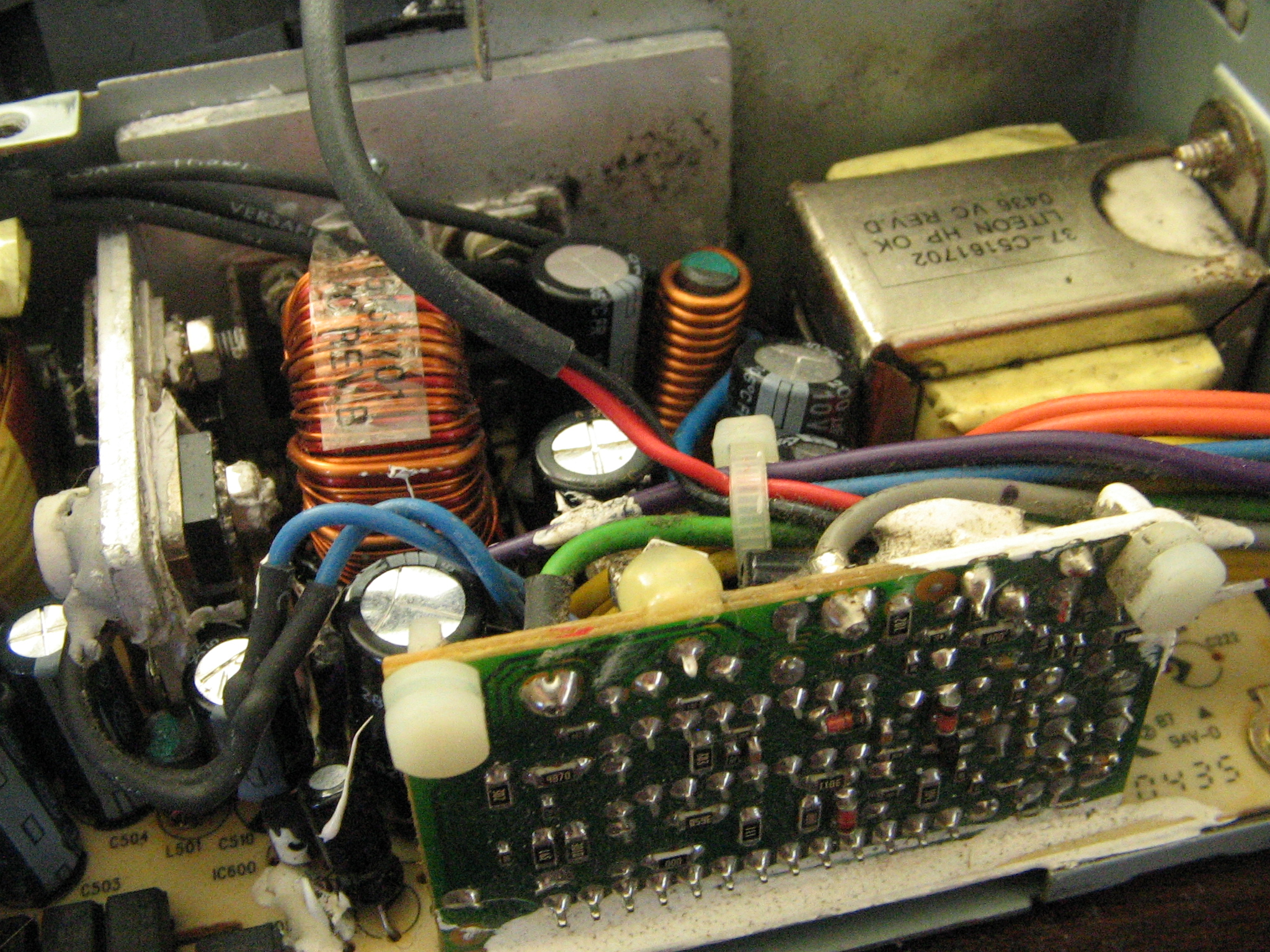

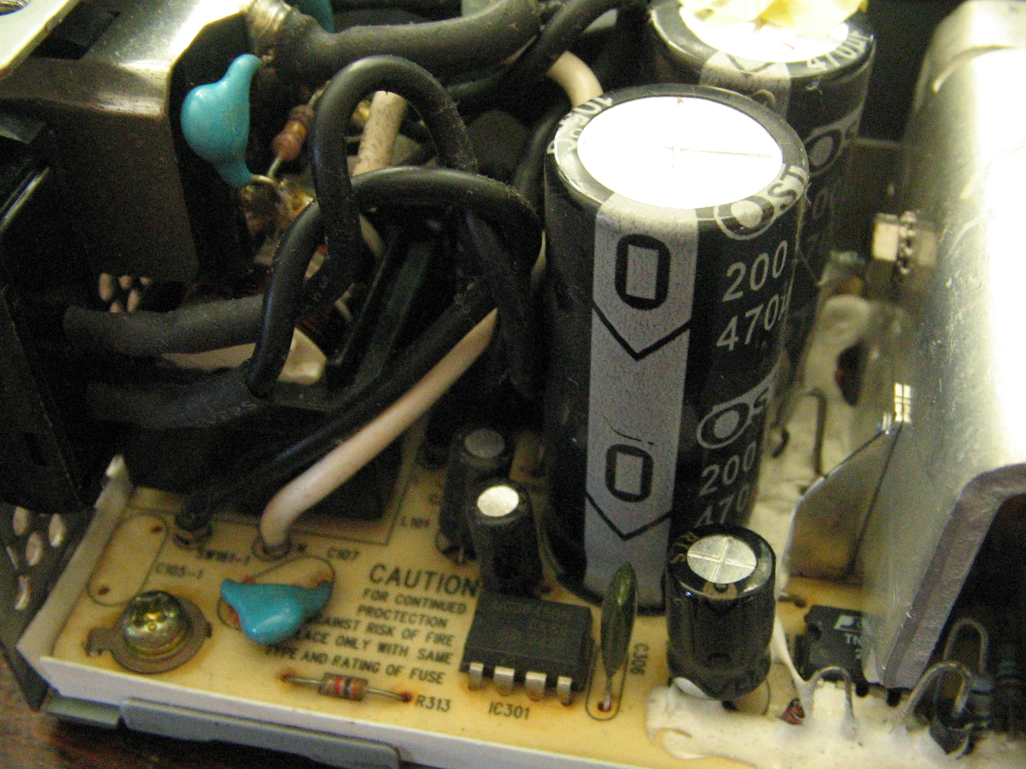

                                  Some eye candy...
                                  For the record:
                                  Main PWM control is a UC3845BN
                                  5v Standby is done with a TNY266PN
                                  Supervisor IC is a Weltrend WT7515
                                    Is the PG/PWR_OK wire directly connected to the WT7515? Looks like it is to me. Check if there are any resistors between in and ground or 5V that and make sure they are alright.
