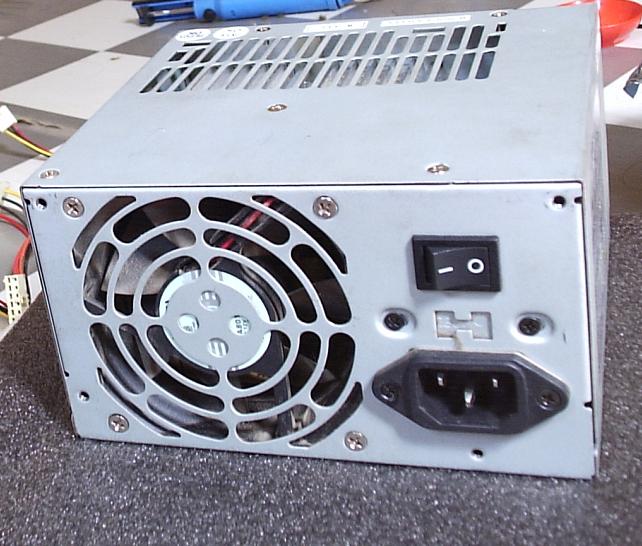

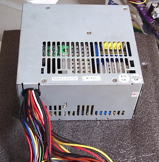

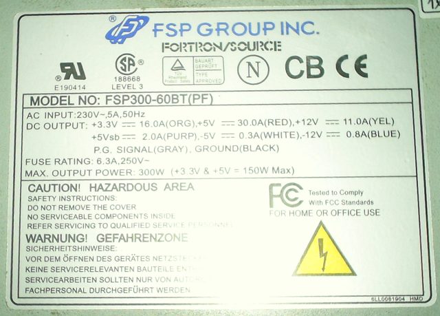

    Fortron FSP300-60BT PSU (300W)

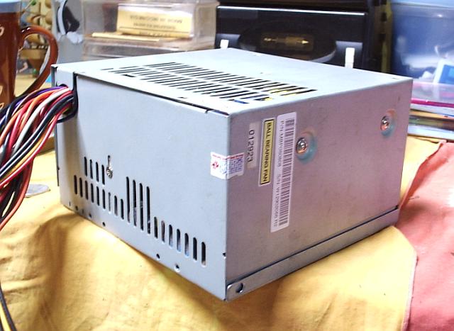

    External Look:
    Premium supporters get full download access and other benefits.

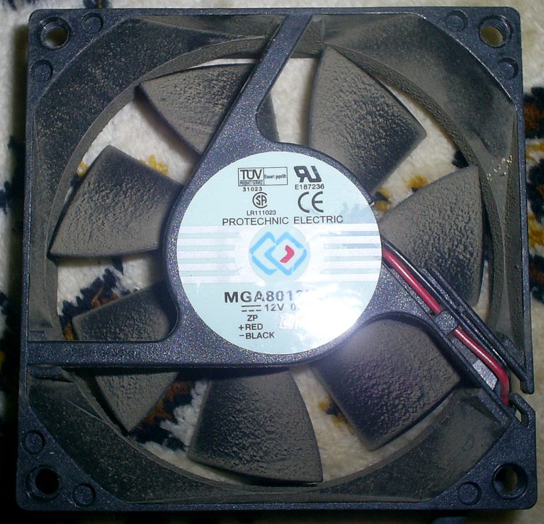

    Re: Fortron FSP300-60BT PSU (300W)
    The fan:
    PROTECHNIC ELECTRIC
    UL E187236
    MGA2018HB
    12V 0.24A
    2001-7-8

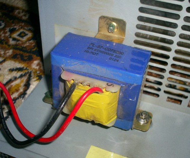

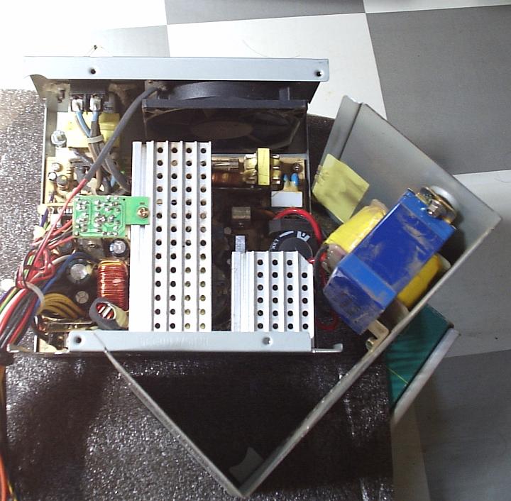

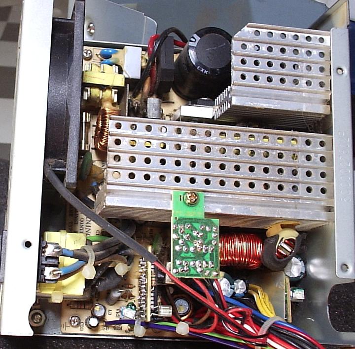

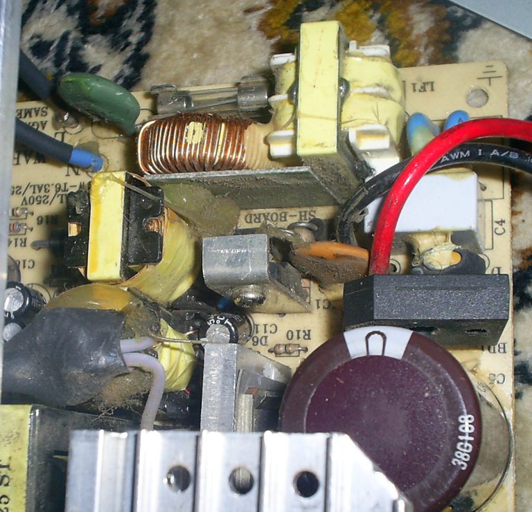

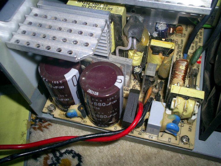

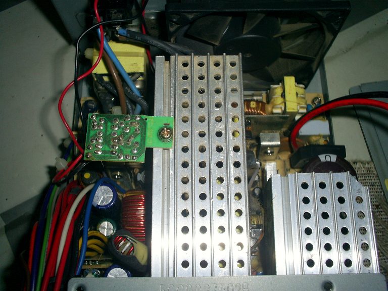

      Inside look:
      The pfc coil:
      days are so short when you actually do something..

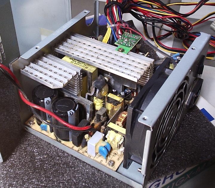

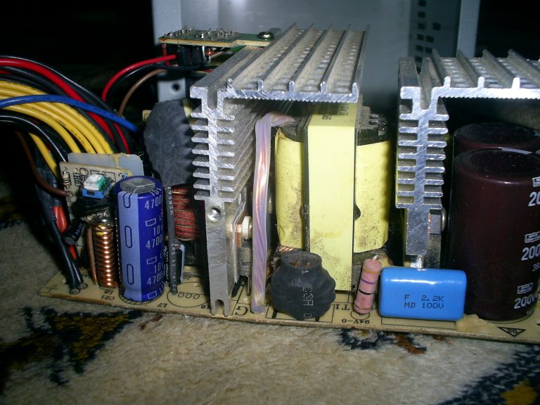

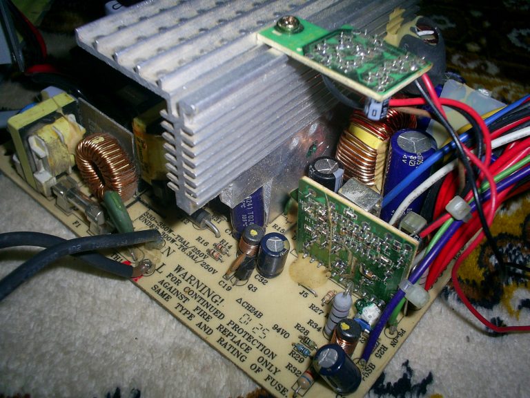

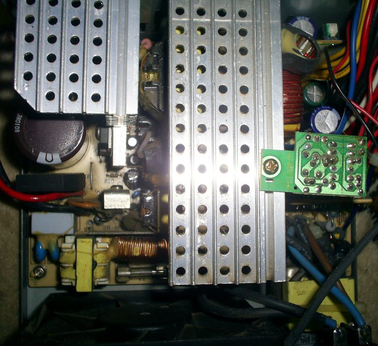

        After recapping:
        primary side:

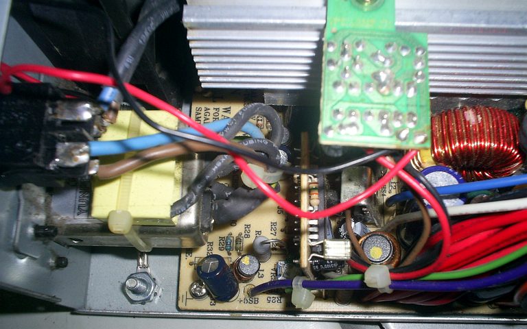

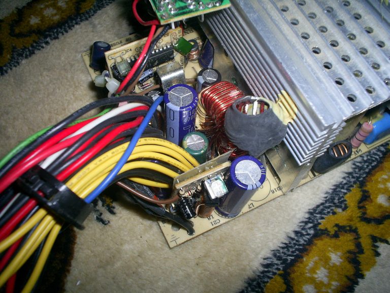

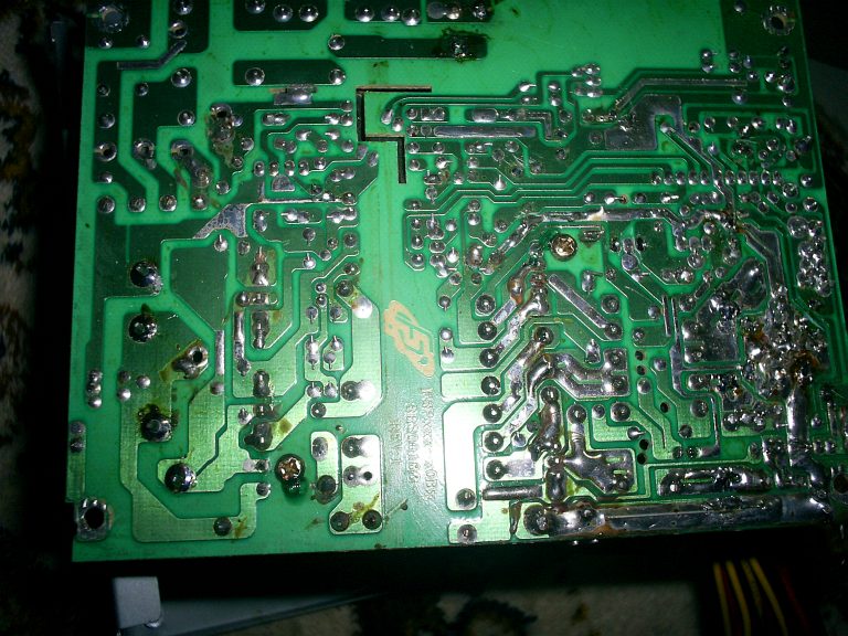

          secondary side:

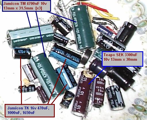

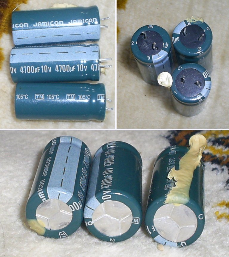

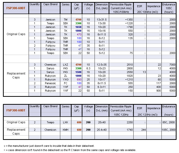

            Caps replacement
            Original caps:
            Jamicon TM and Teapo SEK on output filter
            • yanz
              • Nov 2004
              • 910
              Jamicon TM

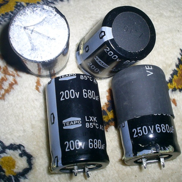

                Teapo LXK on input filter:
                (the ones that was used in this PSU -> 680uF 200V)
                    Conclusion
                    Was it important to recap this otherwise a still good-working psu?
                    It is very subjective (to me). This recapping was done when i was learning the PSU recapping in my beginning time. I blindly recapped all the caps to the smallest ones.
                    But this is my conclusion now:
                    • the big primary caps (teapo lxk 680uF 200V) don't need to be replaced. the only reason they should be replaced will be for upgrading the capacitance. (i forgot to use my 820uF chemicon KMH though, the 680uf ones is used instead.)
                    • no caps were bulging, but there's nothing wrong with recapping the Jamicon TM and Teapo SEK caps (output filter), if it's not japanesse caps i can't be sure it will last long. 2-3 years are probably okay with taiwan/chinese caps but not 5 years.
                    • original fan was replaced with Adda brand (brushless). should be using the ball bearing ones (i forgot )
                    • all tinny caps was replaced. i want to be sure that the lytics wont be the first to fail in this psu. can't be 100% sure though.
                    • it don't even cost me $8 for replacement parts. it's a mere hobby project, desired to gain some skills and knowledge in recapping. thank good this psu wasn't filled with fuhjyyu caps like the others fortron 300W.
                    • powering an prescott 2.8ghz system (been 4-5 month) is okay (only 11A on 12v? ). don't underestimate a good 300W psu!
