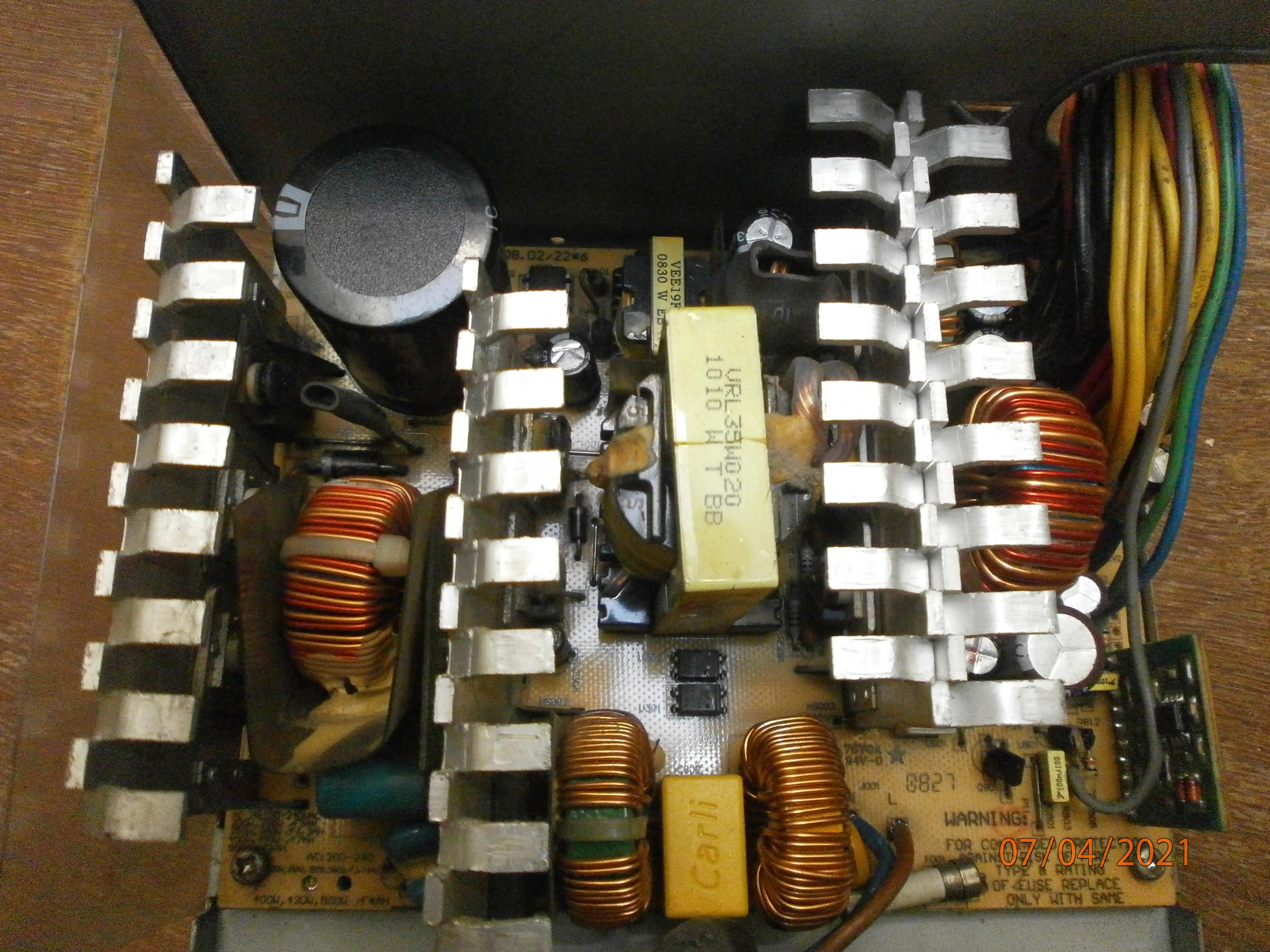

              * 9-year bump *
              I got an SS-400ET which was functioning fine despite its ~2013 initial sale date. All rails were in spec, and no visible cap failures (mostly OST RLS and one Teapo on the secondary). Nevertheless, I decided to recap whatever caps for which I had spares handy.
              Primary APFC boost 220uF/400V/85c NCC -> 220uF/450V/105c Yageo (not really necessary - if it survived a decade, it's probably not going to die now. However, I decided to add a margin of overvoltage safety as per Momaka's experiments with his Enermax. The Yageo 450V/1005c is slightly larger in diameter, but the PCB layout has fortunately been designed for this size - bean-counters probably downsized the cap to 400v/85c to save a few cents.).
              Primary bootstrap 100uF/25V OST -> 100uF/50 Rubycon YXG
              Secondary +5v inboard 2200uF/10V OST -> 1800uF/16V Panasonic FJ
              Secondary +5v outboard 1000uF/10V OST -> 1000uF/10V NCC LXZ 8 mm
              Secondary +3.3v inboard 2200uF/10V OST -> 1800uF/16V Panasonic FJ
              Secondary +3.3v outboard 1000uF/10V OST -> 1000uF/10V NCC LXZ 8mm
              Secondary +12v inboard 2200uF/16V OST -> 2200uF/16V NCC KZE
              2x secondary +12v outboard 1000uF/16V OST -> 2x 1000uF/16V Panasonic FL 8mm
              Secondary -12v 220uF/16V OST -> 220uF/25V NCC KY
              +5Vsb 3300uF/16V/10mm Teapo unchanged for now (don't have that value in 10 mm)
              Powered up, no bang or smoke and everything seems to be in spec - we'll see if the APFC boost holds up over time.

                your capacitor choice is awkward at the very best

                  I had to use whatever Japanese caps I had in hand that would fit in the space available (10mm and 8mm at most of the secondary locations). There's a 2200uF/16v/10mm Taicon HH that I have in stock, but was unsure of its reliability compared to Pansaonic FJ. The 3300uF/10mm Teapo on the +5Vsb is hard to find a replacement for unless I downsize the value to 2200uF.
