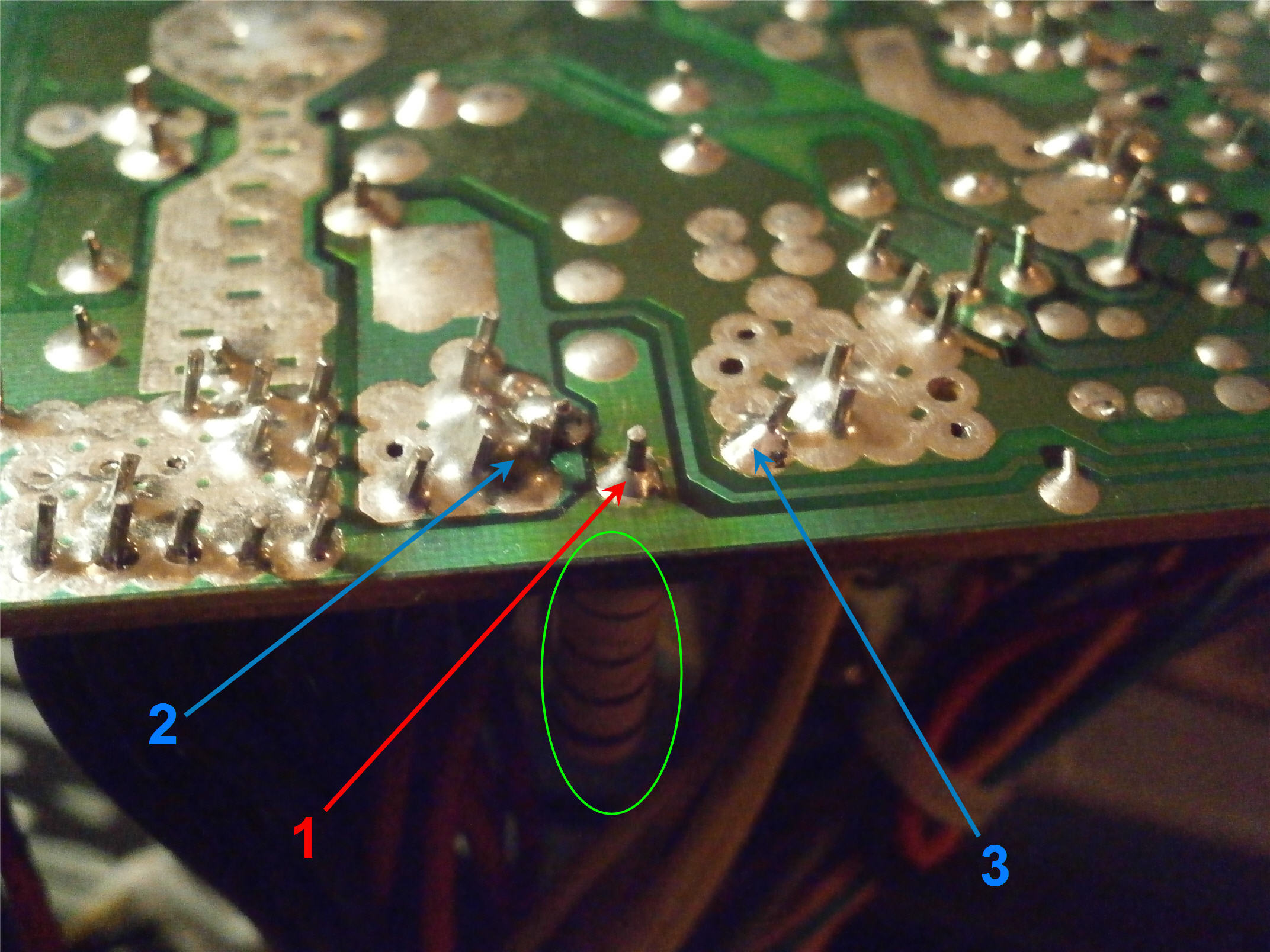

    Already done that. The fan was spining very easily already, but I took it apart, cleaned it nicely and lubricated the axle a bit - now it spins even more easily and quiter. I'm sure it will come handy in some part of the PC casing.
    I guess I'll have to part from the idea of fixing this PSU, though I really wanted to try. But if it will not work safely, then there's no point I guess.

        Yes, this one will definitively be stripped off of usable parts and then trashed. The overheating resistor problem becomes more than that. After testing for awhile, I found that the heat it produces actually gets conducted through the solder and lead points, and then through the wires connected to it - and some of those go to the MB connector, which makes the MB socket very hot. I suppose if left longer on, its plastic will eventually get melted, exposing the contacts and maybe burn itself or the motherboard PCB. Which is out of the question, we'll all agree.
        Also, the problematic 5V output (having connections with these overheating resistors) is only 4.3V. Not good enough.

          You sure? Stranded wire usually does not conduct heat so well.
          I would more bet on several things, connected with each other
          - too thin wires, making huge losses
          - conencted with ^, lower voltage making board suck more current, even worse losses on wires
          - el' cheapo pins on connector, making transitional losses
          Low voltage on +5 V only confirms it. This PSU seems to be utter crap…the resistor maybe even baked itself to lower resistance, it may be sucking much more current than supposed to.

            Heat wouldn't go up the wire.
            I'd bet on the metal in the connector being too loose, making an imperfect connection to the motherboard.

              Yes, guys, I am sure. I am telling you, that is exactly what happens. The red wires, which transfer 5V, are connected at one solder point with the problematic resistor. As you know, PCB leads and wires are made of copper, which is an excellent heat conductor. Only the red and yellow (12V) wires get very hot (because of the contact with the overheating resistor - anyway, you can see on the above pictures that the insulation on some of those wires got burnt), but since they go all the way to the motherboard 20-pin connector, when this PSU is connected with a good working board for no more than 5 minutes - you can actually fill the hot wire(s) by gripping the cable bundle that goes to the 20-pin connector, pluged in its socket on the MB. Then the area around that socket on the MB starts to get pretty hot. Since 5V and 12V wires are hot, their respective pins on connector and MB become hot as well (because heat gets transfered on them through the wires). The MB is fully functional, and when tested with other PSU it does not heat up there. I guess this PSU transfers both power and a bit more heat through the wires... and that's scary.
                  Not that much. I don't believe it being able to conduct heat over tiny wires at some 20+ cm lenght.
                  Usually +5 and +12 V are most used voltages, +3,3 V is barely used these days so there is no power output thus no reason for wires to heat up.
                      Hi again, guys. I do not wish to sound like I'm contradicting or anything like that, but it's the truth. Only 5V and the 12V wires are getting hot. Because of the resistor which becomes burning hot. If at some point it got hot enough to desolder itself and the wire next to it, then the temperatures it reached were surely at least 200 degrees or more. Some of that heat ought to have passed through the wires and then towards the socket.
                      In order to rule out that the motherboard itself is causing this, I started the PSU with nothing connected to it, only by using a single piece of wire between the green pin and the ground pin. After a couple of minutes, the 5V and 12V wire cables became hot all their lengths outside of the PSU casing.
                      I saw several pictures of some scorched pins on 20-pin sockets on the motherboards. I am guessing that malfunctioning PSUs like this one, if connected to the board for a sufficient period of time, may actually do that kind of damage.
                      Everything I described above is exactly as is. Look at the picture: the resistor gets burning hot, and first it desoldered itself (1), during that process it desoldered one 5V wire (2), and 12V wire(3). Then the heat probably gets transfered to other red and yellow wires soldered to the same place on the PCB. Those wires then become hot all their lengths outside the PSU's casing.
                      Somebody here suggested me to throw this PSU into a fire before it lays eggs, I guess I'll have to do just that. It looks like this PSU is on a good way to throw itslef into a fire of its own.
                          Thats it. If it was conducting heat, there would be temperature gradient. The resistor simply does not have enough power dissipation to heat several long wires to almost same temperature all along. Have you ever tried to heat 1 meter long copper pipe with open flame? It will barelly get warm on the other end when one end is shining red.
                          You know what, desolder the resistors and try again. Than share the results.
