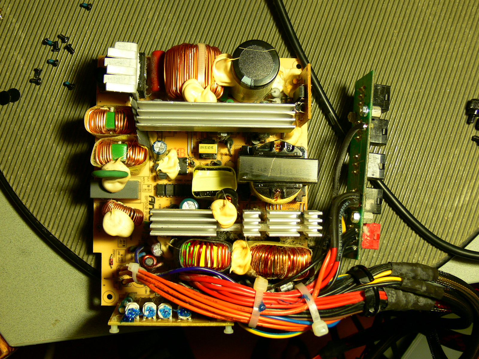

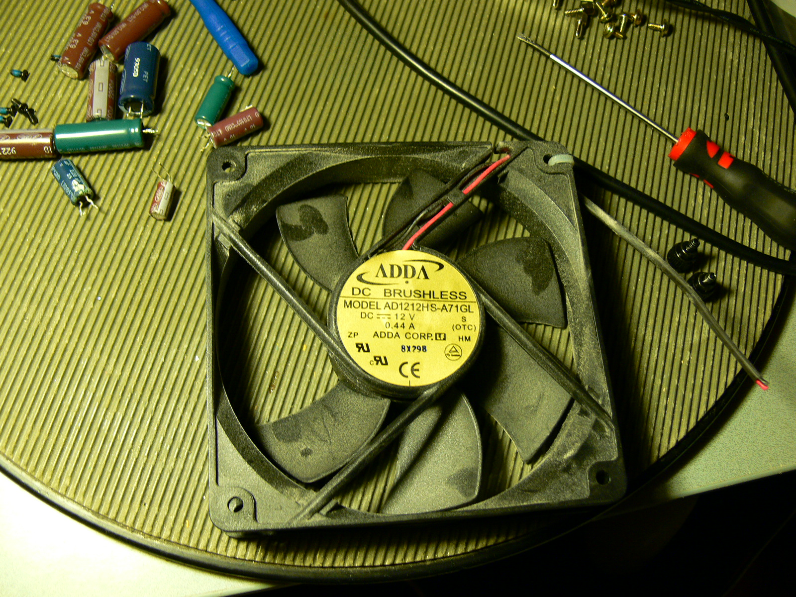

    I decided to crack this one open, because the fault i got it with was a broken-off blade from the 120mm fan
    Upon plugging it in, 5Vsb came up just fine. Shorted the green wire to ground, and it powered up apparently fine (if you ignore the racket coming from the unbalanced fan), albeit with a fizzy-squealy sort of noise. OEM'ed by Delta, btw...
    Replaced the fan with another Adda, "grafted" the 2-pin connector onto the replacement.

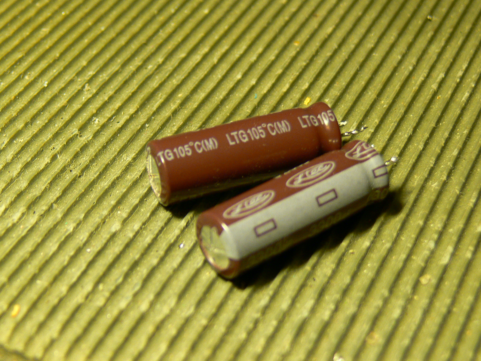

    Upon inspection, the two Ltec LTG 3300u/6.3v on the 3.3v output were well-bloated. Datasheet for that series can't be found They got either some Rubycon YXG's or some Sanyo in their places... Can't remember right now
    12v: 2x Ltec LTG 2200u/16v -> Panasonic FK 2200u/16v
    5vsb : Taicon PW 1500u/10v & Ltec LTG 1000u/10v -> 2x Sanyo ME-WX 1500u/6.3v
    5v: Taicon PW 1500u/10v & Ltec LZG 3300u/10v -> Rubycon YXG 1500u/6.3v & 3900u/6.3v
    Plus the 220u/35v near the TNY268 got a Panasonic FR 270u/35v in its place, and the Ltec LTG 100u/25v on the daughterboard with the PWM got replaced by a 47u/50v Rubycon YXA.
    Didn't bother with the two small Taicon's on the -12v line :P:
    It's been up&running since yesterday, and powering an AM2 Sempron 2800+ on an Asus M2N-SLI board, with a Radeon 5850 and a 7770 mining for bitcoins, and i haven't had any trouble with it so far

    The TNY268 is a good choice as 5vsb pwm chip, and that booster coil in the APFC circuit looks big enough to do a good job. I have seen much smaller coils which get hot and short. With some good capacitors and a "balanced" fan, looks like a good power supply. Its a keeper.

      Re: Job lot PSU no.2: Antec BasiqPower 550 Plus
      Well, the only thing i'm marginally worried about is that the original fan, i suspect, was a "high speed" version (note the "HS" in the model number), and the replacement is a "medium speed" version. The computer case does get quite a bit warm just behind the PSU (where the modular cable connectors are), at full load
