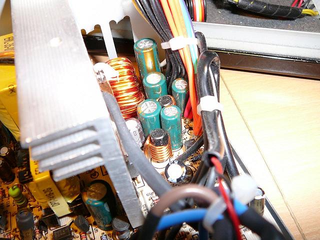

    Hi guys,

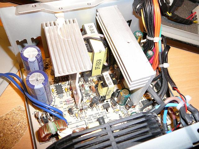

    been having totally random boots and squeeling from the audio with my comp and decided to go through the caps. My Abit NF7 motherboard looked to be OK (will inspect it better later) and my PSU Hec 300w LRPTF also seemed to OK.
    However I started looking at the caps they had used...

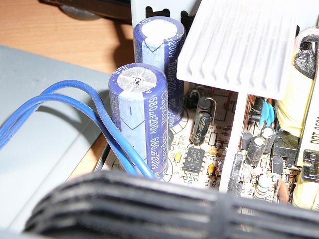

    2 x CapXon on the primary side
    Teapos, 1 * Jamicon (?) on the secondary side

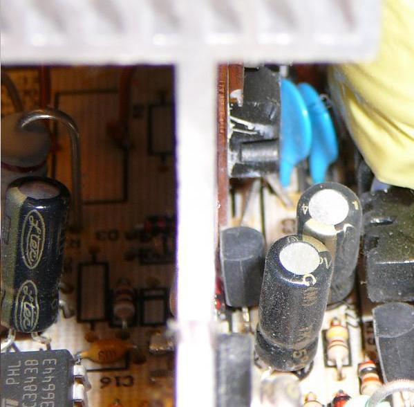

    and two brands I couldn't tell. The other one has the letters Ltec and the other one has (M). Any ideas on those brands?
    Any thoughts on the caps? CapXon and Teapo aren't exactly the best available, but they seem to be in working order so I doubt they are the reason. Overall the PSU operates quite cool, I've swapped a Panaflo FBL80L1A in there, opened up the intake vents and I'm using a fresh air PSU duct from the front of the PSU.

    (M) should be Matsushita (aka Panasonic), certainly one of the better brands.

      you can see the (M) I mean in the last photo. I thought of Panasonic too, but it's not shaped like the Matsushita logo. But it is Panasonic?
        Oh you mean that M - no that looks like part of one of the Ltec caps. I think I can see the edge of the Ltec logo on the sleeve on top of the cap in that picture...

            (M) is +/- 20% tolerance Tiresias....tsk tsk.......
