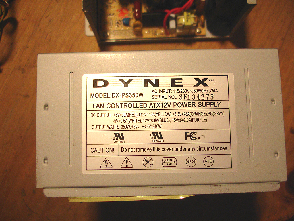

      As for 19A on 12v, I doubt it... that would mean 230 watts out of 350 watts usable on 12v - unless it's a relatively new psu with modern design, that rating is a lie. Generally old 350w psus have about 12-14A on 12v

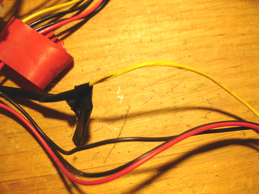

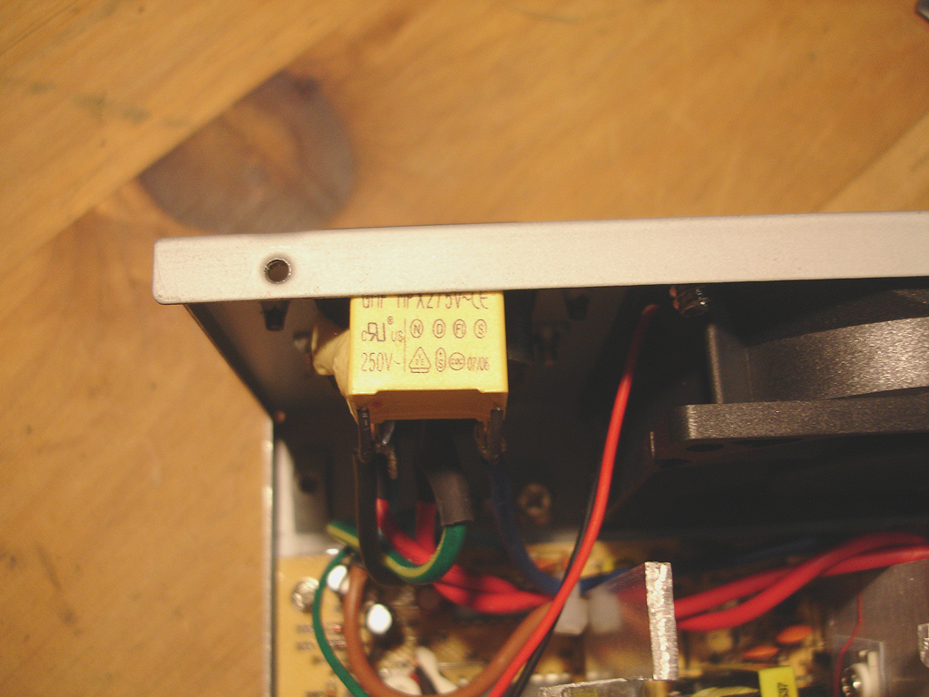

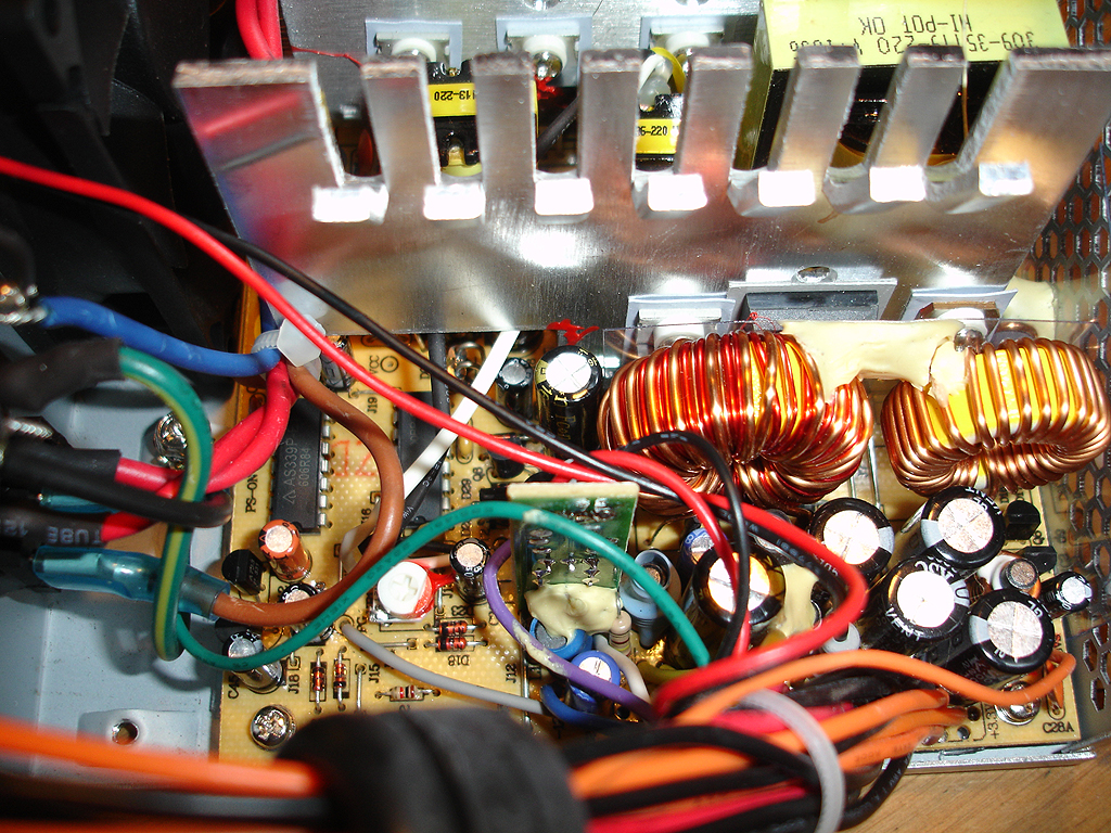

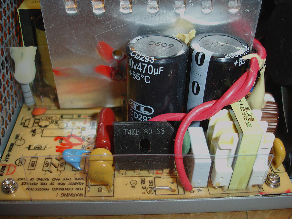

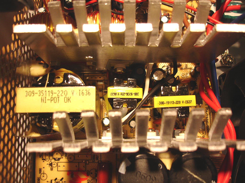

        Here are the pictures. The yellow wire of the floppy connector started smoking, you can see the burnt wire in pic#6.
        There are NO fuyuhu caps in there, which is probably why these Dynex PSUs are quite reliable. There is no burn damage inside the PSU.
        Please let me have your comments.
          Re: ATX PSU Testing
          Yeah... E131865 , made by Huntkey
          Probably one of the models here : http://www.huntkey.com/Product/Producttype.aspx?id=42
          A very similar board and power supply is reviewed here: http://www.hardwaresecrets.com/artic...y-Review/527/1
          This one was rated for 450 watts but only made it to 357 watts, so I wouldn't be surprised if yours is a bit overrated.
          I don't see anything obviously bad, so check the voltages when you power the power supply.
