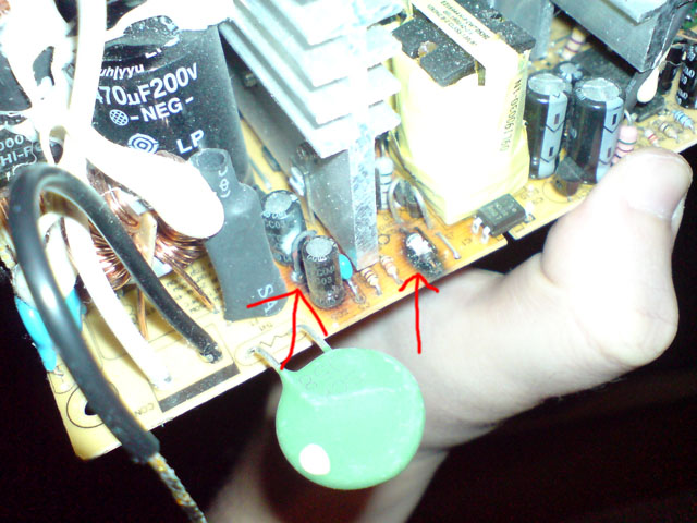

                I just got SP-450P free. It was replaced because of squealing noise. Knowing what to expect I popped it open and took a closer look. Surprisingly all output caps are visibly ok, but 1000uF/10V caps in AUX PS are bulged. Also one of two line input caps seems that it might be bulging, so I might replace input caps as well to be safe.
                Then I spotted two burnt components. Diode (pos D5?, glass) is burnt and the glass is broken so I there's really no way to know what kind of diode it was. Another burnt component is a resistor. It is also burnt beyond recognition.
                I attached a picture with these two components marked with arrows. The one on the left is the diode (behind a cap, hard to get better picture of). Resistor is on the right.
                If somebody has same kind of psu with these two components intact I'd be happy to know the component values.

                  the Resistor is 5.6 Ohm (1W)... Green-Blue-Gold-Gold, according to the link below:
                  http://www.discovercircuits.com/foru...65&an=0&page=1

                        Found one of these squeeking today. The diode is a 18V 1W zener diode, 1N4647A, a bit burned but you could make out the marking. Mine also has ec10 and ec11 leaking and R11 burned. I'll replace them tomorrow and see how it goes.

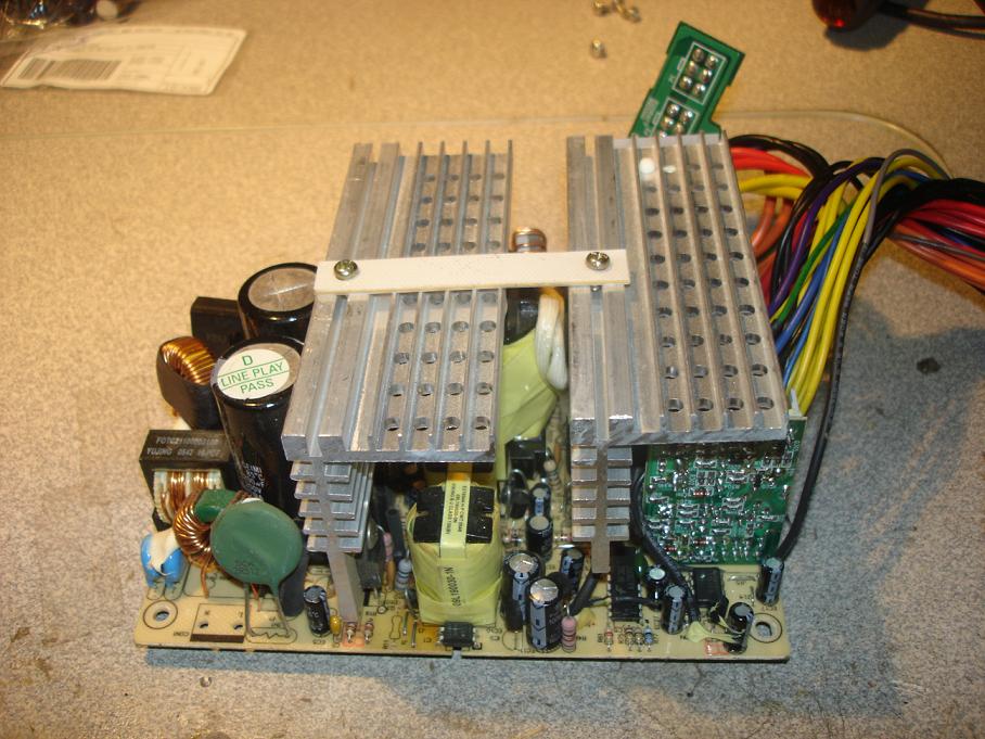

                          I just took a look at the pics I shot of my PSU before my recap.
                          Oddly enough on my Antec SP 500 watt PSU that resistor is omitted. The silkscreen is there but nothing is in its place check out the pic.
                          Antec may have omitted that resistor on future models.

                                  Found this forum because i had the same defects in my PS. Burnt resitor and blown zener..... Replaced these with the info on this forum.. Thanks for the effort taken!
                                  But, while open, checked the complete PCB on weak solder joints (found several) and bad capacitors. Two had bulbs... 1000uF/10V. Measured theseTEAPO capacitors... 23uF and 189uF was all that was left of the 1000uF... So i'm not so impressed by this brand...

                                    I found in Antec SP350 SAME problem like killjoy user. but with extra info: EC5 (22M 50v works like 2,2M ), but fizical is looking ok!) I replace TEAPO 2x1000M 10v (on stand-by line) with KZG 1000M on 16V low ers, 5R6 resistor and 18V Zenner echivalent (hope will work with romanian zenner PL18Z)
