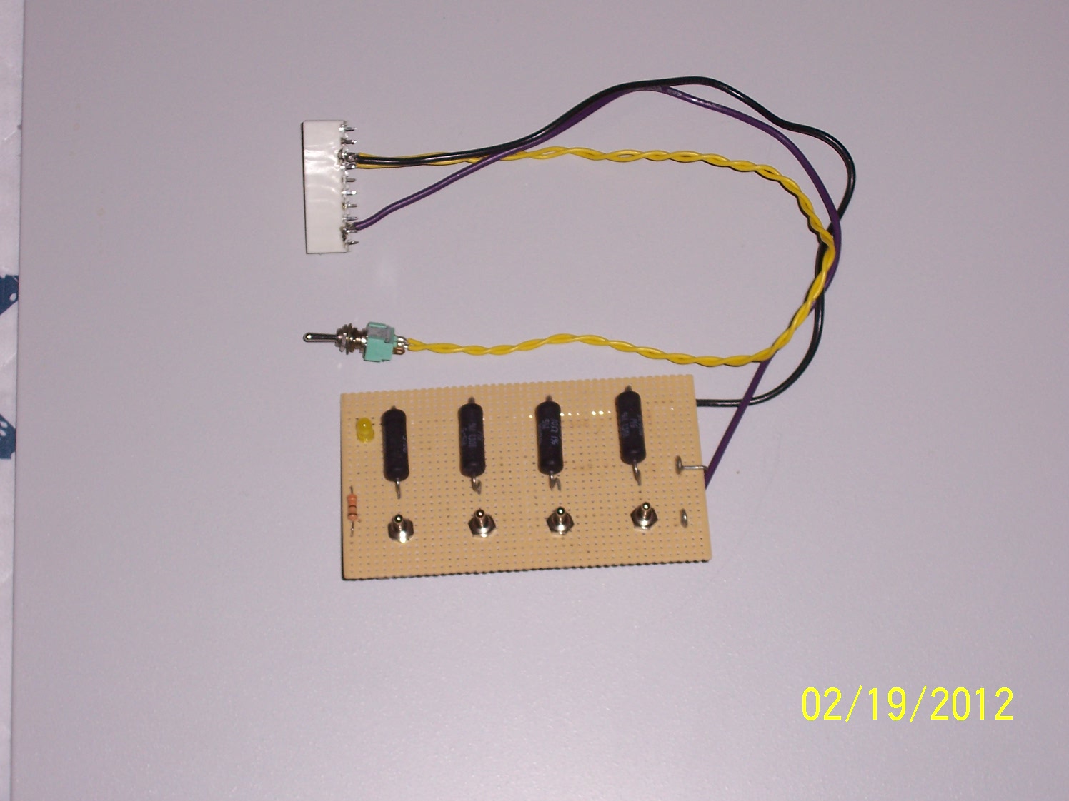

    Pictured below and with drawing is my 5VSB Load Tester. It uses four 10 ohm 5 watt load resistors which can be switched in separately, and a switch to turn the power supply on and off. A 20 pin connector was removed from a “throw away” mother board. Load resistors and switch were soldered to this connector. The power supply then connects to this connector.
    When the power supply is plugged into the wall outlet (power switch is in off position) the 5VSB must work, or the power supply won't turn on when the power switch is turned on. This is true regardless of amount of load on the 5VSB rail. So with power switch off, measure the voltage on the 5VSB rail as load resistors are switched in one at a time. Voltage measured should remain at 5 volts +/- 5%.
    No resistors “in” is no loading
    1 resistor “in” loads to 0.5 amp
    2 resistors “in” loads to 1.0 amp
    3 resistors “in” loads to 1.5 amp
    4 resistors “in” loads to 2.0 amp
    I am using only four resistors because any ATX power supply 5VSB should be able to deliver 2.0 amps. Otherwise there is a problem to be resolved. More resistors can be added, but would be destructive testing. My intent was to make sure the 5VSB rail could and would deliver up to 2 amps. I am not as interested in finding at what point the power supply fails and self destructs.
    For the second part of the test, switch all four resistors “out”. Then turn the power switch ON. The power supply should come on, and the fan should start turning. Now switch the four resistors in one at a time while measuring the voltage on the 5VSB rail. Once again, the voltage should measure 5 volts +/- 5%.
    This is an easy test for a good power supply to pass. Failing either test means trouble. The power supply may stop, or act erratic and unpredictable. This can cause a computer to stop, then restart, or go into blue screen mode. Bulging capacitors and other defects in the 5VSB circuit is a COMMON problem with computer power supplies. Using this Load Tester as a first test will flush out a lot of problems and save a lot of time.

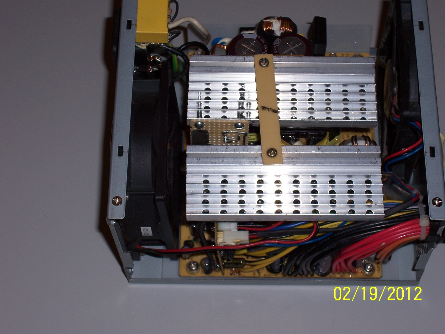

    Although the 5VSB Load Tester can be used for general troubleshooting, I designed the tester to be used in converting 5VSB circuits from “Two Transistor” circuit to PWM chip circuit. As a first example, I recapped an Antec SP450 and did the DM311 mod. With the new DM311 5VSB circuit and no load resistor on the 5vsb rail, it measured 5.08 volts. Great.
    Next, I hooked up the 5vsb load tester. Here is how the 5vsb rail looked when loaded:
    1 resistor 3.81 volts
    2 resistors 3.38 volts
    3 resistors 2.47 volts
    4 resistors 2.02 volts
    Not so good. So what happened? The key is watching how the feedback winding powering the DM311 is reacting to load changes. As more resistors are added, the DM311 has to deliver more power into the transformer. The 5vsb rail is regulated BUT the feedback winding powering the DM311 is not. So as more resistors are added, the feedback voltage powering the DM311 increases. Looking at the DM311 data sheet, when this voltage reaches or exceeds 20 volts, the chip goes into overvoltage shutdown. So here are the feedback voltage measurements:
    No resistor 16.02 volts
    1 resistor 15.45 volts
    2 resistors 19.78 volts
    3 resistors 19 to 23 volts varying
    4 resistors 12.1 volts
    So what is happening? With no resistor, the 5vsb output is 5.08 volts and the feedback power is 16.02 volts. As resistors are added, the 5vsb output is dropping because the feedback power has reached the 20 volt limit, the DM311 stops, then tries to restart, stops, restarts, stops, restarts…..and so on.
    I cannot yet say that EVERY Antec SP series power supply will not act properly with DM311 circuit, but this power supply did not work well with it.

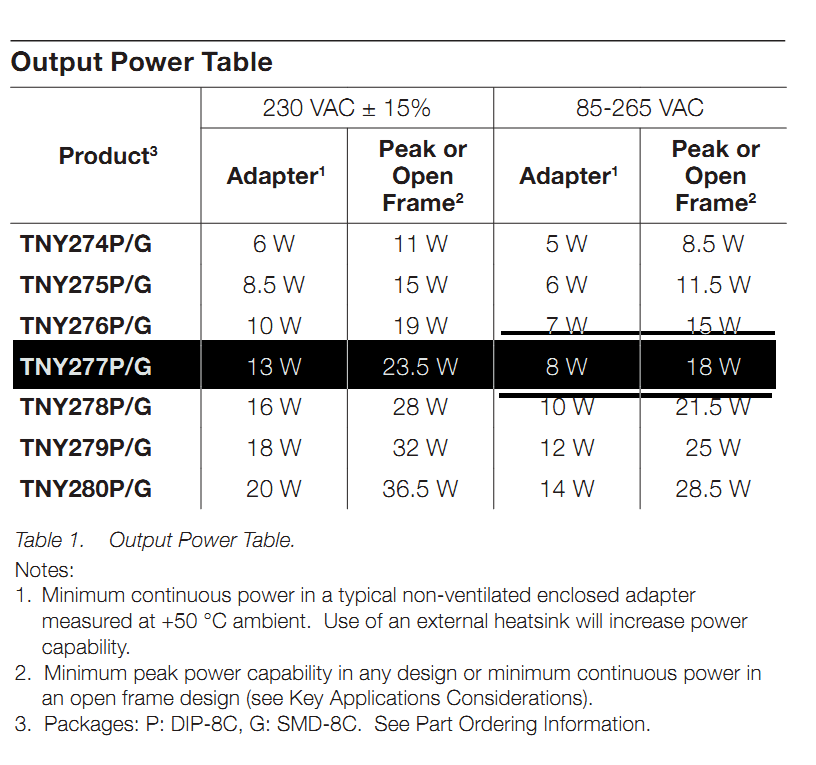

    Next I tried a TNY277 chip. Here are the results. The 5vsb measurements:
    No resistor 5.07 volts
    1 resistor 5.04 volts
    2 resistors 5.01 volt
    3 or more resistors dead
    The feedback voltage measurements powering the TNY277 chip:
    No resistor 16.80 volts
    1 resistor 22.9 volts
    2 resistors 25.4 volts
    Once again this feedback voltage has gone too high and caused the overvoltage circuit to kick in.

      Not surprised the TNY277 didn't make it:
