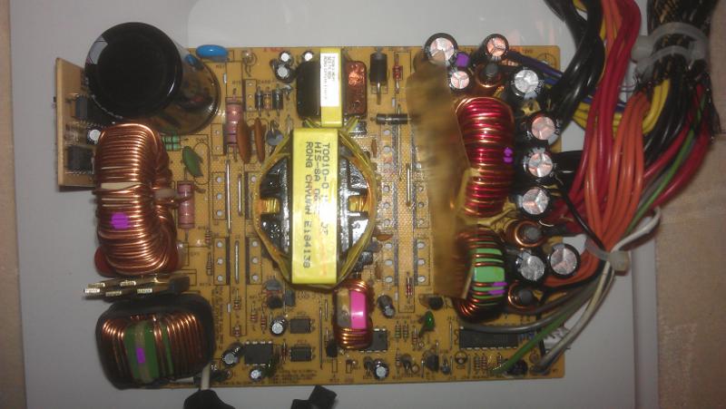

    Good day all.
    This week while using my workshop computer, I had a BSOD and the computer restarted, it got into windows and the computer locked up, So I then pressed and held in the power button.
    Since then I have not been able to get this PSU to turn back on again.
    When the mains power is on, I get the 5volt standby fine, but you press the power button you hear a click, and then a high pitch wissle/buzzing.
    The power supply in question is a Enermax Liberty ELT500AWT.
    I have removed the lid/cover, and I can not see any burnt/damged parts.
    I have read that some early Enermax psu's had glue that would short out, but this psu does not look like it has any of this glue near the high voltage parts.
    I haved tried this power supply in a computer, and on the test bench, but it still fails to switch on.
    When I get some free time I am going to strip this psu down more, and go hunting for the problem.
    I have now ordered a new psu to replace this one with, but I would like to try and find out what had failed in this psu.
    Can anyone please give me some pointers on where to look?

                                Mad Professor: In what country are you located. It is helpful to know if you are using 115 volts (as in US) or 230 volts (as in Europe).
                                It would be helpful if you would post a few pictures of your power supply.
                                From previous posts, I think you have APFC circuitry. If so, it is very common to have one of the FET transistors short because of a shorted booster coil. Also, you mentioned that the primary capacitor was 330 Mfd at 400 volts. Was it Rubycon or Rulycon. The two words look so close. Rubycon capacitors are high quality whereas Rulycon capacitors are rubbish.
                                Using DMM measure the resistance of the two IRFP460A FET transistors. If one has zero ohms between two of its legs, but the other does not, that is a good starting point. Also measure the resistance of the fuse - should be zero ohms.

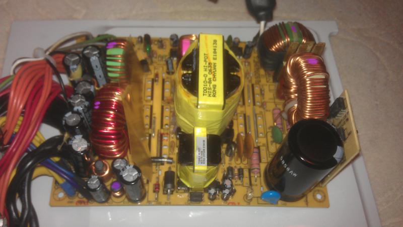

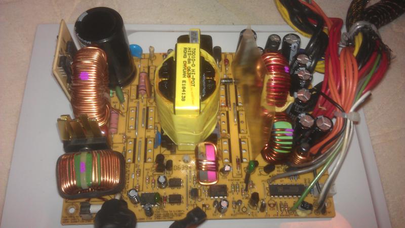

                                  • Mad Professor
                                    • 9
                                    Re: Enermax Liberty ELT500AWT fails to turn on
                                    I live in the UK, so our mains power is 230v 50Hz.
                                    I have also attached pictures as requested.
                                    Can someone tell me what, R15 - (Black, Blue, Silver, Gold, Green) is ment to be, as my DMM is showing it as a dead short.
                                        That should be resistor, but having black stripe both first or last is strange. Could you take image of that one?
