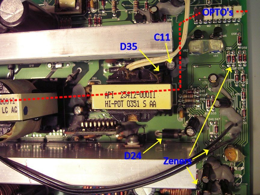

I have a G5 Power Mac power supply model AcBel API2FS34-291 p/n:614-0306 The relay clicks on and off when I push the button to power up the system. Currently the PSU is removed and open. I figured something would cause the protection relay from powering the system. From visual inspection of the power supply there are no burn marks from blown transistors that I can see and no bulging caps. I also did continuity check on the fuse and it's good as well. If anyone has any suggestions or has had a similar issue I'm all ears.

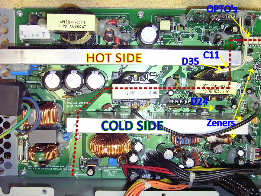

Orient the board so power input is on the left, fans on the right. This places it so all the markings legible and "right side up".
Place your meter in the 200v DC scale.
* WARNING * SHOCK HAZARD *
You, like many others here, are probably not using an isolation transformer. EVERYTHING to the left and across the top of this supply can be at mains / line voltage or higher. The same that comes from your wall outlet. That includes the top heatsink, the tops of the very large caps and any other exposed connections. Contact with those areas may cause a severe shock, burns, or death. If you are not sure of what you are doing, Don't Do It. ASK FIRST !
> See Pictures attached <
With that out of the way, let's proceed:
Plug in the supply. No jumpers.
Check for voltage across D24. It's the large diode just below T2, the far right transformer between the heat sinks. Negative probe to anode, positive to cathode (banded end). Report.
Leaving the negative probe in place on D24, measure and report the voltages at the cathode end (banded) of the Zener diodes to the right, up by the sealed trimmers, and a few more below them. I'll list them in order coming down the board:

With the negative probe still on D24's anode, measure and report the voltage on Pin 1 of each of the 5 optoisolators. They are the square little devices with 4 legs above the trimmers. 4 white and 1 black on mine. Pin 1 is the lower left pin. If you look at them closely, the pad they are soldered to on the board is square, and there is a dot on the body of them. Be careful not to short the pins on these.

Place the negative probe on the negative lead of C11 which is the small cap at the upper right of T2, between T2 and the upper heatsink. Place the positive probe on the cathode of D35 which just to the left and down from C11. Report voltage.

I've doubled checked all these and below are the readings from my DVM at the 200 VDC setting. My optoisolators are all black (NEC) seems odd that you would have just one black and the rest white. M2 was the only one that didn't have a voltage (bad possibly). I must say very thorough on your explanation and the picture diagram, your effort did not go unoticed. Cheers.
D24: 5.1 Volts
ZD9: 11.9
ZD8: 11.9
ZD10: 4.9
ZD7: 12.5
ZD11: 24.3
M5: 22.6
M2: 0
M12: 12.7
M7: 12.7
M8: 5.1

Measure from the negative of the output side connections, where all the black wires join on the board, to the -tab- (not the screw) of D8. D8 is mounted on the upper side of the lower heatsink, adjacent to T2 and just to the left of the D24 diode from earlier. Both pictures show it clearly, and it's right above the "D24" text on the 2nd picture. The designation is probably hidden by the goop on the board.
