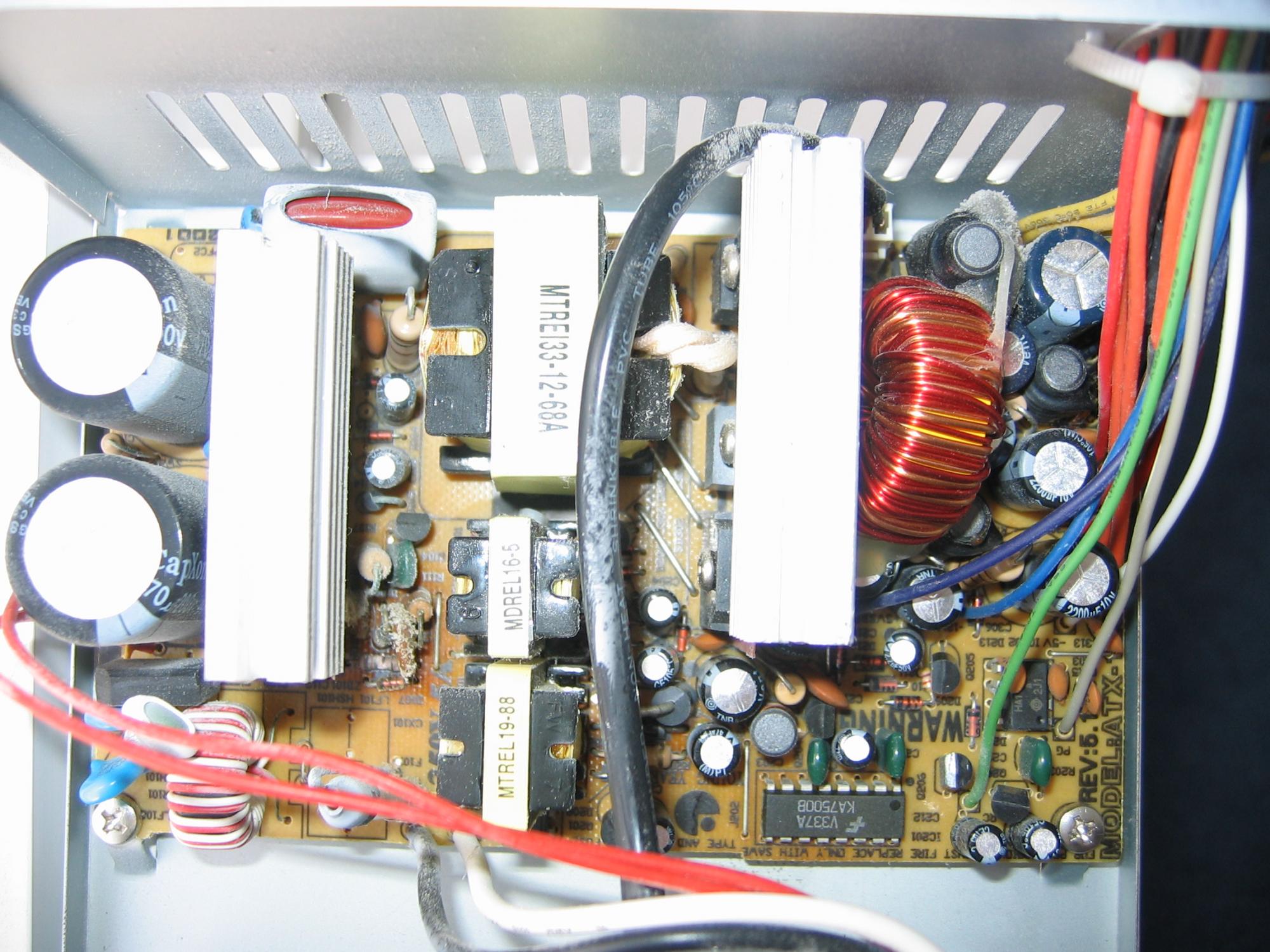

    3) I took apart the power supply and noted two TNR 470uF 10V caps bulging. With all the glue/tight fit, the only 16V cap that I can see is the biggest one in the top right hand corner (Fuhiyyu 2200uF 16V). There may be others on the 12V rail, but until I take more things apart, I don't know for sure.

            One of the bulged caps seems to be on 5vsb and that's not good for your chipset. The PCB near the 5vsb circuit is also starting to burn up - that means impending failure on 5vsb unless the critical cap in that circuit is replaced.
            I think it's time to retire this PSU and maybe use it for parts only (unless of course you plan to recap it or just use as a bench power supply for powering non-important things).

                        Re: 11.4V on 12V rail with YoungYear ATX PSIV-400-2
                        My plan is to recap and use it for Internet usage machine with no critical data sitting on the hard disks.
                        In that case, make sure to change all of the caps on the secondary and maybe even upgrade them if they need to be. For example, if the 3.3v or 5v rails have anything less than 2x 2200uF caps each, then change the caps so that they do. The 12v rail is also very important - in fact the most important here, since you'll be powering a P4. Get at least 1x 3300uF in there.
                        And don't forget the critical caps near 5vsb (usually 10, 22, or 47uF) as well as the caps on 5vsb itself.
                        Last but not least, check the capacity of the 12v rectifier. For a P4, you'll want at least 16A.
                          Upon a second look at the PSU, it seems that there's more work to be done besides the recap.
                          1) Remove the load resistors between the capacitors on the secondary side. I can see two (one is next to the bulged cap near the coil, the other is slightly above that in the picture). There may be 3 or more, actually - usually one for each rail. The one next to the other bulged cap is likely between 5vsb and ground - please check. If it is, remove it. The reasons you want these gone is so that they don't cook your new caps.
                          2) The primary side is missing a safety X cap (between fuse and filter choke). Find one and add it in there.
                          3) The 3.3v rail seems to be derived from the 5v rail via MOSFET - in this case, if there is no space to put 2x 2200uF on the 3.3v rail, 1x 2200uF or 2700uF will likely do fine as well.
                          4) Also change the 2 small caps on the primary side between main transformer and primary heatsink. Those are responsible for driving the primary transistors and may impact the efficiency of the PSU.
                          Overall, that's lots of work. But I'm with ratdude here - don't use it if you don't recap it.
