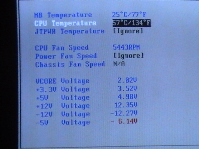

    Hi
    My recapped bestec is working fine since months but i just connected my ASUS P3B-F to it and it says that -5V is bad... see pic.
    Anything to worry about? the other board, MSI KT6-Delta doesnt complain about it....
    Cheers

    many newer power supplies did away with -5.

      More often than not, motherboard voltage sensors are very innacurate. The -5v rail is probably fine, but if you have a multimeter, use that to check it.

        The -5v is for ISA devices. What ATX version is your PSU? It may not have the -5v connector. Quick way to tell is to look at the 20-pin ATX connector on the PSU. If one hole
        in the connector has no metal piece inside it, it doesn't support -5V, and the reading on your P3B-F is meaningless.

          It's newer, got -5V etc, ATX 24pin

            So you are connecting to the P3B-F motherboard with a 24-pin to 20-pin adapter?

              Not really. I just leave the 4 pins hanging off the side.
