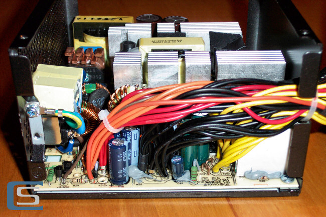

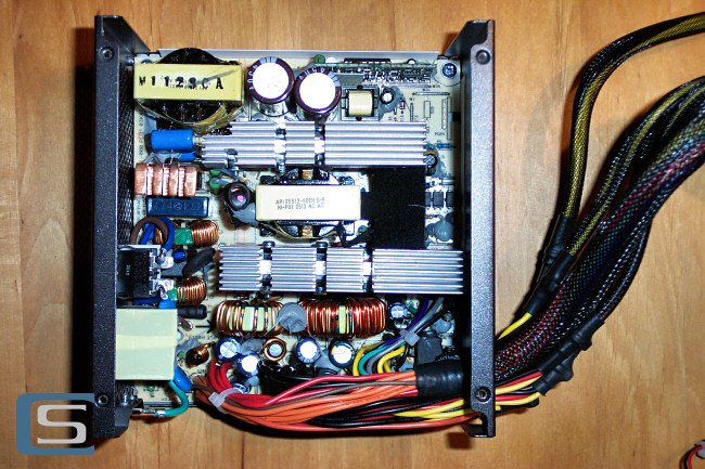

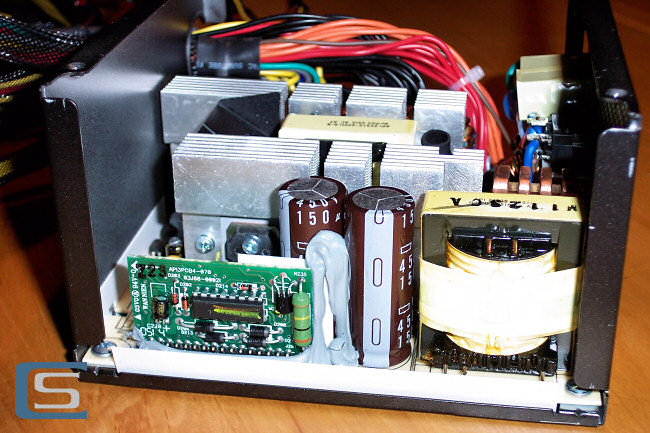

          some different layouts than usual
          Chieftec CFT-500 500w
          http://www.chieftec.com/products/psu/atx_psu.htm
          images taken from German site Cooling Station - review below
          http://translate.google.com/translat...&hl=en&ie=UTF8

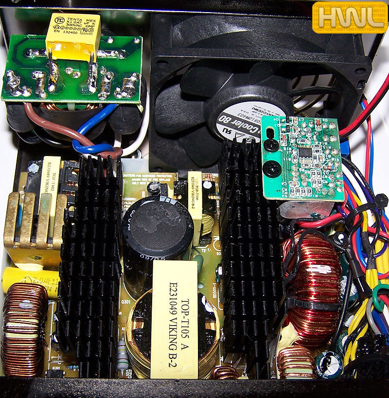

          and Dark Power 470
          review and images from Hardware Labs again German

            That first one is AcBel Polytech in origin... had to go into the review to find a pic of the label to be sure (traced the UL file number on it), but most of them look kinda like that with the two somewhat small main filter caps.
            The second one is a Topower... easy to spot most of the time thanks to that "TOP" nomenclature on the transformers. Never saw a Topower arranged like that before though with the single large cap in the middle. Looks almost like a Seasonic design.

              many thanks indeed, what is your opinion about the greatly undersized main filter caps on the first unit. it would be expected to have 200v and at least 1000uf i guess for 500w. yet they are using 450v 150uf. they appear to be chemicon ripoffs?
              we have availability of this unit here. costs euro 105. Acbel apparently offer 10 year warranty. via Chieftec here you get 1 year

                Can't say for sure what's up with those little filter caps... they're a mystery to me. The only time I've even seen caps like that have been in AcBel units. AcBel is supposed to be decent quality though - the design must work for them. The ones in my Fortron 530W are huge in comparison... 1200uf@250v (don't remember the brand).

                    Re the 150uF, 450V caps, does that P/S have active PFC? The 450V rating of the caps and the length of the primary-side heatsink suggests that possibility. If so, the two caps (if I saw correctly) would be in series, not parallel. Also the bus voltage will be regulated, typically 325V-350V, instead of unregulated, 250V-270V. The energy stored in a cap is .5(C)(V^2). Thus, the regulation and the higher bus voltage permit what might seem like wimpy capacitors. The two caps in parallel reduces the net ESR, and, since PFC is a high-stress application, those should be 105C parts. If the caps aren't from one of the three 'cons or Panasonic, I'd keep an eye on them. As harmonic currents regulations tighten and power levels rise, active PFC will become increasingly common.
                    Edit: I just noticed in the third pic that they are UCC, which is a good sign. I also noticed that the core of that large magnetic component, which is one of two large magnetic components, looks like ferrite. The core material and there being two large magnetic components are almost certain clues indicating active PFC.

                        by the way that chieftec has only a 12" fan and no exhaust fan.
                            I think most AcBel units I've seen like this do have active PFC, and them being in series makes a lot of sense to me.
                            Passive PFC circuits in PC PSU's usually employ just a big inductor IIRC - easy to spot.

                              Like OKW said, passive PFC uses relatively large, heavy, 50Hz/60Hz inductor. The inductor core will be made of steel laminations, hence the weight. The AC I/P current won't be pretty, but complies with harmonic current regs. Passive PFC is relatively inexpensive and easy to implement.
                              Active PFC is a separate, non isolated, inverter in which the O/P voltage is regulated and the shape of the I/P current is controlled so that it is fairly sinusoidal. I've seen some PFC designs where the I/P current is a near-perfect sine wave. It's higher cost, more complex, and the greater precision often isn't necessary. I think that, longterm, the trend is toward active PFC, but the regulators and the OEMs will be brawling over it for quite a while.
