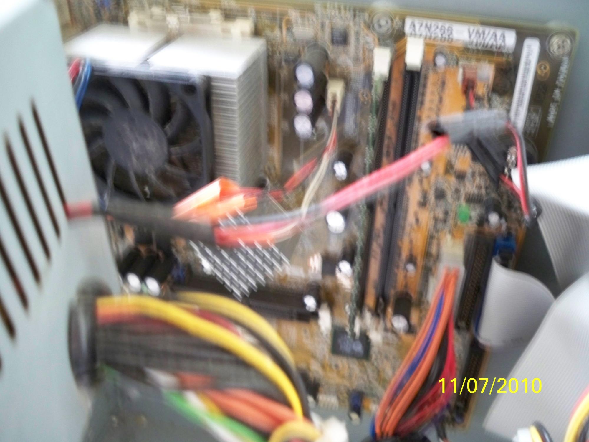

"Ahead" brand PSU (actually feels decent)
    I have one in an earlier Athlon system and it seems to be doing fine.
    Except I had this strange problem, seemingly all of a sudden, the PSU fan wasn't spinning fast enough, if at all and the PC was shut down on its own when just running a utility to wipe the HDD.
    I was near the PC and found out it shut down on its own! Then I couldn't keep a finger on the PSU heatsink!
    The internal PSU fan connector is bad! I'm now required to connect the PSU fan to a motherboard fan connector or a Molex.
    I still have yet to encounter a shut down after connecting the fan to the motherboard fan connector.

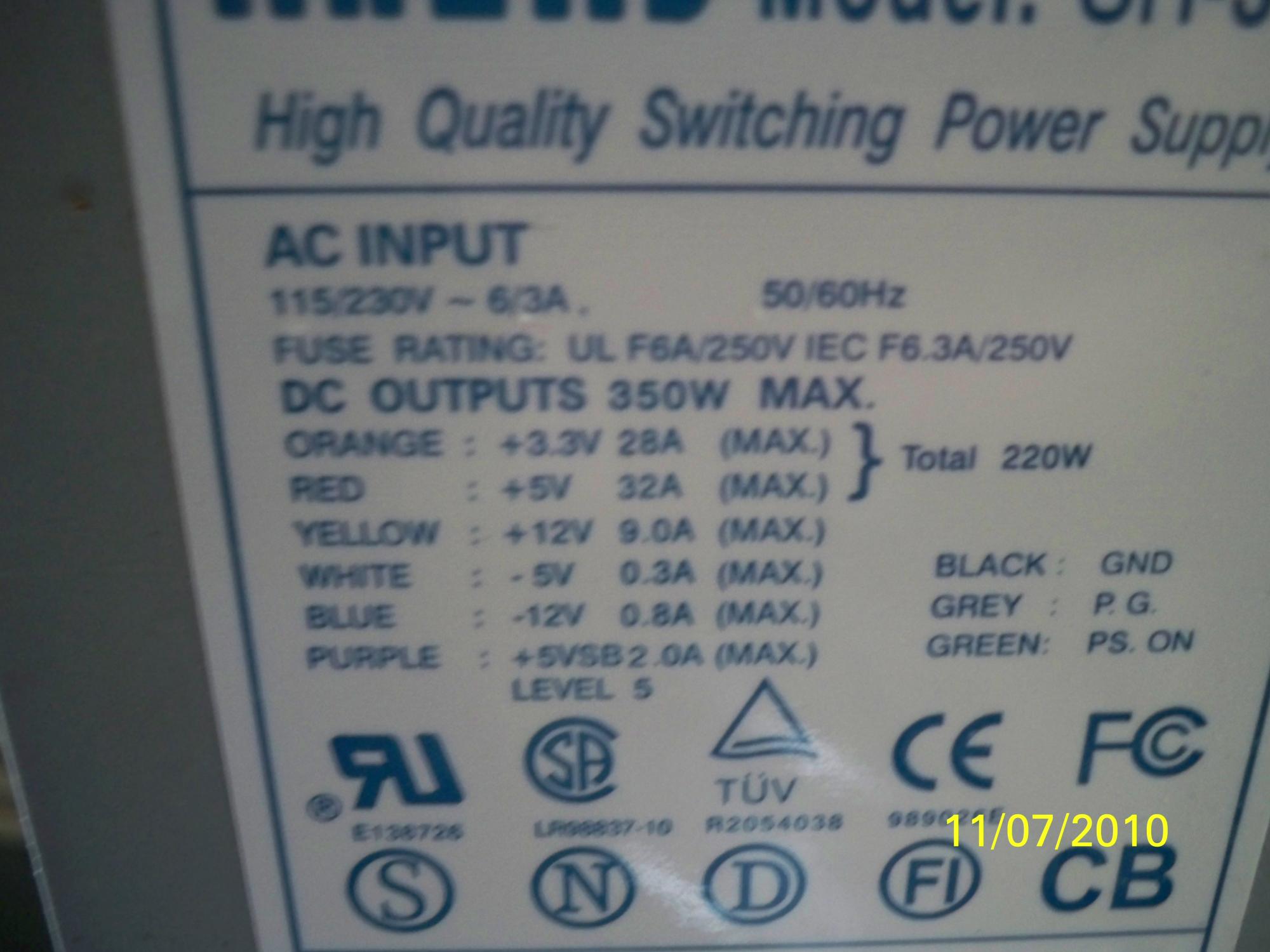

          I doubt it. The brand "Ahead" just sounds very generic - probably a gutless wonder PSU. (or am I completely wrong here?)
          Posts some pics of the insides of the PSU, if possible.

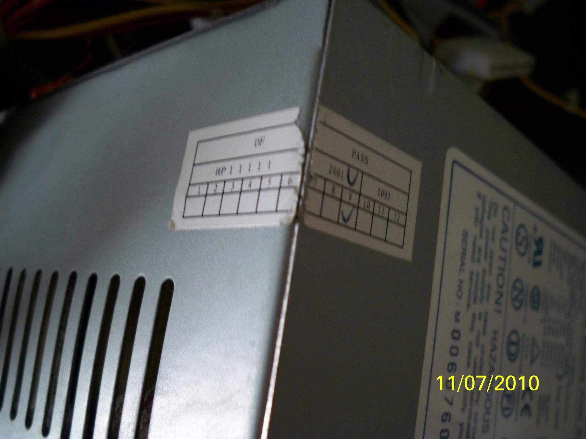

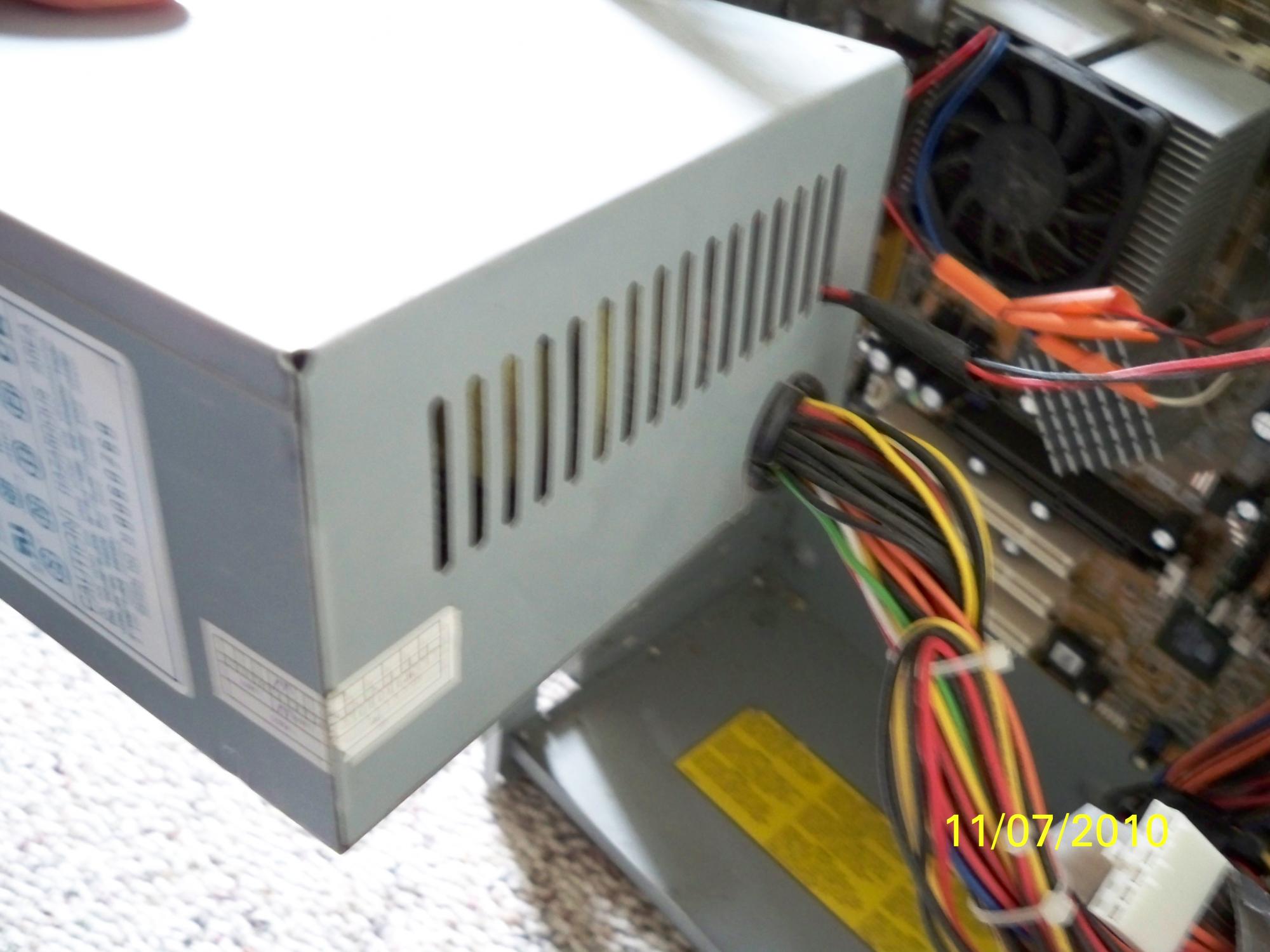

            Re: "Ahead" brand PSU (actually feels decent)
            The PSU:
              "shine honor technology co ltd"
              Hmm. Never heard of them. Would need to see the insides to tell about the quality.

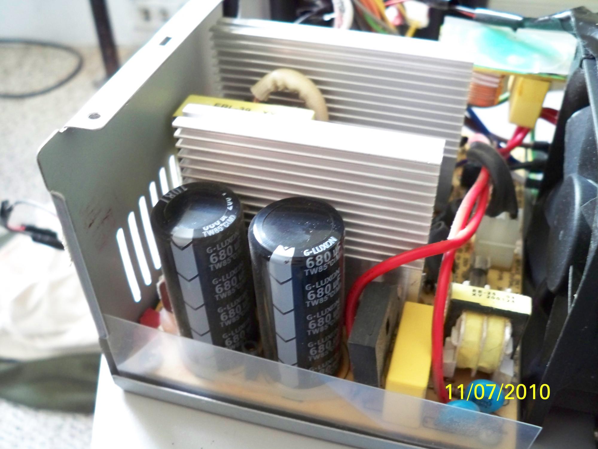

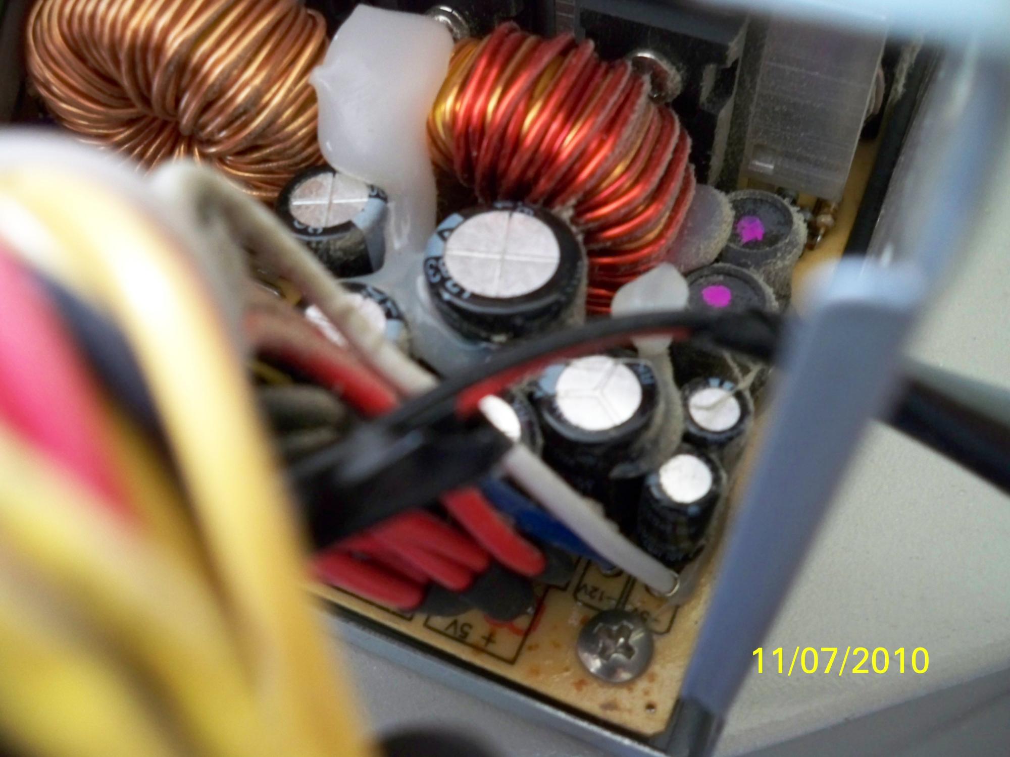

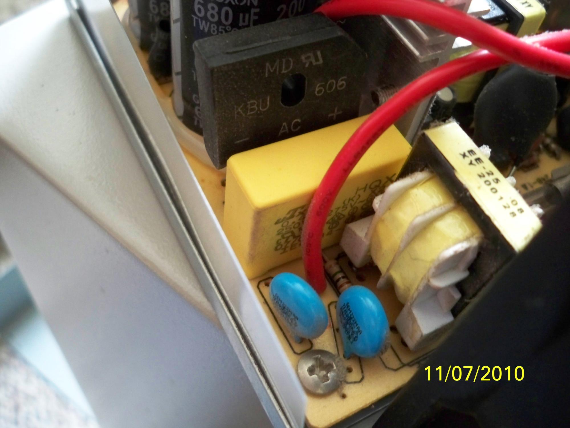

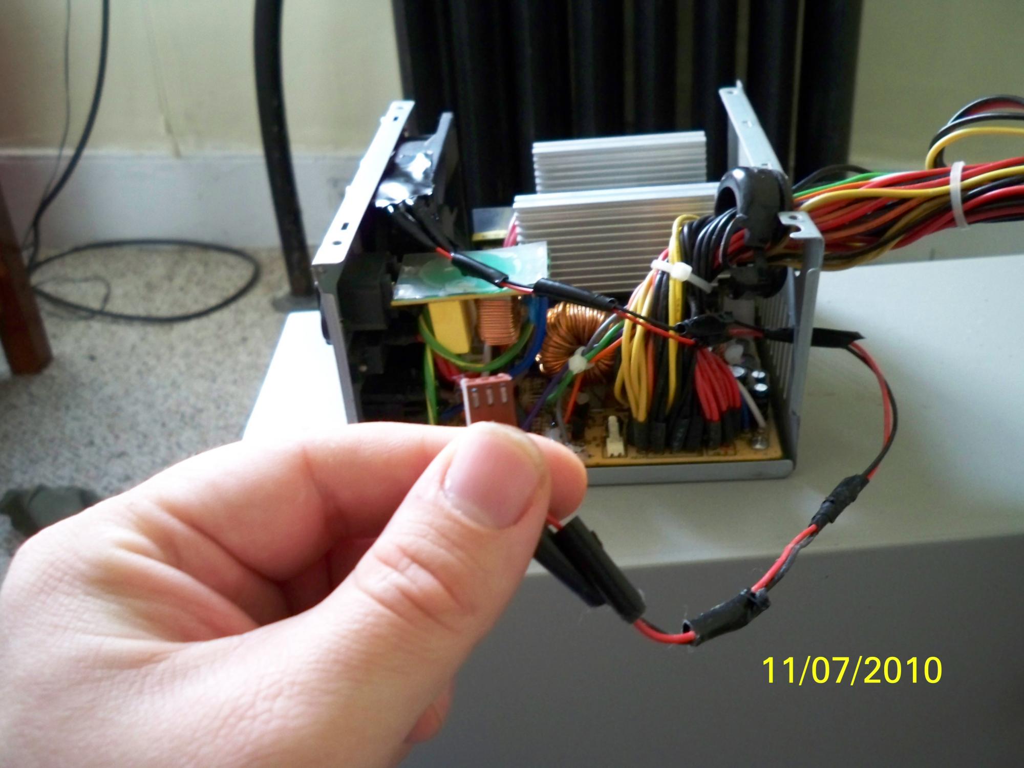

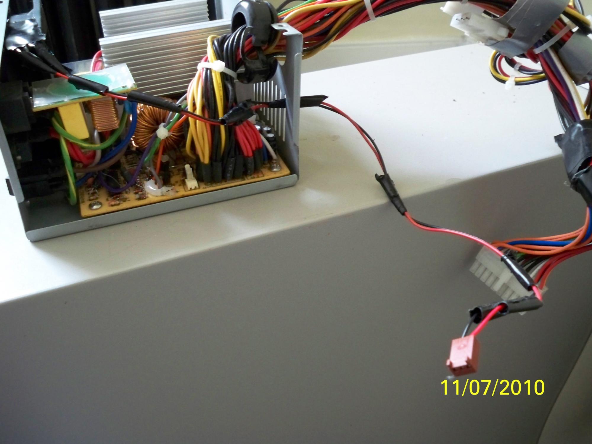

                  The inside:

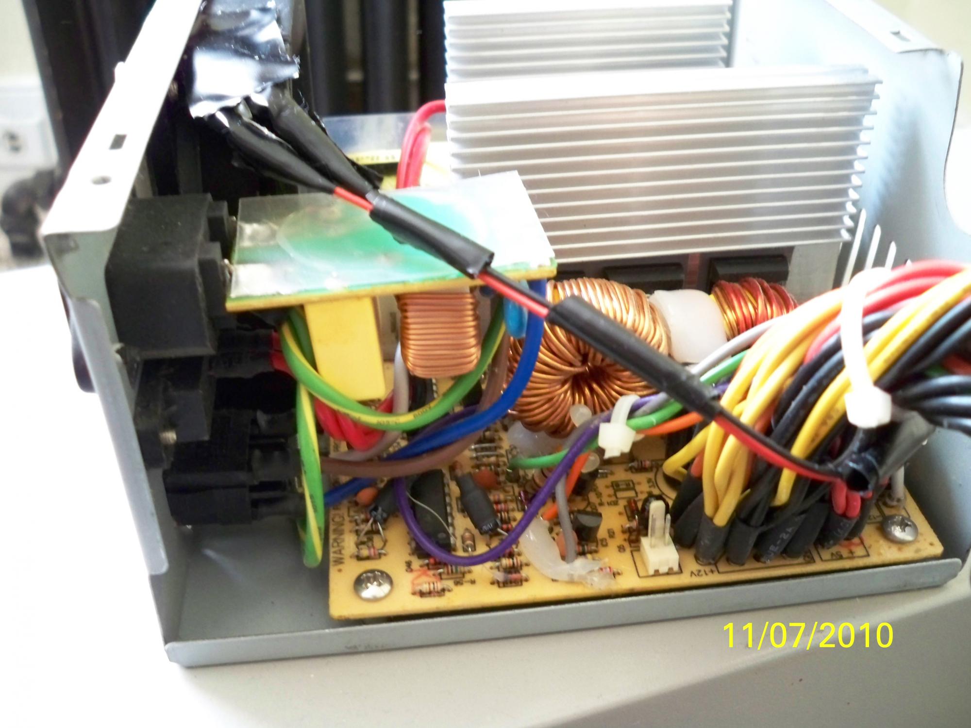

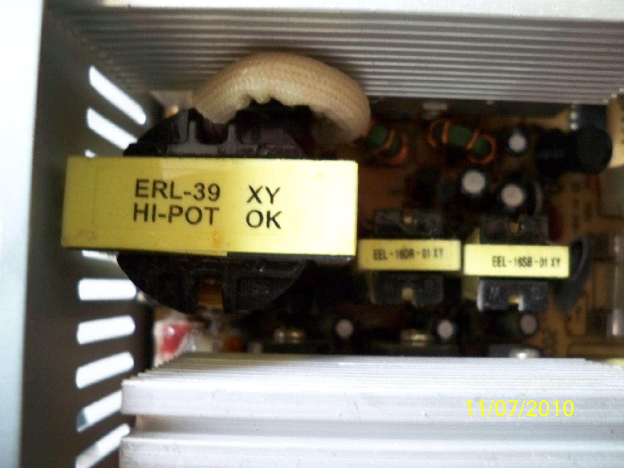

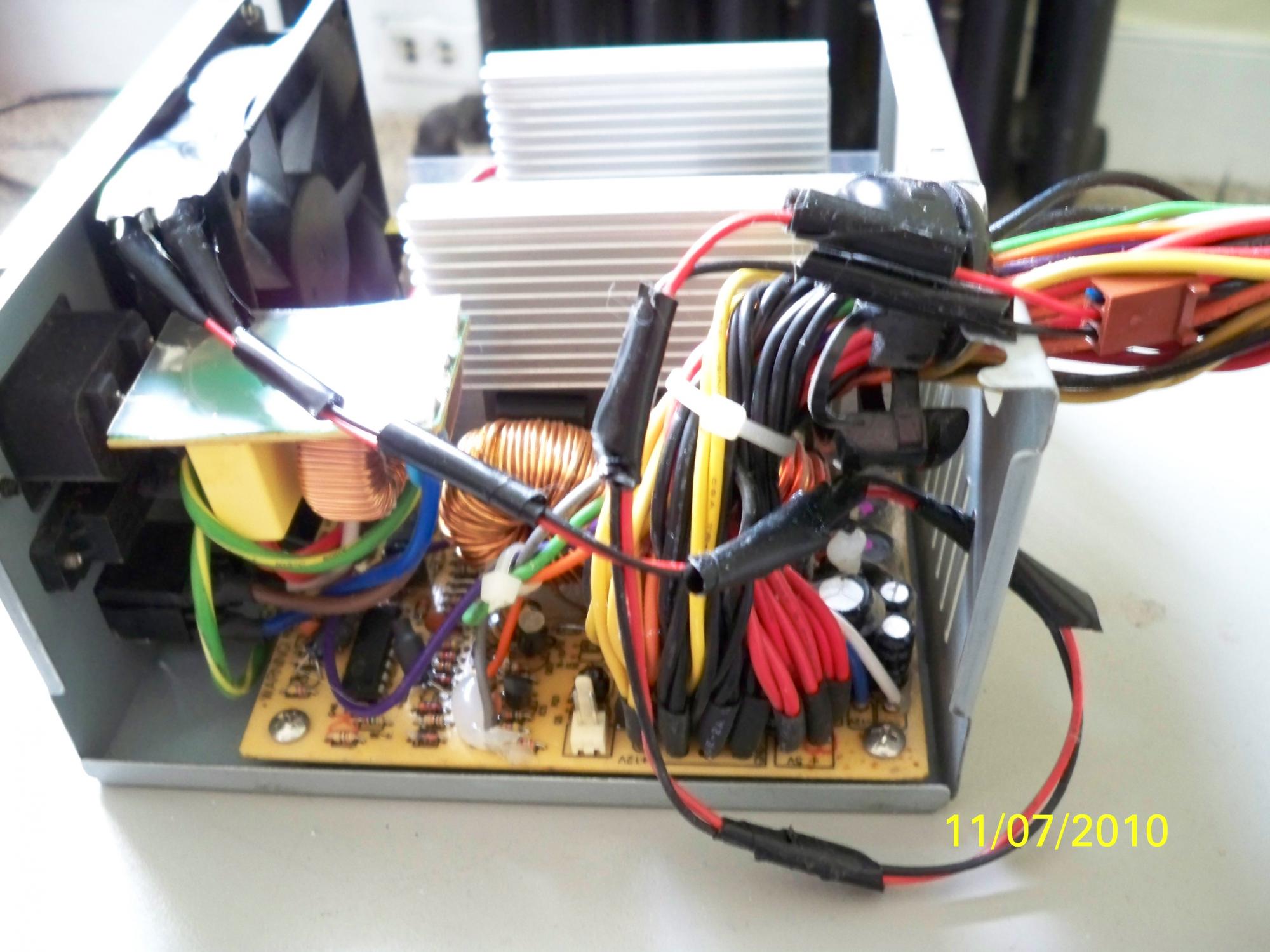

                    2:

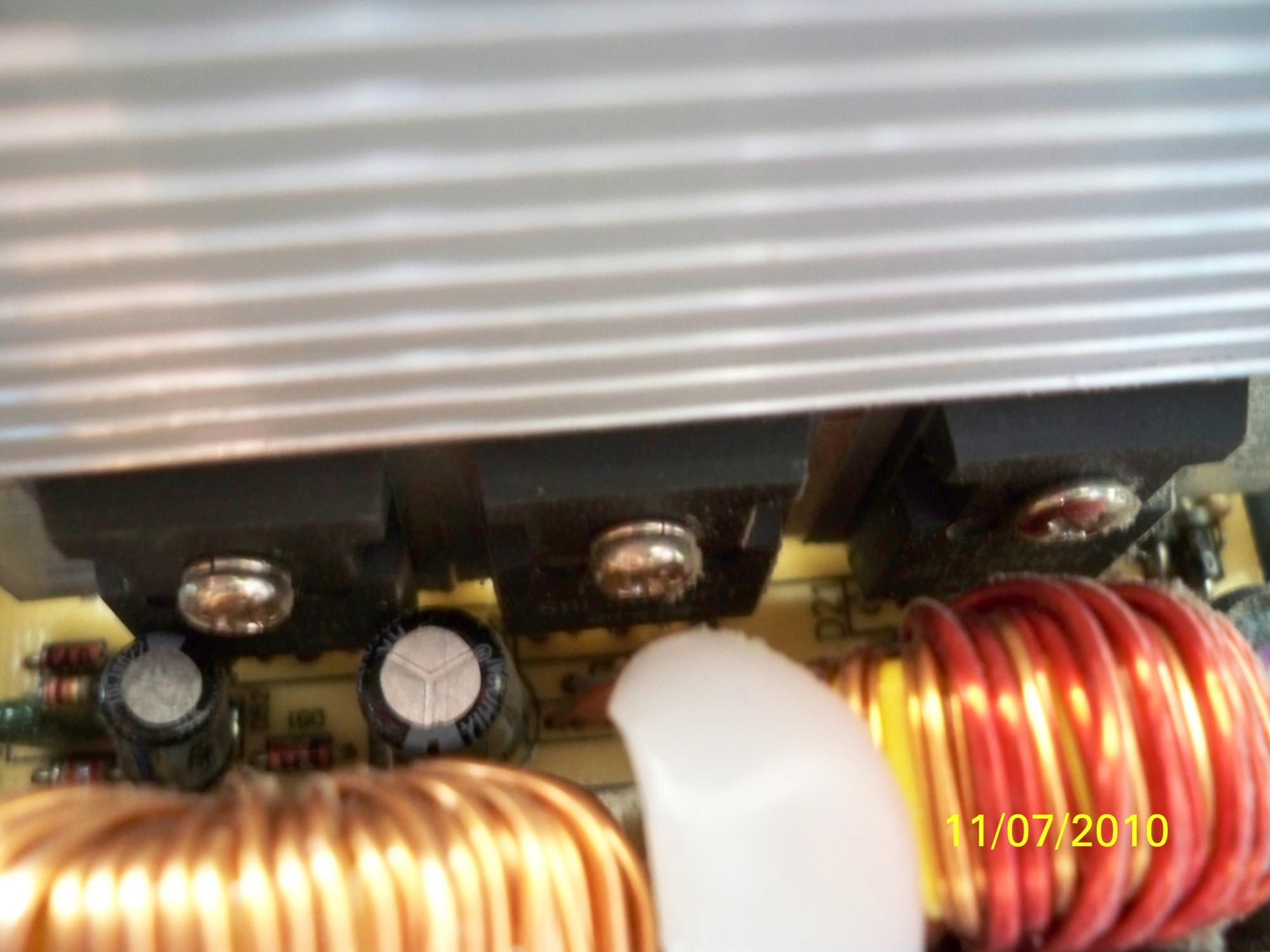

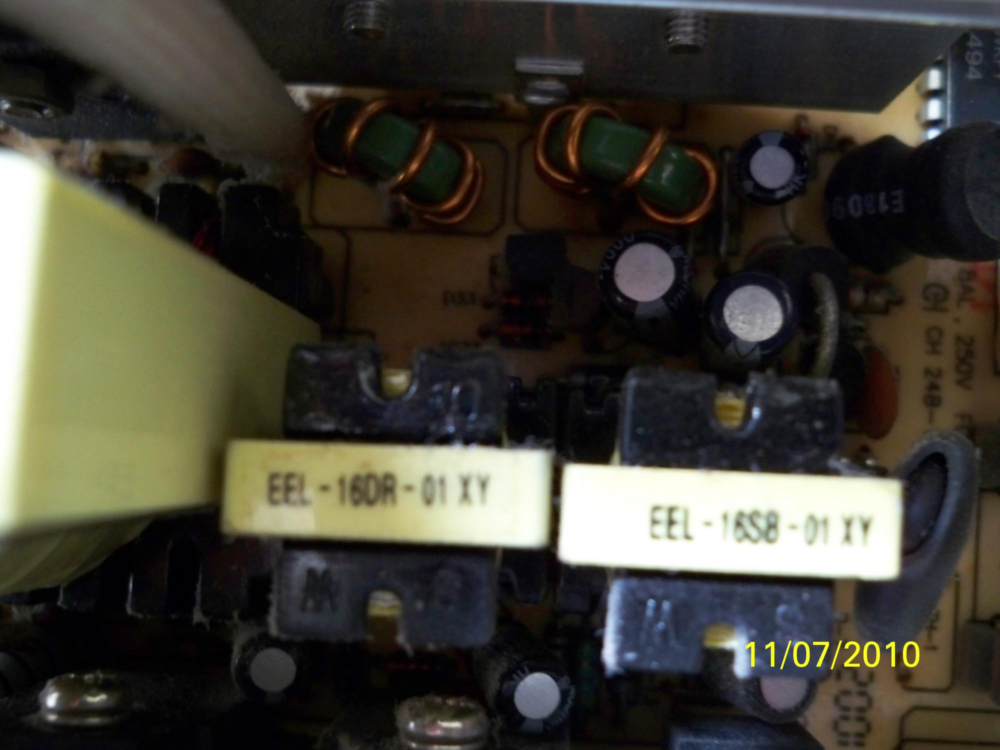

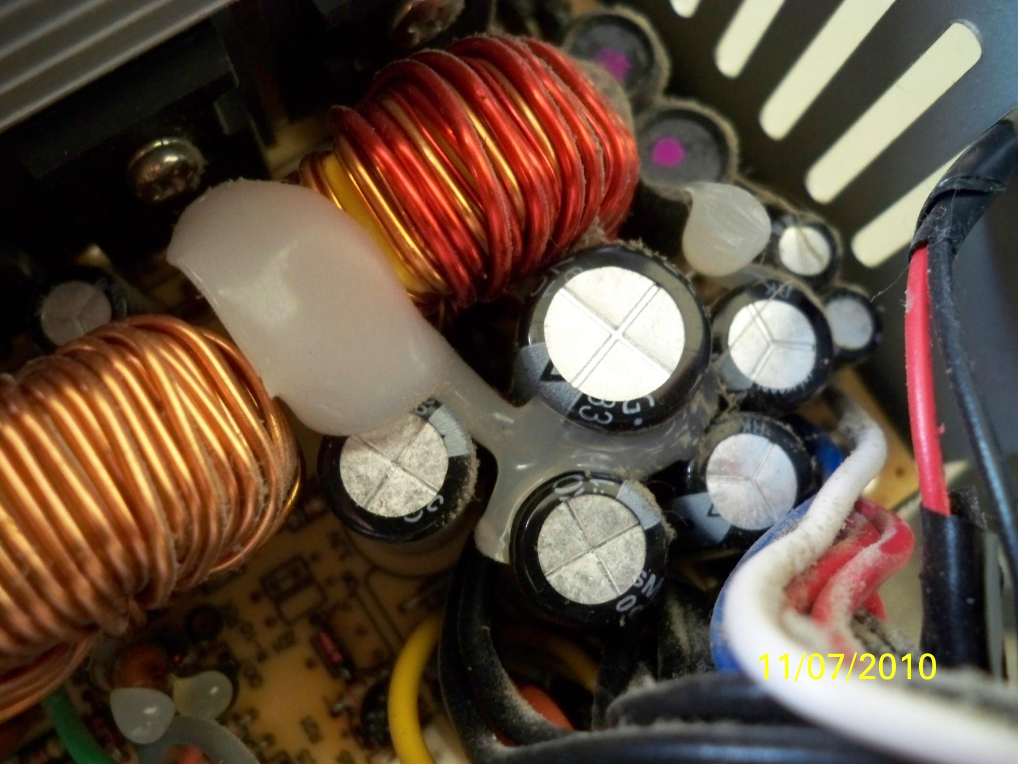

                      3:

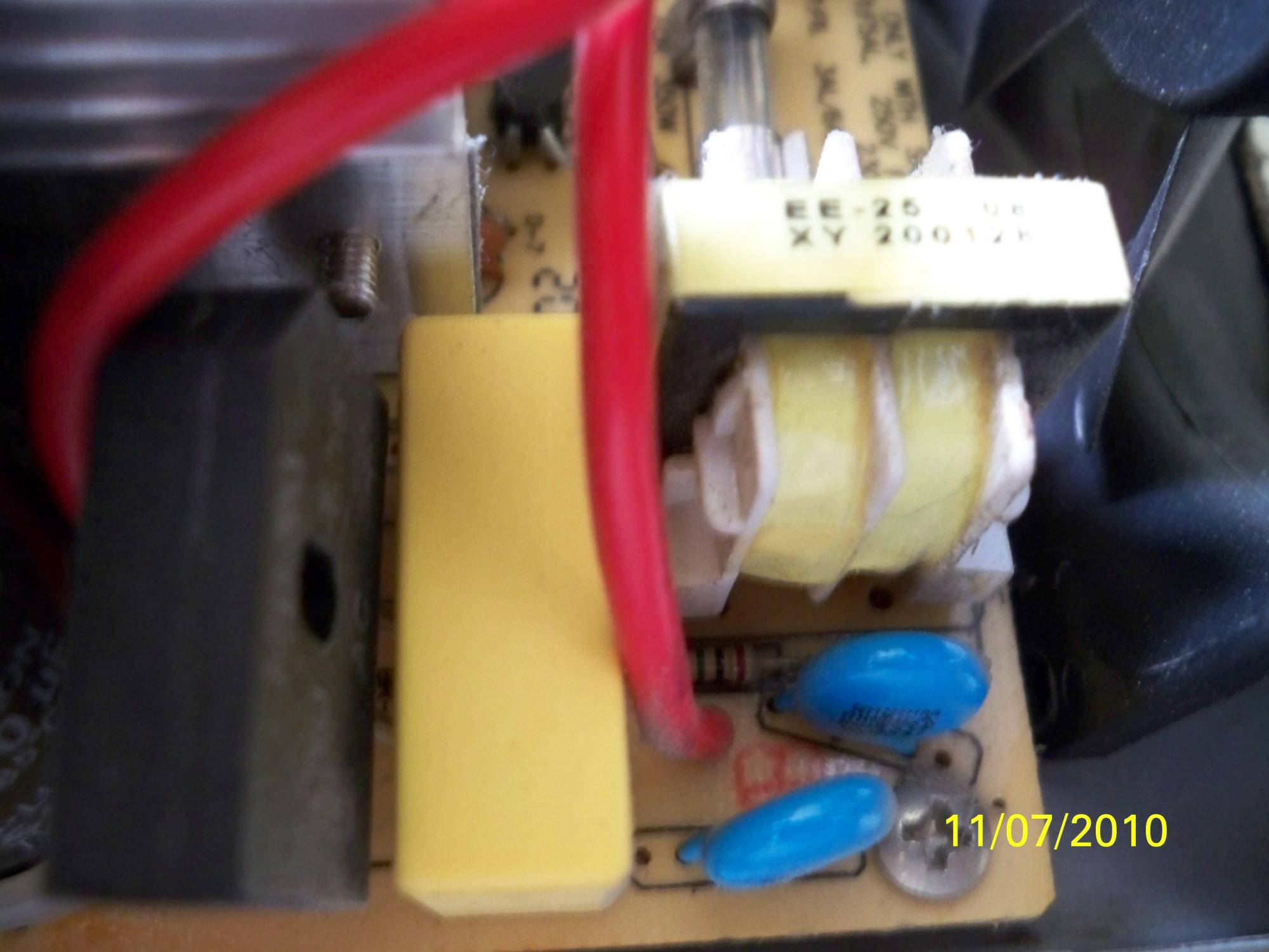

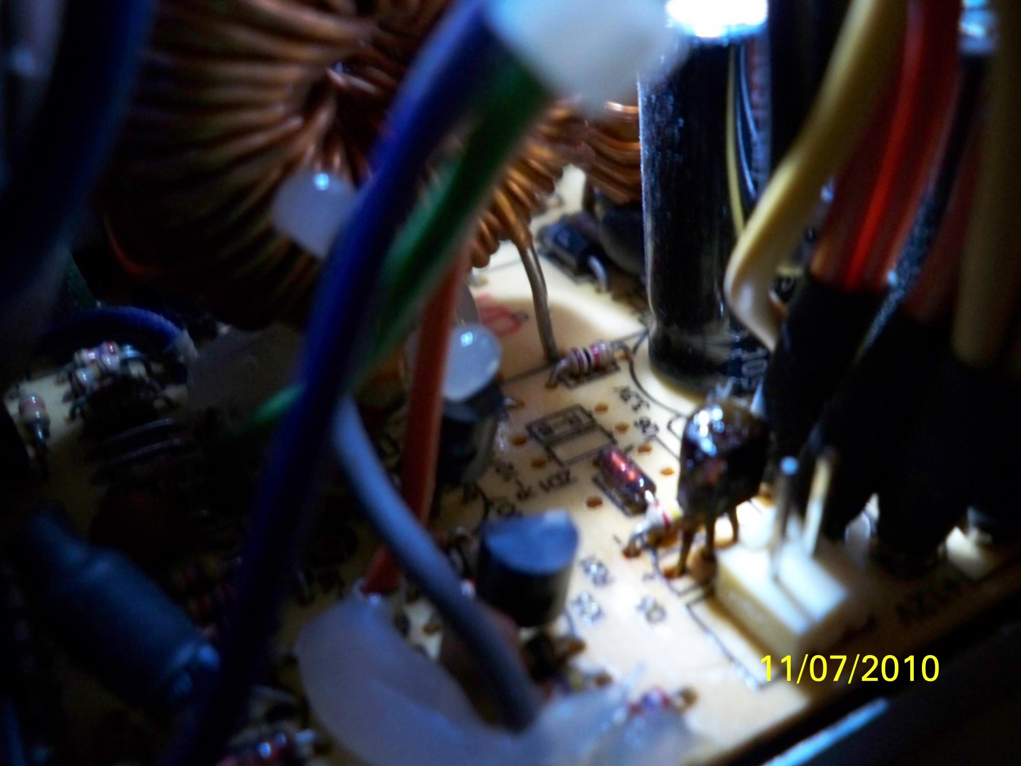

                        The last one:

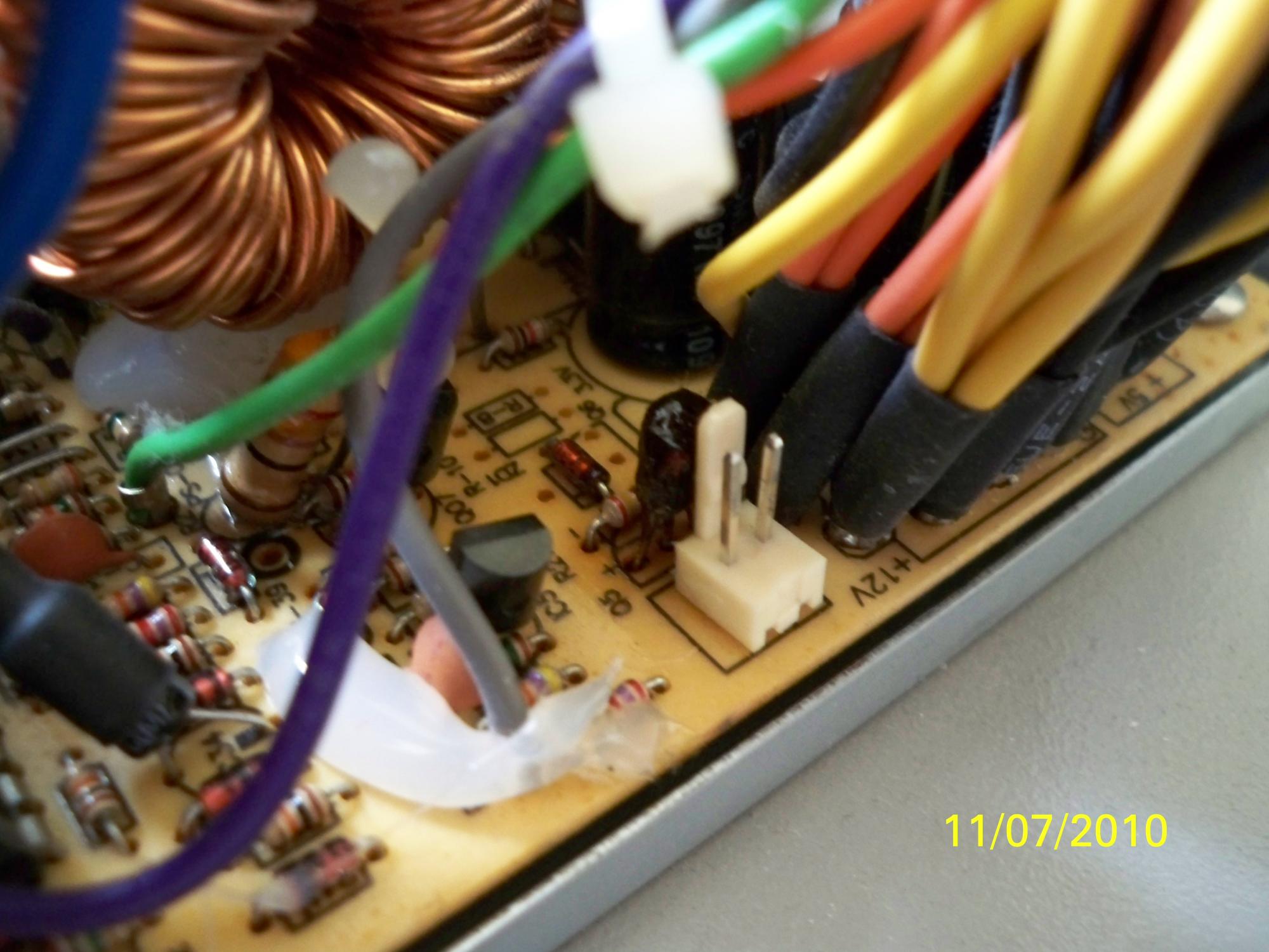

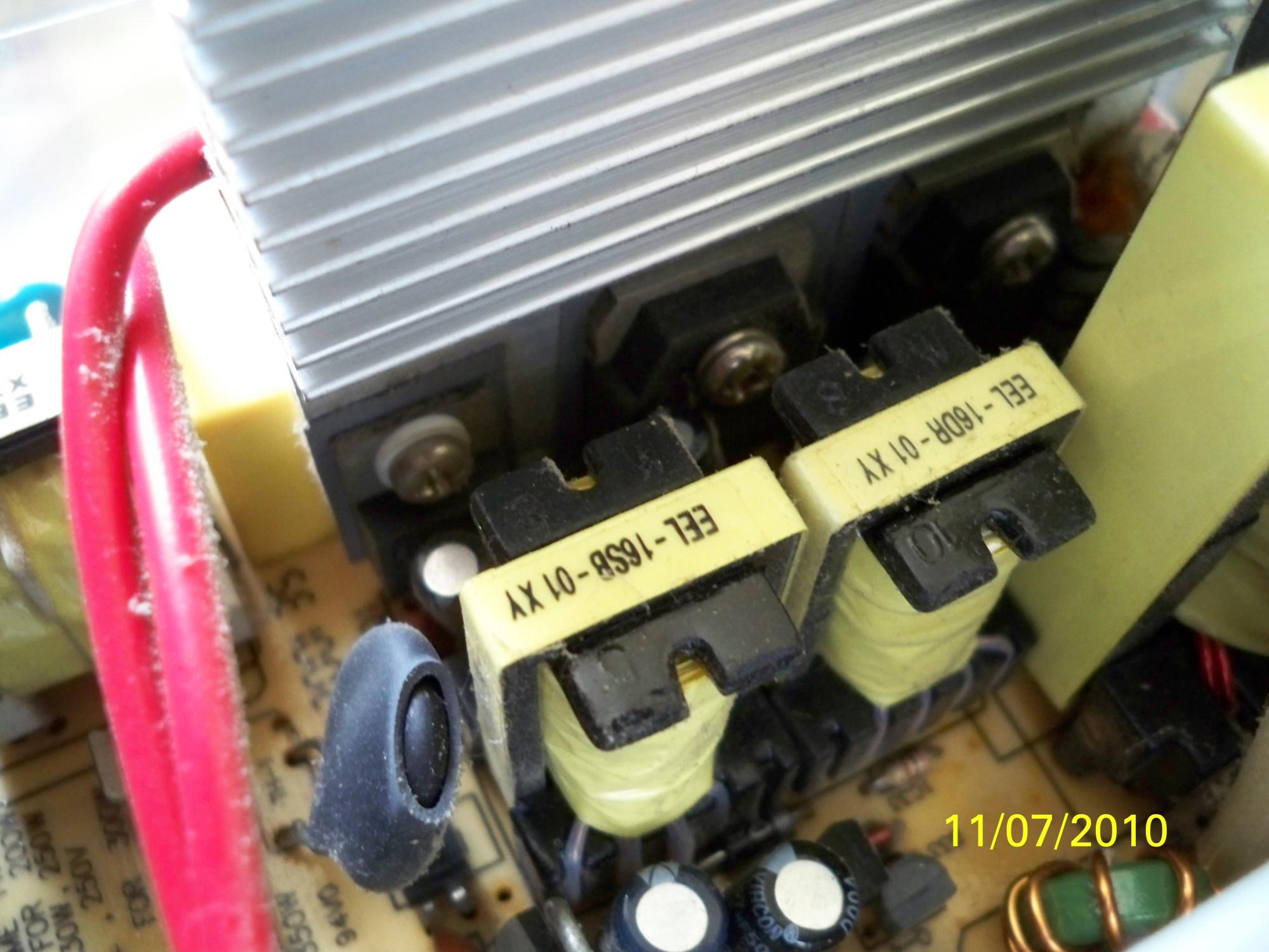

                          On 13.JPG, is that a diode? It looks fried!
                            Looks decent, like a solid 300W unit. I don't think it has OTP, unless the thermistors are hidden under the heatsinks like some companies do.

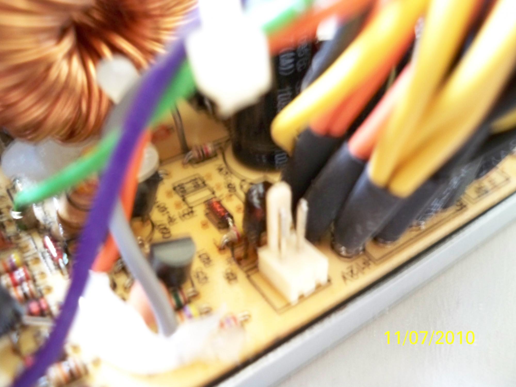

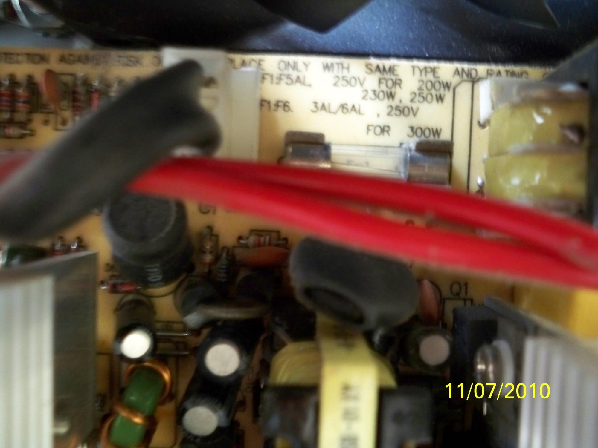

                              The part right behind the internal fan connector appears to be fried!
                              It also smells fried!
                                Looks like a transistor it uses to regulate the fan speed.
                                  Why would that be fried?
                                    A better shot:
                                      Transistor looks ok, covered in well-done baked hot glue.
                                      Recap and use quality fans brands I posted. Run off the 5V internally by cutting the trace and jumper to the 5V. This hodge job I do not like sticking wires out through this PSU for *Safety* reasons.

                                        Smells fried right there! It smells the strongest in that spot!
                                        The fan spins too slowly now with it being plugged in that connector now! (I got shutdown and blazing PSU heatsink)
