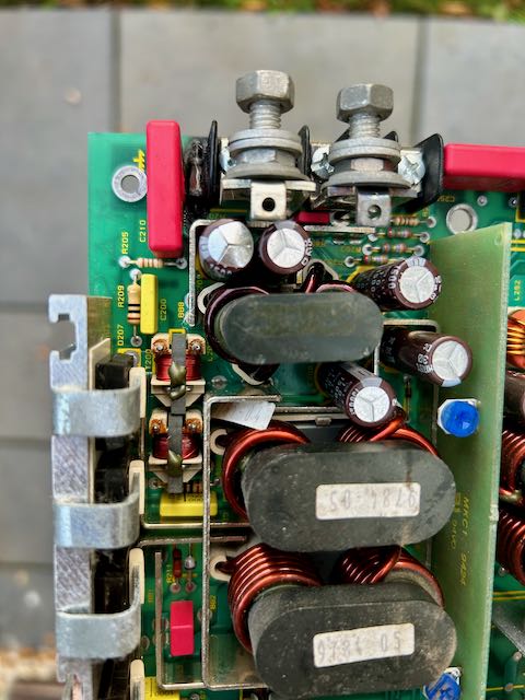

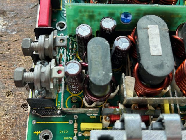

    Im about to repair a failed Wier WA505 power supply which hasn't been used for many years. It was working for 30 mins or so, then started to smell bad so switched it off quick.
    On closer inspection a 1500uF cap across the 5v output has swollen. Adjacent to this is an overheated (open circuit) resistor.
    Ive removed the electrolytic cap and resistor - the cap replacement is straightforward and will replace the adjacent ones at the same time. The resistor looks like it sits across the output. Any ideas what value this is likely to be? Was thinking 100R 1/2watt would be suitable.
    I have removed the red 0.1uF too, as it looks to have suffered from the nearby heat.
    Any advice very welcome. Thanks!

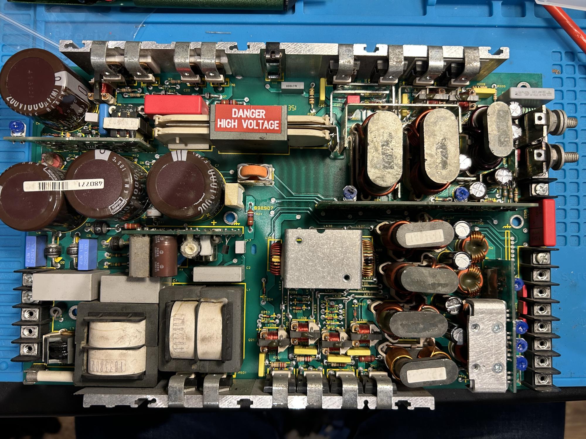

                      Still looking for some help if I can. Load resistor, and several output smoothing capacitors replaced.
                      I can now get all of the low current voltages present 24v, -5, 15v etc. However once loaded with say the cooling fans on the 24v, there isn't enough power to drive the fans. Also, the high current 5v is only reaching 3v.
                      No obvious faulty components elsewhere on the board. Any obvious things I need to go after first?
                      Thank you!

                        Re: Wier WA505 SMPSU output failed
                        Hmm… maybe upload some straight shot high resolution pictures from the whole PSU. For shits and giggles, check with a kill a watt or similar how much power the PSU is drawing.

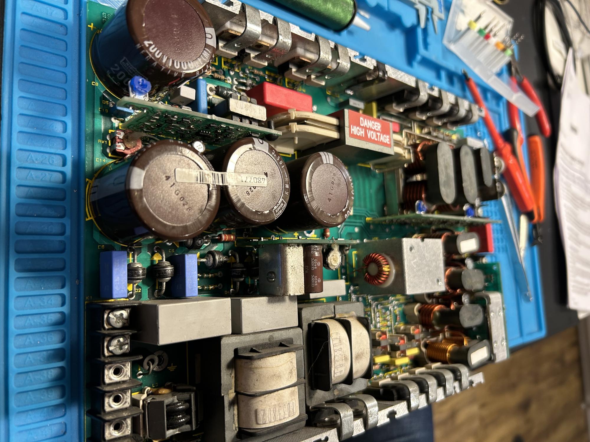

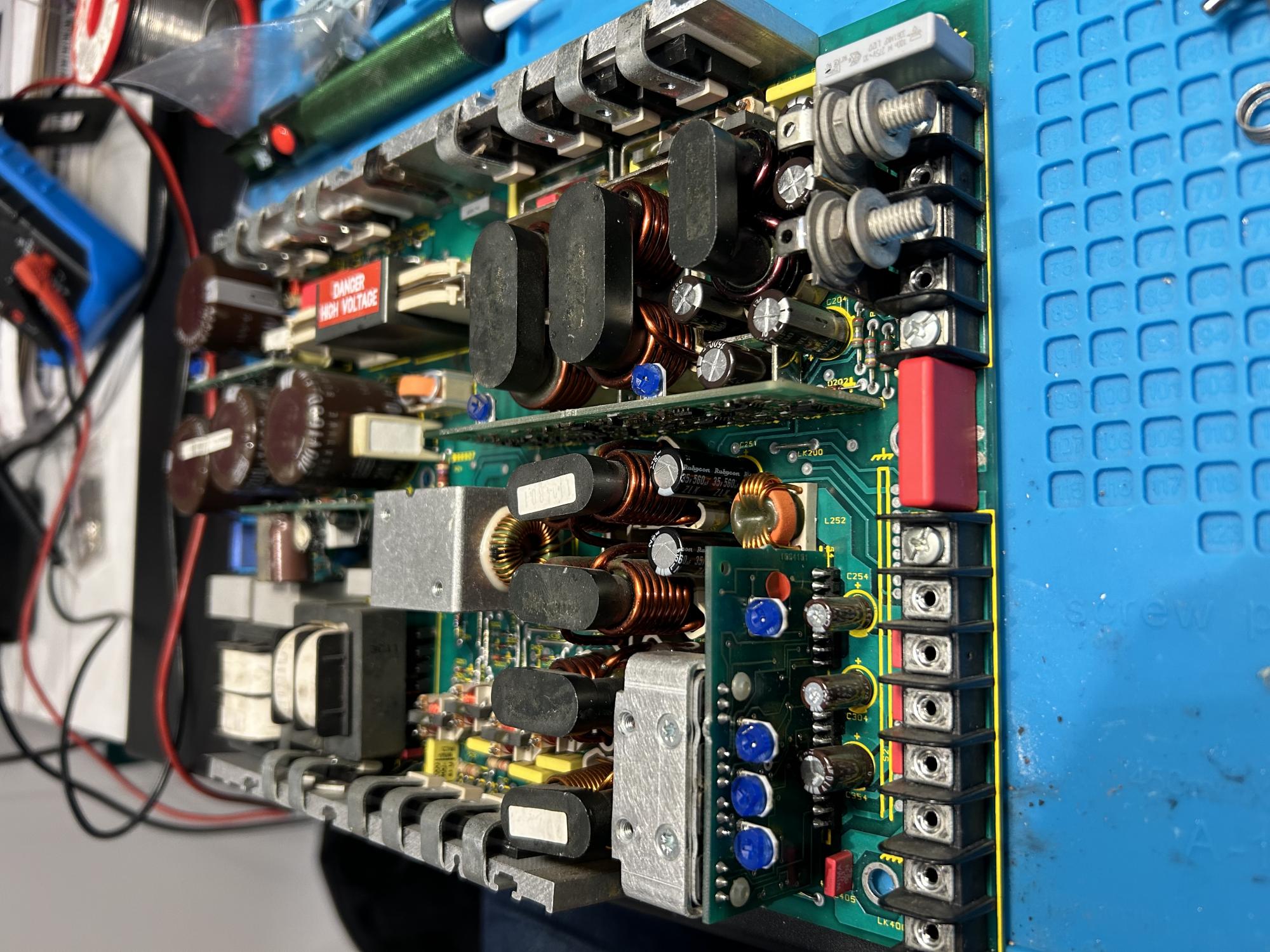

                          Pics enclosed. Thank you.
                            • 31161
                            check the input smoothing caps maybe
                            after checking them for voltage - incase it has no discharge resistors!!!!!!!
                              • 31161
                              what caps did you fit?
                              • CapLeaker
                                Leaking Member
                                • Dec 2014
                                • 8296
                                As stj already mentioned, if the main filter caps in the primary are bad, you won’t be getting anything much out of the secondary either.
