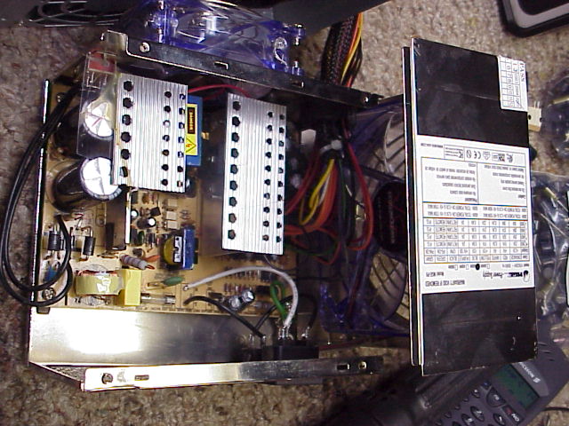

                                any questions?

                                  A POWMAX!!!
                                    Re: and a list of known junk power supplies
                                    i will get more detailed pic later.a kid at the store has one and likes it so it is going to come in for a recap.told him its a waste of good caps.but its purty!
                                    ever noticed parts marketed to the pc ricer crowd are pretty outside but junk inside?
