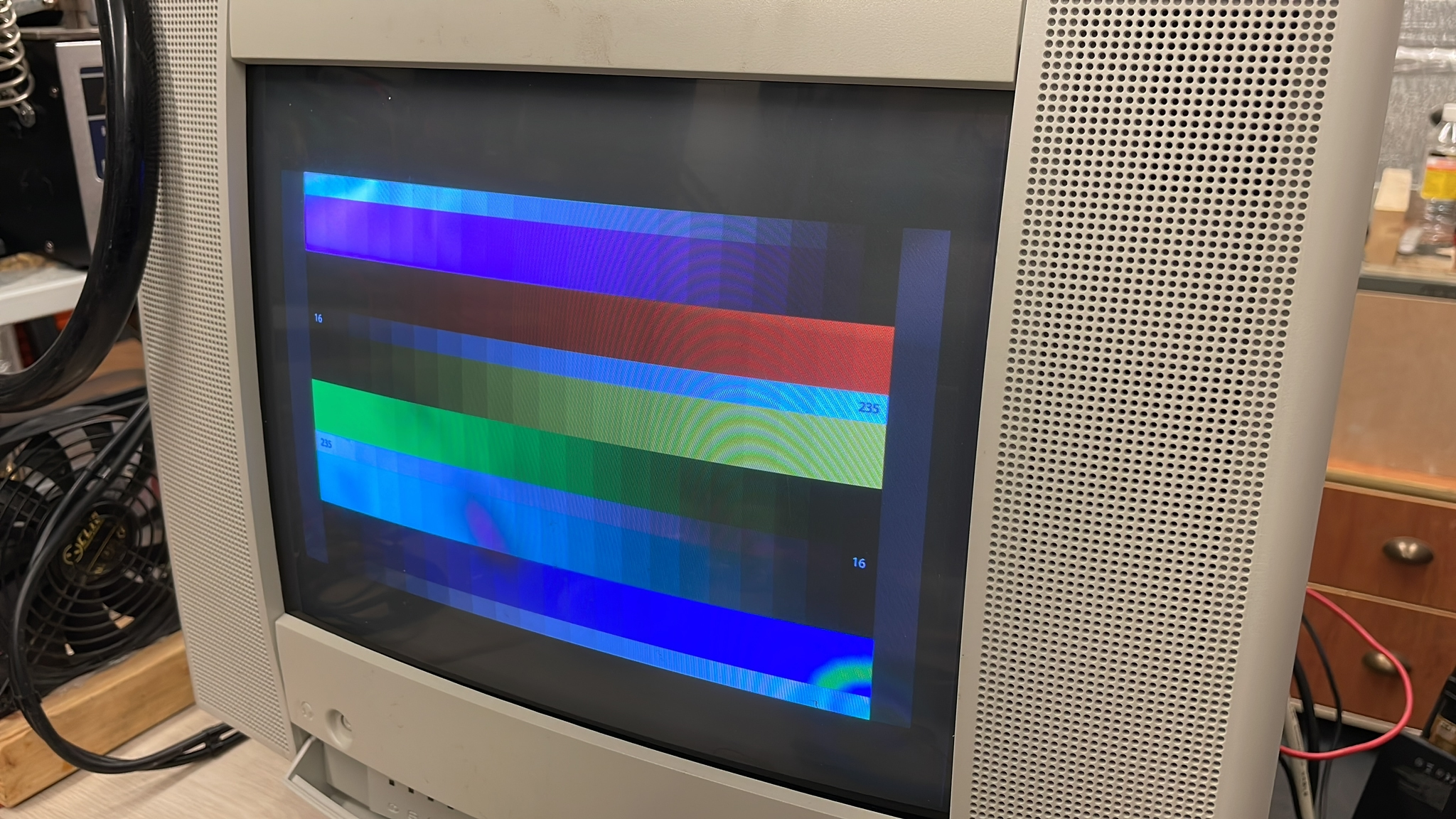

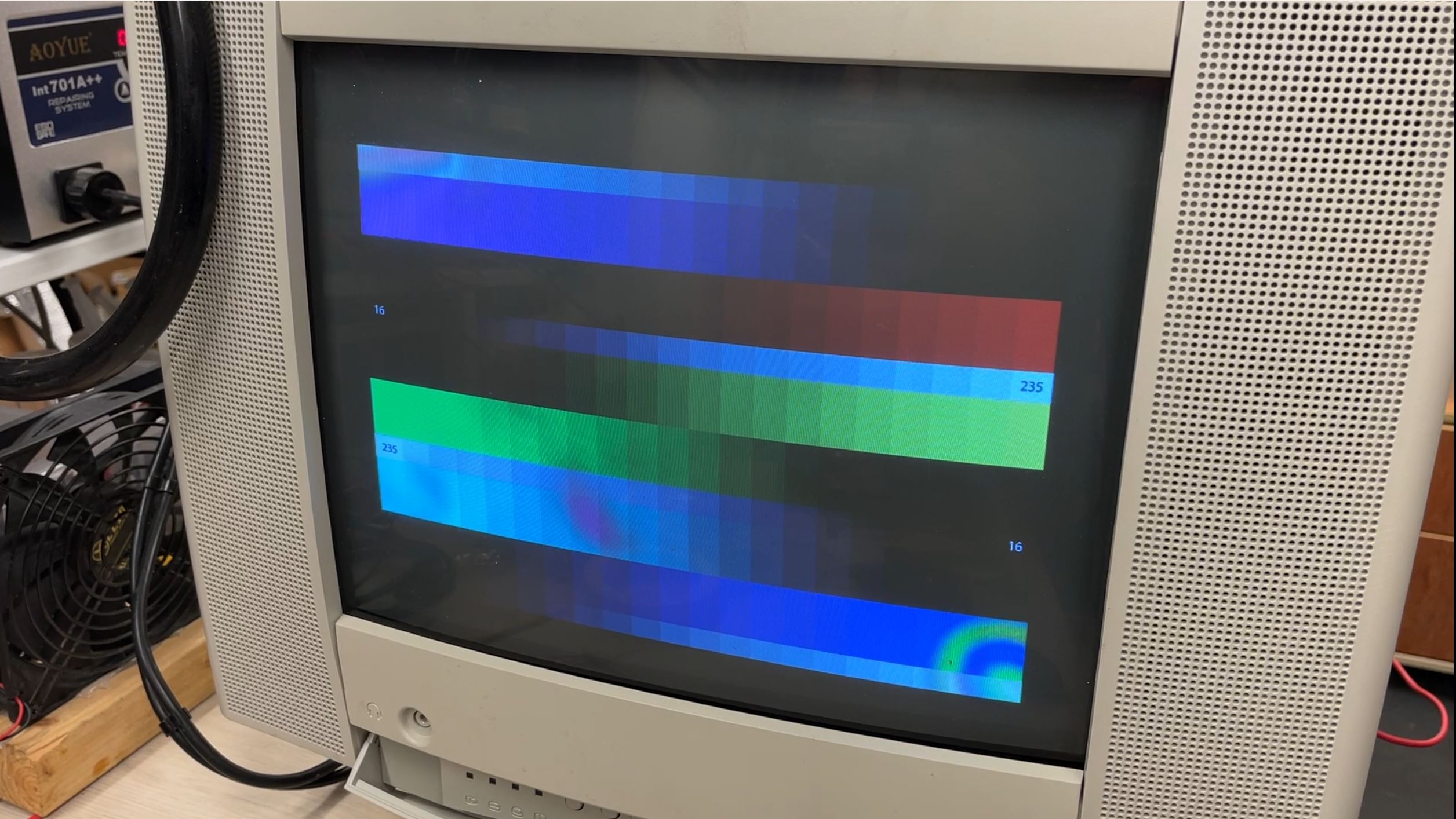

    The picture is all messed up but I believe this is normal when you swap a neckboard between tubes - all the adjustments are in there. Colours are off, brightness is too high and I can't turn up contrast without causing major smearing on the picture.

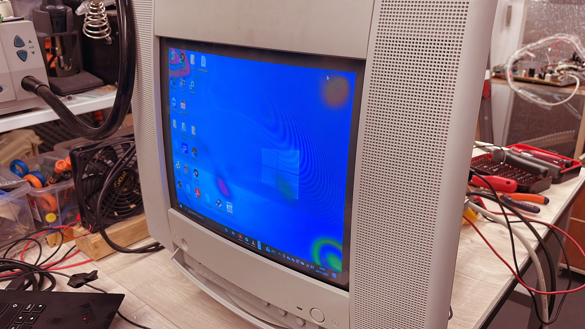

    - Those blotches are still there. I am not sure the de-gaussing circuit works? I remember hearing this loud "boing" (sorry!) when turning on a TV and you'd see the picture wobbling for a few seconds while the coil was discharged. I don't hear/see anything here

      The built in degaussing circuit will not fix that issue, you can try an external degaussing coil, or it is possible the tubes shadow mask has been damaged, this can happen if the monitor was ever dropped. It is also possible there were some strong magnets stored against the crt The fact they are in circles is odd.

          not something i would recommend but years ago i used a magnet to clear a crt . started at one corner then moved to other side then down a little and back across and carried on to the last corner and beyond .
            Yes, your picture looks very blue-ish. It looks as if the red and green guns are barely firing.
            I see two potentiometers on the picture of the neck board you provided earlier: "R-Cut-Off" and "G-Cut-Off". These are your red and green gun cut-off adjustments. Might have to play around with them... but before you do, take a sharpie / permanent marker and mark their original position (this is always a good idea when adjusting potentiometers in general.) Then adjust and see if that changes anything on the picture. With higher red and green colors, the brightness should also come up, since those colors will now be firing on the screen as well and helping with the overall light output. If these don't seem to change anything on the picture, check that these potentiometers have not gone open-circuit from old age (and especially from moisture.)
            As for the "Sub-B" pot... not sure what that does. Perhaps something with the Blue gun/gain adjustment?
            All of that said, before you do anything, it might be even a better idea to consult with the service manual for any of these pots / adjustments.
            Can you invoke the degauss function from the monitor's menu / OSD? If so, try that first and see if they disappear (even if only momentarily while the degauss is working.)
            If there is no menu option to degauss the monitor and you don't hear the monitor try to degauss when starting it from cold (let it sit turned Off and disconnected for 20-30 minutes if doing that), then check the series PTC and degauss relay. If needed, you can always externally force the relay contacts on. The relay is probably RL901, and associated PTC likely TH901.
            If the monitor's degauss doesn't fix or improve the blotches, you might have to degauss with an external coil, like R_J suggested. I've also seen people (on Youtube) do it by using very strong Neodymium magnets attached to a shaft and spun on a drill. Not sure how effective or good that would be... and obviously I find such "hacks" to be a little risky if any of the magnets fly off and get too close to the CRT... but it is an option, I suppose.
            And if neither an external degauss nor rotating magnets "hacks" can touch the blotches, then indeed the monitor's shadow mask might have suffered fall damage or something. Though the way those circular patterns appear really does seem like something highly-magnetic and very sharp came in contact either with the tube or some of the metal work on the back of the tube.

              I tried with a small magnet I had. I think I saw some changes on the blotches but not on that circular spot. Uhm... Let me focus on the adjustments first.

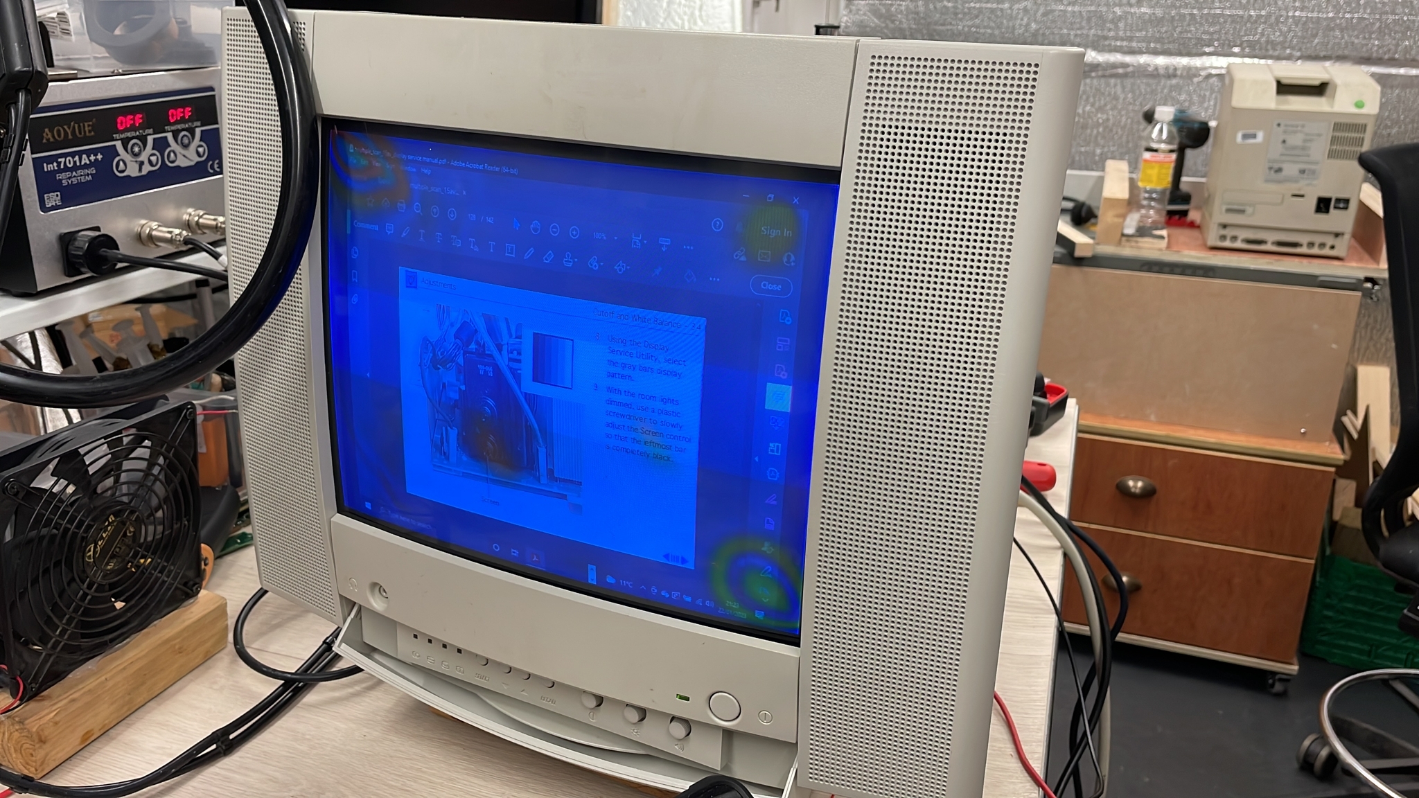

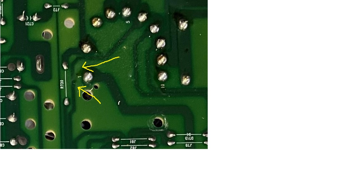

                Go back and find out why your 70 volts is low, It looks like it comes from the power supply, and if it is only half, nothing is going to work correctly, Check you don't have a bad diode or partly open resistor in the power supply for this 70v line
                Usually a purity problem would not show such defined circles, it would be more of a blotch covering part of the screen
                It may only be the picture but is this trace from fbt pin 6 ok?
                Also check that D954 (70v source diode) is ok, and that the ground connection on that transformer is ok,

                    Weird update.
                    I unintentionally shorted the 70V line again (I soldered a pin to the VCC of the CRT IC to check voltage at the IC, then I put the metal cover back without removing it...).
                    Same transistor and same resistor went up in smoke. I replaced them.
                    I went to power up again, monitoring the 70V while doing it.
                    Now it reads 67V! And the picture is definitely much better, clearly it just needs white balance and cutoff and it will be ok - besides the blotches.

                    The trace you pointed out is fine. There's a little flux residue from factory which made that weird effect on camera! Well spotted though!

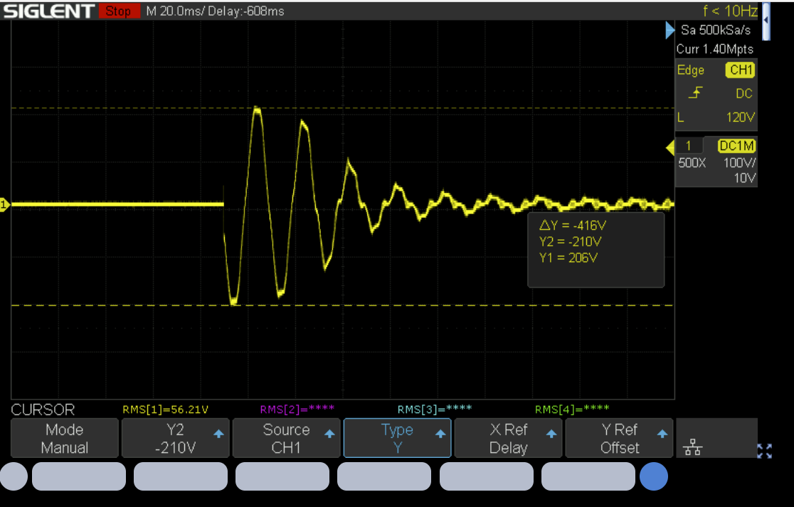

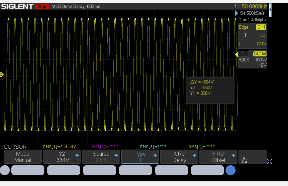

                        Back OT, how do I check that the degaussing coil is working? I guess I should read a short on the coil, what about the connector? Can I disconnect the coil and expect to read a voltage when I power up? What kind of voltage should I expect?
                        The thing is that I hear the relay clicking but I don't hear the usual "WOANG" (I'm making this up!) noise when I power up.

                          The degaussing circuit consists of the coil itself, TH901 (PTC) thermistor and in this case there is a relay across the a/c line. Once the thermistor is warm from running a degaussing cycle it won't operate again until it has cooled.
                          It is there to clear up MINOR purity problems only.
                          That ring is likely there permanently, it does not take that much of a magnetic field to change the purity, even the earths magnetic field effects it. If you screwdriver tip is magnetized, move it along the screen and you will see that doesn't take much. I fear that spot is permanent

                                        This is what I get out of the degaussing circuit - with the degaussing coil attached.
                                        416V p/p are 147V RMS. Do you think this is what I should expect from a degaussing circuit?
                                        This is with the monitor cold, previous attempt was an hour earlier.
                                        With a 15W light bulb I get full power (see pic) so two scenarios here:
                                        1. Everything is working totally fine
                                        2. The Thermistor is reducing the power too early.

                                          Oh sorry, I thought I answered this before, but I guess not.
                                          147V RMS seems a bit low. IMO, the thermistor is reducing the power earlier than it should.
                                          Do you have another CRT monitor? It doesn't have to be an Apple - any CRT monitor will do. If yes, what you can do is you can disconnect that monitor's degauss coil and connect the 15AV's degauss coil instead. Then power up the Apple monitor with a picture. After that, power on the other monitor and see if the image shakes / squeezes and the degauss coil makes a buzzing "boang" noise.
