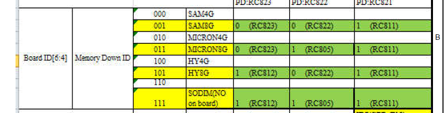

    i need nm-c781 rev 1.0 schematic for onboard ram disable. Is there anyone who can help me with ram disable? I just found boardwiev but I couldn't find how to disable ram.

      Thank you for the schematic, but I still couldn't find how to disable ram. can you help me?
            Page 10 from schematic... Stuff R, RC812, RC805, RC811 (id 111)
