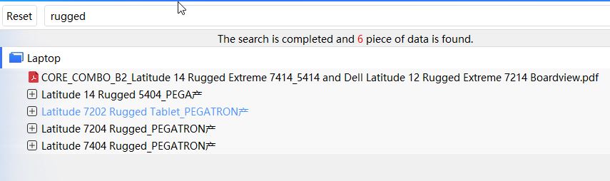

    Re: Schematic/Boardview Request: Dell Latitude 7424 Rugged Extreme
    Found only the attached in my paid service.
    What is the fault ? Start a thread in the laptop repair forum with the details.

      Boardview
        Originally posted by SMDFlea
        Boardview
        Maybe I'm using the wrong viewer to open it but, it's telling me the file is password protected in allegro, any advice? thanks
        • anshad
          • Nov 2010
          • 249
          Use "Allegro Viewer 16.6". I Tested on it and opens perfectly.
