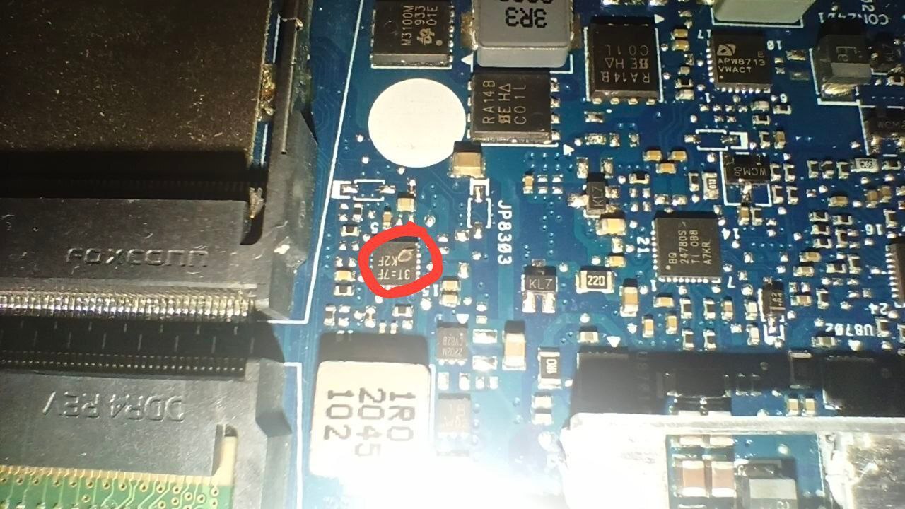

    Hello there, I am looking for a schematic and if possible a boardview for an Asus FX505DT - BQ403T.
    Trying to identify a component that is heating up. See attachment.
    Visible code on component is 3F=7A 26Z
    Any help would be welcomed.

    Re: Asus FX505DT Schematic + Boarview
    This is RICHTEK p/n RT6575BGQW.
    Datasheet is attached.
    When sourcing a replacement, be 100% sure that the 'B' suffix is in the part number. This defines that the 3v3 and the 5v0 LDO rails are ALWAYS ON and will match the original p/n.

      Thank you very much kind sir, and will do make sure to check things well. Hats off to you.

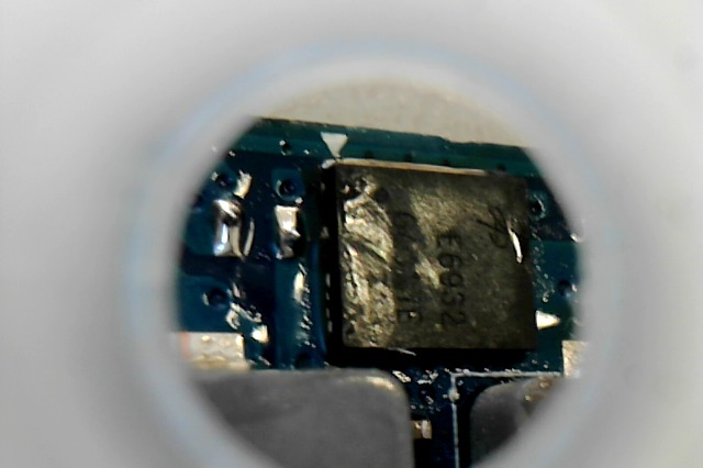

        Hello everyone!
        I have a similar board, Asus FX505DT - BQ030T.
        I mosfet was burnt and when I removed it from the board, the short was gone.
        I have no doner board. What mosfet is it? Have a look at the attachments.
        It reads E6932 GA0A1E
        Can anyone help?
        Thank you!
          Originally posted by cocobill
          Hello everyone!
          Can anyone help?
          Thank you!
          The logo at the top left is Alpha Omega https://www.badcaps.net/forum/showpo...7&postcount=15
          AOE6932 https://cdn.badcaps-static.com/pdfs/...acdf91bd1f.pdf

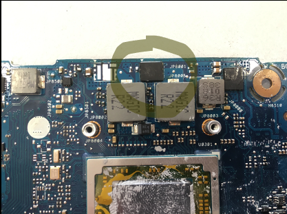

            Hello, have the same mainboard and (I think one capacitor) is creating sparks and doesn't work so laptop won't turn on. Does someone know of what specification are the most upper caps in reverse "L" shape?
            edit: put picture in attachment
              Both are 10UF/25V 0805 X5R/+/-10%

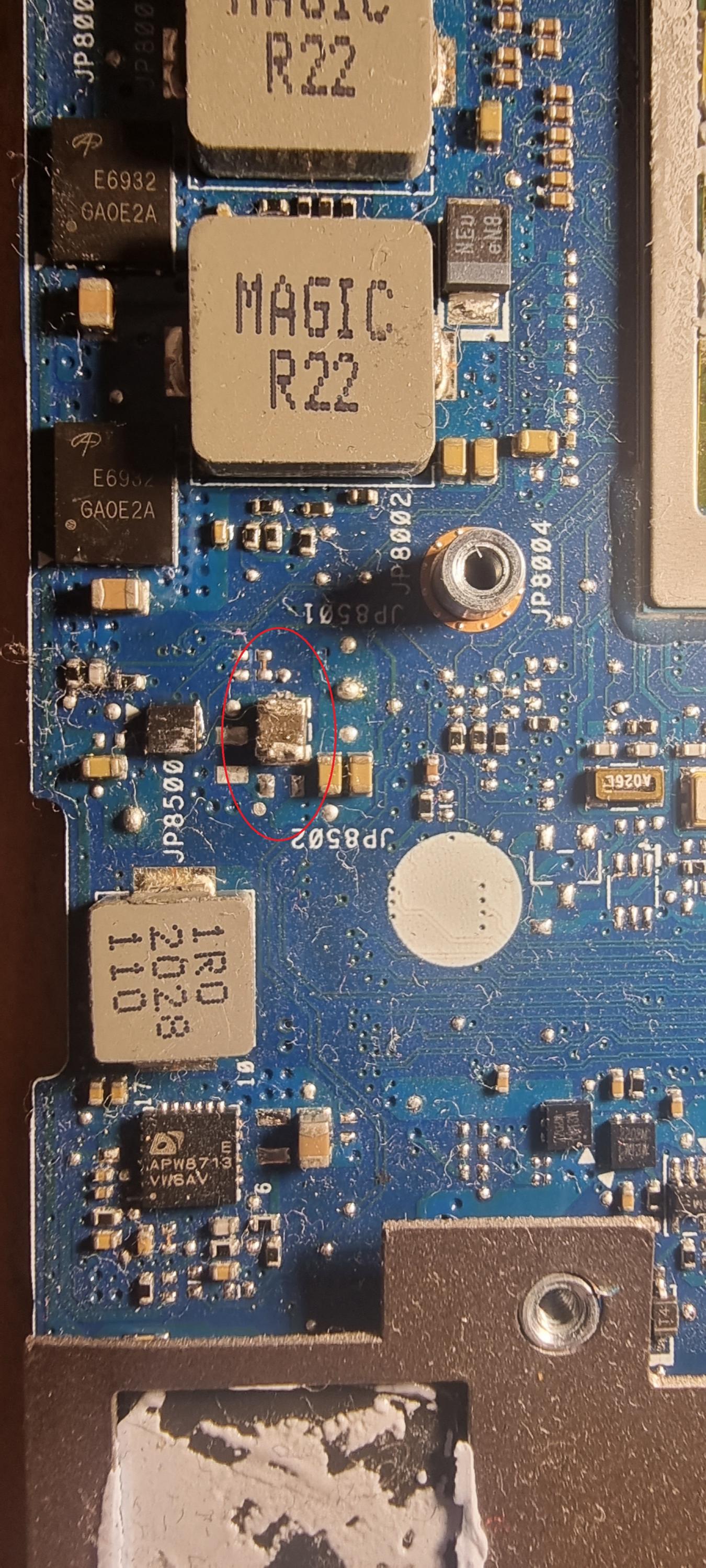

                  got the same Board. after visual inspection found that component(on the pic) what looks temperate with.
                  is it a capacator or induktor?
                  any schematics or boardviews?
                    Inductor

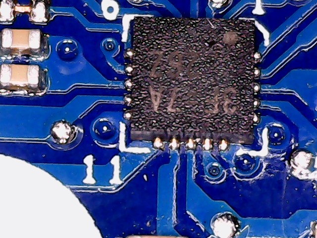

                          hello, i have the same motherboard and a component that is heating up. can you help me ? on this there is : 3T=7C354
                          Thanks for your help !
                            • 20914
                            3T= mentioned in a post by mon2 https://www.badcaps.net/forum/troubl...76#post3251276
